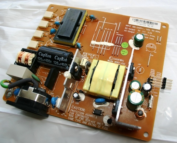

    Hey Guys: Enjoyed searching the forum this afternoon looking for a solution to my monitor issue, and alas - seems I may have another problem.
    This is a Westinghouse L1916HW that I've had for a couple of years with a Darfon B092-XXX inverter board. It worked beautifully for what it is until about a week ago when I powered it up ... The screen was washed out with faded colors and a green tinge overall. There seems to be a shimmer to the display as well. The image is clear enough to be legible but I can't use it because it kills my eyes. I spend 12 - 14 hrs a day on this thing for work.
    The monitor is hooked up to a HP Pavilion d4vt-1020usa laptop with a perfect display.

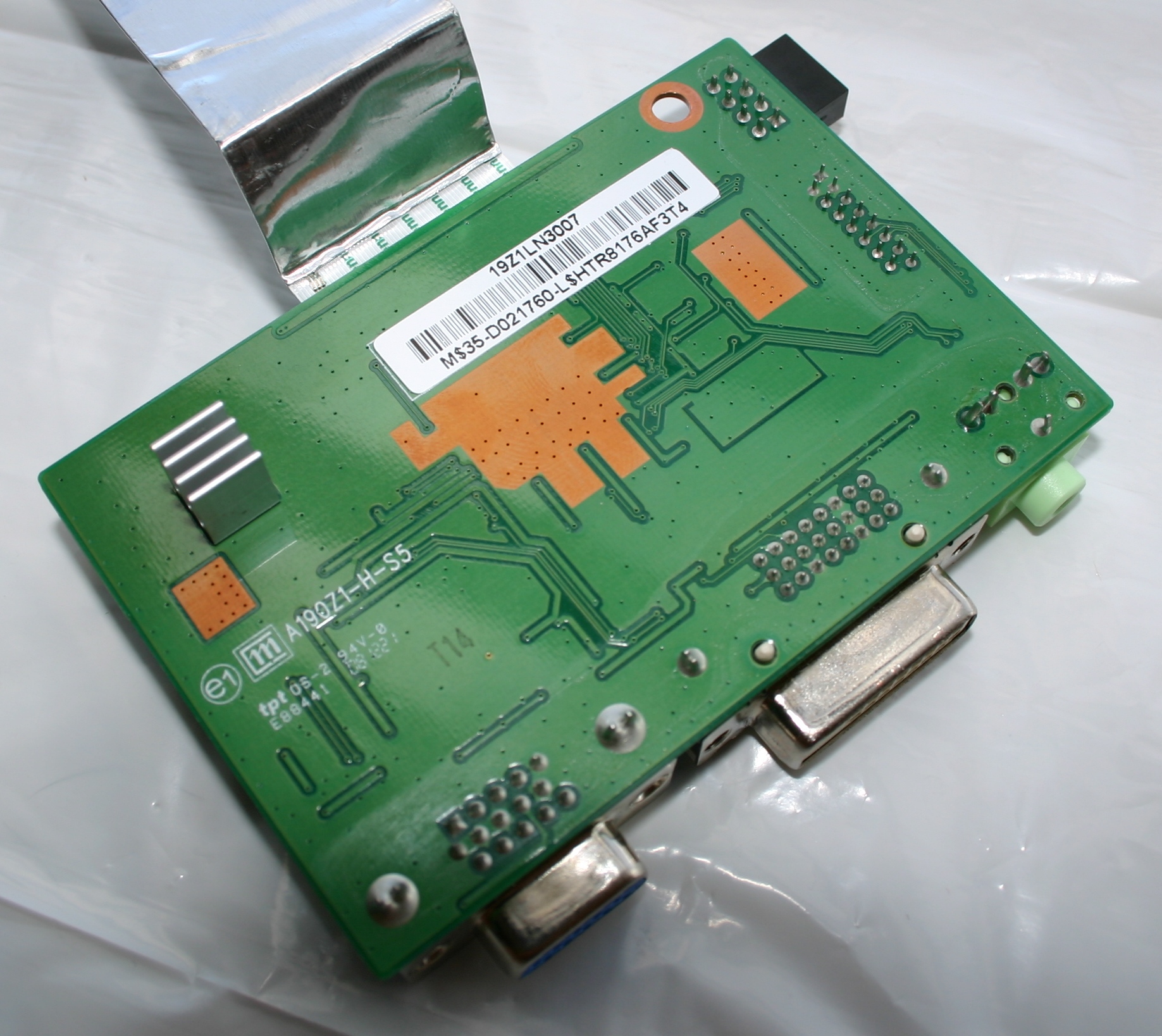

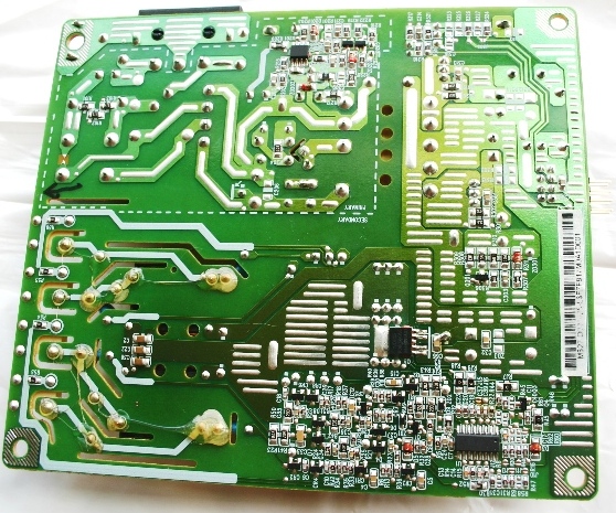

    I took the monitor apart and see no issues with blown caps although there is discoloration under a Nikos Mosfet. I intend to replace all the caps, and that Mosfet if I can figure out how to find one, but ...
    Does anyone here think that there may be another issue with this monitor exhibiting what I described above? Looking forward to your feedback.

    Welcome to the forum! Please post some clear photos of the power supply, logic board and display per the link below:
    https://www.badcaps.net/forum/showthread.php?t=1868
    Possible problems:
    Caps. If a filter cap has failed, it might be putting out an unstable voltage to the logic card, which could cause unusual behavior.
    Logic card could be bad.
    LCD panel could be bad.
    Loose/bad ribbon cable connecting logic card to lcd panel.
    Post the photos first and give people a chance to look it over.

          The P2804ND5G mosfet is responsible for generating a sine wave voltage, which is required by the inverter tranformer to generate the high AC voltage required by the backlights. This mosfet does run HOT and since the board itself is being used as a heatsink, it will get discolored over time. So, unless you're having trouble with the backlights, leave it alone.
          I suggest you piece the boards back together and start taking some voltage measurements at the 8-prong plug. Measure for the 5V and 12V outputs. As for the logic (video) board, one of the larger 3-legged chips on the right side of the board is a voltage regulator, probably marked XX1117-33. See if you can locate it.

              Your logic board picture is low resolution, but it looks like there are 2 voltage regulators on the far right hand side. They will be designated with the letter U.
              Again, with black probe on the ground screw, measure each pin on the voltage regulator. Also, we need the part number for each regulator.
              Report all voltage readings.

                    Some of the symptoms (flickering) you describe can be caused by bad caps. If you want to take a chance (without having done any testing) go ahead and replace them (except for the large one). This board uses very few caps and would cost you under $10 (including shipping). No guarantees that this will solve the problem.

                      For flickering, there is a small chance your problem is like this one (post #140)
                      https://www.badcaps.net/forum/showth...?t=9343&page=7
                      Replacing the large cap for Aruba worked because of fluctuating voltage on the big cap. And the big cap had very poor uF (0).

                        Logic Board Voltage Regulators:
                        50117
                        K-G
                        73822
                        Pin 1: 0V
                        Pin 2: 3.3V note: is not connected as the other two are
                        Pin 3: 4.74V
                        L1117LG-1.8
                        XB52J0286
                        Pin 1: 3.3V
                        Pin 2: 1.8V
                        Pin 3: 0V
                        Logic Board Pin Connectors:
                        Top row:
                        Pin 1: 4.99V
                        Pin 2: 0V
                        Pin 3: 0V
                        Pin 4: 0.04V
                        Bottom row:
                        Pin 1: 4.99V
                        Pin 2: 4.99V
                        Pin 3: 0V
                        Pin 4: 0.06V
                          Re: Westinghouse Monitor Fading Colors
                          All the voltages for the connector pins and voltage regulator seem normal. 5V, 3.3, and 1.8 are fairly common for a logic board. Replacing the caps might solve your problem, but it is only a guess. I have no hard evidence.

                              Just re-read post #11 re big cap. If it makes sense, you might want to include that in your cap order.

                                    I rec'd and installed all the caps with Panasonic except for the big one. I expect that one to arrive in the next few days.
                                    The flickering seems to have disappeared from the display, but the colors are still washed out. This happens as soon as the monitor is powered on.
                                    I've tried adjusting colors, brightness, etc. with the buttons on the side of the monitor as there does not seem to be a way to make adjustments using the laptop with a VGA connection. I have ordered a DVI-D to HDMI cable from Amazon which I hope will allow me to use the controls offered by the AMD M880G with ATI Mobility Radeon HD 4200 in the laptop.
                                    I have a feeling that adjusting the controls is not the issue. Anyone got any other ideas?
