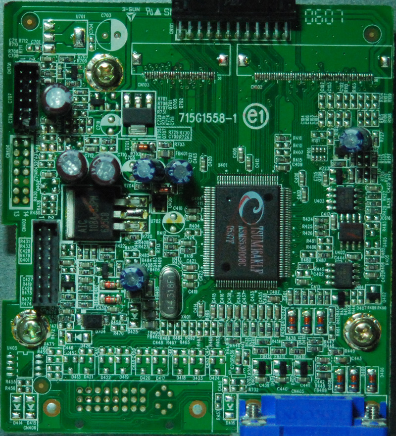

    after reading a blog post I dug out my Acer AL1916 from my closet in hopes of possibly fixing it. The reason I had stopped using it in the first place is that one morning when I got up I tried to turn it on and neither the power LED or the screen itself would light up.
    So like I said I dug it out plugged it in and no surprise here, nothing happened. Now I've already checked the capacitors and I believe all of them are in order, I didn't see any bulging near the top for those that had slits and for those that didn't I couldn't see any obvious bulging either.
    Aside from that I have no clue. I am completely oblivious to anything electronic/electric which is why I came here (the bad capacitor suggestion was made by someone on another, more software oriented, forum).
    http://www.mediafire.com/?v2a385jl9e05m
    Here I uploaded pictures of the circuit boards inside the monitor. Also, I'm not sure if this can be of any help:
    It's an Acer Service Guide for this model (I assumed it was the right one, there are multiple variants of the AL1916 model but this particular guide was the only one to have pictures of the circuit board that matched mine).
    P.S: This is probably not important but if I connect the monitor to my laptop's VGA port, the laptop's display flickers to a different resolution.

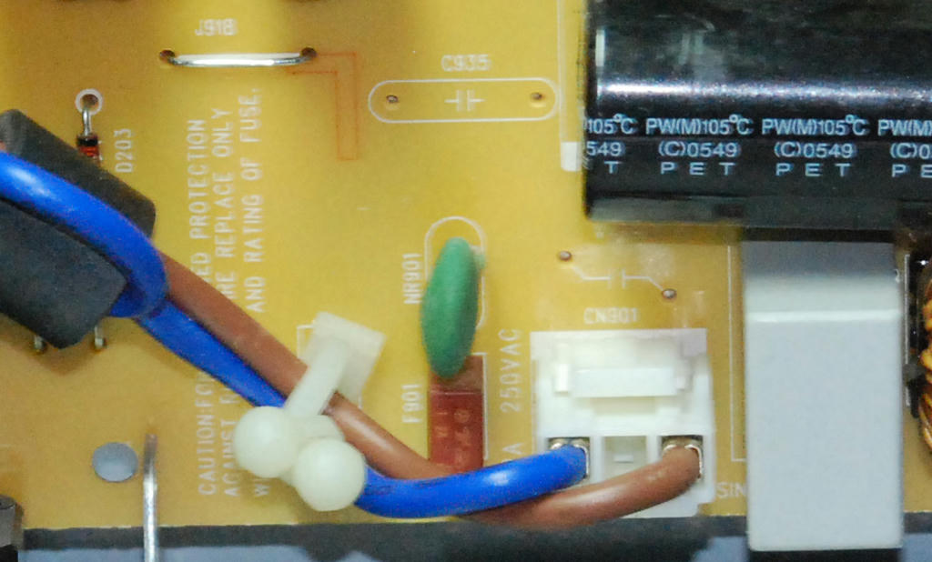

          F901 should only have two pins. [look at schematic]
          Probably looks like a resistor.

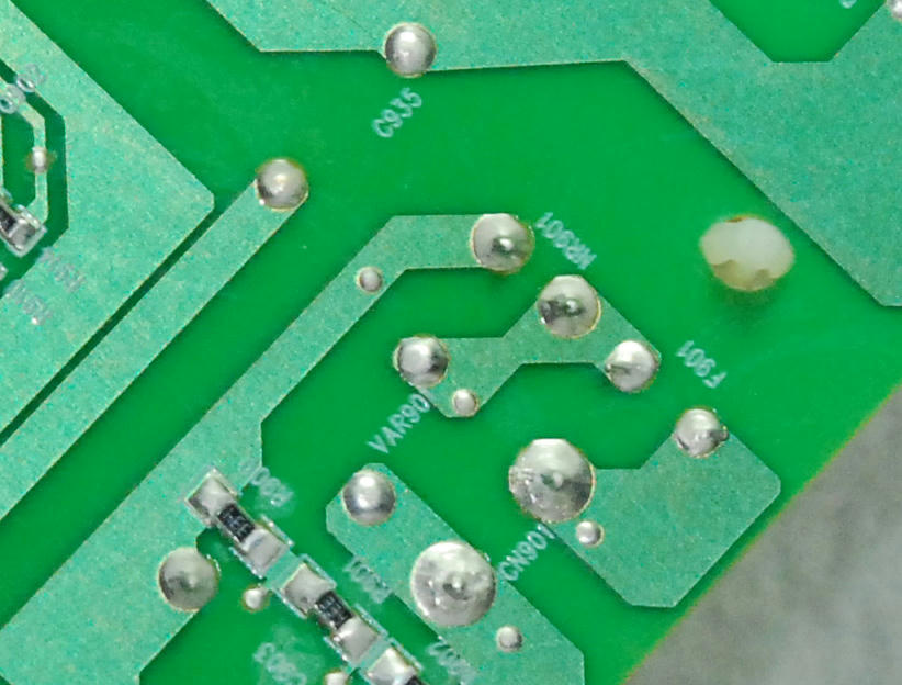

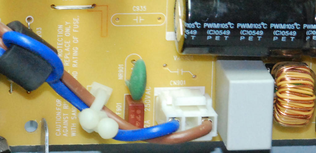

              It seems I was incorrect, when I looked at it last night the lighting was dim, so today I un-screwed the yellow board and flipped it over it only has 2 pins. Also, the markings on the box read "T2A" and "392". And it looks in good shape.
              http://www.mediafire.com/imgbnc.php/...1abf703c6g.jpg
              http://www.mediafire.com/imgbnc.php/...9c06cb206g.jpg
              http://www.mediafire.com/imgbnc.php/...b6c9b00d6g.jpg

                Looks in good shape, but did you measure it?
                Looking isn't going to eb enough. You'll need to measure, or replace caps, and measure fuses and voltages to fix the problem.

                  As weird as it may be, the continuity test on my multimeter doesn't "beep", instead when I connect the two probes the value goes from 1. to ~0.
                  Since the fuse (red box) is soldered so close to the board, I can't test the two pins from the top, so I unscrewed the board again and put one probe on each of the two pins/metal patches on the bottom of the board and I got the same ~0.
                  This means it's good right?

                    The threshold for continuity varies with multimeters. Some beep "good" if the resistance is less than 1.5k ohm.
                    A good fuse should read less than 1.0 ohms depending on the multimeter.
                    Since you measure 165V DC across the main filter capacitor that implies the main fuse is good.

                    • Borgleader
                      • Sep 2010
                      • 8
                      Re: Acer AL1916

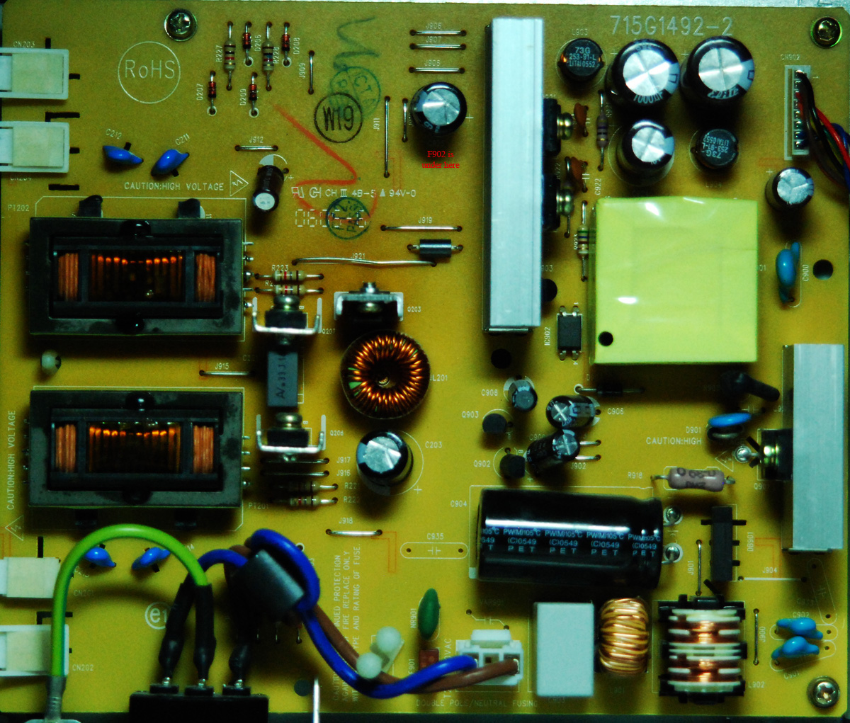

                      (I had originally uploaded my pictures to mediafire to save bandwidth to the server, but since the guidelines suggest using attachments with a max width of 700px i resized it and attached it)
                      Ok so on this picture, the cables going off to the bottom right come from the yellow circuit board. I put the black probe on the ground screw under them (from this angle) and the red probe in a few of the sockets at the end of the cables.
                      I got readings of ~4.47V DC (for brown cable), and ~4.92V (for yellow & green cables). The others I couldn't get a reading, the metal part is just too far in.

                        Re: Acer AL1916

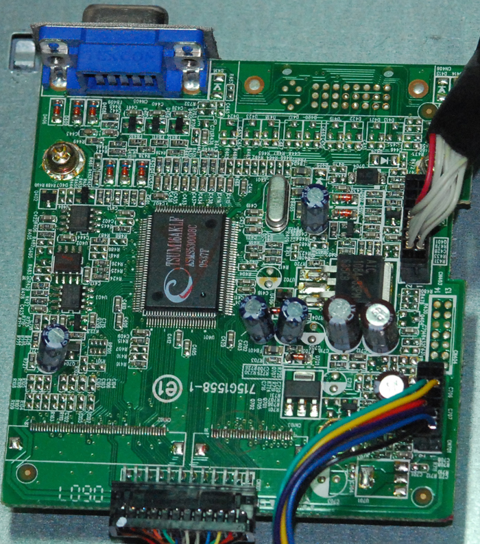

                        Look at page 32 of the PDF file in your first post.
                        It tells you to measure U701 and U702 for 3.3V. You should also be seeing 12V DC on pin 5 and 6 at CN701.
                        Your pictures of the power board at the offload site have too much glare for me to see the PCB designations. We want a picture that looks like this

                            • Borgleader
                              • Sep 2010
                              • 8
                              Re: Acer AL1916
                              I've added a new picture (in attachment) of the green circuit board. At U701 (top left), there isn't actually a component. It's been observed in another thread in this forum: https://www.badcaps.net/forum/showthread.php?t=8257
                              Even though there wasn't a component in U701, I checked the 3 spots where would've been soldered the pins had they been there (just in case it's helpful) and I also checked the 3 pins for U702. For each of these I used the top screw as my ground.
                              U701: Top pin: ~0V | Mid pin: ~0V | Bottom pin: ~4.92V
                              U702: Top pin: ~4.65V | Mid pin: ~3.3V | Bottom pin: ~0V
                              (Since top/bottom is relative, U701 is top left corner, Blue VGA port is bottom right)
                              As for CN701, pin 5 doesn't have a cable in it so I didn't manage to get a reading, but pin 6 had a reading of ~14.5V DC.

                              • retiredcaps
                                • Apr 2010
                                • 9271
                                Re: Acer AL1916
                                Hmm, that voltage looks a bit high. It should be 12V DC.
                                F902 is ~0.3 ohms (I used a scale of 200, didn't have 20).
                                D921 (ohm scale 20k, 2k was not enough):
                                1) put red on pin 1, black on pin 2: 3.96k
                                2) put red on pin 3, black on pin 2: 3.92k
                                3) put red on pin 1, black on pin 3: 0k
                                D921 (diode test):
                                1) put red on pin 1, black on pin 2: 0.232
                                2) put black on pin 1, red on pin 2: 1. (the manual says to reverse the leads if i get this, which ends up being 1) )
                                3) put red on pin 3, black on pin 2: 0.231
                                4) put black on pin 3, red on pin 2: 1.
                                F902 and D921 test good.
                                Let's try measuring the voltage on D921 pin 2 (middle pin). Put your black probe on the ground screw in the top left. Red on pin 2. Report the DC V measurement.
                                Hmm, I will have to think about this. You are getting 5V DC and 14.5V DC, but there is no power LED.

                                    Left pin: 0.00V
                                    Middle pin: 4.92V
                                    Right pin: 4.30V
                                    And so I proceeded with his test (unlike the other poster I chose the battery version). And I got:
                                    Top pin: 0.4V & 0.01V (We werent able to repeat the 0.04V however, so it could be a fluke)
                                    Right pin: 0.05V
                                    I cant deduce anything from his post however since he assumed that the top pin would have 3V on it, although the fact that it doesnt may mean the part is bad, or maybe the soldering gave out?
                                    • retiredcaps
                                      • Apr 2010
                                      • 9271
                                      Re: Acer AL1916
                                      Right pin: 0.05V
                                      I suggest retesting this again. Please try to use the same terminology as in PlainBill's post so it makes it easier for us to track and read.
                                      If you are not getting 3V on the upper pin, that means something is wrong.
                                      --- begin sig file ---
                                      --- end sig file ---
                                      • jetadm123
                                        • 2169
                                        Re: Acer AL1916
                                        Sorry for the delay, just got back to Uni and haven't got used to my schedule yet.
                                        Ok so I Ctrl+F U406, and I took the same measurements that PlainBill asked for in the other thread, and I got the same results, that is:
                                        Left pin: 0.00V
                                        Middle pin: 4.92V
                                        Right pin: 4.30V
                                        Right pin: 0.05V
                                        If you read the entire thread, the second test suggests shorting the bottom 2 pins with a small screwdriver, while hitting the power button. This sets the reset pin to zero (ground). Some people actually removed U406 altogether (I don't recommend this). Read the entire thread and decide for yourself.
