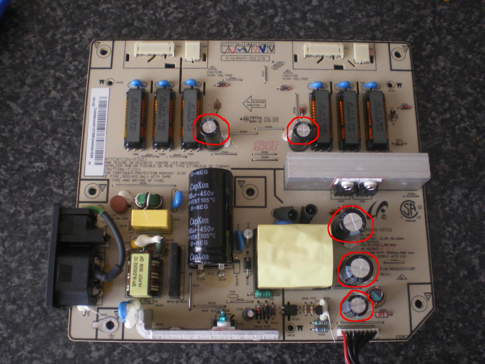

    Hi there again hope some one can help me with this one i have a samsung syncmaster 215tw that the backlight has gone. So i have removed six capacitors to check them with a capacitor meter all caps are made by capxon.
    First i checked caps C327 & C328 which both are 1000uf 25v but on test i get 1025uf on one and the other 1018uf. One the next two which is C263 & C261
    which are also 1000uf 25v but on test i get 1073uf and 1088uf
    and the last cap to test is a 470uf 25v but on test i get 501uf .What i want to know is are all these caps nackered or are they within there tollerences. i will add a pic to show which caps i have tested. Any help appreciated guys thanks again.

    Electrolytics normally plus or minus 20%..so i'm sure you can do the maths,lol.

      They're probably within tolerance *capacitance* wise, but that's not the only measure of capacitor health.
      The ESR is very important, especially in modern switchmode circuits.
      If it were my monitor, I wouldn't even drag out my ESR meter, I'd just replace them, as they're a known bad brand. I'm not saying that's what's wrong with your monitor, but it could very well be.

        If there is no backlight, not even a brief flash, I would check for a fuse in the inverter section of the board (upper half).
        Additionally, there my be transistors or mosfets that are shorted.
        Your pic is a bit fuzzy. Try to get a more clear one and please post a pic of the backside as well.
        Please do not post pictures inline.
        Take your boards to a window on a sunny day, turn flash off, and use macro mode. Take a top down view of all your boards (front and back). Make sure the photo is legible so that we can read the PCB printing clearly. A shutter speed of 1/125 or faster will produce nice clear focus pictures. Try to get a photo that is 2000x2000 resolution or as close as possible.
