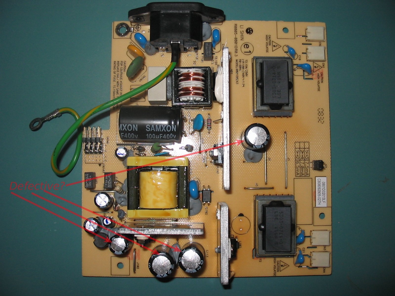

    i have an I-Inc 19" LCD monitor, Mod. # HSG1022, Mfg. Date 11-2008 that is dead. Well, not quite dead, it gets power and flashes something on screen every few seconds, just some colored rectangles or something like that.
    Google search lead me to believe that there is a chance the power supply has bad caps, so I opened it up to check. There do appear to be 4 caps that have slightly bulged tops, as opposed to completely flat ones on all the others. All these caps are Samxon brand: 3 - 1000uF 25V that measure 12-13x20mm, 1 - 470uF 25v that measures 10x15mm. They have marking of "105 degrees CF", and "SF(M)".
    I don't see any leakage or bulging except that the tops are slightly convex.
    Since Samxon is a recommended brand sold here, and they are not that old, I don't want to jump to the conclusion that they are at fault, but I am wondering if this is the likely cause of the monitors problem, and what replacement caps I can use? None of the Samxon's listed on badcaps.net seem to be an exact match.
    The power supply is Li Shin, Mod. #0801D243. if that helps at all. It also has these caps that look OK: 1 - 100uF 400v which measures 16-17x30mm, 2 - 330uF 25v that measure 8x14mm (all Samxon), 1 - 47uF 50v Rubicon that measures 6x10mm. There is also 1- 10uF that I cannot read the other specs or brand, due to it's proximity to other components and a dab of glue on it. It measures about 5x8mm. It has a jumper switch that is labeled:
    Those caps in your picture with the red arrow are DEFINITELY bad.
    Heat rises and 3 of those caps are at the very top of the monitor and take the brunt of the heat from the heatsink. Heat kills caps.
    Since 50% of your caps failed, we would recommend replacing all of them. The only exception might be the Rubycon one, but if you live in a hot climate or don't have very good ventilation on where your monitor is placed, replace them ALL.
    The exception would be the very big cap. It rarely fails (but not never).

      You definitely need to replace those caps. As a matter of fact, replace all 7 of them (probably run under $10 icluding shipping). A good replacement choice would be Panasonic or FM or FC series. Use the instructions below to order:
      1) Go to digikey.com
      2) In the "parts search" window type: panasonic fm and select "GO" button
      3) Under the Capacitor heading select "Aluminum"
      4) The first two columns you see are capacitance and voltage. Highlight the value and voltage with your mouse and select the "Apply Filters" button
      5) You'll see several selections available. Here's what to look for:
      a) Look at the quantity available and minimum purchase. If "0" are available, then there's none to purchase. Some selections require a minumum purchase of a 1000 units, which you also don't want. I think you get the picture.
      b) Size and diameter. Measure the original caps and compare to what's listed.
      6) If your value is out of stock, go back to the beginning and type in "panasonic fc" and go through the same process
      7) During the checkout process select USPS First Class shipping, since this will give the best ship rate.

        Oops! I missed one cap. Replace all 8 of them except for the large 100uf 400V one.

          I did a different model I-INC 19" last year.
          Was a dead freebie. - I'm using it right now. LOL.
          Replace all except the 100uf 400V and it should be fine.

                I am on Digi-Key's site now. Should I worry that some of the Panasonic caps only are rated at 3-4000 hrs? Would I be better off to buy different brand/quality?
                • PCBONEZ
                  Grumpy Old Fart
                  • Aug 2005
                  • 10661
                  Re: I-Inc monitor power supply
                  That's not expected or useful lifetime, it's endurance lifetime.
                  The number is not useful for anything practical.
                  Look at ESR [Impedance] and Ripple.
                  Ripple - more is better.
                  ESR - less is better.
                  I would use Panasonic FM if they are available in diameters that will work.

                    Oh, and make sure to look only at 105C rated caps.

                      OK, thanks pcbonez. found all except the big 100uF.
                      And the 105 C is temperature tolerance? My originals say 105 CF?
                      • PCBONEZ
                        Grumpy Old Fart
                        • Aug 2005
                        • 10661
                        Yes 105C is the max temp rating.
                        I'm not sure what the F is on your old caps.
                        If you care I might be able to figure it out with a readable pic or two of the caps.

                          You know after replacing the caps I get a "No signal input check video cable" error message. At least no its displaying something. Just to let you all know that it could be a cable issue. That is what it was after I replaced the caps.
