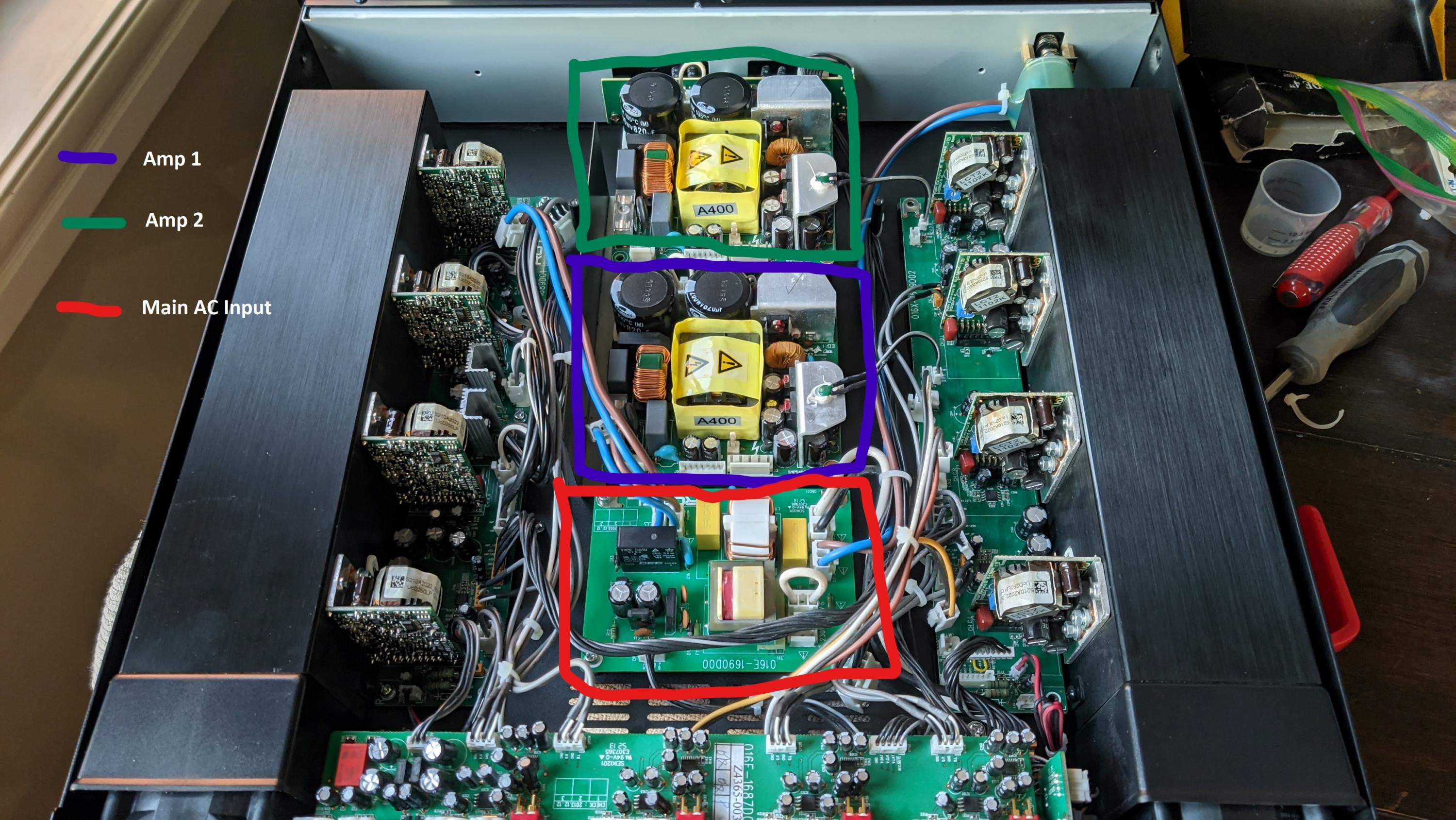

    Unit goes into protection mode within a minute after turning on.
    I get sound for a few second before protection mode.
    The unit seems to be made up of "two identical halves", which I think will help during troubleshooting.
    I tried finding a technical/service manual online but so far by Googling has returned no results.

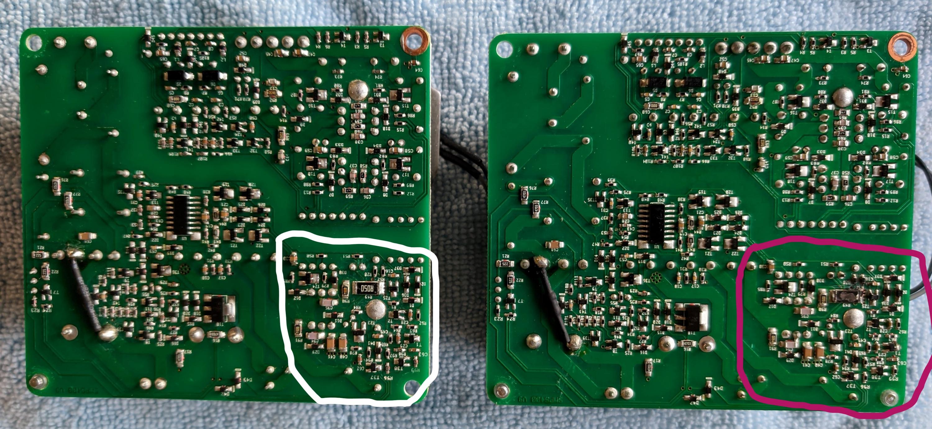

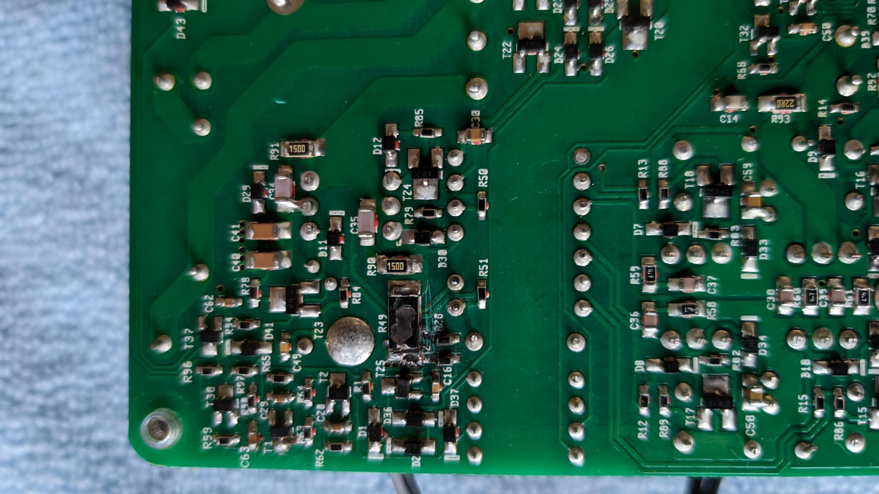

    I think I narrowed it down to Amp 1 in the first picture (pardon my ignorance if that is not an Amp). There are some burnt Chip resistors (shown in picture 2 right image). The big one (R49) is easy to tell from Amp 2 but the two small ones (R52 and R28) I cannot tell.
    I also noticed two transistors were bad. Hard to get a picture of it as it they are hidden on the board.

    1. A search on Digi-key for the big chip resistor showed it will be a 0.05 Ohms resistor, but I saw multiple Watt ratings available. How can I determine the wattage to buy without access to service manual?
    2. ow do I determine the values of the small chip resistors the purchase a replacement?
    3. the small chip resistors, how do I determine their value in order to get replacements.

    Re: Rotel RKB-8100 Amplifier going into protection mode
    Maybe i'm wrong,but to me, this is 2 power supplies. And one is obvius burn. Maiybe the amp gets without current with only one psu?

      I checked the resistance of the two small burnt chip resistors on the good unit and I get 0.9 kOhm on both. I am assuming they will be a 1kOhm resistors.
        If you measure something on board, all depends on the circuit. So when in doubt, take it out! Remeasure. And yes, it is a PSU.
        As for the SMD resistor sizes, google something like: smd resistor size chart
        Datasheets will have the sizes printed in them. The size determent's the wattage.

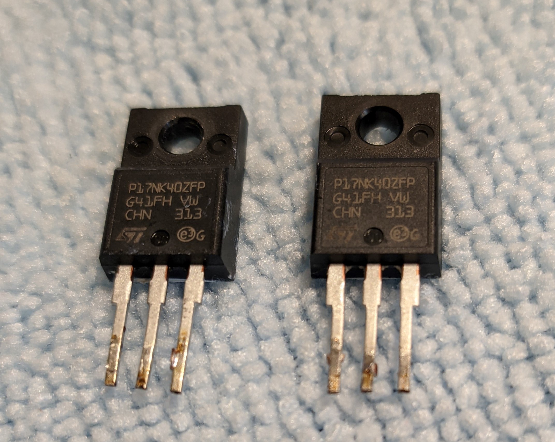

          The bad transistors are identical with part numbers - P17NK40ZFP. I have added a picture as I took them out.
          Shows on Mouser as STP17NK40ZFP

            The STP17NK40ZFP are n channel mosfets. Since this device is shorted all three pins, you have to check all the components that drive the gate of the mosfet. If something is wrong with the gate drive and is stuck on, all the parts you put in are going to blow again.
            Be smart, make pictures, take notes on lots of measurements from the good and the bad PSU, order every part you need twice, fix that what you know is wrong, double-check your work, take more measurements and pray you got it all before powering the unit up.

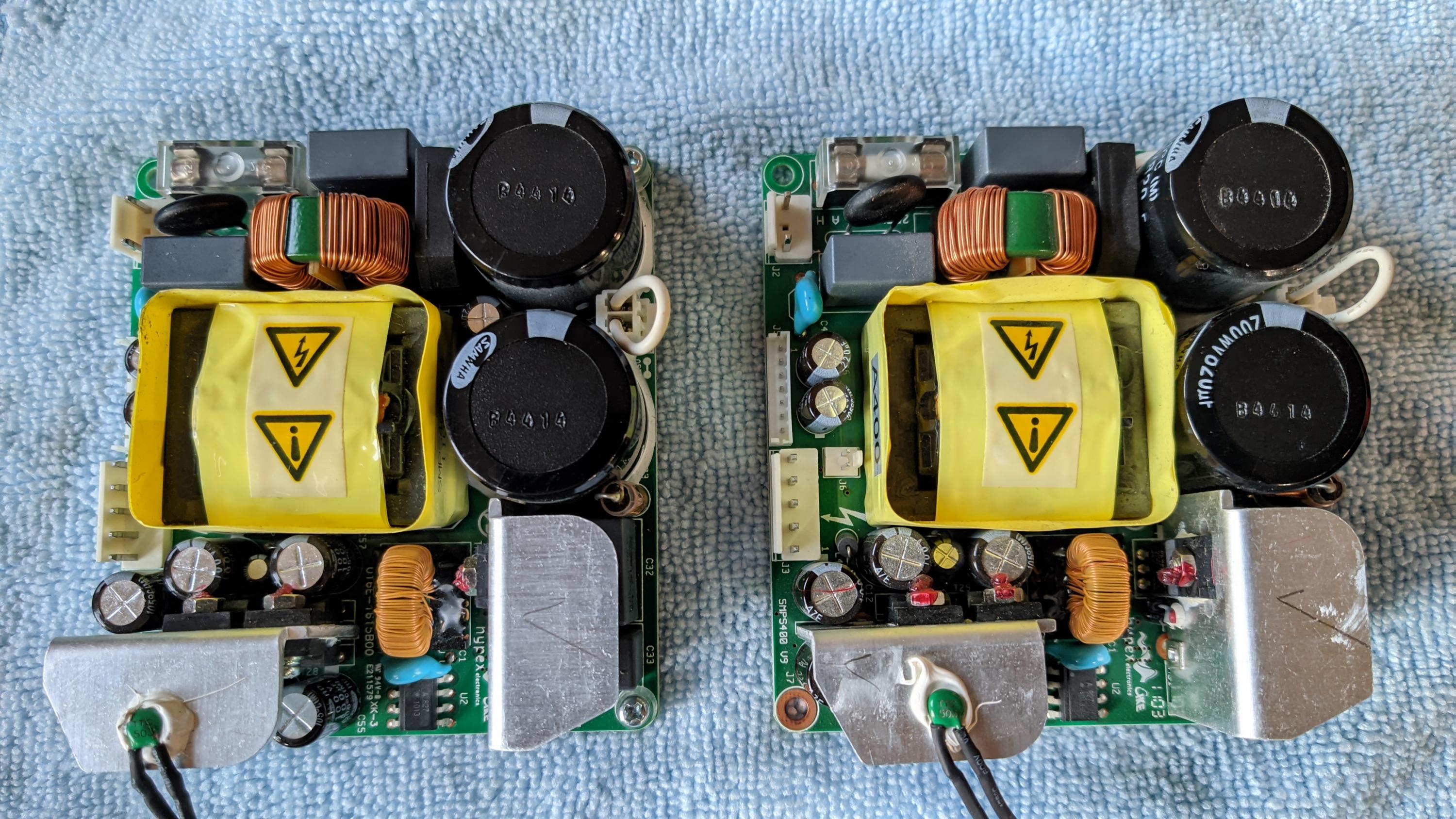

              Thanks again CapLeaker.
              I will do exactly as suggested. I guess this is where having two identical power supplies will come handy. I can compare values between the two.

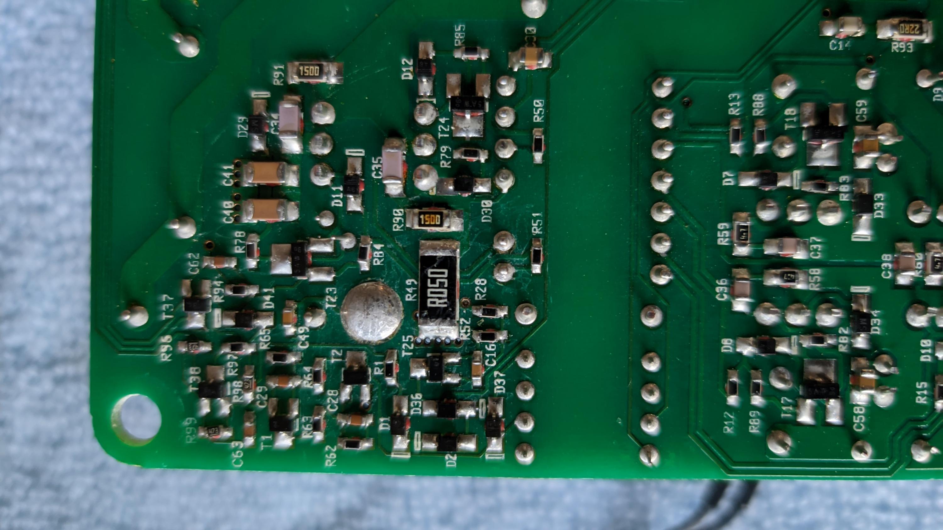

              After removing the two small burnt chip resistors, I noticed the damaged wasn't just to the resistors. There is damage to the PCB traces connecting the resistors. I have to take it to a professional to fix the traces as it is beyond my capabilities, and I do not want to cause more damage.

                Damaged traces are an easy fix. There a tons of videos that explain how to do it. But most of them do have a microscope, which makes repairs much easier.

                  I think this is where the Pros and noobs like me differ . I came to the conclusion to have a Pro fix the damaged traces after watching some of the repair videos on damage traces. I'm sure a Pro will watch the same videos and go, piece of cake
                  Anyway, I wanted to thank you again for the input and advice. I took it to a Pro in the electronics teaching lab/repair shop on campus where I work. He was adamant on not trusting measurements in-circuit, so I agreed to him removing the two small resistors on the good power supply to measure the values and sure enough, they were different. One was 1k Ohm and the other was 10k Ohms. Looking back, it makes sense that I was measuring 0.9k Ohms on both.
                  He fixed the traces, replaced the burnt resistors and the bad MOSFETs.
                  Took it home and did a comparison of values between the two power supplies and fortunately, they were all comparable.
                  I put the power supplies into the amplifier connected every and rechecked everything. Turned it on and viola, its back up and running again.
