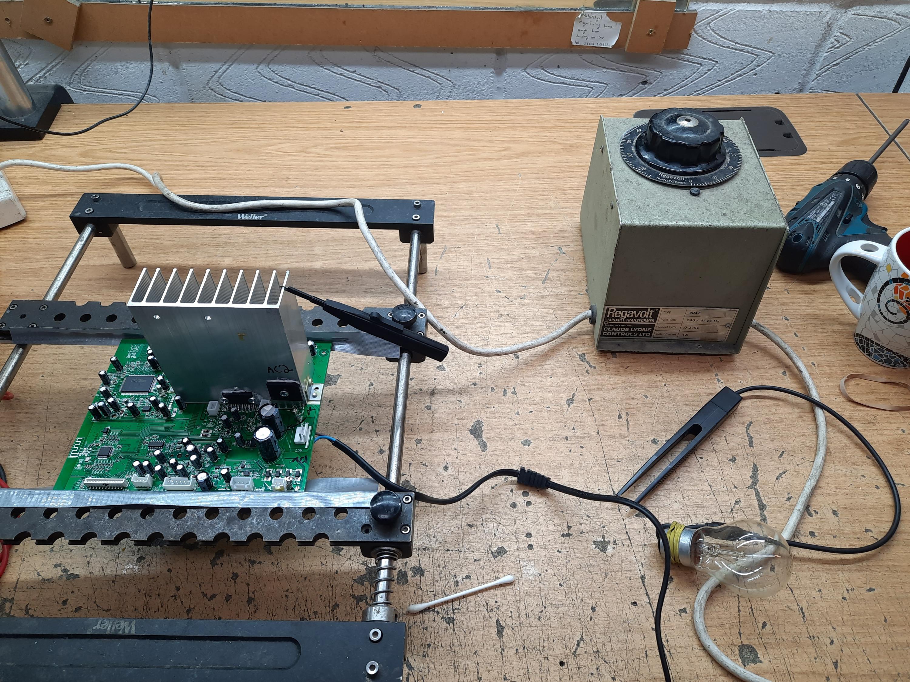

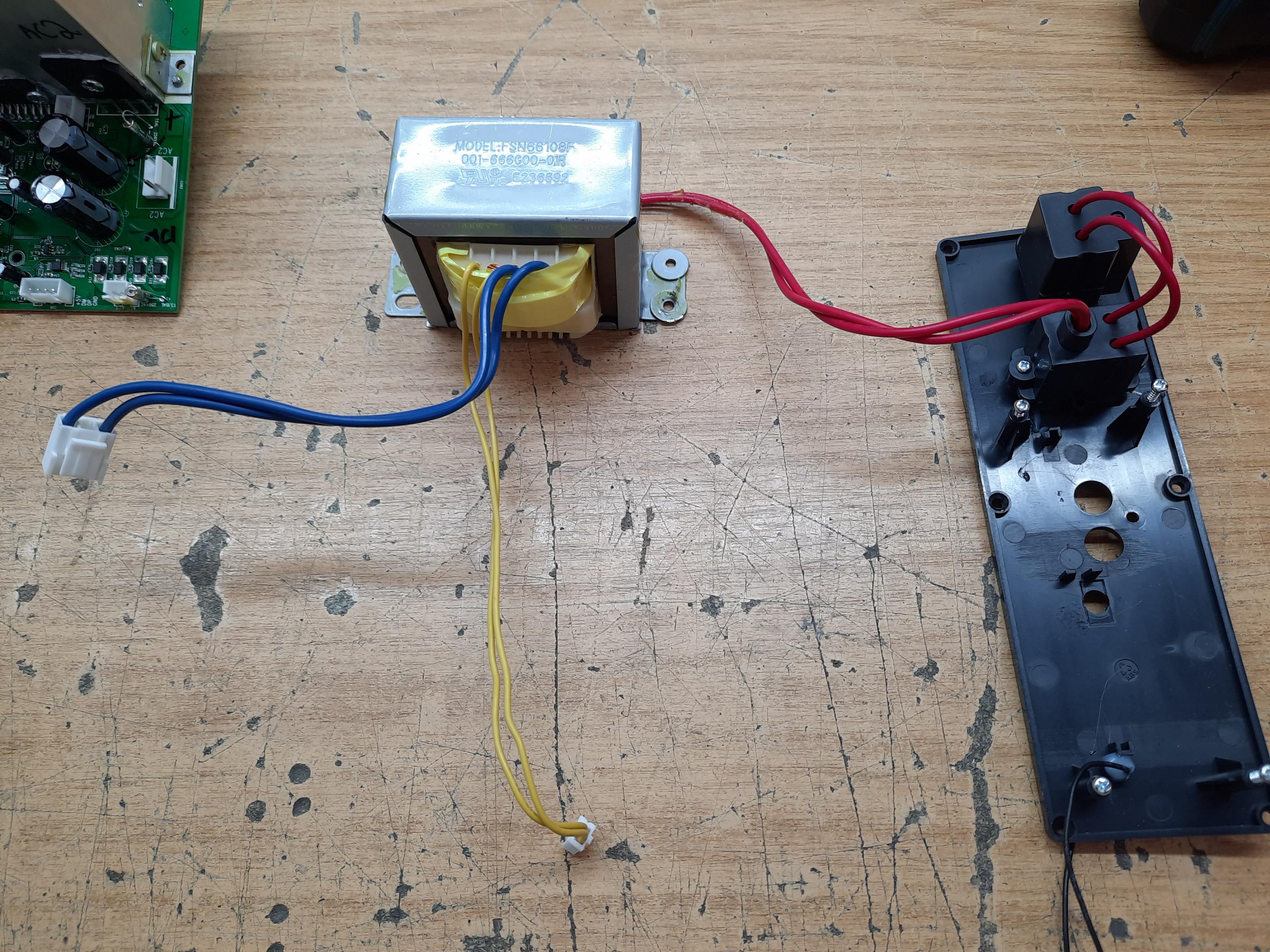

    Hi all

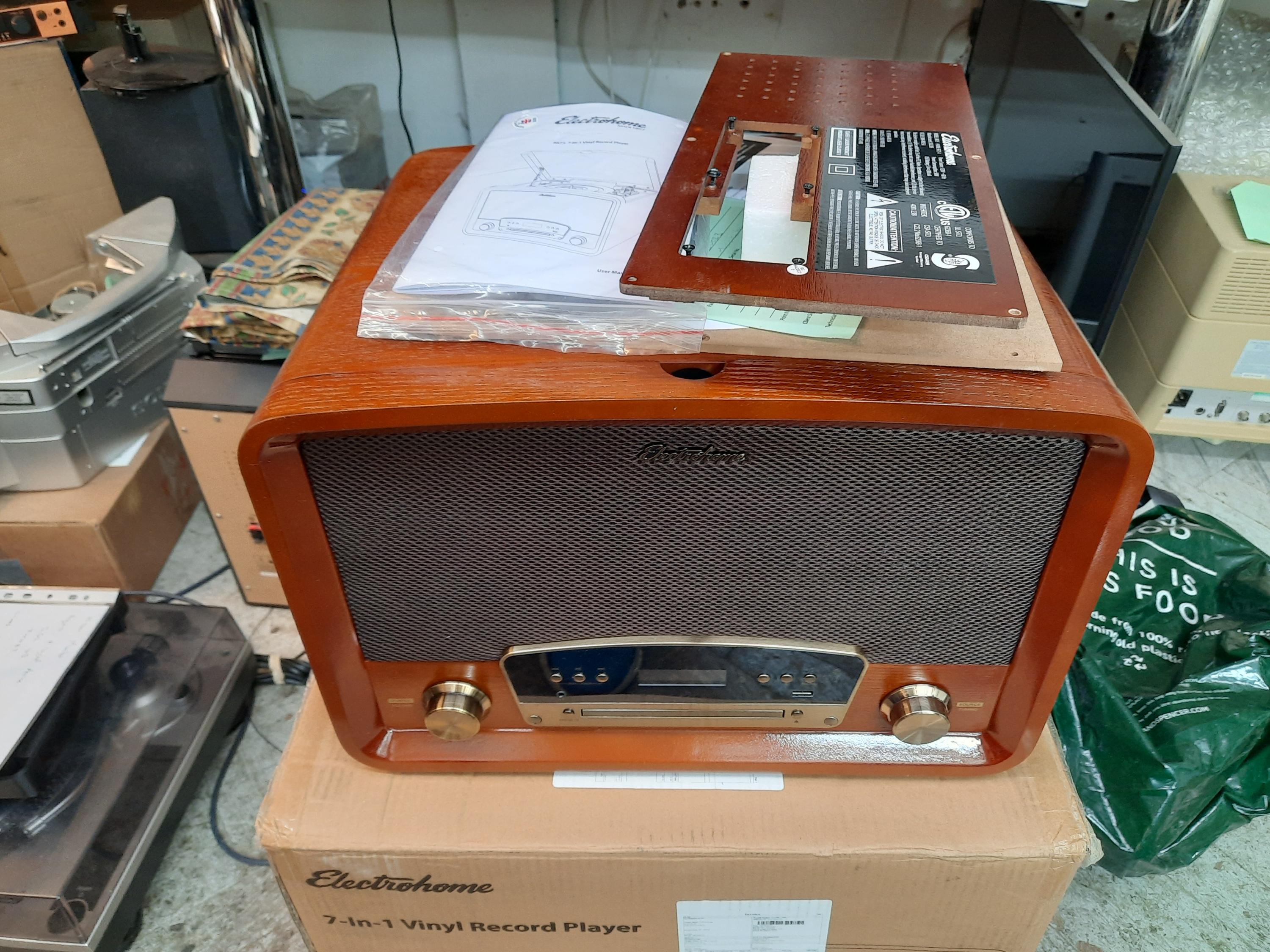

    Customer bought a retro stereo unit from Canada & didn't realise it was a 120V unit.
    Need I say more?

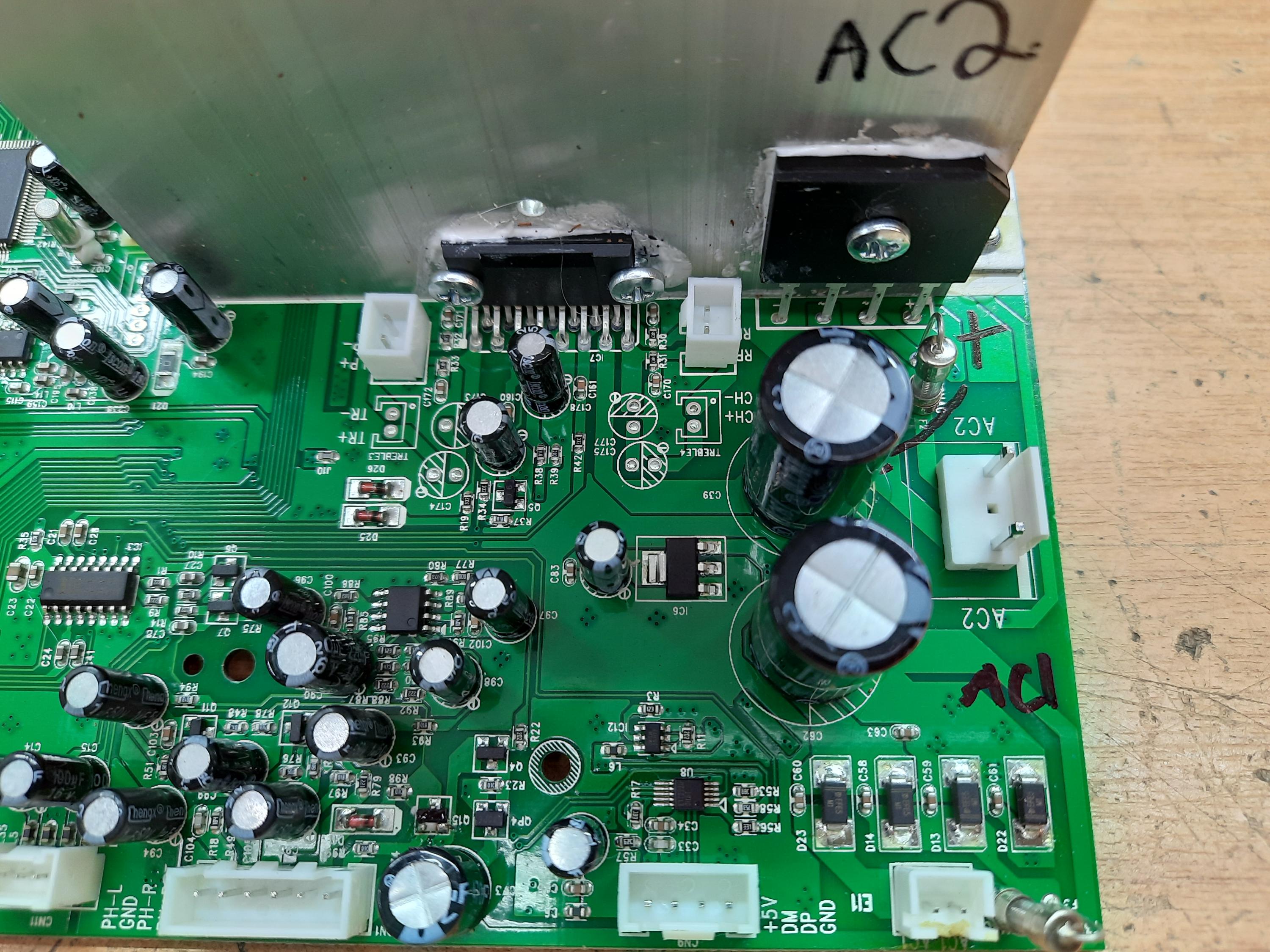

    Primary winding blown quite badly, therefore trying to work out the secondary AC supplies, of which there are two.
    AC2 which are the thicker BLUE wires go through a rectifier, then to a 25V cap, which narrows things down slightly.
    AC1 the yellow wires, after rectification go to regulator IC6, which may also be fried.
    The appliance is an Electrohome HVIN-RR75-1

    AC2 after rectification arrives at the audio out chip STA540SAN.
    Pulled up datasheet for chip & supply voltage stated as a maximum of 22V

      Re: Mains transformer help please
      AC1 as mentioned after rectifier seems to arrive at IC6, which is a Microne ME6118A33B3G adjustable regulator.
      This one might be slightly trickier to pin down.
          Connected a Variac to the AC2 terminals on PCB & increase supply gradually.
          An AC input of around 12V will result in DC 15V on audio chip supply pins 3 & 13. Will play it safe & start with that.
          AC1 I'm not quite sure about.

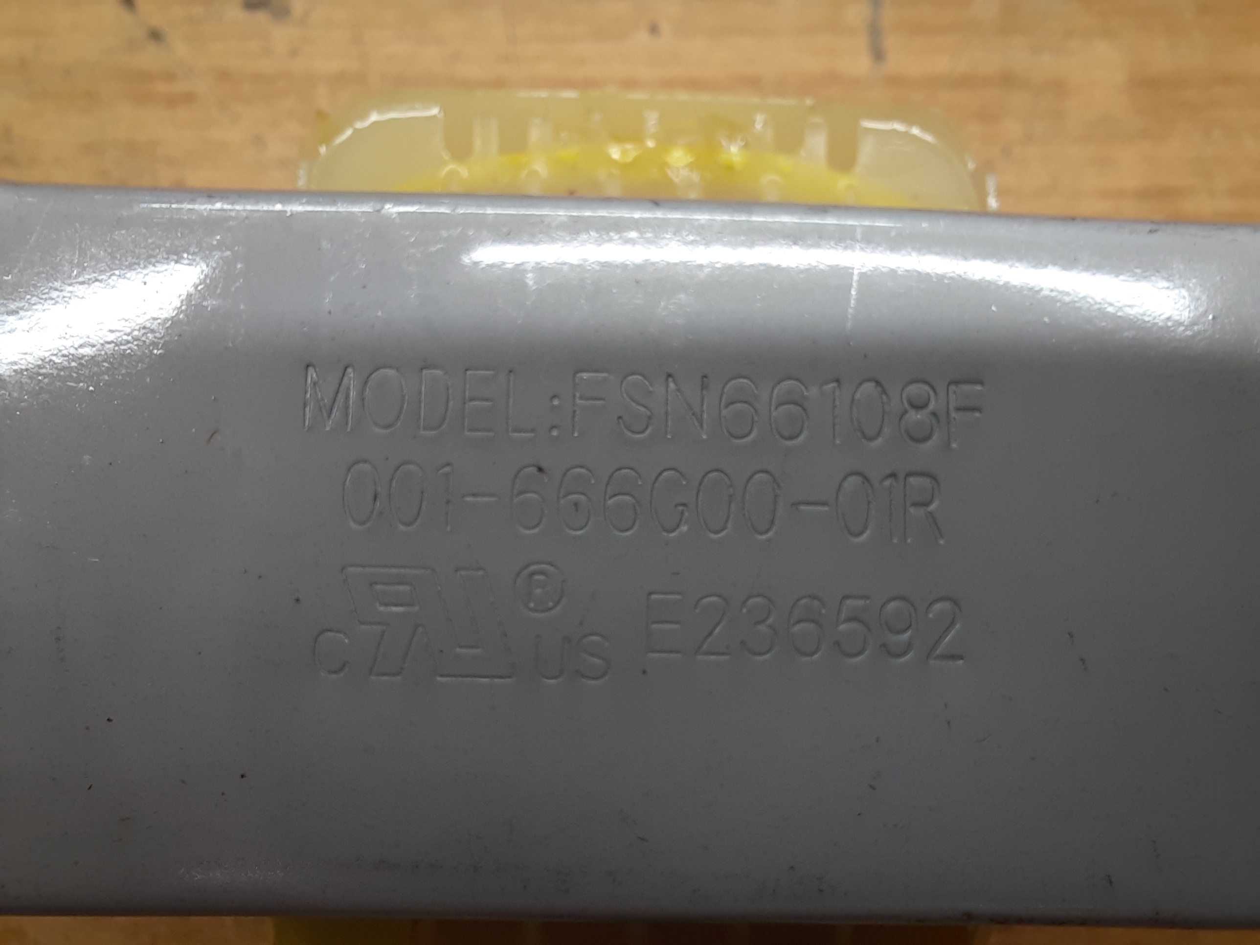

            so i just tried to look up that UL code on the transformer.
            it seems the UL has sold out and is just another "kosher" mark now.
            just go to the website and buy a few, but you cant check one without an account!!
            so no use anyway if they cant be verified as real by non-gangsters - i mean non-members
                AC1 is probably 7v
                AC2 is probably 15v
                7v is common for driving a regulator for logic circuits.
                • zen
                  • 511
                  Thanks , i wasn't too far off then

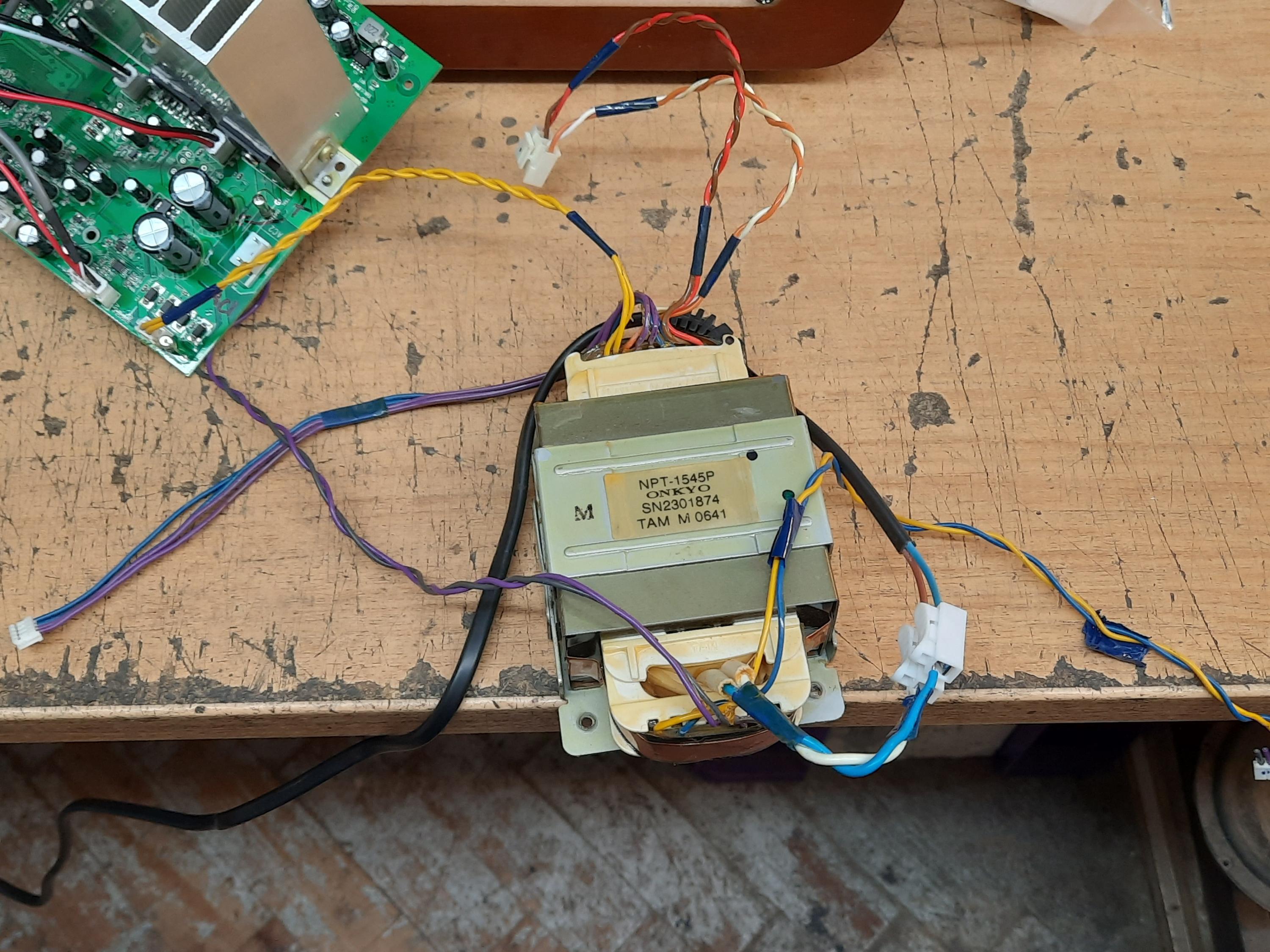

                  Managed to dig out a transformer I had stripped out of an Onkyo AV system years ago, which has load of outputs.
                  12V to AC2
                  10V to AC1

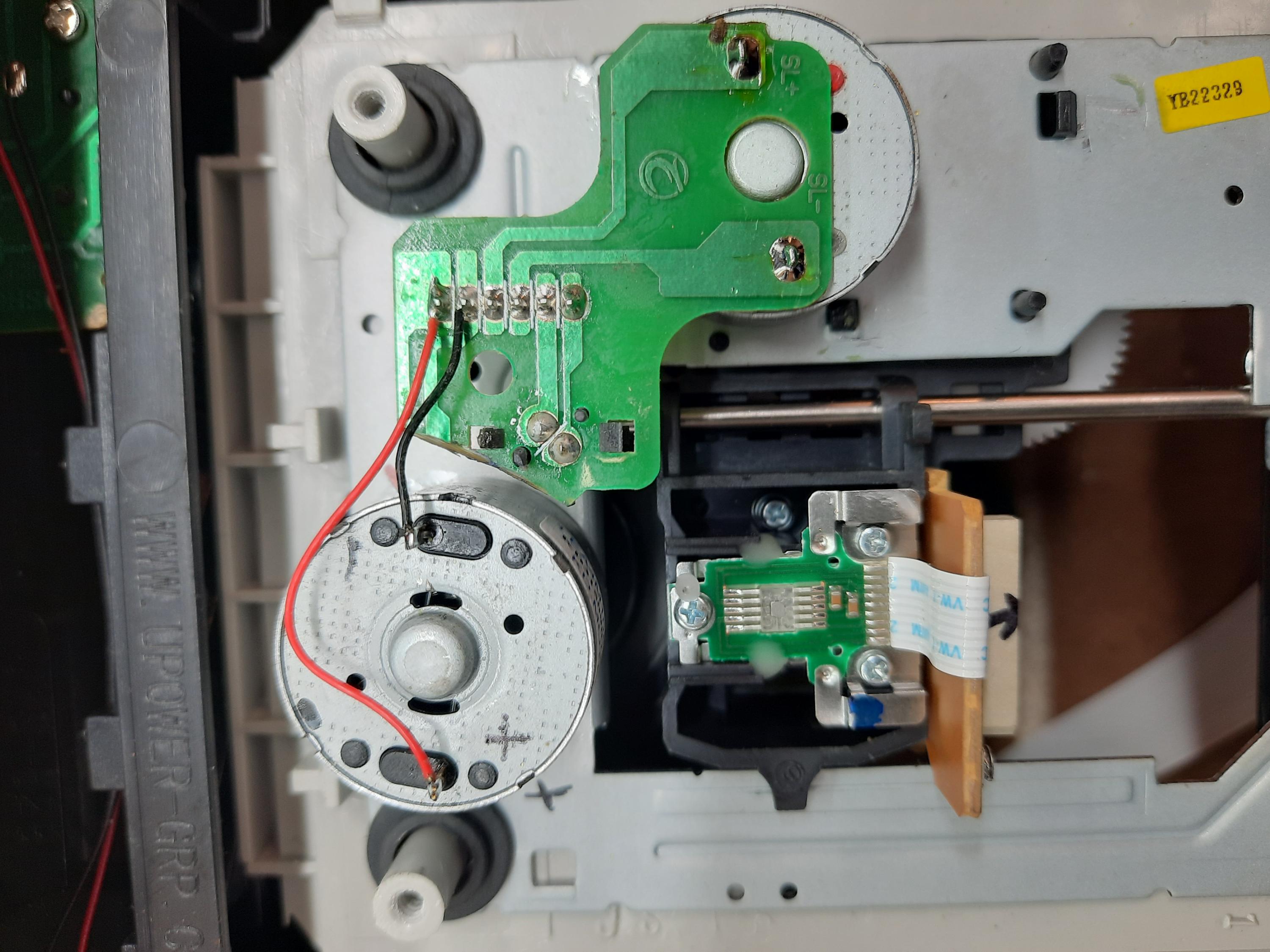

                  Unit then powered with radio and turntable working, but no CD play.
                  Started scratching my head thinking supply not correct, or surge has damaged it.
                  Turned out to be bad contacts on CD turntable motor & a quick spray with some cleaner restored operation.
                  Result finally after a whole day on this beast.

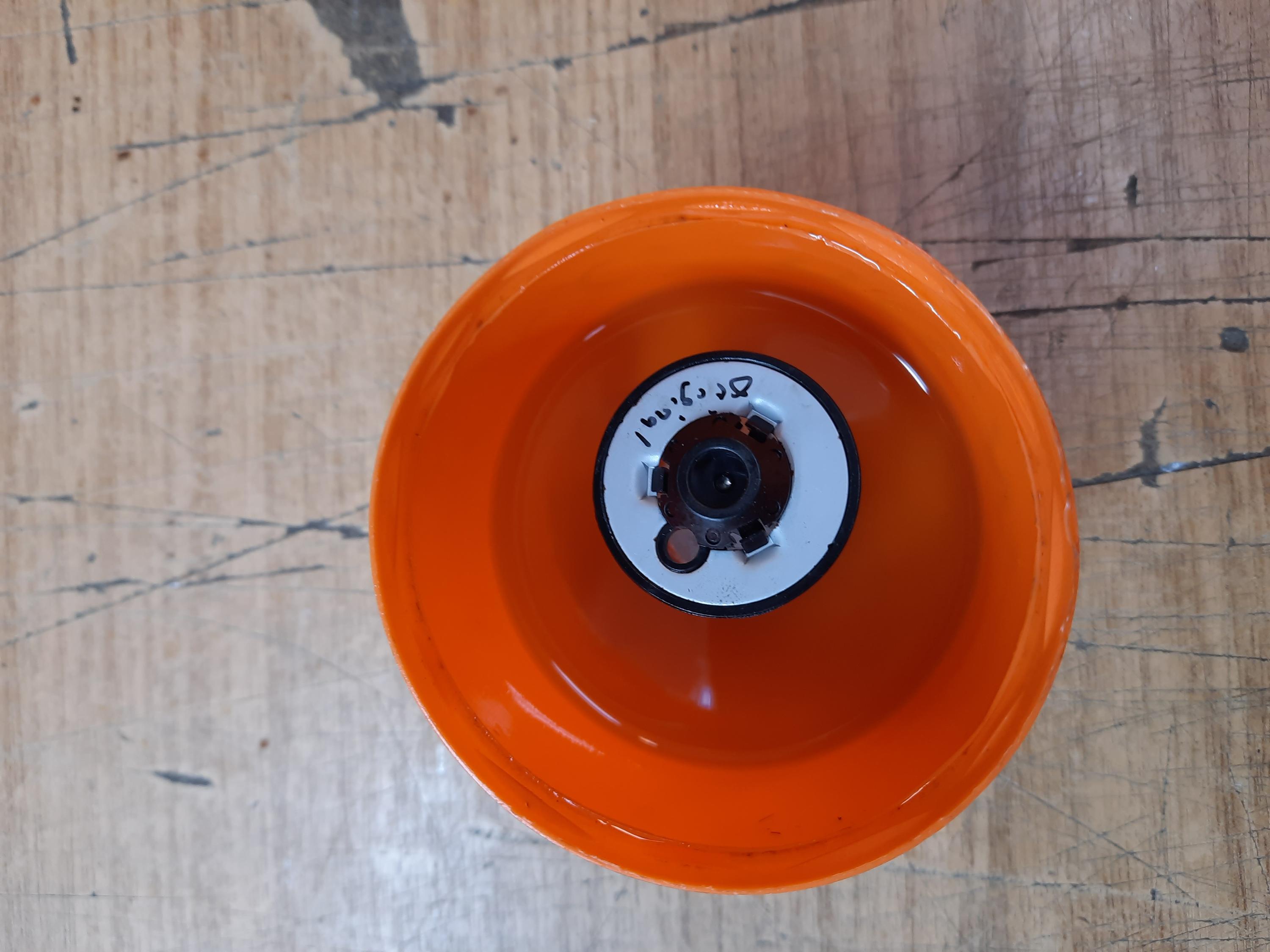

                    Can't believe this unit.
                    Meant to be new, fully working, but CD turntable motor lazy.
                    The turntable motor has no marking to indicate type, therefore modified board to take a physically larger motor, but that didn't work.
                    As a last resort, I have immersed original motor in WD40 & will leave it overnight, which I'm hoping might restore full operation.
                      wd40 is moisture remover,
                      you should use 3-in-1 oil instead.

                          Well tried it all, including injecting very fine watchmaker oil into the motor bearings.
                          This improved the functionality, but not reliable enough.
                          I then started searching for CD mechs that use same reader, which is a Sanyo SF-P101N
                          Found a generic one at ASWO that looked same, except for the spindle & sled motors which were physically larger.
                          Took a chance, as it was cheap enough.
                          Fitted & now working on test.
