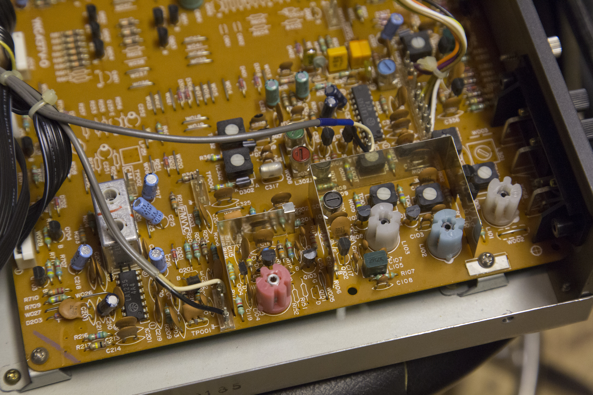

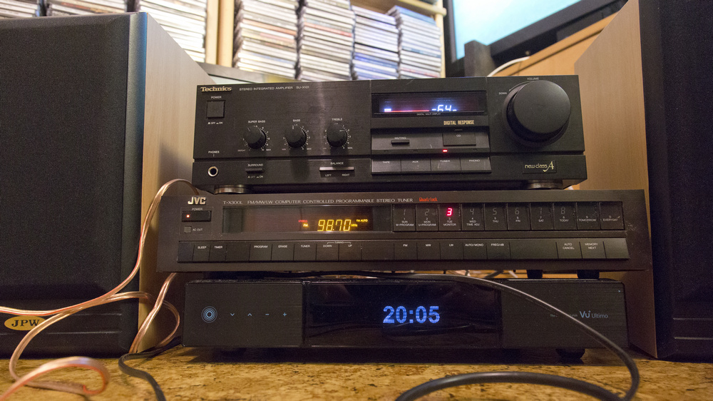

    Does anybody have service manual or schematic for this tuner? It seems to have problem in the tuning section. Tunes 0.05 MHz off and the sound cuts off one in 2 seconds.

    nice, looks a bit like my old jvc
    i'm surprised the backlight still works - i had to change mine.

        Needed to adjust the coils of the stereo decoder, the metal colored dual one on the left.
