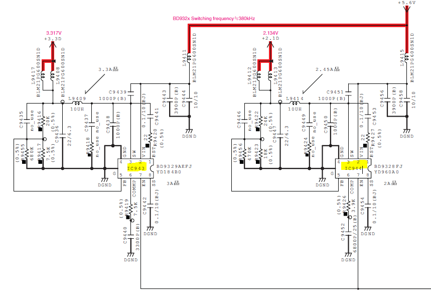

  • MaLe20
    • Feb 2022
    • 4
    • United Kingdom
    Re: Yamaha RX-V677 no response
    I think I am getting close. I started to look into other power sections and I found that on Both IC944 and IC943 there is no Voltage coming out. 5.6 V goes in but nothing goes out. Schematics in the attachment. Any advise more than welcome
    • R_J
      • Jun 2012
      • 9594
      Those ic's both have ENable pins , the ic's are likely not turned on. As for the micro, check the reset circuit.

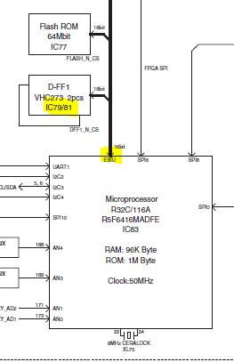

      • MaLe20
        • Feb 2022
        • 4
        • United Kingdom

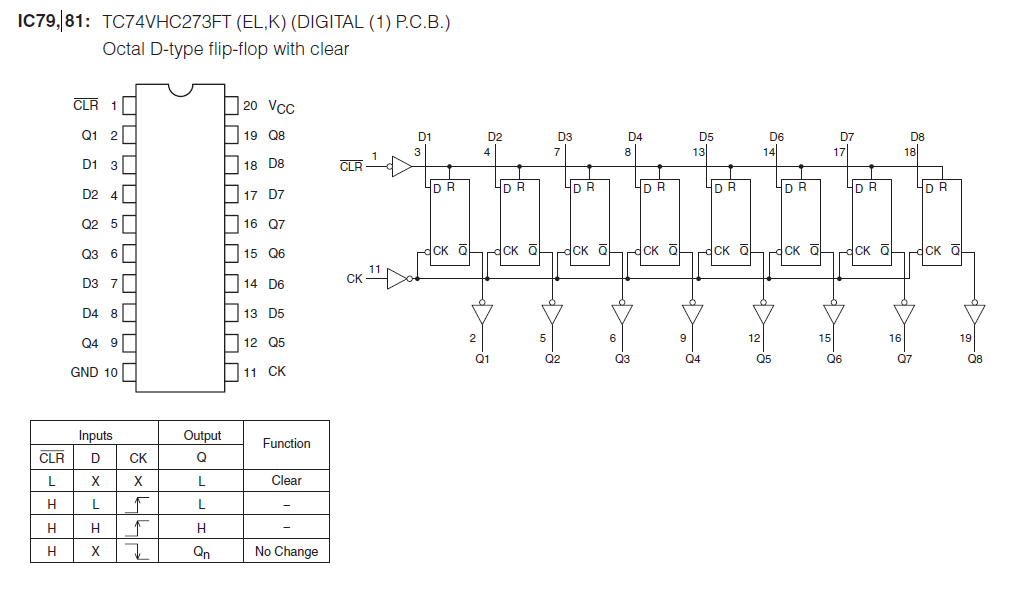

        You are correct lack of enabler to run DC-DC converters. As you said I looked at Reset circuit and I draw attention to DFF_FROM_N_RST line which is connected to D type flip flop IC81. This sends enable signal to DC-DC converters giving other voltages on digital board.
        DFF_FROM_N_RST line comes directly from Microcontroller IC83 pin 92. Signal stays high at this line and D entry on flip flop which comes from same microcontroller is low. If I am correct to get flip flip to pass correct output I need D to be high as well.
        Is there a chance that EEPROM is corrupted?
