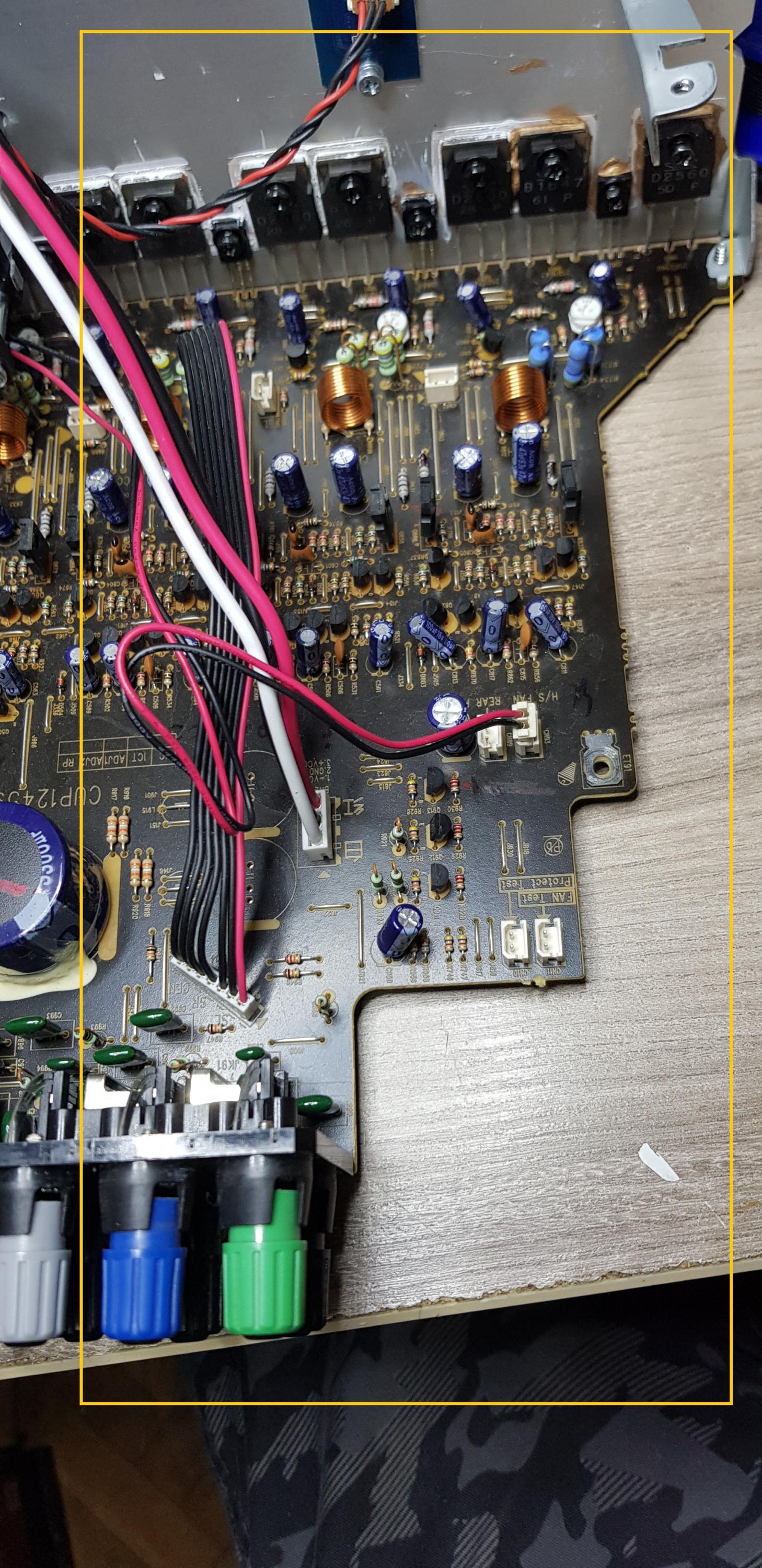

    I see you ordered the transistor, But a 2SC2911 should work also.

      Re: Harman Kardon AVR 370
      Hello receiver repaired thanks for the help
      Parts have been replaced:
      B1647
      D2560
      2W 0,47 ohm
      2SD600K Y TO126 NPN 100V 1A 130MHz
        Hello, today I have speakers and it turns out that one channel in the amplifier, the one that was damaged, plays quietly and creaks, it is SURR.LEFT
          You likely have more damage in the driver circuit. Take measurements and compare against SURR.RIGHT channel.
            Hello, I checked all parts and they look good and the sound still creaks
              Hello, I was able to fix it but I don't know what I did, that the central speaker doesn't work, the receiver does not sound central
