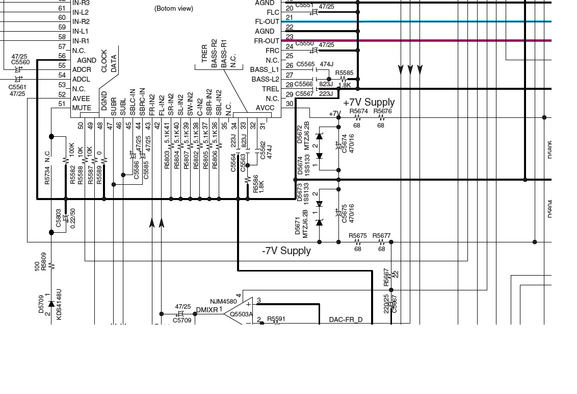

    My receiver stopped playing any sound suddenly. I tried all the entrees and nothing.
    I decided to measure +/- 7V which are responsible for the operation of the R2A15218FP chip, and the + 7V was only +6V. I measured the + 15V and it was only + 14V. The line - 7V, was ok. After many measurements and exchange of some caps, I realized that when I disconnect the turner pack, the + 7V returns to normal, but the -7V drops to -6V. From the tests I did, it does not seem to be a source problem. Any idea? Thank you very much, because this receiver is really hard to repair.

              It seems to be really an electronic problem. I made a table with the V + and V- with the Turner pack and without the Turner pack.
              Should be +22V / -B / +15V / +7V / - 7V
              With Turner pack +20.2V / -31.6V / +8.9V / +1V / -12.7V
              Without Turner pack +27,1V / -26V / +15,5V / +7,5V / -6,1V
              Any suggestion?
              Thank´s a lot.

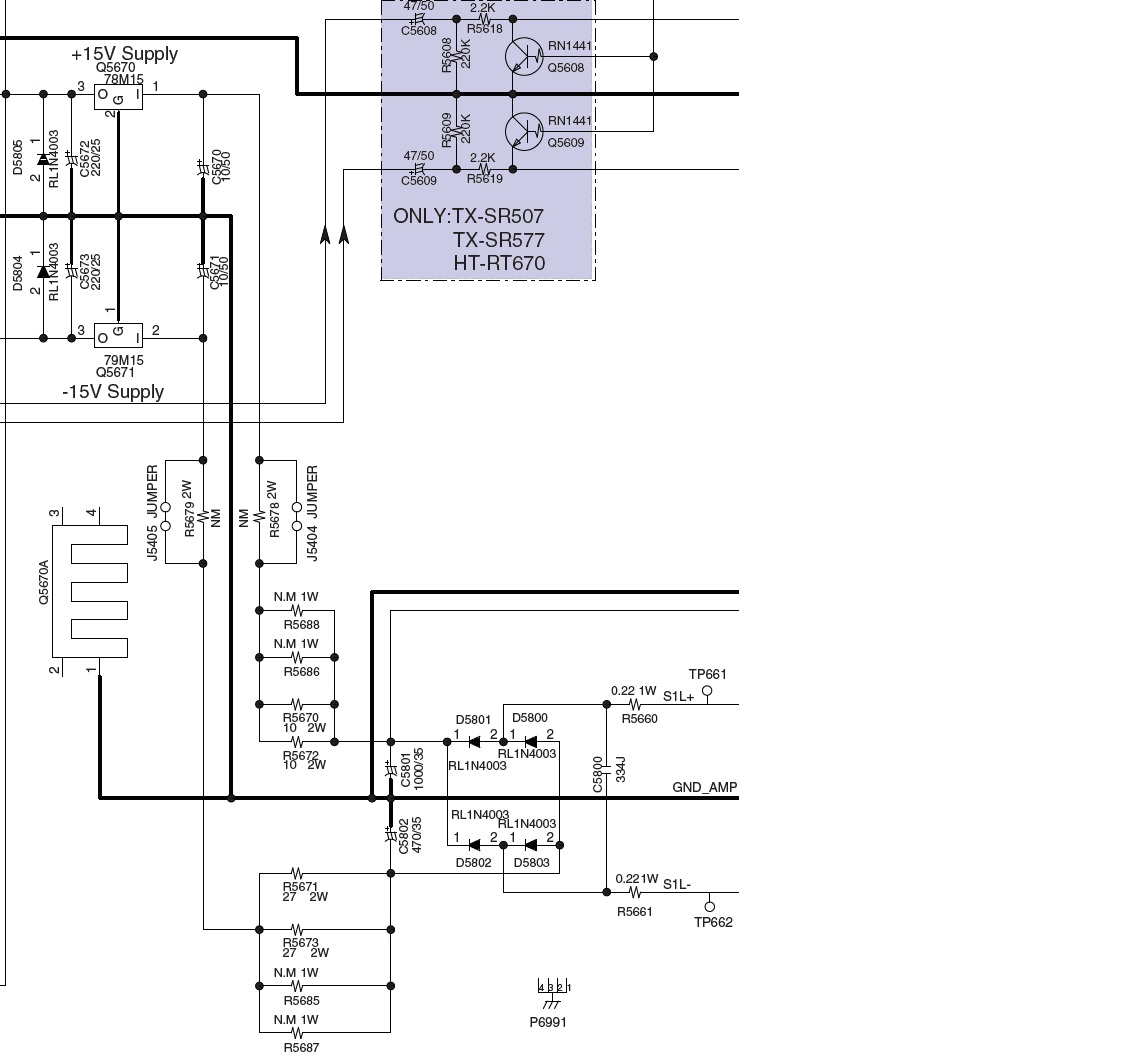

                I forgot -15 V, With turner pack -> -20,5V
                Without turner pack -> -13,8V

                  +- 15V power supply and +- 7V power supply and service manual.

                    The tuner should not effect the NO AUDIO condition. The amp should operate without it connected to P101A and the tuner operates from 9 volts which is supplied via Q111 from the +12 [+15v] volt supply
                    I can't see how connecting the tuner pack would have that much effect on the voltages, unless it's vcc is shorted.
                    If the tuner +9VTU is shorted, that would kill the 9 volts on Q111 and load the +15 volts causing it to drop. or Q111 could be shorted?

                          It almosts looks like an open ground somewhere. If you are working on the amp with it disassembled, it could be a ground path is missing, this happens a lot with these amps, as an example they sometimes rely on the rear plate for completing the ground between some of the boards.

                            [QUOTE=R_J;906254]It almosts looks like an open ground somewhere. If you are working on the amp with it disassembled, it could be a ground path is missing, this happens a lot with these amps, as an example they sometimes rely on the rear plate for completing the ground between some of the boards.[/QUOTE]
                            +1
                            That may explain why you have that strange reading below in your post 8:
                            "I forgot -15 V, With turner pack -> -20,5V
                            Without turner pack -> -13,8V"
                            Most of these rely on metal chassis to complete the circuit ground, that is why it is important to make sure all the board mounting screws are tight.

                              Thank you very much. You are completly right! When I put the 37 screws back into the back cover, all +/- V returned to normal. I was putting some screws back in place to measure. But now the original problem persists: No sound. It all started when I decided to measure the +/- 7V, because for me the problem is in the Q5501 IC that seems not to be working. I do not know how to test it, I started by testing the +/- 7V, and measured + 6V instead of + 7V. I thought this is the problem because this IC works with values between +6.5V and 7.5V, but I was wrong about +7V because now with the back screws I have +/- 7V back on the IC. I do not know if this IC could burn. But the problem appeared after the device had been disconnected for a year. A year before when I turned it off, it was working perfectly, when I turned it on a year later it did not have any sound. I thought: some cap must have dried up. Now I do not know what to do, because changing that IC is not so simple. and I'm not sure if the problem is really in Q5501. Any suggestion?

                                      This signal (AMUT) is controlled by a signal from the Q701 IC called AMUT_COM (I also don't know what this signal means). But I suppose it should act in case the something goes wrong. I don´t know what yet. Any suggestion? Thank you very much.
