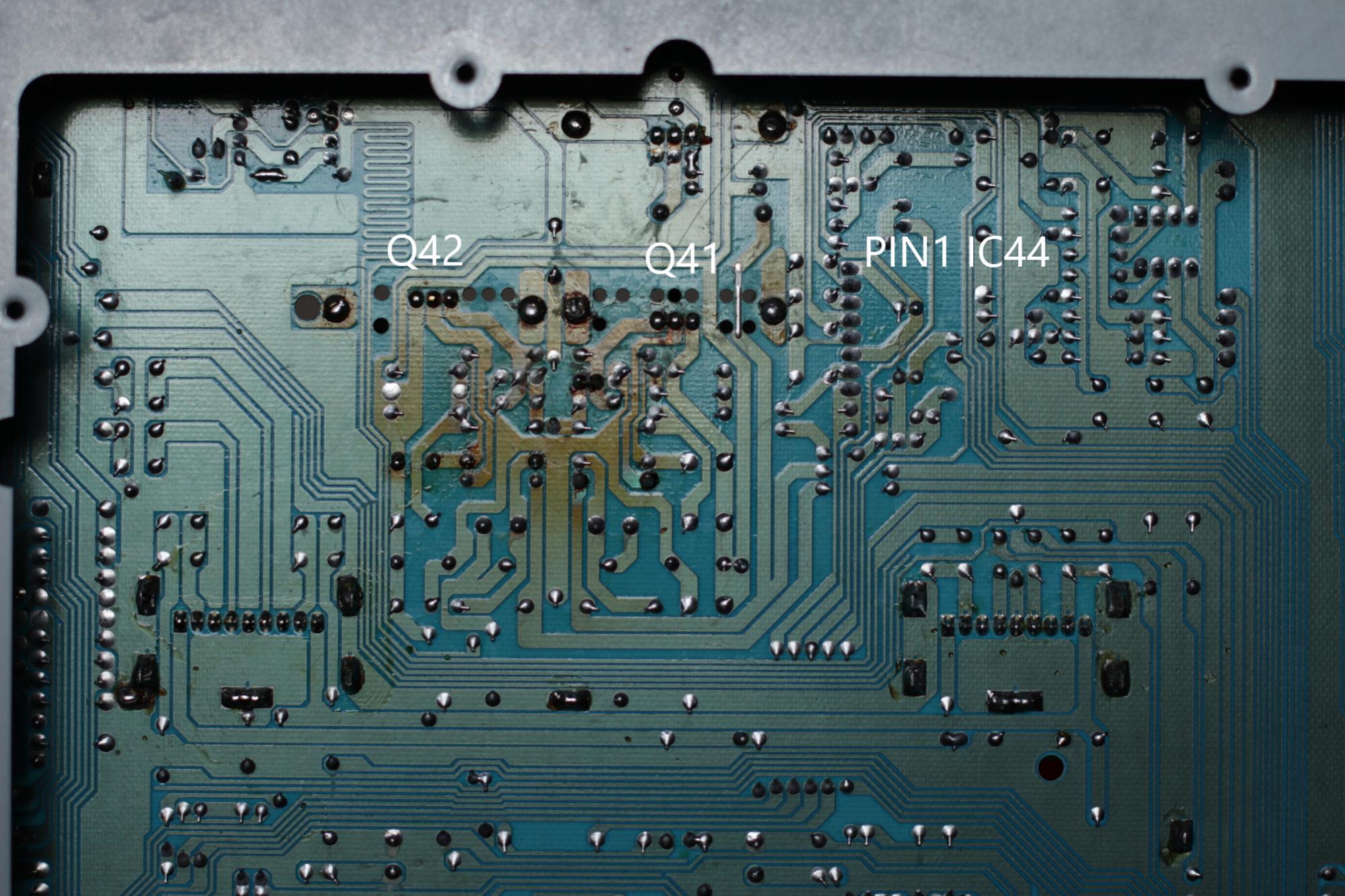

    Hello dear forum members!
    I have a need for your assistance! I have a NAD 320BEE (with the infamous JH capacitors). I have read about them here on the forum and I am now facing issues with my unit. I powered it off with the remote and I thought it sounded a bit louder than usual. And the next morning when powering on, the orange light stayed fixed - indicating something was wrong. Pulled the cord, waited and reinserted the plug and powered on with no luck. Still orange light. Unscrewed the lid. At first I thought the caps in the power supply / filter area had leaked but learned that this is just glue. I do think one of the 15000uF cap is swollen. Maybe some other ones are discoloured on the "mainboard". Could you please advise on what I might be seeing/not seeing? Should I just try to replace the 15000uF 50V capacitors or should I try to recap all electrolytics (with the possibility of shortening something). Previous during the last few years I have been hearing the 50hz hum but thought this was from the potentiometer since raising or lowering the volume made it disappear for a while.
    Thank you for your time and effort!

        Used this and the above service manual. Https://3.bp.blogspot.com/-SShCymnrP...ower%2Bamp.jpg
        The plastic cover is not depressable, a fraction of a mm is all I could get it to depress with use of some (but not extensive) force.
        I did do a bit of measurements, could someone help guide me in what to make of it?
        The orange light means "security". I read on this french blog regarding issues with the security module (google translate) and this gave me some insight.
        I measured CB47 (value specified in schematics)
        Pin 1 -> Gnd
        Pin 2 -> 5.6 V (5.6V)
        Pin 3 -> -38.5 V (-37)
        Pin 4 -> 38.5 V (37)
        Pin 5 -> 0.13 V
        Pin 6 -> 1.75 V --> C421 --> IC 44 PIN 4 [1.75V] (2.0V)
        Pin 7 -> 0V
        CB49
        Pin 1 -> -38.5V (-46V)
        Pin 2 -> -38.5V (46V)
        IC44
        Pin 4 -> 1.75V (2.0V)
        Pin 8 -> 3,23V (3.25V)
        C420 -> 1.98 (2.16V)
        There seems to be a substantial difference on the CB49 (7.5V difference), could this voltage drop be the culprit? Also when investigating the security part of the board on the underside (around Q41, C420, C421 and the resistorbank sourrounding these the board looks a bit discolored (yellow/brownish). Could not wash this of with IPA.
        Thank you for any input!

                I rechecked the voltages on the IC44 nad C420, C421 and C422.
                IC44
                Pin1 0V
                Pin2 80mV
                Pin3 0V
                Pin4 1,75V (specified 2.0V)
                Pin5 0V
                Pin6 0,5V (output)
                Pin7 2,0V (specified 2.16V)
                Pin8 3,25V (specified 3,25V
                C420 - 2.0V
                C421 - 1,75V
                C422 - 80mV

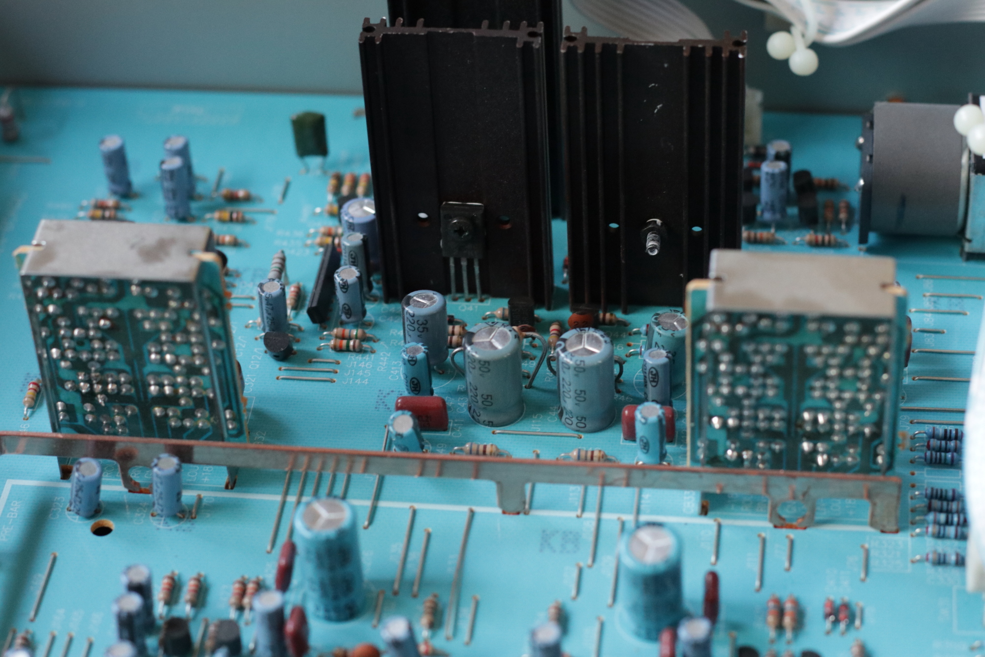

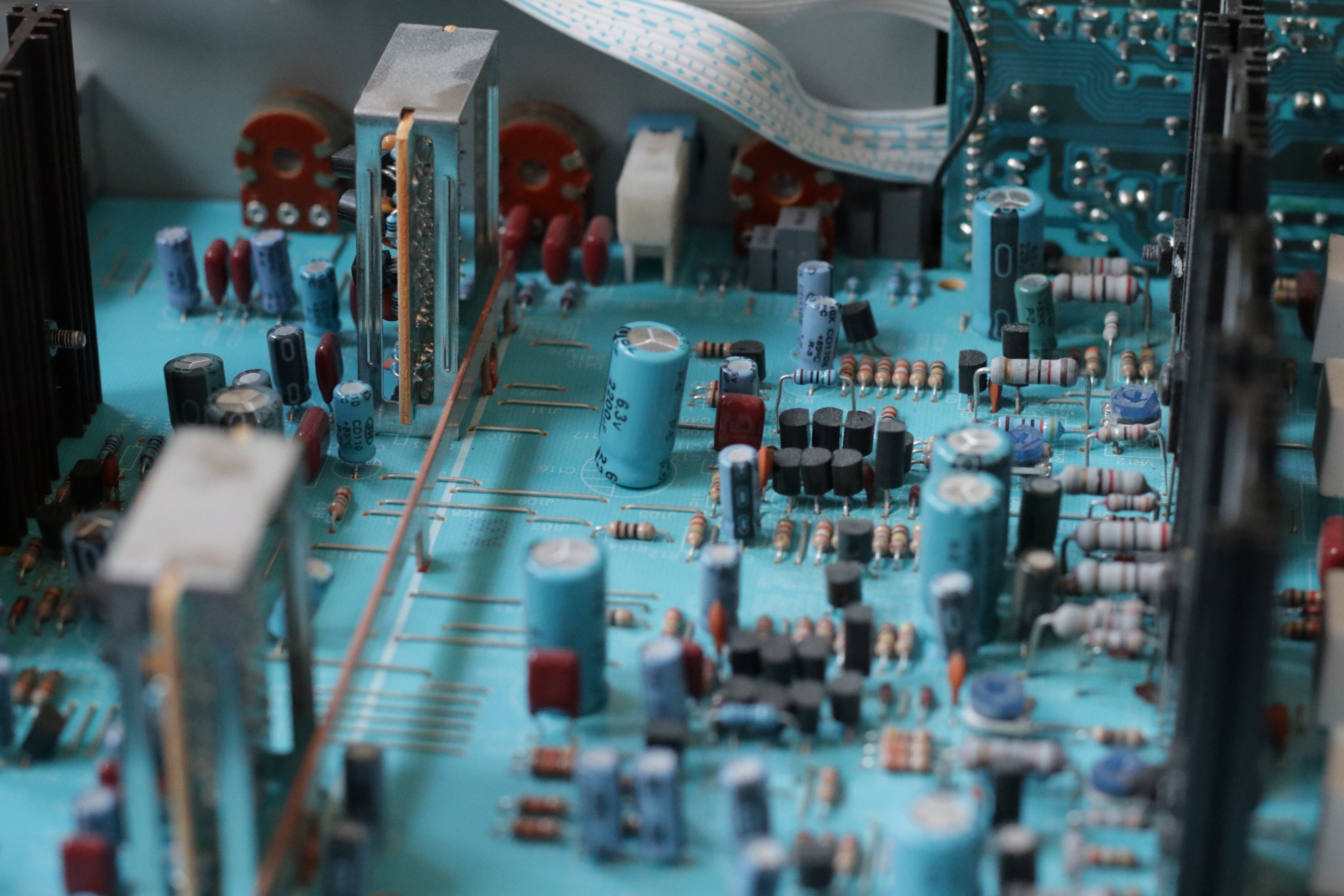

                For the brownish areas please see supplied images. Is it oriented front of IC44 circuit. And looks as it is mostly around the base of the heatsinks of Q41 and Q42 and the resistor/capacitorbank on the left (towards the transformer).

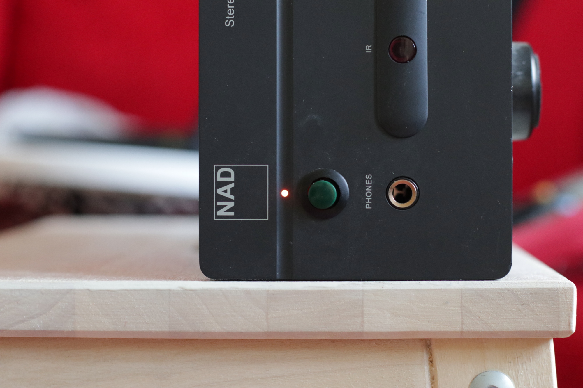

                As of the light. It is the Power light. It is orange. Not red. It doesn't come out of "stand by". No reaction pressing the buttons on the front or the remote. No relay click.
                Any good spots to measure the 18V supply on the board?
                Thank you again!

                  Read this a bit sloppy this morning and forgot about this:
                  Checked the emittors (and collectors) of Q41 and Q42
                  Q41 emittor 0V
                  Q42 emittor 2.5V
                  What I dont understand is that the soldering joints of the heatsinks the transistors are screwed in to are 37V.
                  The diod D043 has 4V both ways. Shouldn't diodes restrict the voltage one way?

                    Q41 & Q42 collectors should have (+/-) voltage, if there is no voltage on either collector, check Resistors, R447,R449, then check R45,R46
                    You can check for + & - 37 volts on plug CB47 pins 1 & 2
                    Q41 collector should have positive voltage, Q42 collector should have negative voltage
                    what is "diod D043" Where is it located?

                      Hi!
                      Checked!
                      R45 38,7V
                      R46 -38,5V
                      Haven't found R447 or R449, yet.
                      CB47
                      38,5V and -38,3V
                      Misread the diode, it's D403.
                      Will locate R447 and R449.
                      Anything of this makes sense?

                        Don't worry about R447/r449, if you have voltage on R45/R46 thats good
                        I would check the caps and resistors around Q41 & Q42, You should have +18v on Q41 (E) and -18v on Q42 (E)
                        If the caps in that area are bad I suspect you will not have the +_18v
                        Still can't dind D403
