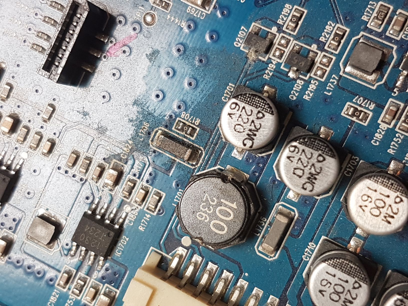

        I was taking a better look at the CUP12457 board and noticed a smudge on it.
        tested the Q2107 and belive it's broken, in the manual it's marked as
        RT1P144C(PNP,SC-59,SISAHAYA
        found the datasheet
        https://pdf1.alldatasheet.com/datash.../RT1P144C.html
        I can't find it for sale on either Mouser or farnell, any one know a suitable replacement for it?

              Re: Harman Kardon AVR 270
              A DTA114, should be the same, digikey DTA114EKAT146CT-ND What do you mean by broken? It will be hard to test with a meter due to the internal resistance, I doubt it is the cause of the problem
                Thanks for that, I noticed that R1 and R2 have the resistance of 10k in the DTA114, but the RT1P44 has the resistance of R1 10k and R2 47k, is that ok?
                I thought it was broken because the Diode function on my meter gave me no readings and
                Positive probe on collector gave me a reading of 6.05M ohm on both Base and emitter
                Positive probe on Emitter gave me reading of 60k ohm on Base, same result with positive probe on Base.
                And I managed somehow to break one of the leads :/ on the other one.

                  All similar https://www.digikey.com/products/en/...pre-biased/292
                  This should be better SMUN2114T1GOSCT-ND https://www.digikey.com/product-deta...SCT-ND/9087746

                      it is what is refered to as a digital transistor
                      This is what it should read (e-c, b-c open)
                      47k +10k = 57k (very close to 60k which is correct
                      I would say it was good

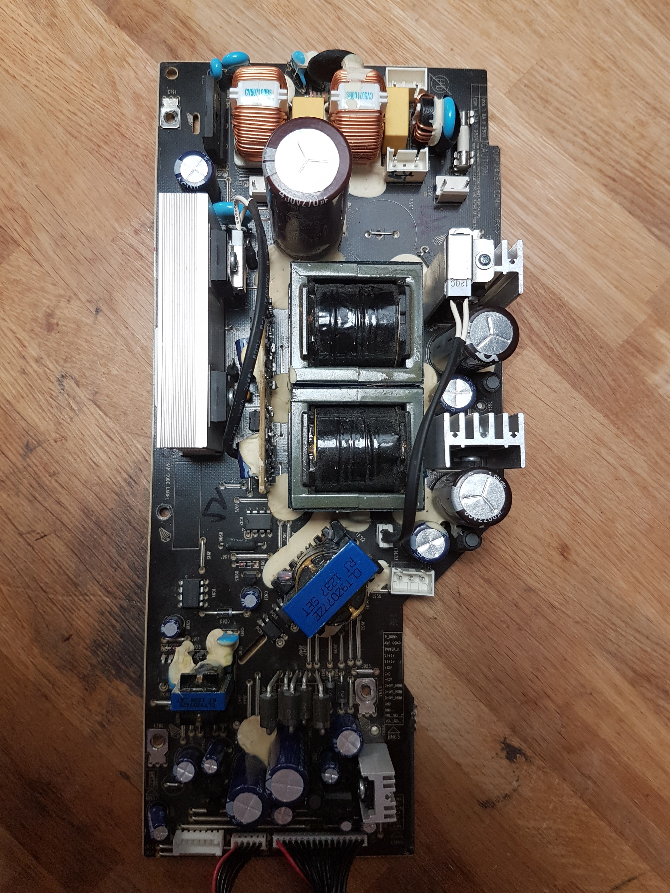

                          Re: Harman Kardon AVR 270 - No power
                          I received the parts today and soldered them in.
                          Now it still won't power on, just like it did before I took it apart.
                          The orange power light turns white for a second then returns to orange.
                          I can hear a faint noise coming from the SMPS PCB, like it's trying to start but can't.
                          The noise seems to be coming from those two big black transformers or near them.
                          The Ceramic caps C984 and C983 were really dark so I replaced them, saw it somewhere that if those caps are gone the AVR would have the same symptom as I had/have.
                          Any one know what might be wrong?

                            You seem to be making it worse, In post one the zone 2 was working and your fault was with zone 1, and now nothing is working correct?
                            If the amp was working with zone 2, why would you change parts in the power supply? this makes no sense.
                            Did you just change the two 471/1kv caps in the power supply so far?

                                Hi, sorry, I guess I wasn't clear enough in my post, my bad.
                                The problem started at first with the zone problem, when I was checking it's settings out, it went to standby mode suddenly with a slight heat smell, after that it did not want to turn on again.
                                I was so sure that these caps were the problem since they looked burned, so I just asked about the zone problem here.
                                If I remember right, I heard some low crackling noises as I connected the speaker, just like it usually happens when you connect a speaker.
                                When I was putting it to gather I noticed that some of the large transistors on the large heatsink had been changed, and the repairman seems to have a little brute on the heatsink fan connector, as
                                the two pins were trough the PCB and ripped the connections under it, But I believe I've managed to repair it. The fan connection is located on the sound output board.
                                Yes I only changed the two 471/1kv caps.
                                I checked the VCC-/+ on the SMPS PCB the resistance started from 0.5k Ohm or so and just raised on both +and -, as if the DMM was charging it, stopped measuring at 2k Ohm
                                When I switched the Unit on the volts seemed to reach 50-55V + and -, just for a part of a second.

                                  Your power supply is working ok, I suspect there is a fault in one of the amp output sections. place your meter probes on each speaker output terminal and turn on the amp, you should see 0 volts, if you see more than a couple volts on any of the speaker output terminals, that section has a fault, you will likely need to power of the amp between each speaker test as the amp will shut down.
