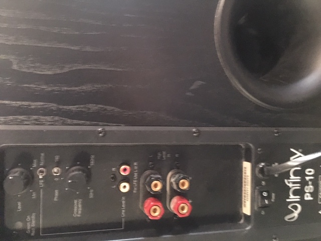

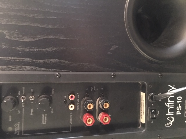

    I hope I am in the correct forum as I am new to BADCAPS.NET. I have an Infinity PS-10 Subwoofer and I am trying to figure out how the separate the amp section from the plastic box it sits in. I removed all the screws around the plate and was able to pull out the Amp box. It is enclosed in a black plastic box and I am not sure if I need to remove any other screws for example, the four around the left and right + and - inputs, or the screw near the power cord, etc. I have a copy of the repair manual, but the blow up does not show the amp box assembly other than then whole box. I want to go in and check the capacitors, resistors, etc. I hope some can help me out.

    Show some pictures of this unit font and back and side to side

        Post YOUR PICTURES so we can see what you are talking about

          Re: Infinity PS-10 Subwoofer Disassembly
Name:	Screen Shot 2018-11-12 at 8.03.55 PM.png
          [ATTACH]185808[/ATTACH]
          [ATTACH]185809[/ATTACH]
          [ATTACH]185810[/ATTACH]
          [ATTACH]185811[/ATTACH]
          [ATTACH]185812[/ATTACH]

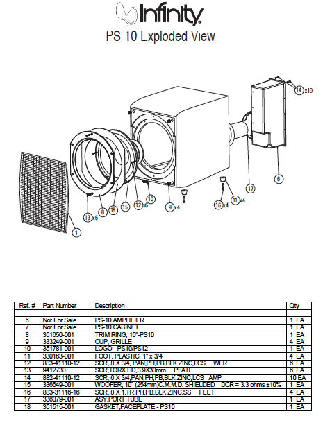

          In the exploded view, the item marked 6 is the plastic box that has the amp, boards, caps, etc inside. I can remove the entire amp plate section but not sure how to separate if from inside the plastic enclosure? Thanks in advance for any help. Joel

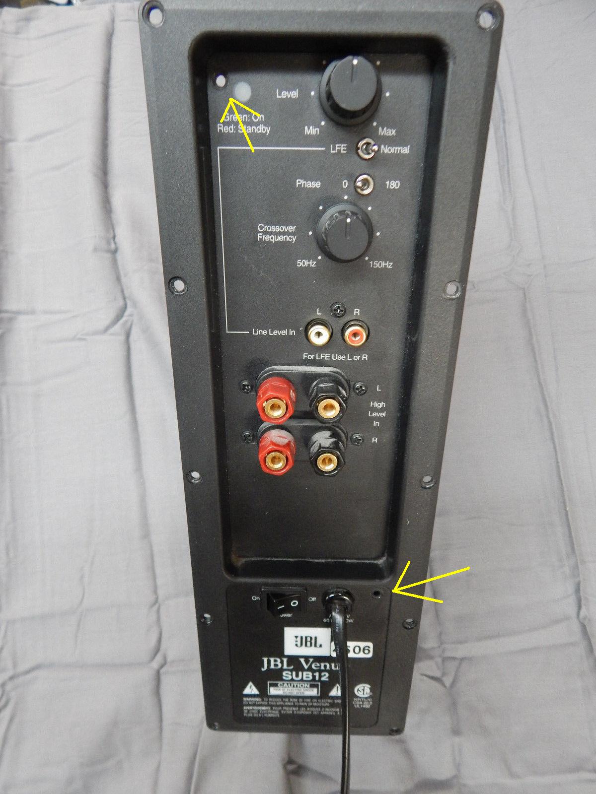

            It looks like there are two screws to remove and the cover should come off

              As shown in the image, there are 10 screws that once remove allow you to pull out the entire amp section. With that said, it is encased in the plastic box. It is that box that I cannot figure out how to remove to expose the electronics. Not sure what 2 screws you are referring to. Have you done this before or do you see which 2 screws from the image? The exploded view from the repair manual does not show them other than the 10 to remove to get the entire box out of the sub case itself. Thanks, Joel

                I did not see the thumbnail that was attached. I will try to remove the 2 other screws and see if that works. I will let you know and thanks for your image. I feel like an idiot not having seen that image. Thanks again!

                  That did the trick. Thanks so much for your outstanding help!! Now I can start taking measurements to ensure the unit is sound!
