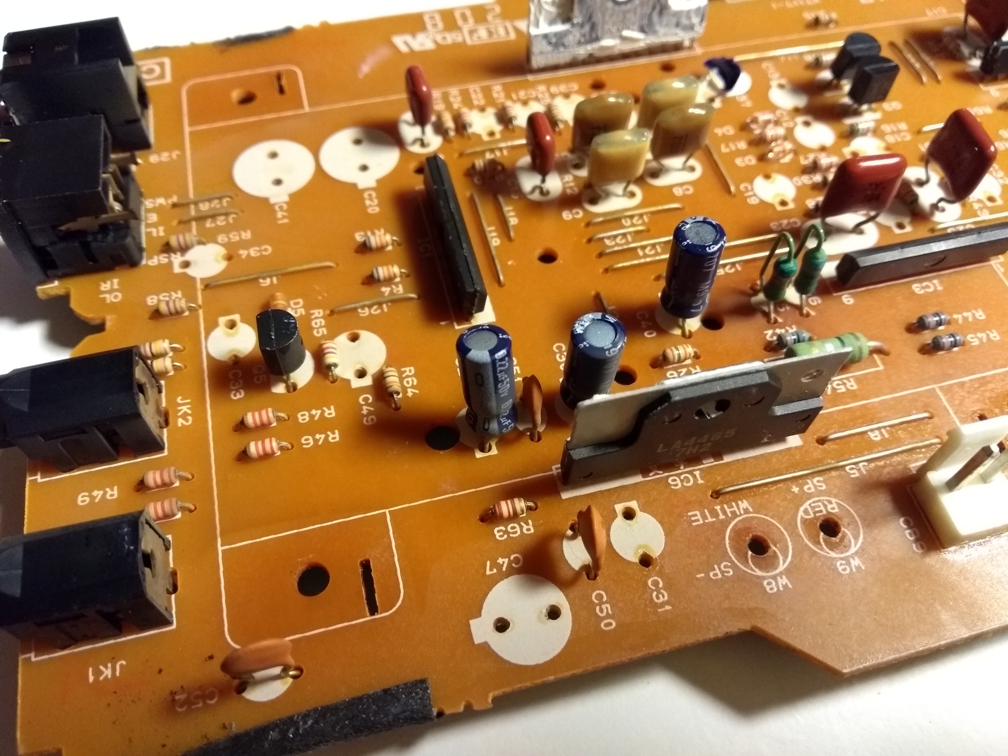

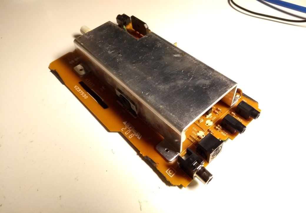

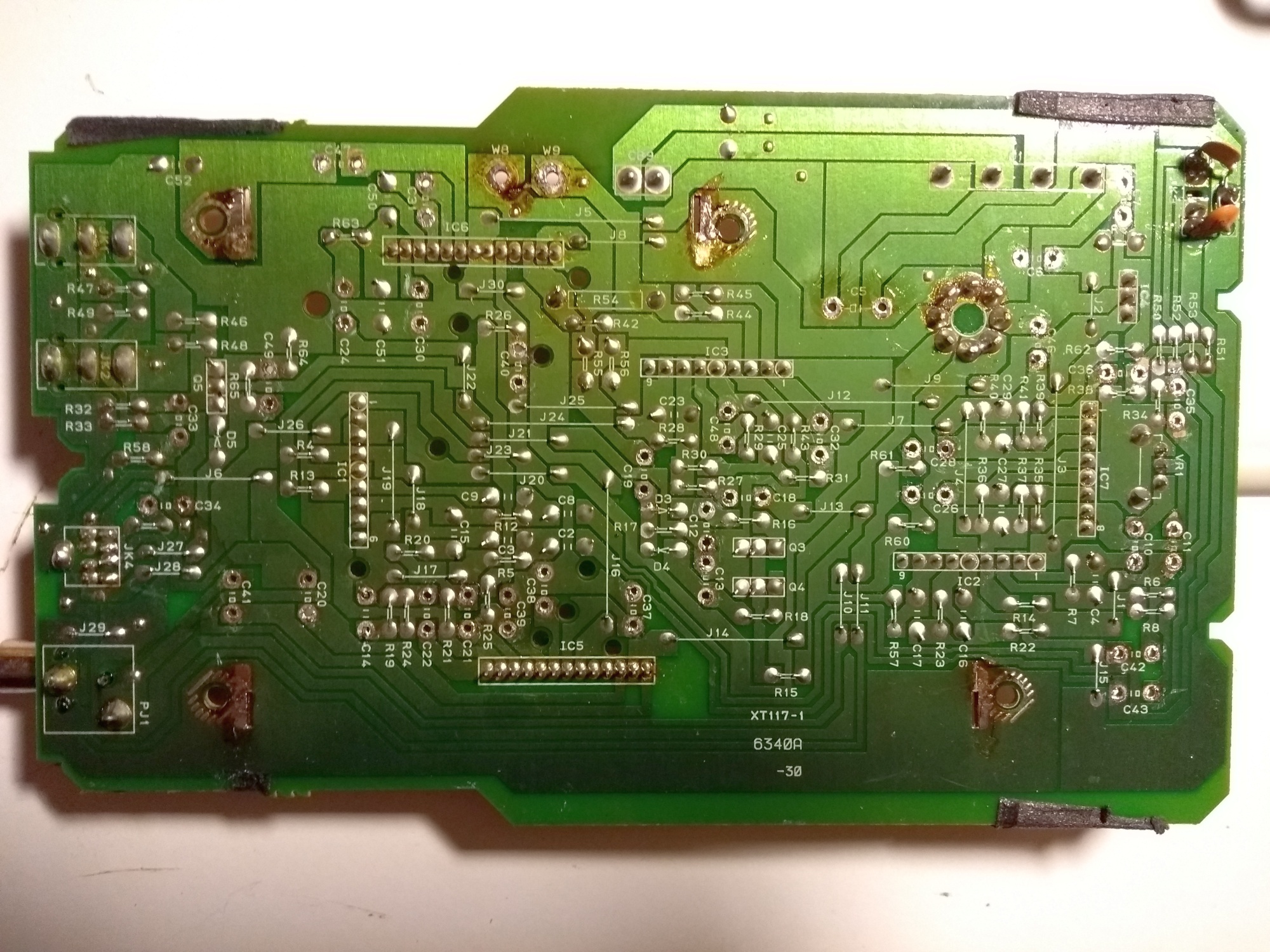

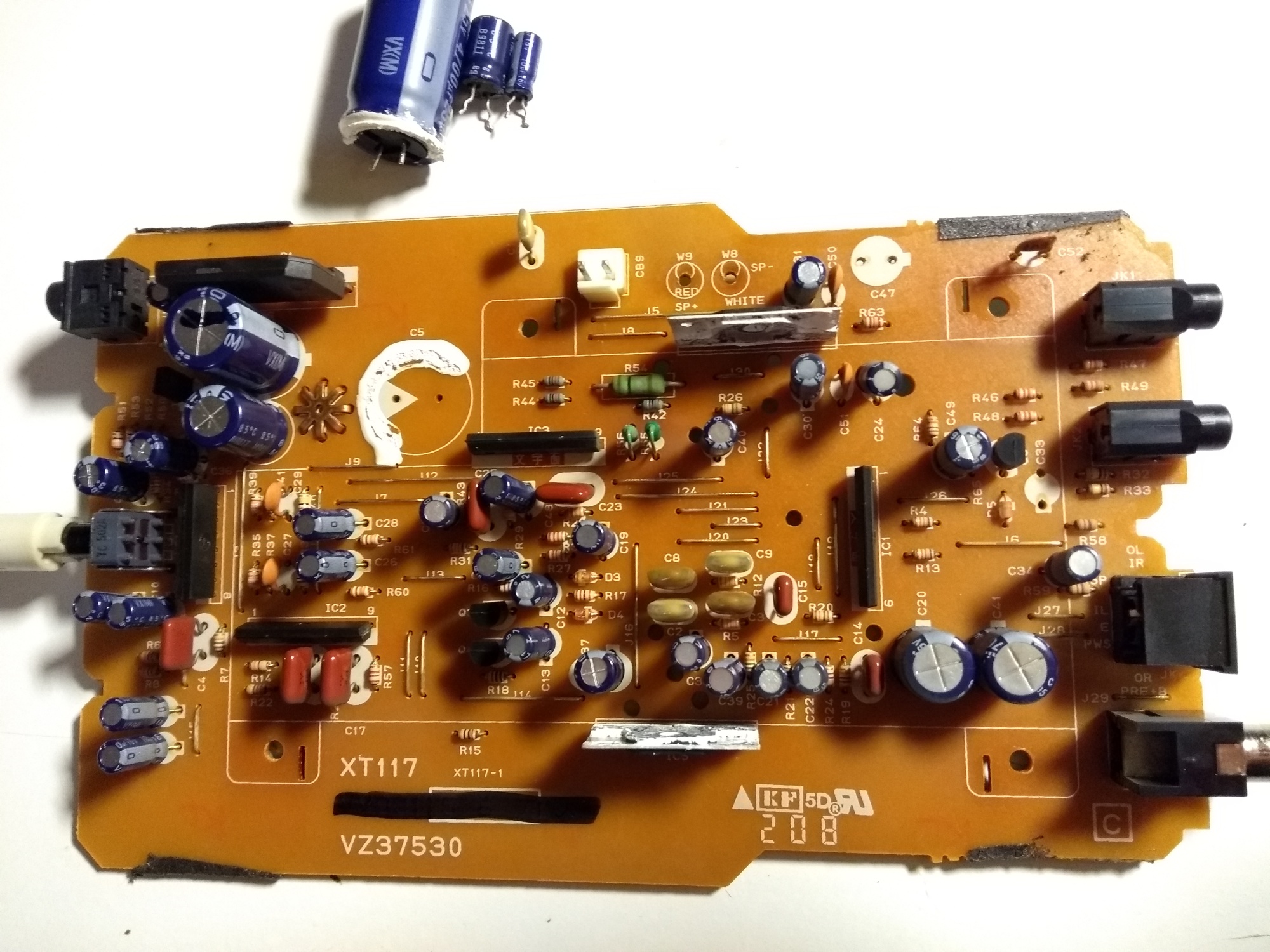

    Hi there, I'm working on the 25W amp board of a Yamaha YST-MS25. It's 20yrs old.
    Since a few months the volume on the left channel is way too low. It turned out that - compared to the intended use and the former price tag of this thing - they put solid stuff into it. So I decided it's worth a recap.
    The board uses two amp ICs on opposite sites of the board. Both ICs are connected to the same heatsink. The heatsink unfortunately is a bridge-like construction that covers almost all other components, including the majority of the caps (pictures and schematics below).

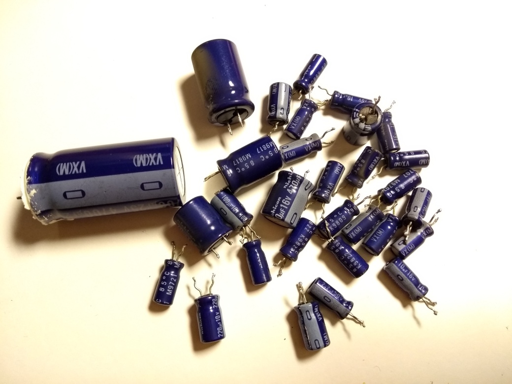

    All 30+ electrolytics were Nichicon VX, old radial series, general purpose, 85°C, now out of production. Most of them measured ok.
    The two 470 uF on the satellite outputs (C20 in H3, C41 in J4) both had only 420 uF. Maybe they came like that from the factory.
    Some of the 10 uF/16 V had an ESR 2.5 times higher than other 10 uF/16 V. They are probably dry.
    I'm going to replace all electrolytics with Panasonic FC. Unfortunately Panasonic and others stopped production of very small values for some variants. Currently smallest FC is 2.2 uF. But smaller ones are required as well.
    As 1uF I can get my hands on Panasonic NHG, Chemi-Con KMG or Rubycon PX.
    For the 0.22uF ones I couldn't get hold of anything suitable, only found crap caps or old stock that's out of production since years and sold at exorbitant boutique prices.

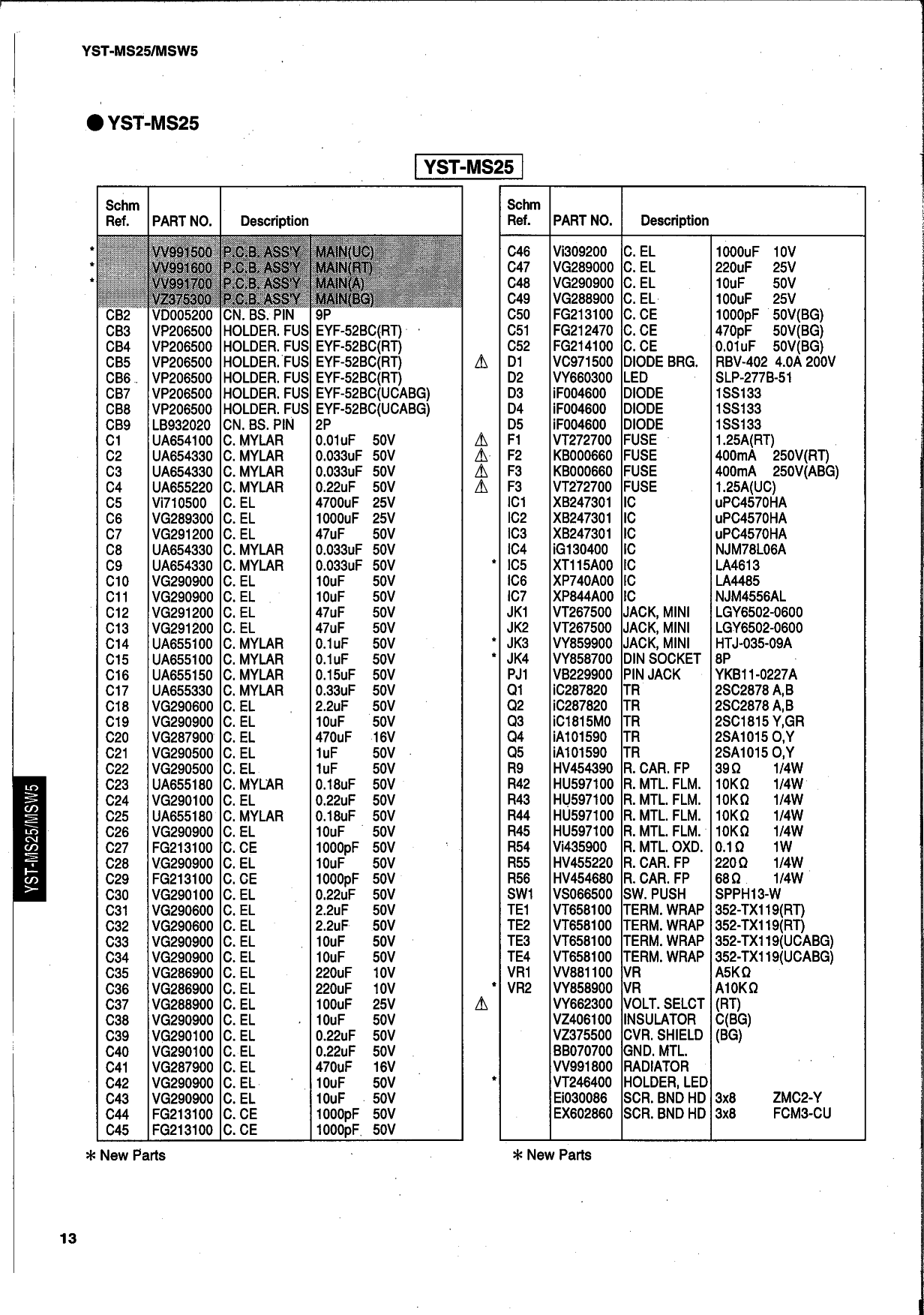

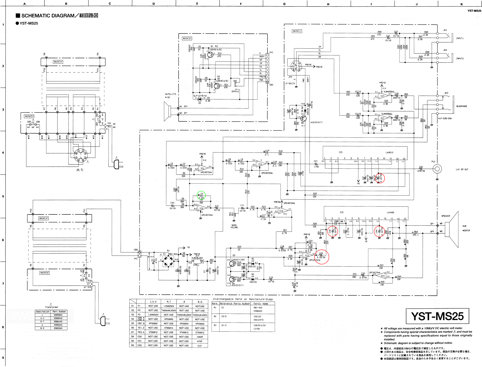

    Four 0.22uF electrolytics are in the Yamaha schematics, red circles:
    C24: sub amp IC6/LA4485 (runs in bridge mode) channel 1 input capacitor
    C30: sub amp IC6/LA4485 unused channel 2 to ground
    C39: sat amp IC5/LA4613 standby supply capacitor
    C40: sub amp IC6/LA4485 standby supply capacitor
    According to the LA4485/LA4613 datasheets increasing these caps isn't a good idea. So I'd like to keep them at 0.22uF.
    Should it / is it possible to replace these 0.22uF electrolytics with another type, like ceramics or <...>? If so, which ones?
    The LA4485/LA4613 datasheets do not mention any cap types, however, in all example circuit drawings they used the sign for polarized caps.
      Not surprised. Those older solvent-based electrolytic caps last a very long time. I rarely replace them unless they have been exposed to excessive heat for a long time. (Think: darkened/burned PCB and such.)
      That's fine.
      Electrolytic caps have a 20% tolerance rating usually. So for a 470 uF cap, anything in the range of 376-564 uF is still in spec, technically.
      For 5x11 mm caps, it's not uncommon for them to read 1-3 Ohms ESR, but check the datasheet anyways. Only when their ESR goes higher than that I consider replacing them. I have 10's of different 100 uF 16V GP 105C caps reading about 1-2 Ohms. So it's more or less normal. For low-ESR type caps, of course, the ESR should be lower.

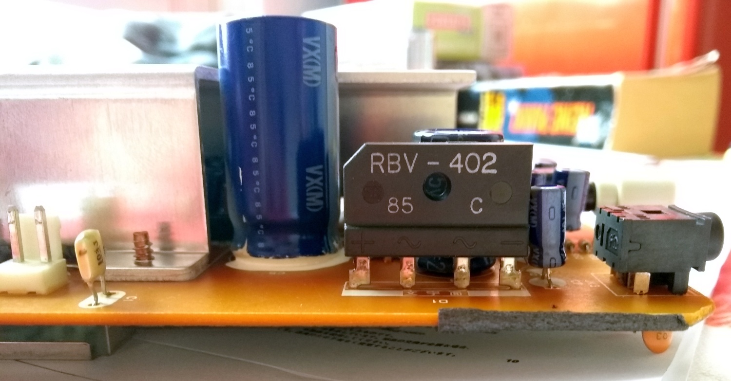

        The area below the large heatsink - almost the whole board - is darkened, it's not really visible on the pictures. Airflow in the box is the bare minimum, maybe less, there were small 85°C caps next to hot ICs and resistors. But yeah, seems at least replacing the 4700u and 1000u PSU filter caps was probably not necessary.
          Well, if you already did, that's fine. Just keep the old ones as spares in case you run into another amplifier (or other device) that needs a recap. In a pinch, they will do.

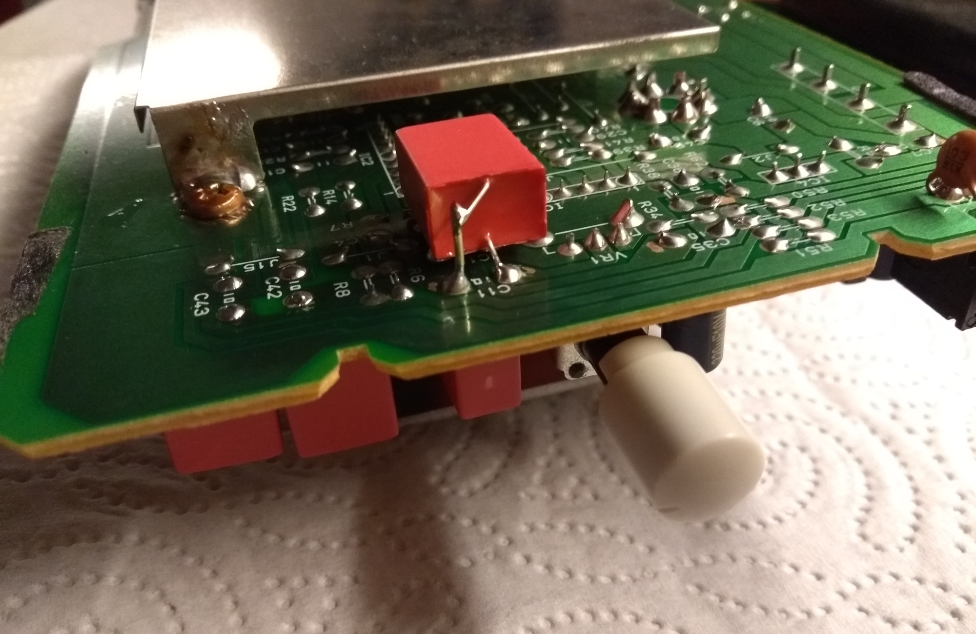

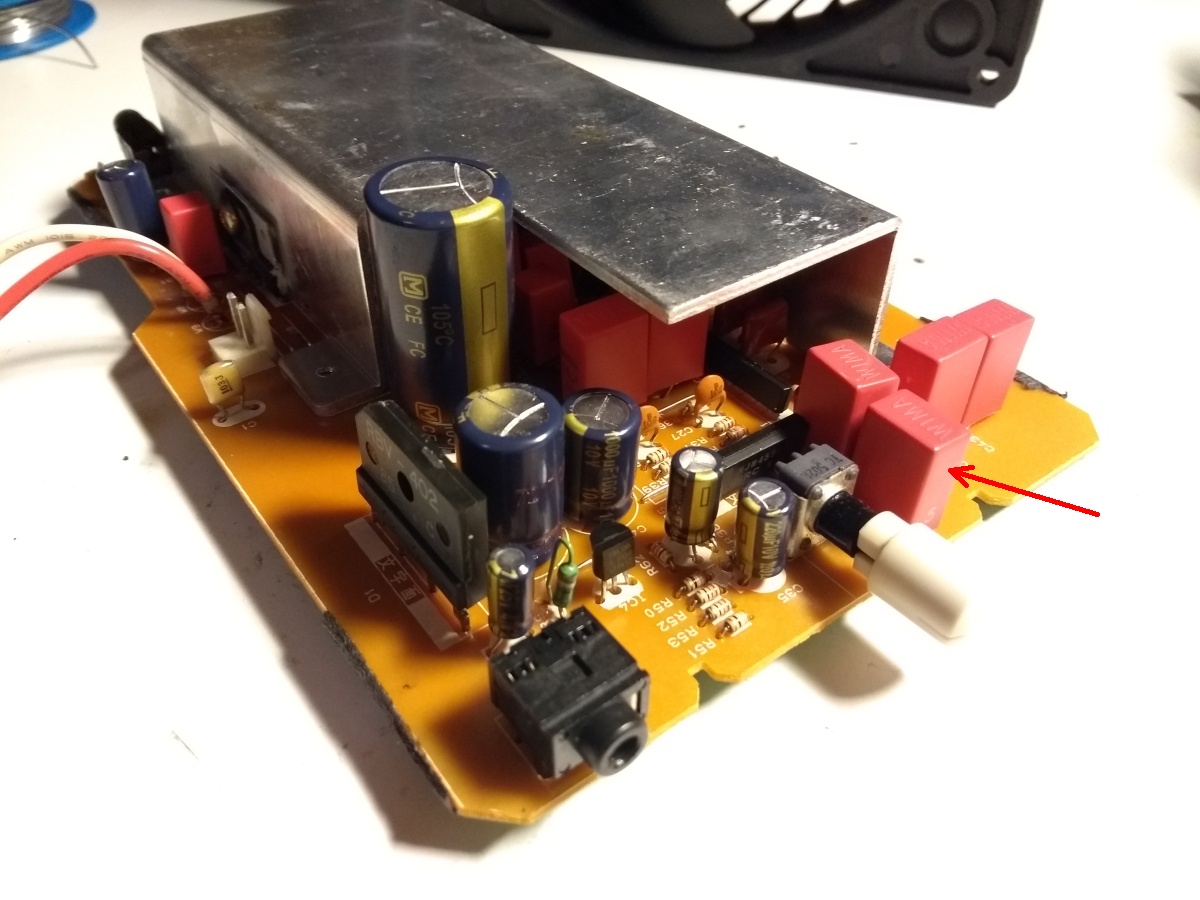

            Replaced all electrolytics up to 10uF with PET films, the others with Pana FC.
            It is (well, it was ) fixed. Left channel working fine again.
            The signal path between input and power amps now contains PET films only, the remaining signal-path-electrolytics - now FCs - are between the power amps and the speakers.
            My impression is that actually the sound is a little different, less bass, treble is about the same. All subjective, no science. If this comes from the now-films-only-in-the-pre-amp-section or the now-FCs-after-the-power-amps or old caps getting replaced with new ones or my ears getting older or the current phase of the moon - I have no idea. And I don't care. After all it's not a boutique hifi device. But it's fixed. And the new caps are rated 105°C.
            Unfortunately it worked for the 10 minutes test only. After putting it back together the sub channel was gone. It turned out the "click" noise when tightening the screws was not the sound of the PCB snapping into the front panel holder. It was the sound of legs being ripped off a cap.
            While getting creative with leg-bending to fit the bigger film caps I forgot about the space required to mount the PCB. The red cap (arrow) was in the way of the mounting slot, it was pushed against the second red one, both legs of the second one snapped.
            But the PCB is ok, nothing else was damaged, will get two new caps and put one to the bottom side of the PCB. It will fit. Also when mounting the PCB. I checked. Twice.

                  Yes, since replacing two replacement caps with replacement caps it's working fine again.
                  The initial reason for the left channel volume drop was probably one of the very small old caps around the pre-amp. Couldn't measure all of them, my ESR meter only handles caps >= 1uF.
                  The new solder joints are ok and shiny, the camera is just crap.

                    The IC12 chip LC9116A-105 (red marked) remains under suspicion yet.
                    But it is custom YAMAHA's chip, and I can't find any information about it.
                    Maybe somebody came across with the same issue?
                    Any information will be very useful. I will be very appreciated.
                    Thank you....
