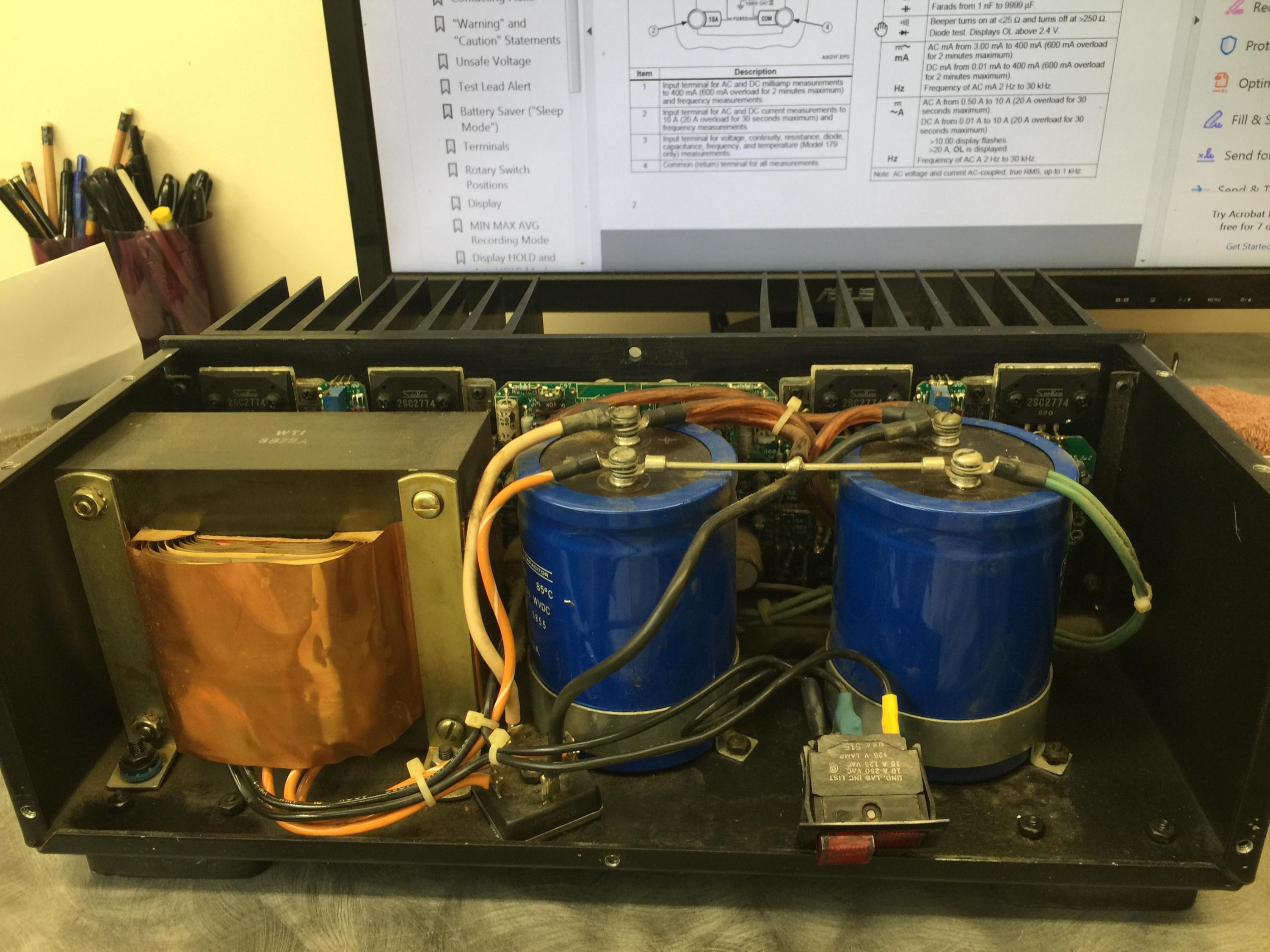

    I have an older Electron Kinetics Eagle 2C amp from the early 90's. It was assembled and inspected around mid December, 1992. One channel has gone out. I tried contacting the company through email, and also called, but have yet to get an answer! This has been a couple of weeks now. I have also tried searching for a schematic for this amp, but no luck!
    I'm thinking it may be a bad cap or caps, and also wondering if the transistors may need to be changed as well? The transistors that were used in this amp were from a Japanese company called Sanken. They are still in business, but I'm not sure if they still carry the OEM transistors used in this amp. I would guess that they should have a direct replacement. I will write to them and ask.

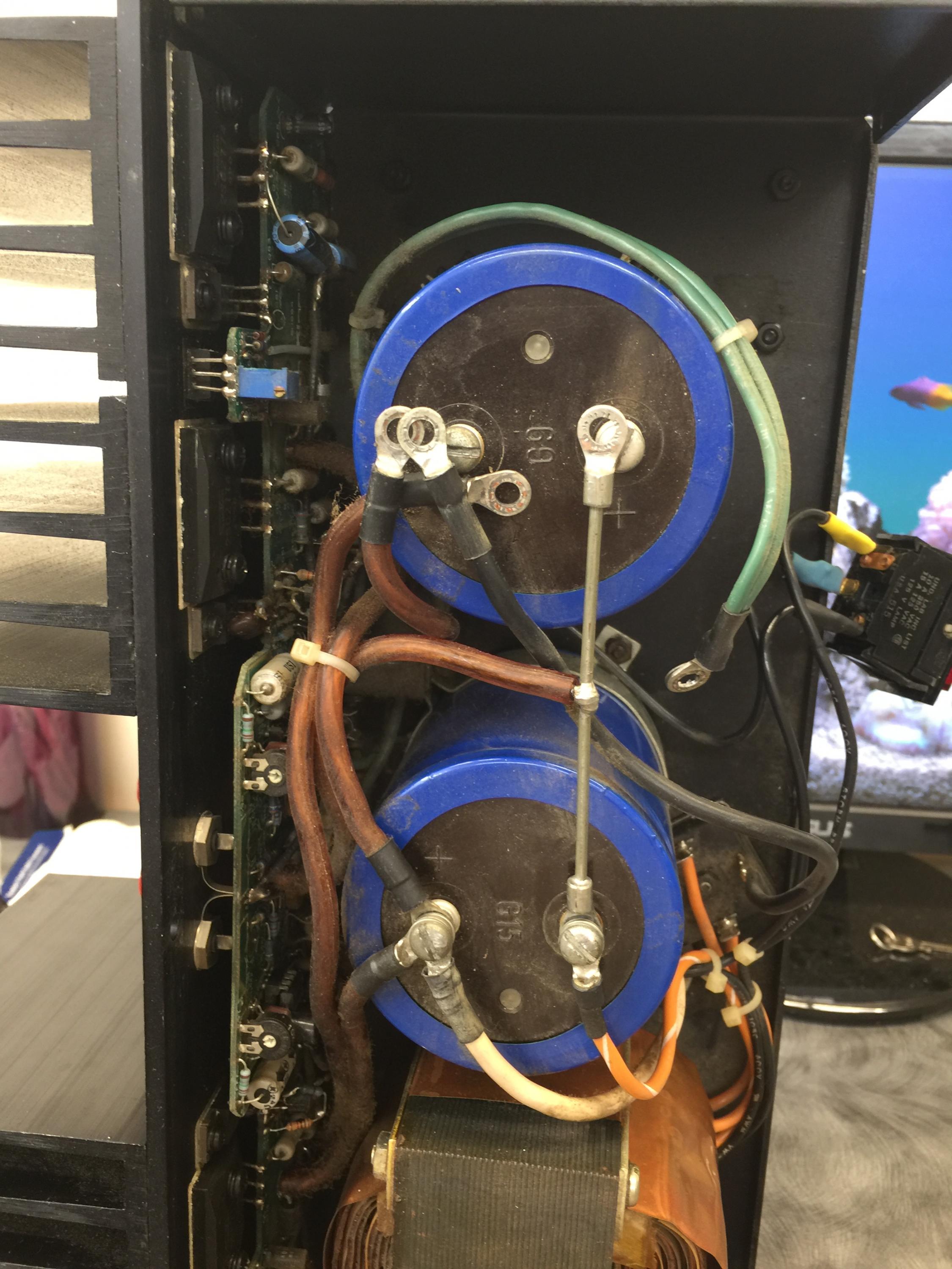

    They have 2 large caps that run in series. I took them out and made sure that they were discharged. I proceeded to check them with my Fluke DMM for capacitance, but I realized that these big caps are 80,000mfd/50V. Not sure what I can do to see if they are still good or bad?
    Has anyone ever upgraded these older Eagle amps, or may know what I may do to fix the problem? Any info or help would be greatly appreciated! I just want to get it up and running again in 2-channel!
    Thanks in advanced!

    That is a great amp you have there, designed by John G. Iverson the founder of the company.
    The two caps are for the +/- power supplies. Since one channel is still working then no need to check those filter caps for now.
    You should upload good clear pictures the inside of the unit so we can see the layout of the unit.
    Are the SANKEN output Transistors shorted or what? If they shorted out it would have caused the main fuse to blow by now.
    There are small lytics caps that should be by now for unit that old.
    The way the boards are mounted are not easy to do the test with power applied.

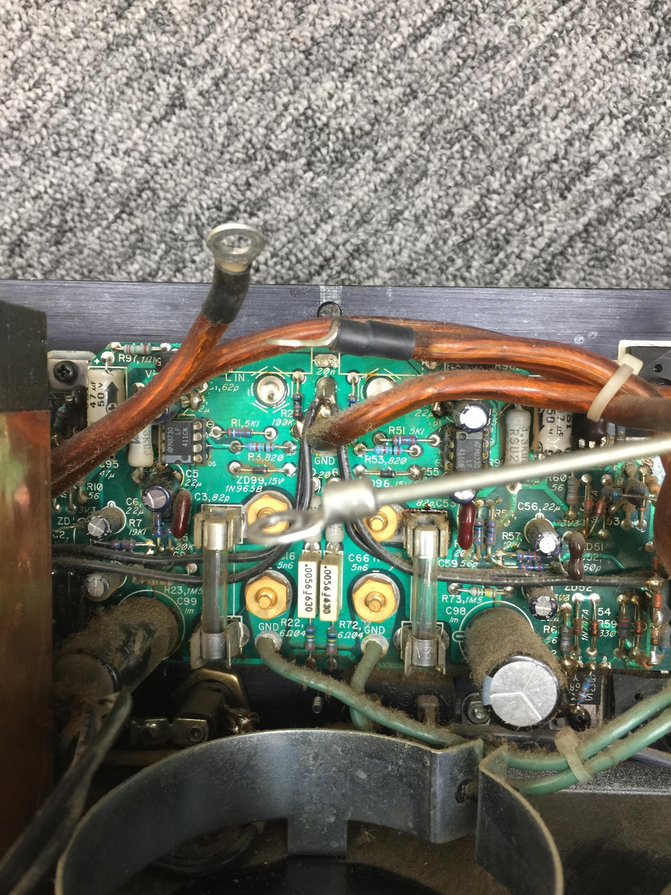

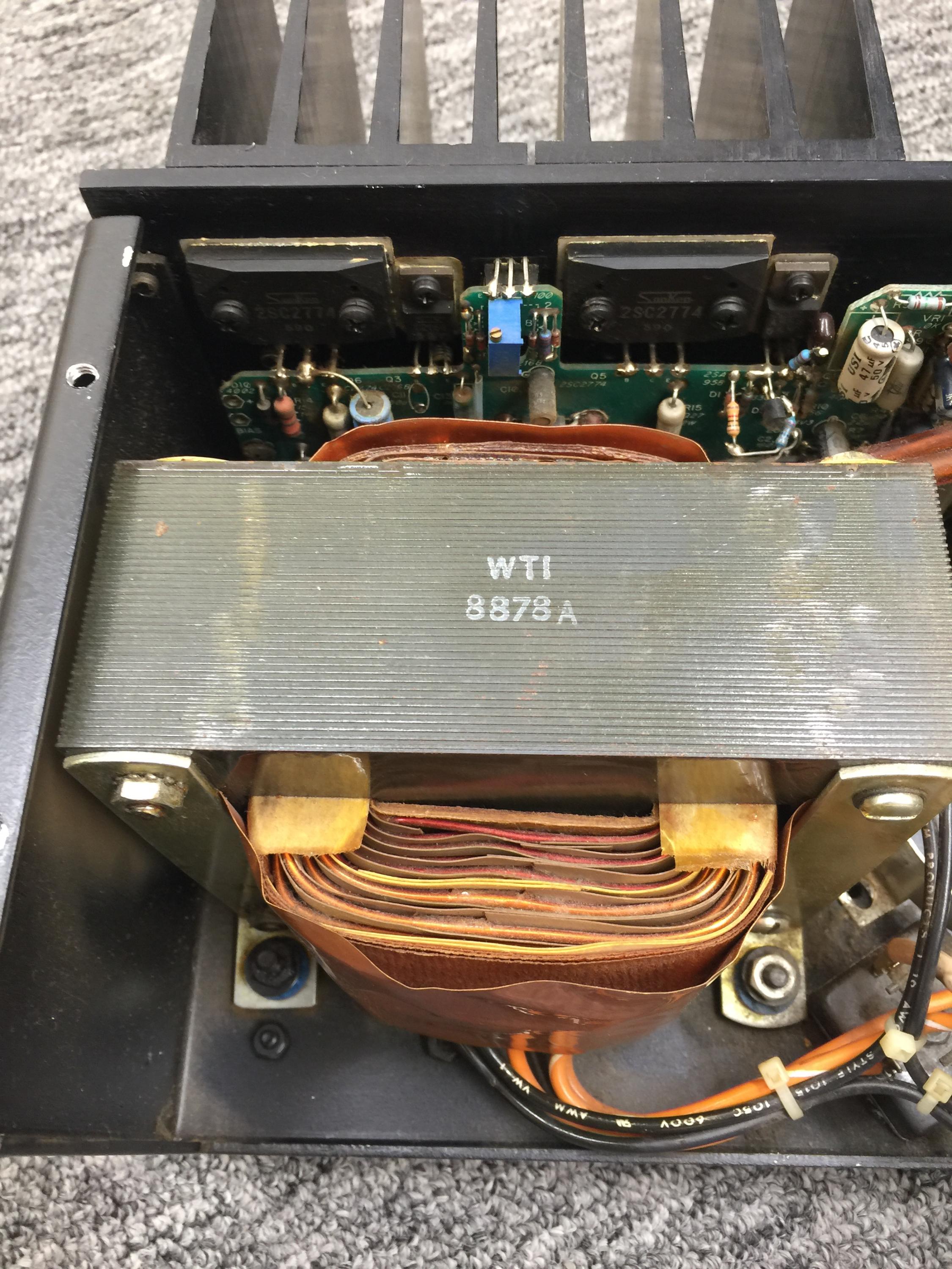

      HI bud. I do have some photos of some of the board and components. I can take more if needed. I had heard that Mr. Iverson had suddenly vanished after he had an encounter with the FBI years ago..lol Not sure what that was all about, but then again, that is what I had read. May just be hear say!
      I'm not really sure how I could test the big caps? My DMM only goes to 10,000mdf. I have checked the fuses, and they are all OK. I have removed both large caps, as to get to the components on the board. You are correct as it will be a little difficult if I have to remove the main board from the amp chassis. But I believe I can do it. The large transformer must be removed next, along with the bridge rectifier and perhaps some de-soldering. What do you think would be best in this case? Should I try and change all of the components, like the caps, resistors, diodes, FET's, and wires? Thanks again Bud!
        Re: Electron Kinetics Eagle 2C amplifier problem
        1) As I indicated, no need to check the big caps or the rectifier since one channel is working.
        2) Since you have two amplifiers, one is working and one is not then you can do the Voltage comparison readings between good amp and bad amp, just have to be careful not to slip the probes.
        3) You can also do the resistance comparison readings too.
        4) I see speaker fuses so check them out: https://www.badcaps.net/forum/attach...3&d=1535524223.
        5) Make sure to put the wires back on correctly for those two filter caps!

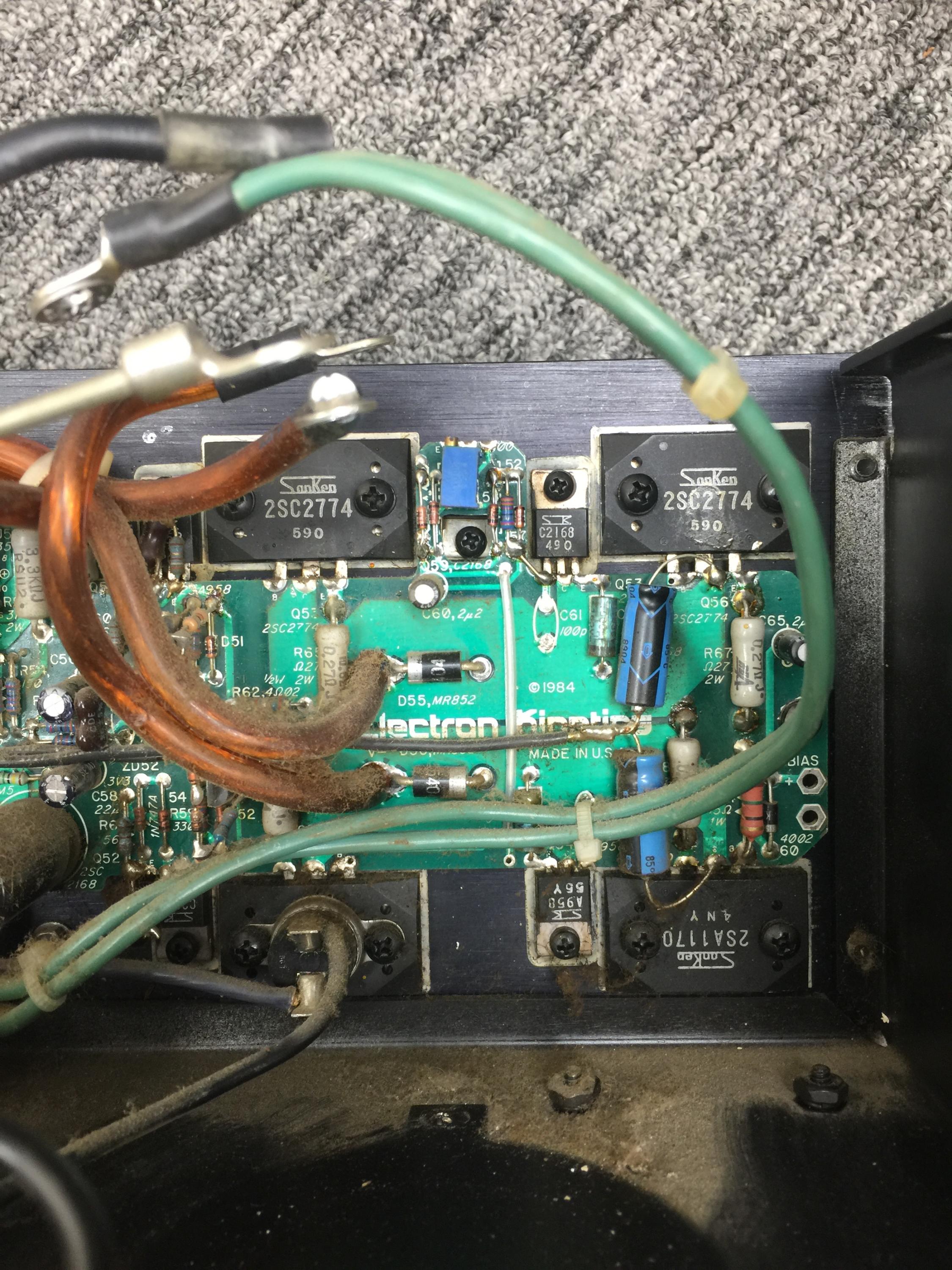

                    You can start by check the checking the Voltages on those SANKEN output transistors against circuit GND.

                      So I would need to connect the big caps back, then I would use the ground probe clipped on to the chassis? If this is correct, then it would be OK to use the red probe to each of the legs on the transistors to see what voltage they are showing on each side? I'm not really sure if I can test the Sanken transistors on the bottom as those big caps may prevent this.
                        Yes, you will need o hook everything back up and power up the unit, you can put your meter black probe to where the two green wires are attache to the filter caps.
                        As I indicated before, this is not easy unit to work on. When I work on something like this I will extend the wires so they are longer so it will allow me to get to the test point.

                          tape up your meter probes so just the tip is showing ..this is for when you slip ..
                          on those outputs B should be about + or- 600mv .
                          C rail voltage + - same voltages as across each of those big caps .
                          E should read very low mv.s ..ideally 0v but rarely is the case .

                              B C E means base, emitter, collector pins on the transistors basically see if you can read the writing on the transistor then look for a data sheet for the transistor it will then show a picture of what each pin does,maybe in the mean time start watching some youtube videos on how to test transistors/mossfets/diodes/resistors the videos do help this is how im learning.

                                      whats the number on the transitor?
                                      • Gammaray
                                        • May 2010
                                        • 120
                                        • U.S.A.
                                        I have Sanken 2SC2774 with 590 marked below that. Also Sanken 2SA1170 with 4NY below that. Some of the smaller sized ones are marked C2168 with 490 below that. Another smaller one is A958 with 55Y below that. These smaller ones appear to be Sunken as well with a SK on the top.
