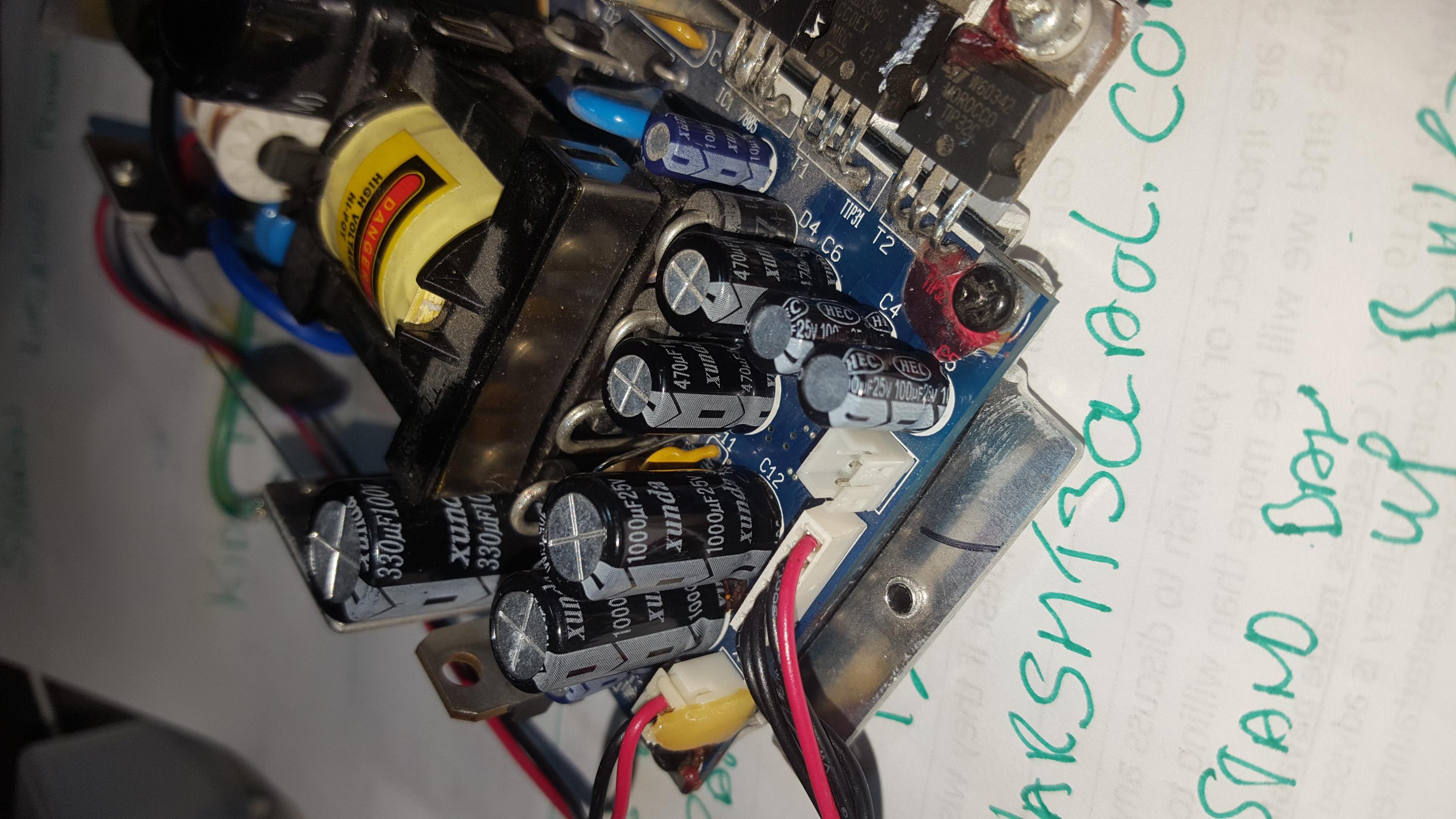

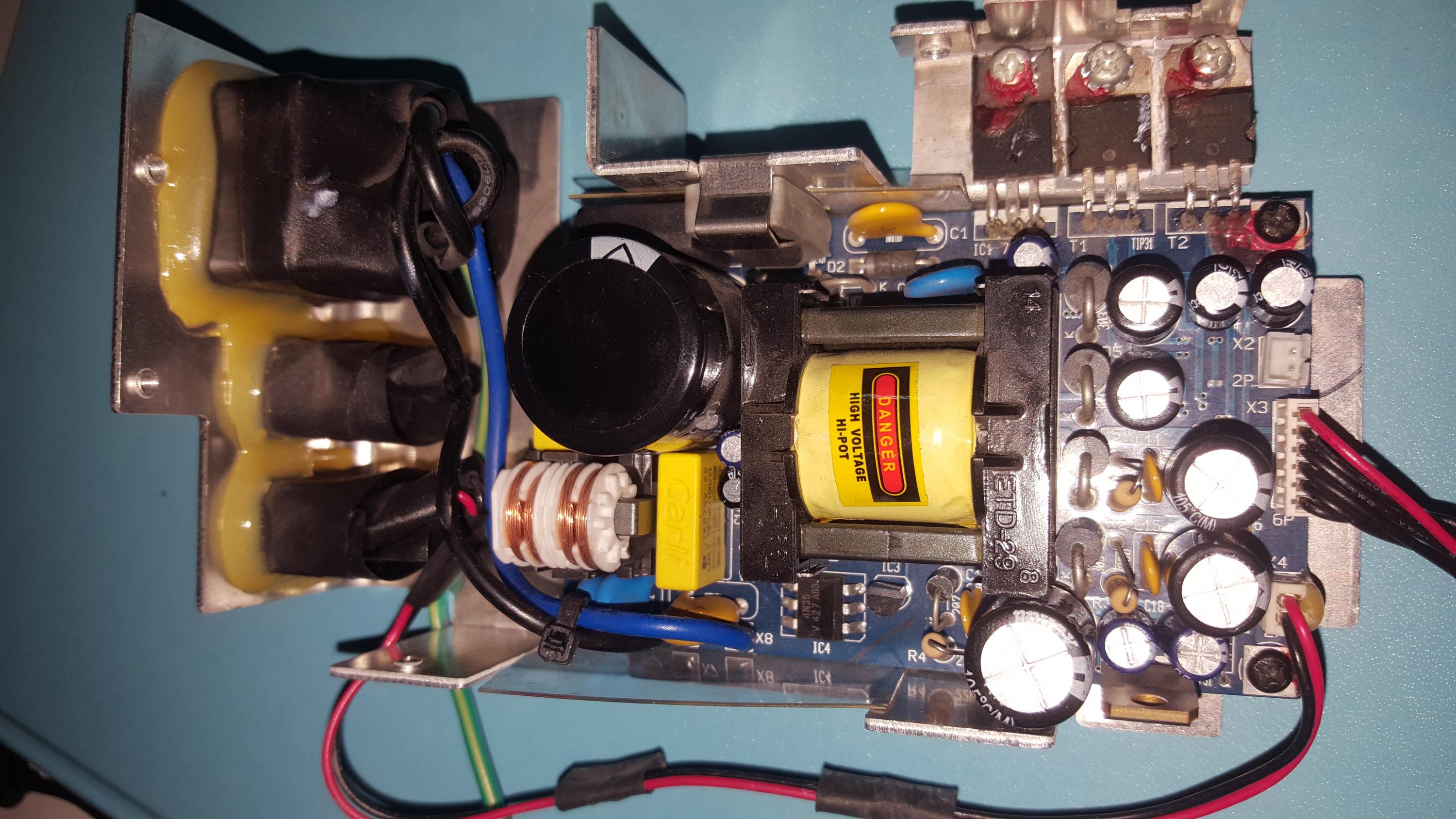

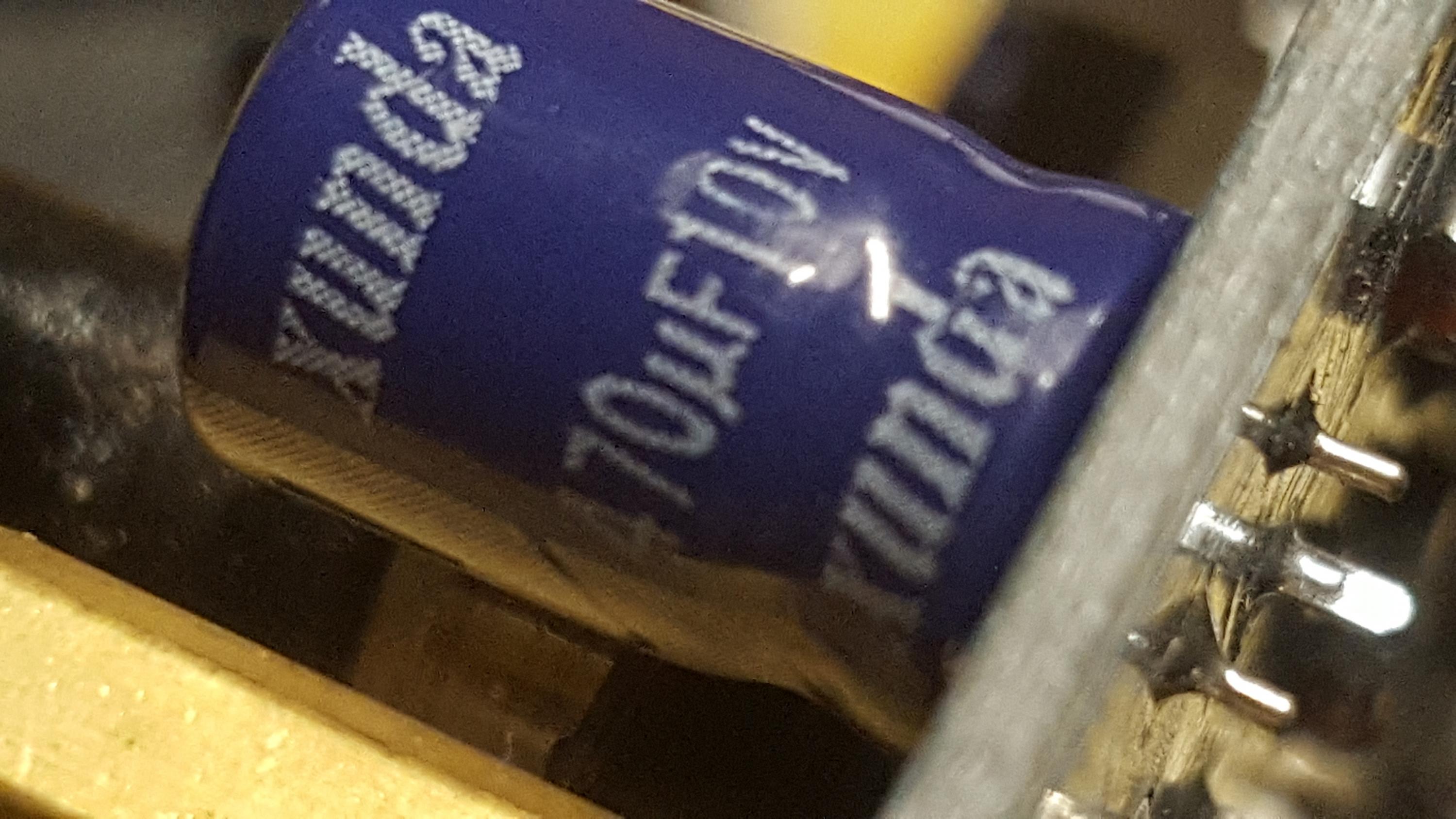

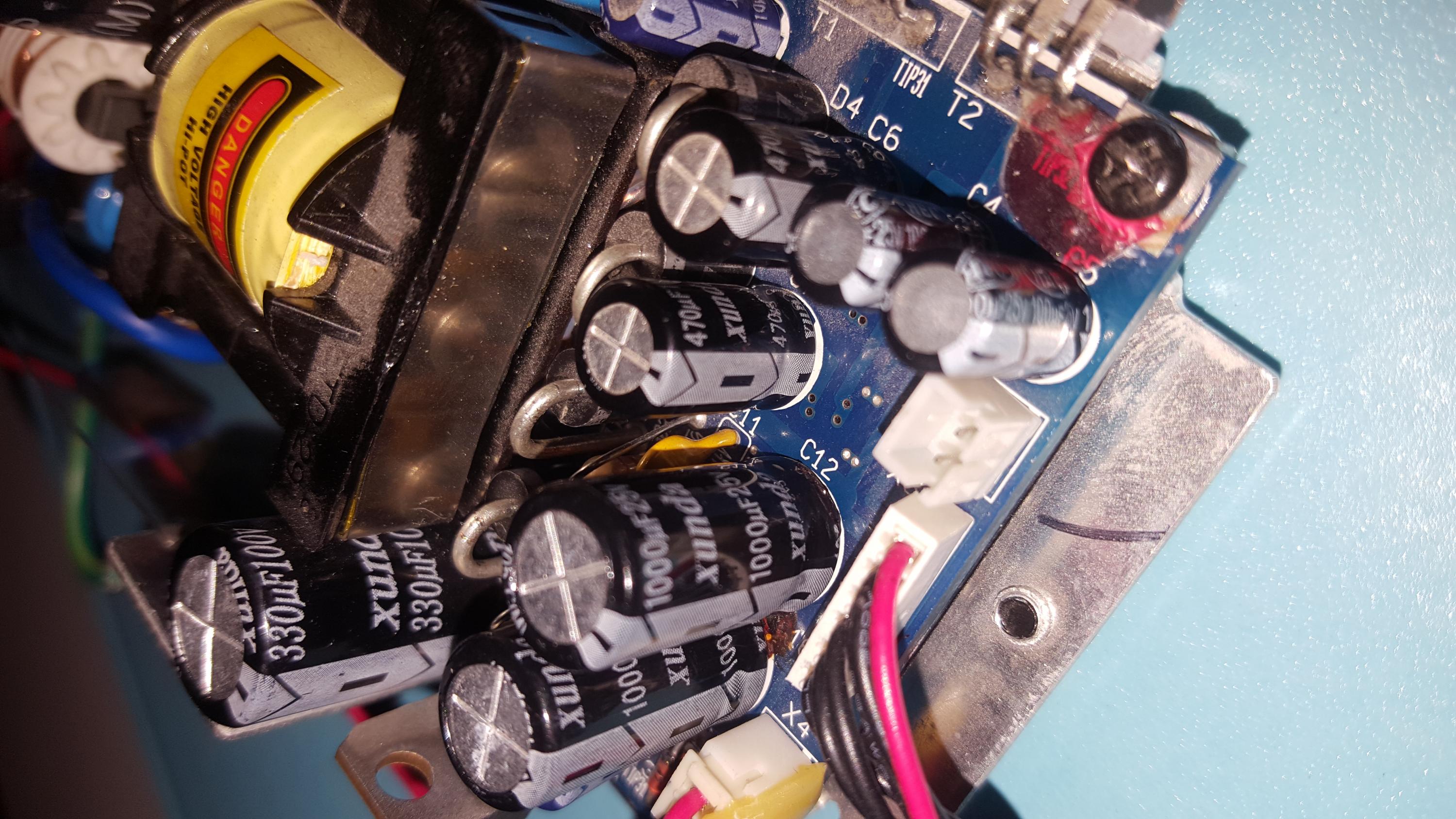

    Hi Guys another mixer I'm currently working on it was working fine at a gig then its started resetting the effects selected then it started going on and off altogether I have opened it up and all the caps are xunda caps which don't have a good reputation I saw NTKILLERS700 regarding a mixer power supply on here and its the exact same power board so I have ordered the same caps from mouser the only thing im not sure of is there are two capacitors next to the fx board 220uf 10v and a 470uf 10v and im not sure what to order to replace those ones ie esr value or ripple current. And help much-appreciated guys

    Re: Behringer UB1622fx-pro Effects pulsing on and off

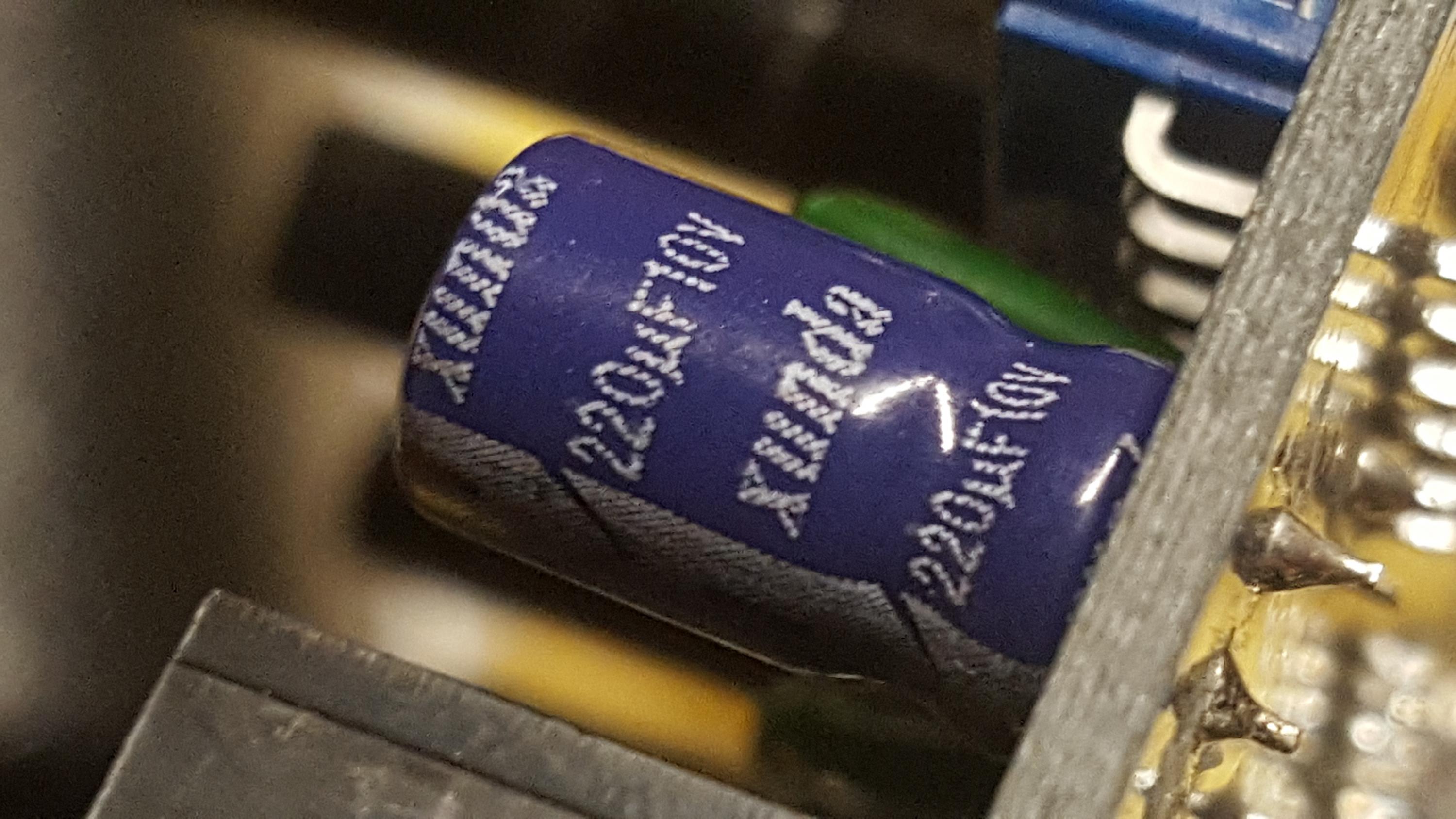

    I found one for the 220uf 10v
    667-EEU-FR1A221
    but I can't find any for the 470uf 10v with the low ESR Filter in mouser with Panasonic or nichicon help please guys any info much appreciated:
      Take the next voltage rating up, like 16V. Again use Panasonic FM.
        Thanks capleaker for the info but still can't find any with low esr the only one I can find is lelon brand
        140-RXW471M1ABK-0811
        what u think any good for the fx power of the mixer

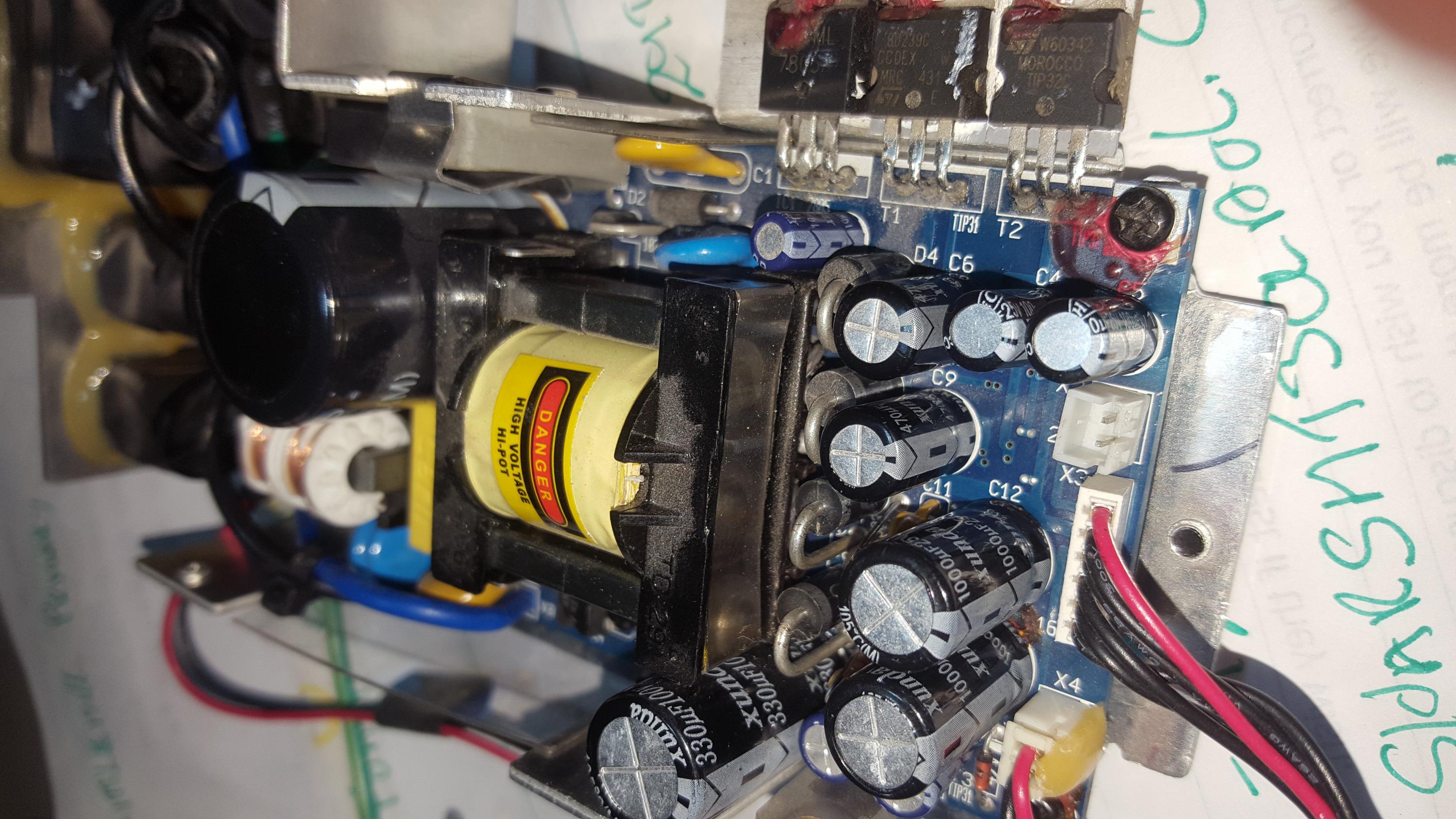

          check the red thread lock stuff for going conductive .
            found: Panasonic FR : 667-EEU-FR1C471
            Also found : 667-EEU-FM1A471

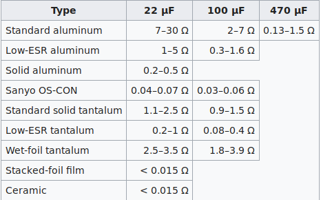

                    Quick question when im repairing a power supply should you always use low esr caps
                    Your never to old to learn
                      It depends on the type of power supply , traditional transformer power supply does not require a low esr caps. There are 50/60Hz only.
                      Inverter(SMPS) power supplies works with high frequencies up to hundreds kHz - there is necessary to use low esr caps on the secondary side .
                        Hi garry ... where in Ayrshire are you ?
                        You sound very inexperienced (with your difficulty finding components) ... how have you come about the diagnosis that it is power supply caps ... from reading the thread it looks as though you have just decided to replace these as they have a bad reputation?
                        Behringer equipment is renowned for bad build quality ... with gigged equipment a high percentage of faults are from loose connections especially now with lead free solder.
                        How did you decide the fault was defo in the power supply?

                              As regards tracing faults in audio equipment ... learning how to inject and trace test signals to pinpoint where faults are actually happening would be the best and most useful advice I could give you ... rather than just replacing components because that's what somebody did with what looks like a similar fault on youtube.

                                    In the "Filters" panel enter: Capacitance, Voltage (choose matching and one step above), Mounting type, Technology and Equivalent Series Resistance (ESR).
                                    (Below is a chart to help you choose "low" esr caps for different capacitance values in the future)

                                    One last point ... don't just restrict yourself to Panasonic there are a few other quality cap brands ... best to look for suitability for what you want and lifetime, price etc. then choose the best deal.
                                    Here's the ESR chart:

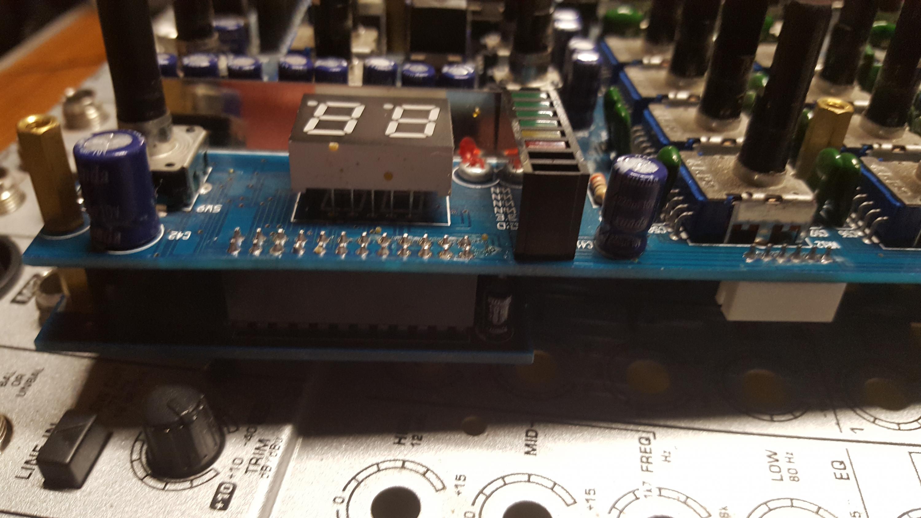

                                        Just another wee quick question How would I go about finding out what voltage is getting to the transformer and also out the transformer I'm getting voltage out of the filter capacitor and voltage out from pin 4 and 7 from ic2 top245y I've attached a picture of the area marked in red. Thanks in advance
