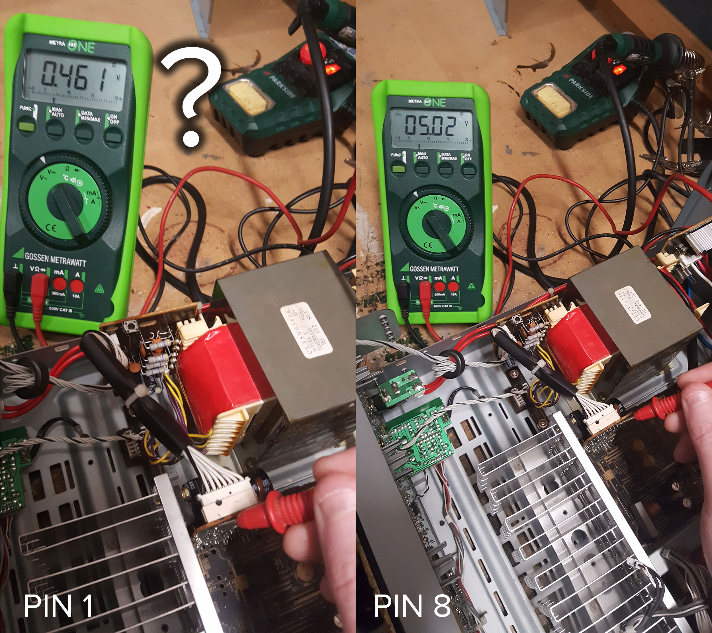

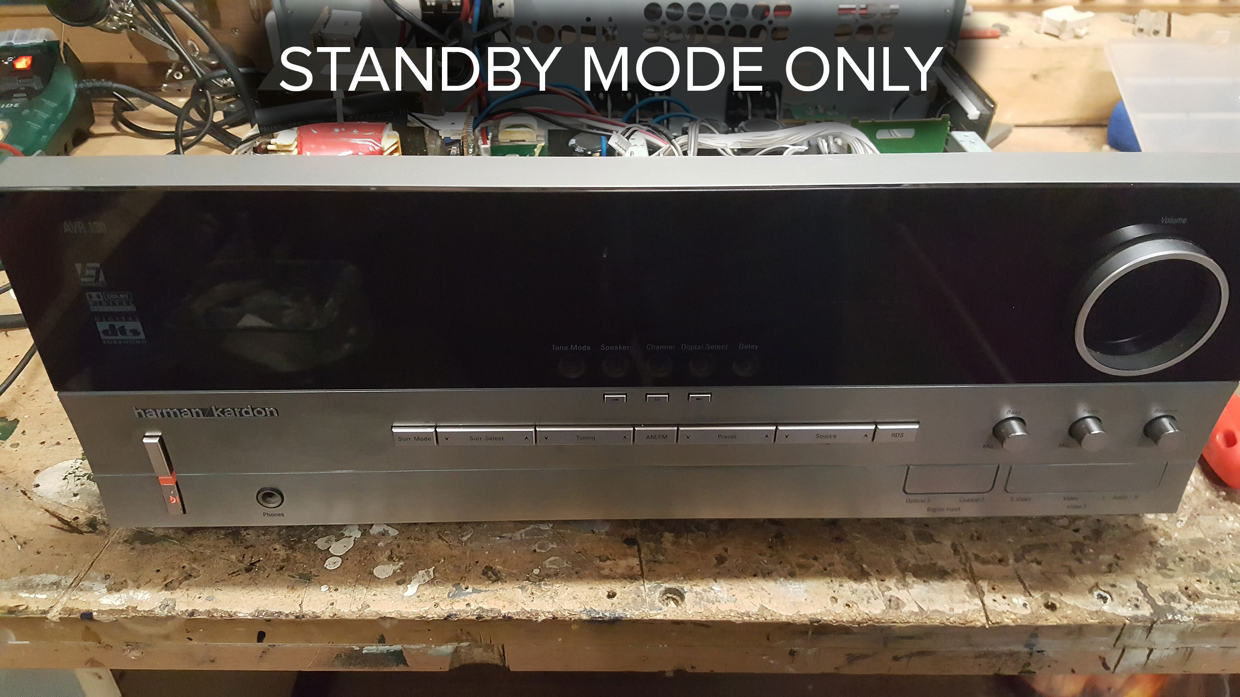

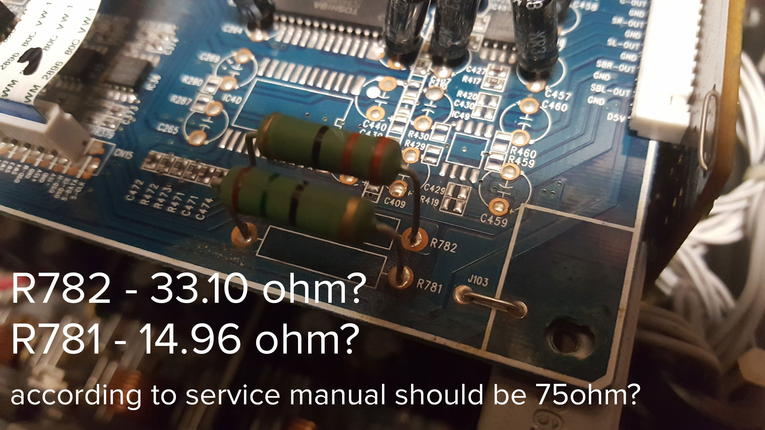

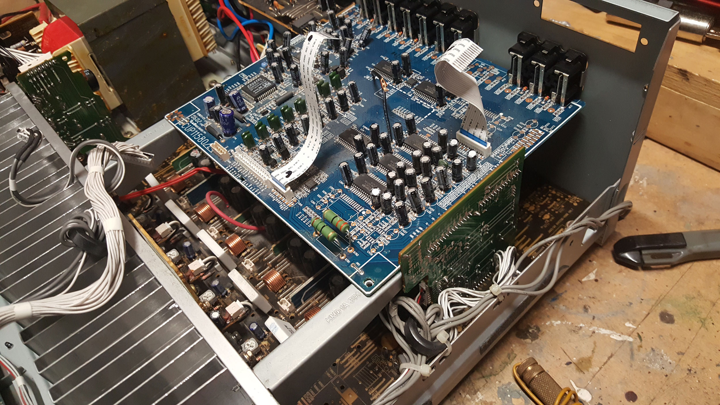

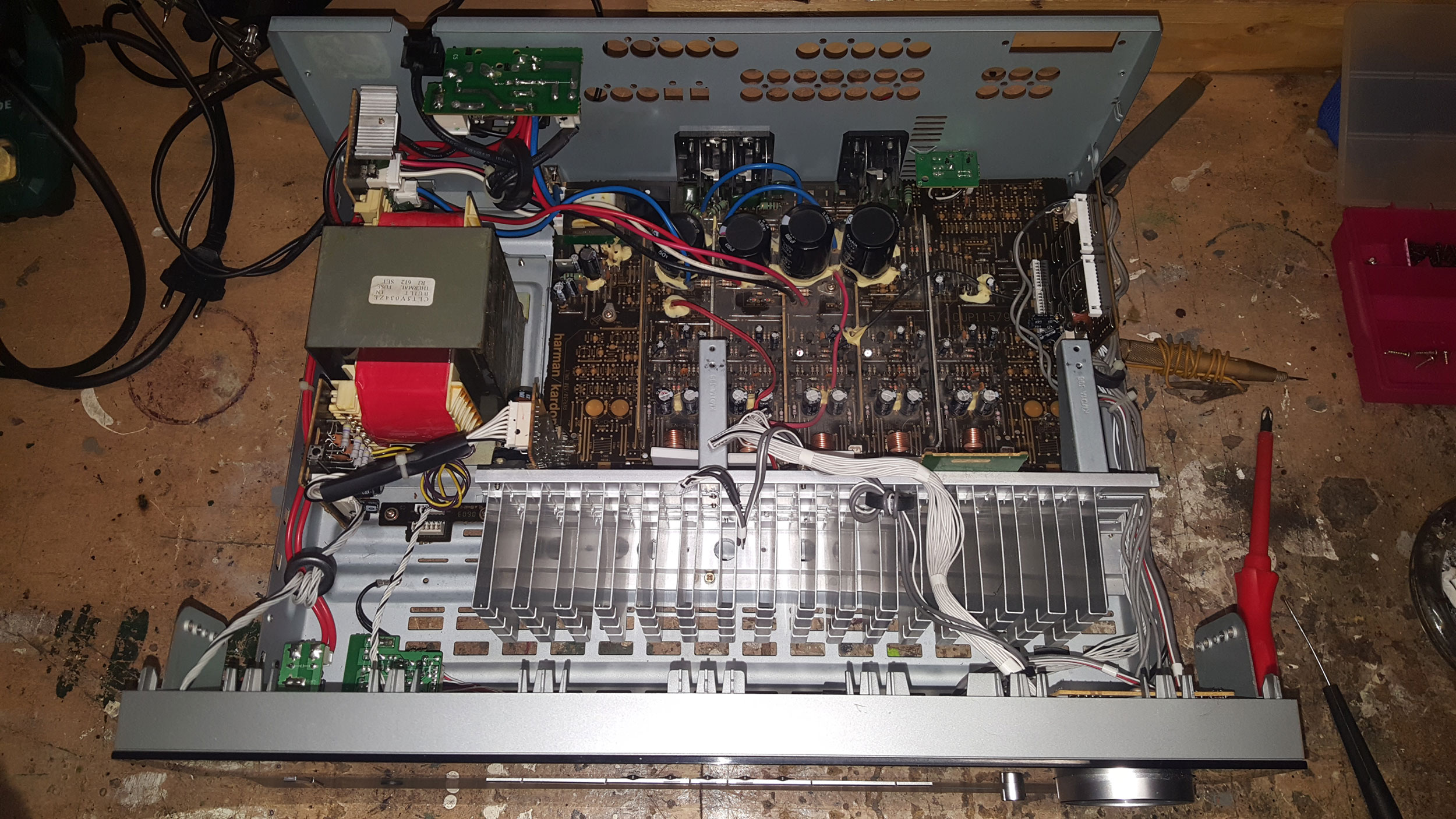

    Hello i have a HK - AVR130 with the following problem: Its stuck in standby and won't turn on. I have checked some resistors and can't find visual damaged capacitors, i have no idea where the signal goes to when you hit the standby button (it should turn on and show blue lights) wich cable or where it ends to measure it. the 5 resistors i checked should be 0.47ohm and they are around 0.43ohm and 0.51ohm (think that means they are not broken)
    Also ive checked pin 1 and pin 8, they should have 5 volts, however pin 1 gives back 0.461v? << don't think thats correct (not sure how to read that value) pin 8 gives me 05.02v (i believe this is correct?)
    Ive seen more HK's on this forum but not exactly with this problem. Hopefully someone can help me out.
    Help is much appreciated!
    PS. Ive attached photos of several components with text to explain what i did.

    Do you have the service manual? pin 1 & pin 8 of which plug, There should be a plug like that with +8.5 volts on pin 6 that supplies the +5 volt regulator ic. If it is missing check for open R106 or R107 on cup11581-5 board

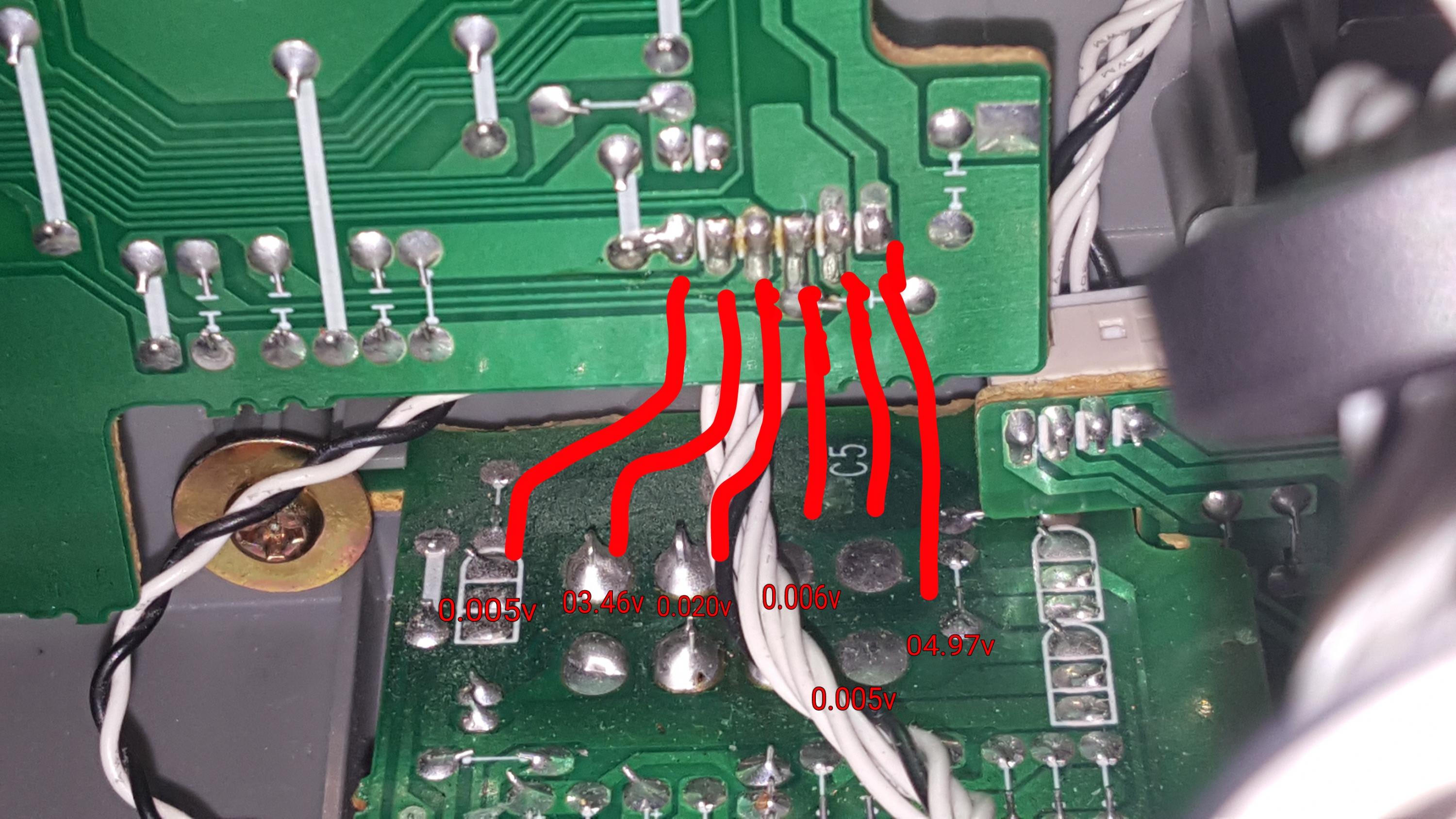

      Re: Harman Kardon AVR130 - Issues
      Its the second photo, and yes here is the service manual

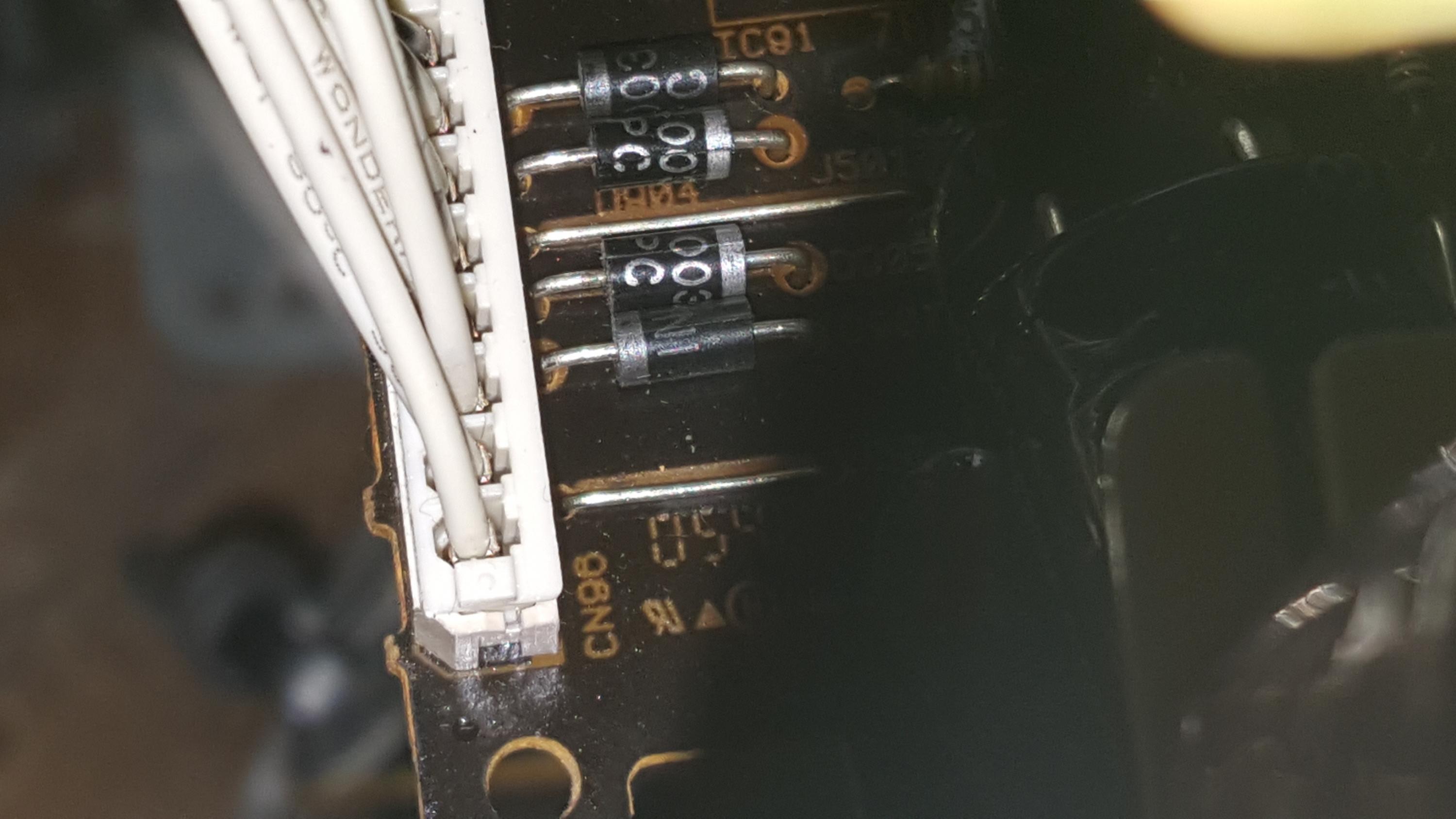

        I looked at the second photo and I can't see the plug number? is it cn81, bn96, cn98
        I'm guessing you are missing +8.5 volts
          Ah it's a bit hard to read so here's a photo:
          • R_J
            • Jun 2012
            • 9578
            looks like cn96, so do you have 8.5 volts on pin 6?

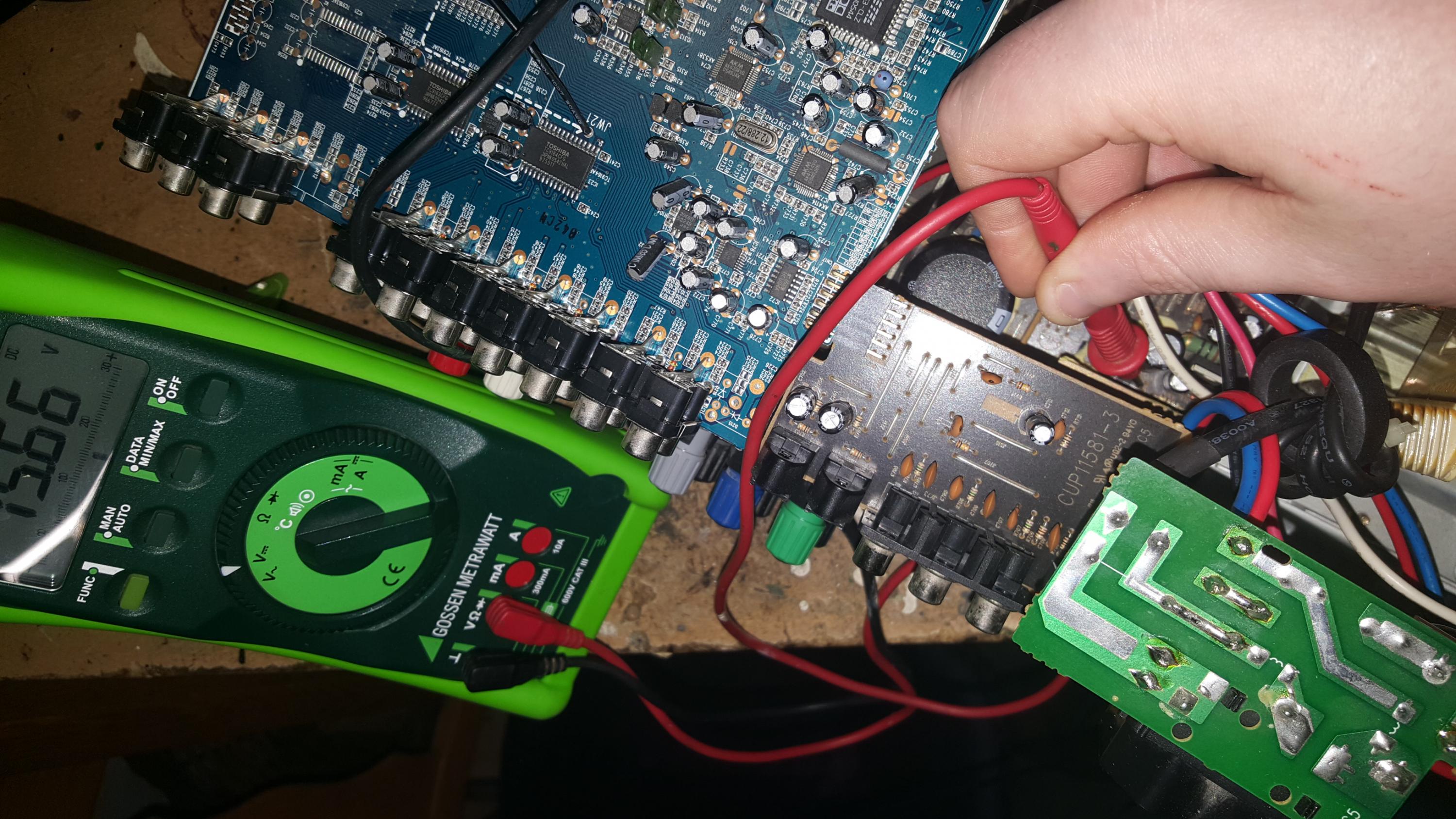

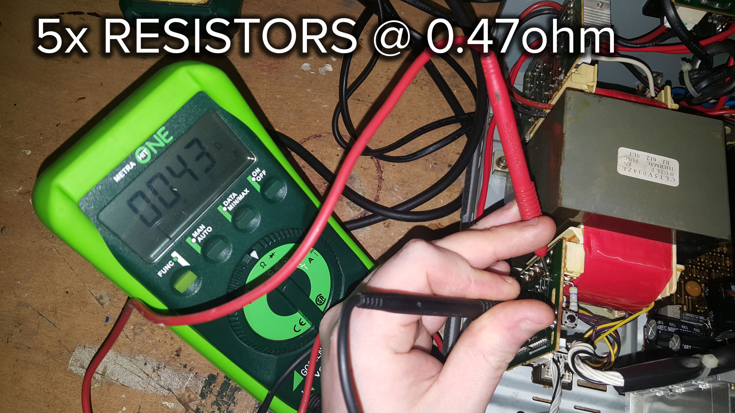

              I am checking I don't have 8.5volts on pin six if I measurred correctly the most I get is 2 volts, see photo
              However if I meassure R104, R105, R106 and R107 they give the same value between 0.43ohm and 0.48ohm

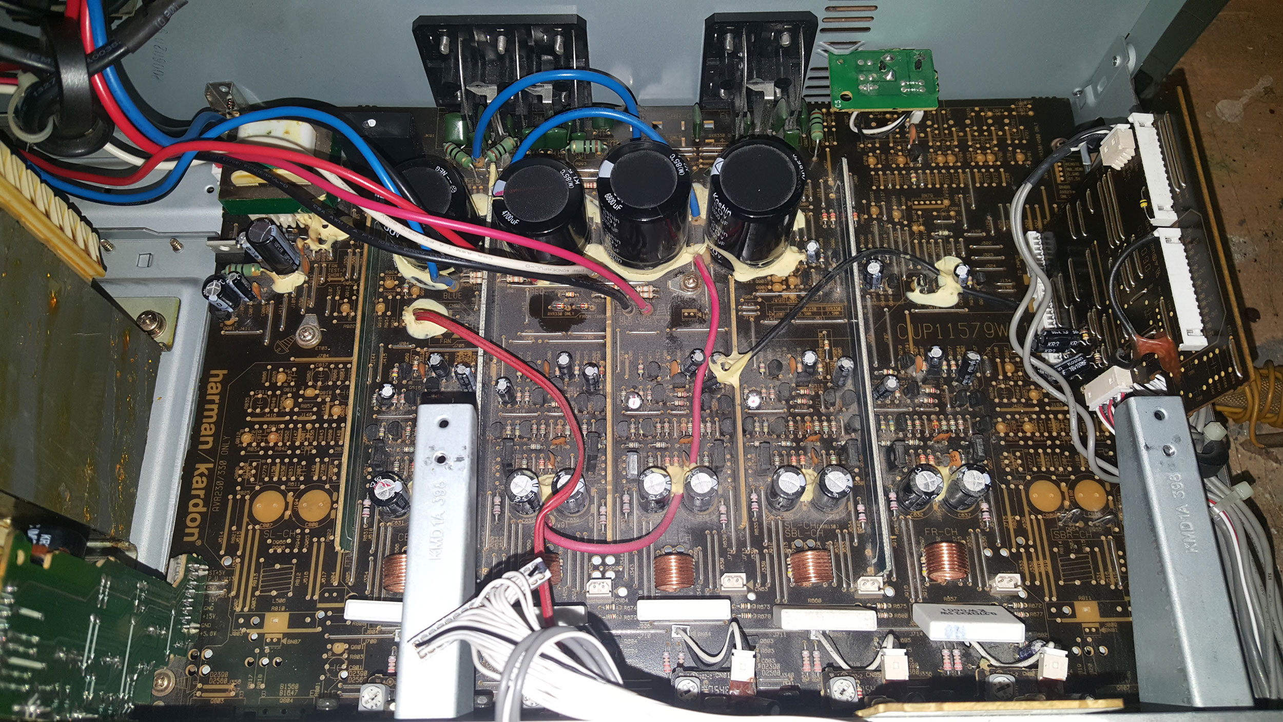

                  you won't get the +5 volts on pin 1 unless the amp is turned on, which means relay RY94 needs to be turned on, Do you have +12 volts on the relay coil pin3
                  Have you tried a processor reset
                  Where can I find that pin? Or do I need to take out the Main pcd since it's on there?
                  Yeah ive hold down the tone mode button for a few sec, but nothing happenend
                    Think I can reach it from here, not sure wich one is the third pin

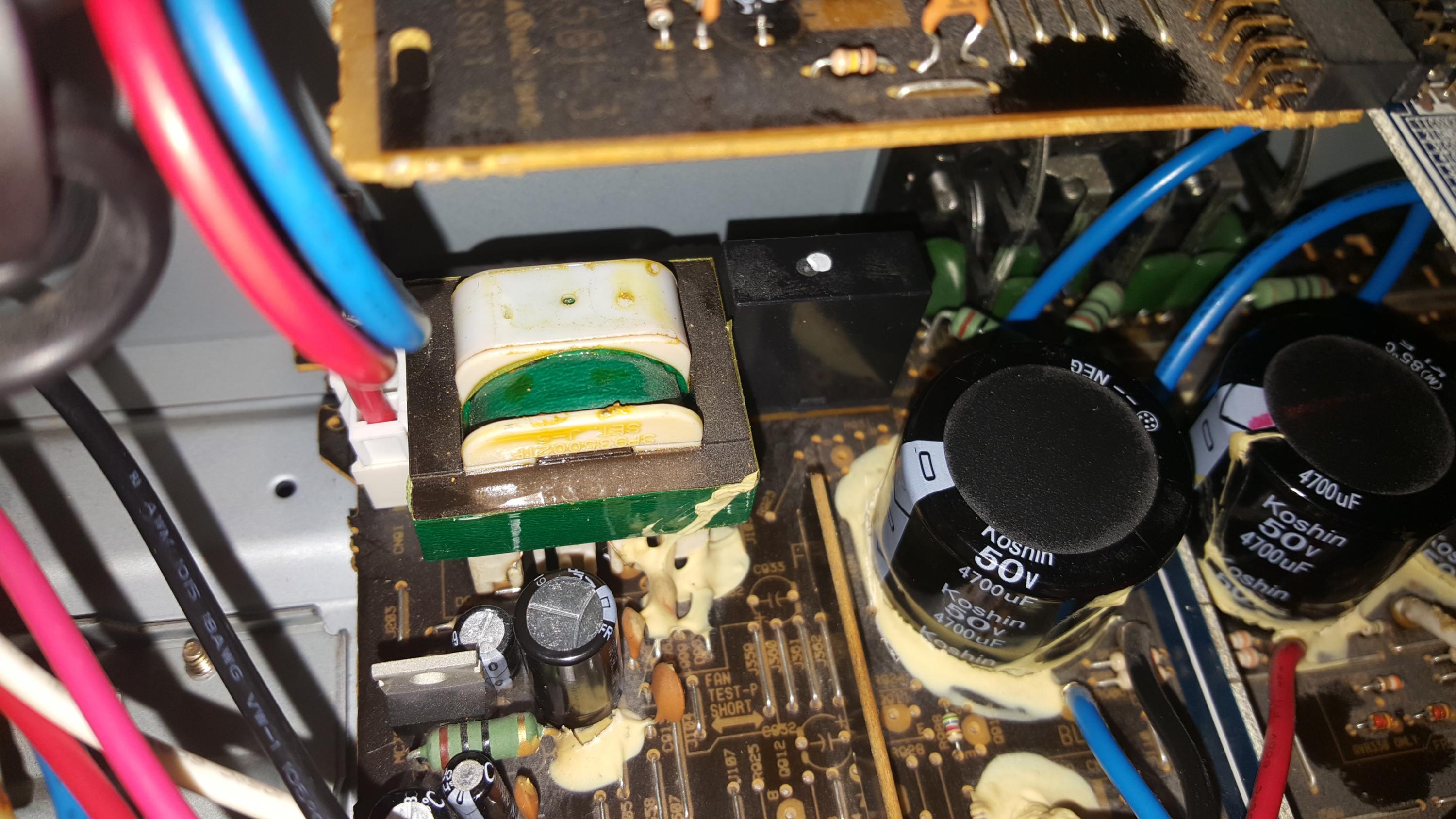

                      On the Main amp board there is the standby transformer T902, it supplies +12 volts to the relay. It is located near the large caps. Locate D901 It's cathode should have 12 volts. Q901 is the transistor that activates the relay, it requires .7 volts on its base to turn on, that .7 signal voltage comes from the front panel "POWER_H"
                      The 12 volts will be on the coil, those are the pins directly in line (left side of relay in picture), check both pins if you can
                        D901 if I have the right cathode measures 15volt left side (silver colored side) the right side 7volts (black side)
                        Same for the pin under the Transformator left side back is 7volts and left side front hardly anything

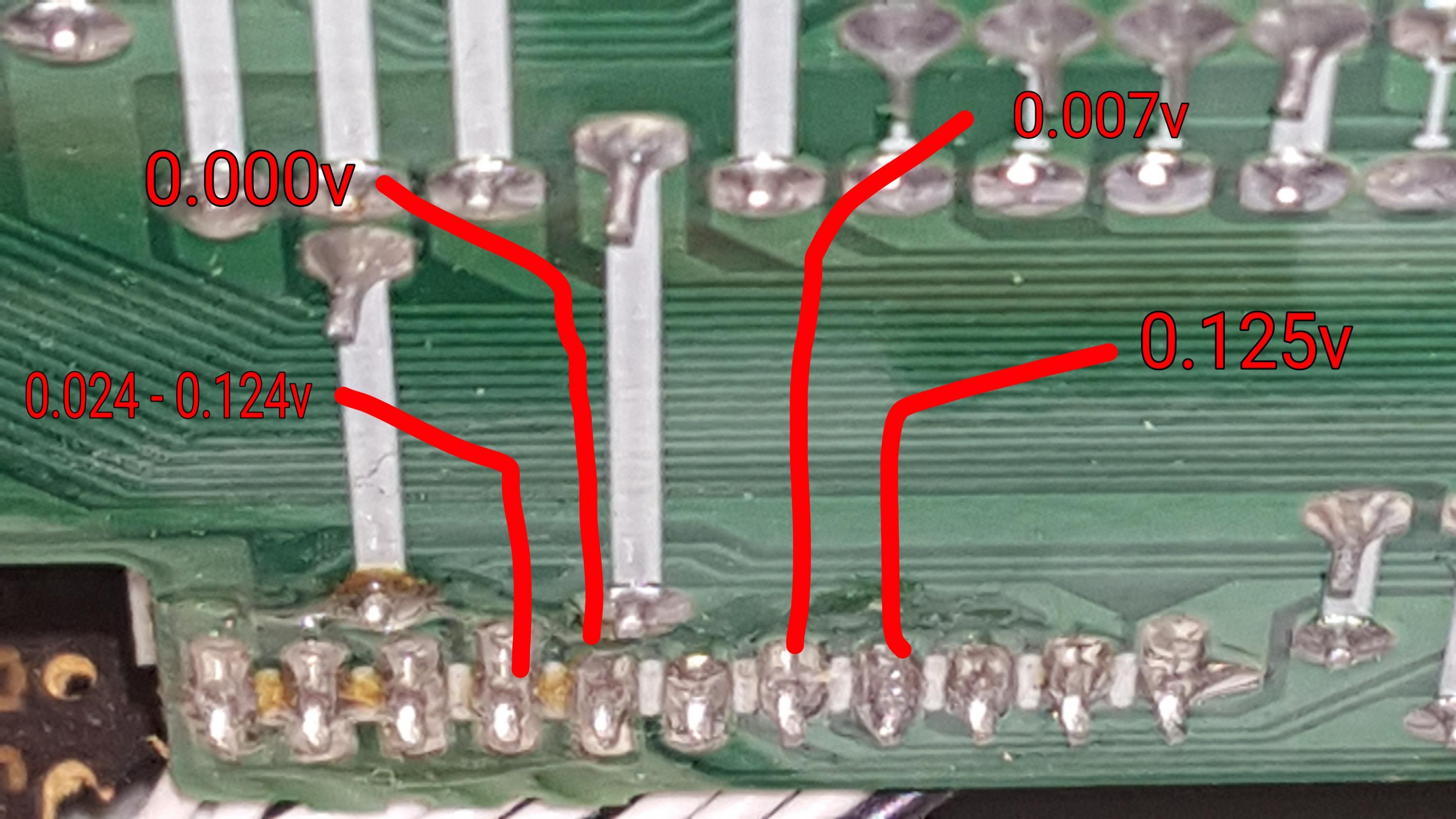

                            Hopefully I got the right one, but it looked right. So ive measurred all pins and the 4th pin is at 0.006v but it goes from 0.006 to 0.020 and 0.043 and then lowers again not sure what that means? I've attached a photo with the pin voltages

                              That seems to be BN15, BN80 is at the other side of the front board, layout is on (page 26) schematic is on (page 110)of the manual. BN80 has 11 pins (pin1 is toward the center of the board, pin 11 near the edge)

                                  So i tried to measure the corrects pins the results are a bit unclear.. often its not a stable voltage. Please see the photo, hopefully that makes it a bit more clear about what is happening
                                  PIN 4 from the right side goes from 0.020 to 0.125v and i'm not sure what to make of that.

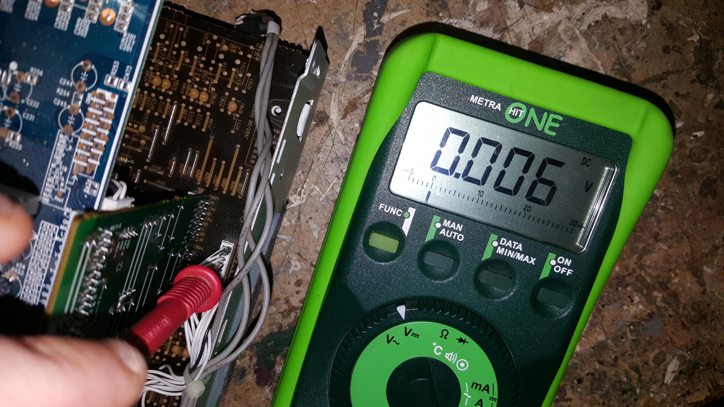

                                    I tried it again from the center pin 1 to pin 11, pin gives me a value between 0.004v and 0.008v. Same happens with pin 5
                                    EDIT: ive followed the small cable and did a test at the end wich shows that PIN4 has 0.006v and PIN5 has 0.000/0.002v. So I think those pins are correct? See attached photos

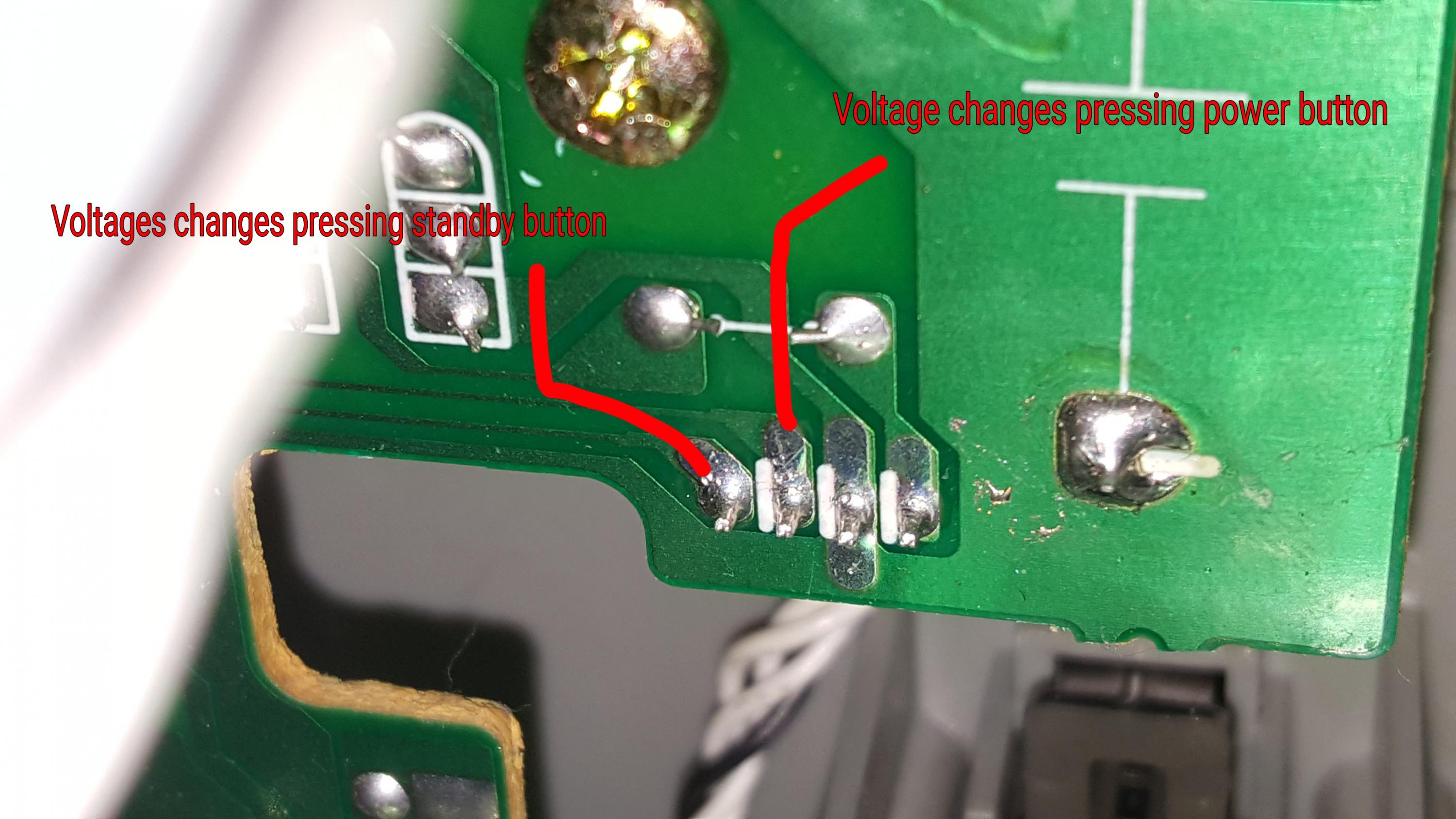

                                    • R_J
                                      • Jun 2012
                                      • 9578
                                      So it does'nt look like the power on signal is coming from the front panel to turn on the relay. so is the power button sending the power on command to the front panel,
                                      I guess check BN88 pin 4 and see if the voltage changes on it when the power button is pressed. ther should be voltage on that pin and when power is pressed it should go to zero. (connector is near BN15)
                                      at the top of that front board, ther should be BN81, pin 6 should have +5 volts, also check pin8 (reset) see what voltage it has on it
                                      Then check the voltage on L702, then on D761 (all in the area of BN81) thats the supply to the main micro
                                        Alright BN88 PIN4 changes voltage when pressing they go to zero (see photo) BN81 PIN6 has 5voltage and PIN8 (reset) has 5 voltage aswel.
                                        L702 Has 5 voltage, D761 has around 5volt bit lower
