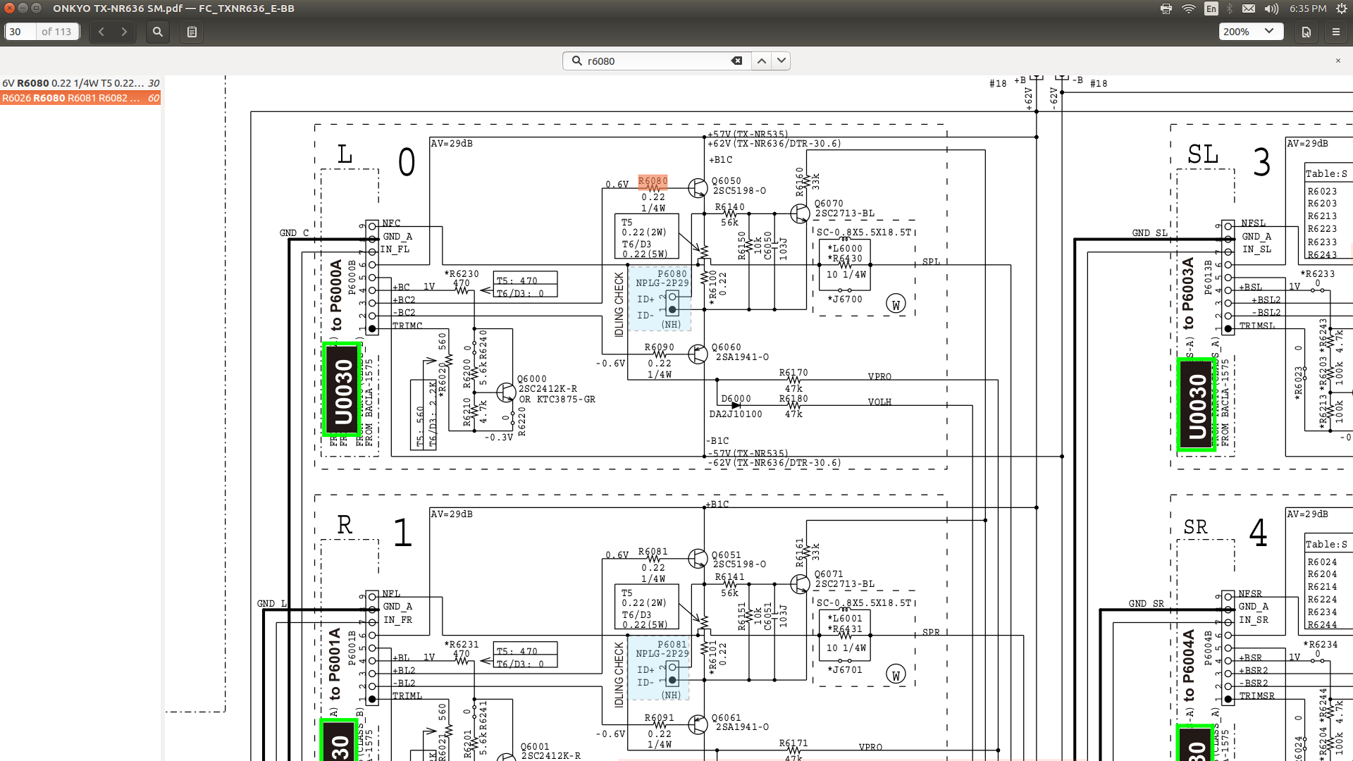

Onkyo TX-NR636 Quick Question
  • mmartell
    • Oct 2013
    • 3189
    I have an open resistor at R6080 (top center). it is a 0.22r 1/4 watt non-flammable carbon film resistor tied to the base of the final output transistor 6050. Is it advisable to replace it with a 2w resistor or is it meant to protect other components should the final blow ? Thanks.
