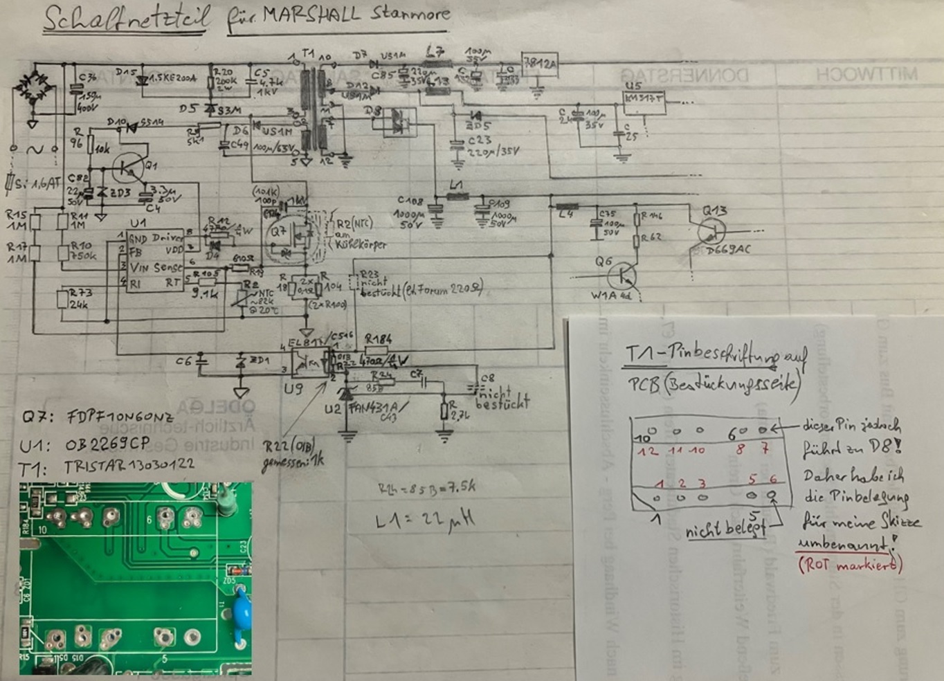

    From Josef Aichhorn (Guest), first contact with my inquiry: 16.12.2022 01:00
    Hello everyone!
    I want to thank everyone who helped me repair my MARSHALL STANMORE! Yes, it's working again - something I hardly believed after initial research.
    The link to Badcaps by "4:46 (Guest)" was very efficient! THANK YOU! Among tons of photos and posts, I found the values and designations of the burned components!
    In short, facts (values and designations of the components, see schematic sketch):
    2 defective electrolytic capacitors (EKLOs): C59 [electrolyte leakage], C80 [bulging cap], [both 470µ/50V], and as a precaution, 4 more of the same type replaced.
    Defective parts: Si 1.6AT, Q7, C124, U1, R18+R104, R19,
    Defect due to the removal of the black, hard, tough paste: R69 (not in the power supply: R41[3R30]).
    A heartfelt THANK YOU to everyone!
    Josef from Austria
    PS: As a small thank you, I want to share my painstakingly created sketch of the switching power supply (from Marshall Stanmore) here - because I can imagine that it might be useful ;-) !
    Maybe someone can send it to the Badcaps forums - I don't have authorized access yet... just for viewing. °[:->)​
    And here is the sketch:

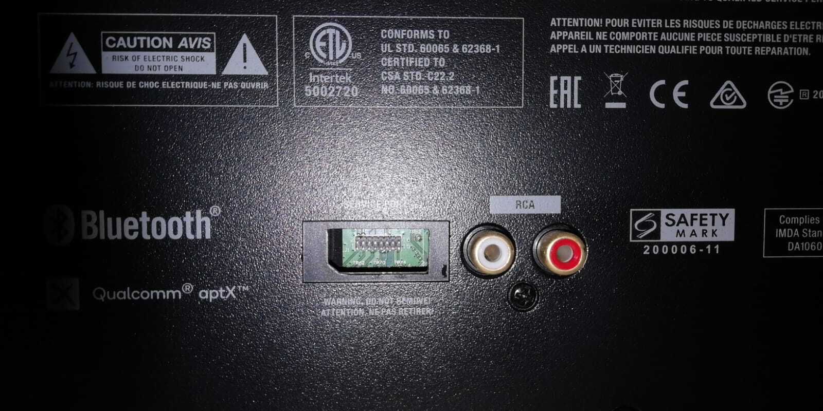

                      so first thing to notice, it is a BT WITH the switch behind saying "standard and enhance" powersave .. hum!
                      I must warn people : if you do have this device DON'T add R23 as I can read above... you will push the secondary side voltage out of the acceptable limits and hamper PSU stability.
                      my PSU was slowly hesitating between 10V and 32V... strange, I checked everything,
                      so , in that case, I first fuel externally the controller with a lab PSU => not successfull.
                      okay then, I help PSU to ramp up the secondary caps, by precharge them with ... a lab PSU.. and surprise! the system starts up... hue?!?
                      when I focus on Q12 and Q9... I guessed what there are standing for???...
                      okay got it ;... "low power mode" only deliver something like 15V , probably to shutdown classD amp. in standard mode secondary side should be up to 32V , this process is switched under blutooth module control, with the help of Q12 and Q9. the latters commutes resistances divider across TL431 shunt regulator
                      and , BT module was out of service in my case .
                      by cutting Q12 base , PSU starts directly to 32V, and system starts normally
