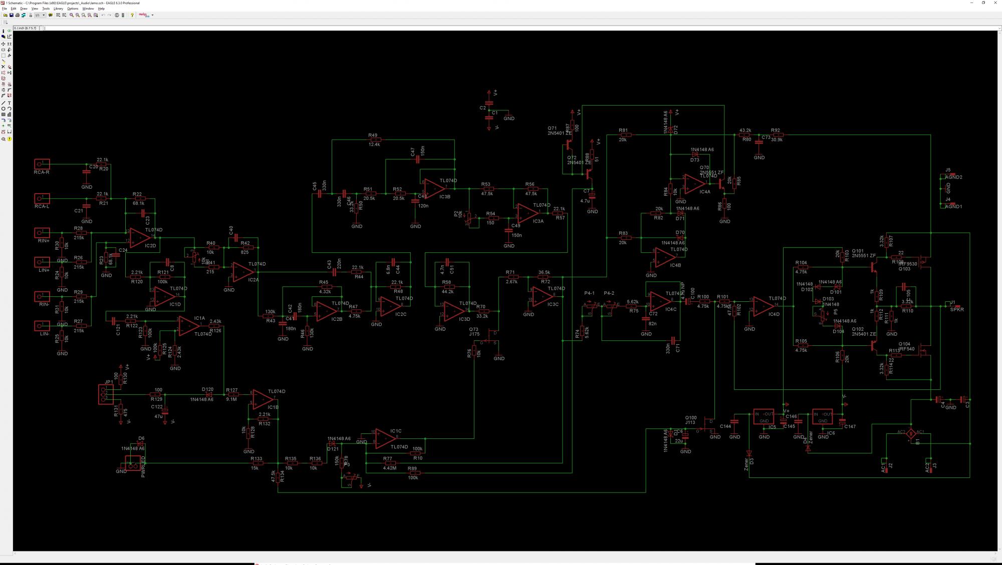

    I got recently jamo subwoofer model is sub 300.the problem was no power.when i checked smps i found that two mosfet shorted at primery side.after i replaced power is ok now but when i am testing with audio signal i and geting distortion bass is ok but distortion at high freequency of music..i checked the speaker with other amplifier speaker is fine..so i suspect issue in pre amp stage or high freequency cut off stage..

    Hi any one have schematic for this subwoofer

      And on a personal note, i bought a dead Jamo Sub 200 for really cheap a few years ago, and the problem turned out to be that the volume and low-pass adjust pots had crapped out. That might be worth looking into, as well.

        Re: Jamo sub 300 subwoofer distortion
        [QUOTE=Khron;776365]There might be some useful ideas here:
        https://www.eevblog.com/forum/repair...-board-repair/
        And on a personal note, i bought a dead Jamo Sub 200 for really cheap a few years ago, and the problem turned out to be that the volume and low-pass adjust pots had crapped out. That might be worth looking into, as well.[/QUOTE
        volume and lpf adjust pots are working well... what i understand that on high frequency content not attenuating properly, distortion from high frequency signal.. even i cannot hear any vocal male voices through sub.

          I have no idea if the line-level circuitry is the same between the 200 and the 300, but when i was working on mine, i "decoded" the whole board - see attachment.
