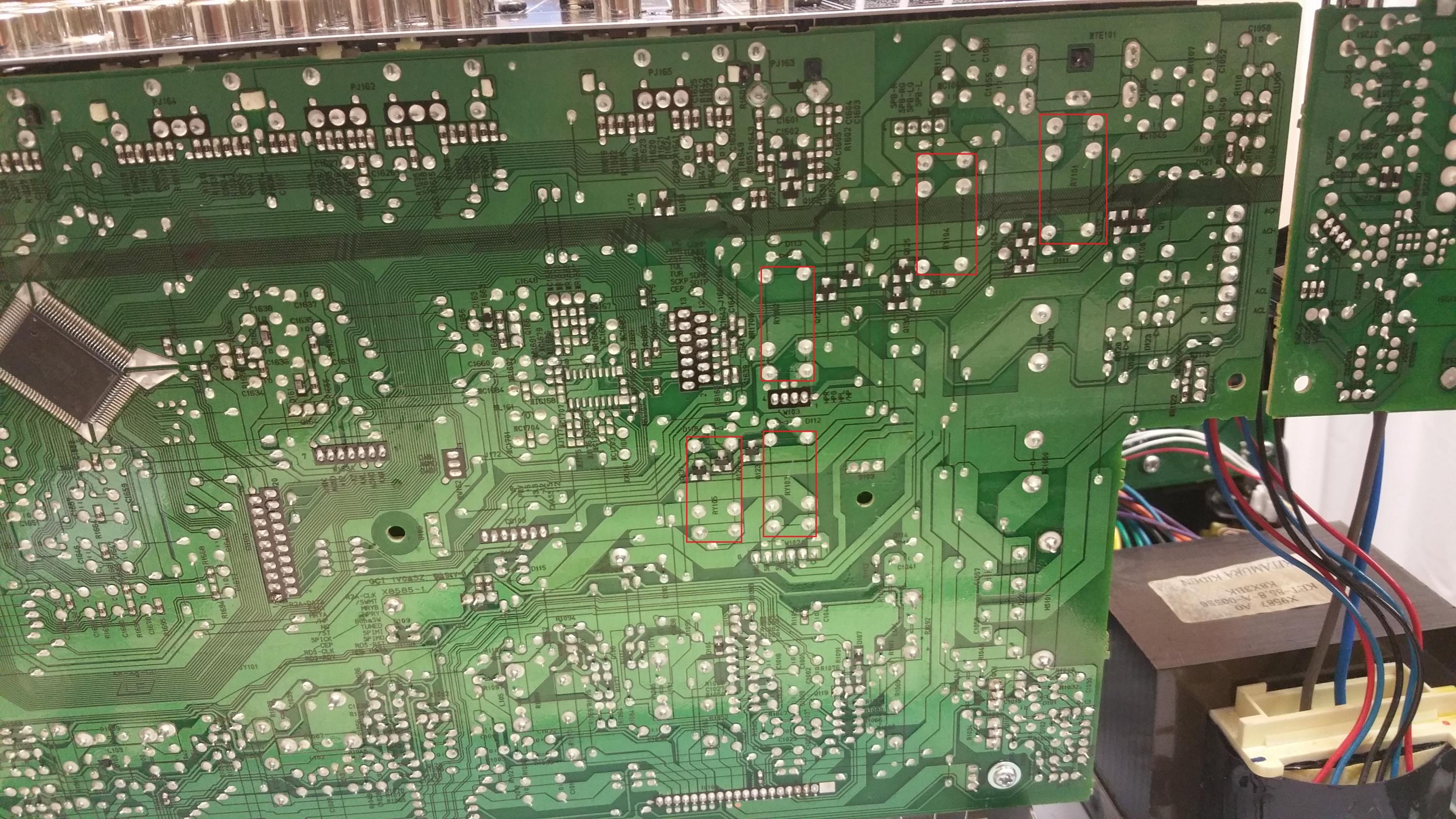

                                Re: Yamaha HTR-6130 - Blown "front" channel
                                If you look at the service manual, block diagram, and circuit diagram: You will see that the output of ALL amplifier are fed to the speaker protection relays (5 of them). So you need to find out of the relays for dead channels are turned on or not, headphone jack is also fed through the relay.
                                  I guess a stuck relay would make sense because the unit isn't detecting any fault.
                                  How would I go about testing them in circuit? Can I check continuity of the relays while the circuit is powered? Or is that a no-no?
                                    The relay is normally OFF, it is turned on if no fault is detected that is why you need to find oyt if you do have DCV on the relay coil or not, if you do have correct dcv on the coil but the relay is still not closed then you will need new relay.
                                    Show us the pictures of the relay as shown in the diagram.
                                      Did you download the service manual and look through them?
                                      Here are the 5 relays. The two closest to the top are the ones of concern.
                                        The group of 4-pin are the relay contact, the group of 2-pin is the relay coil, so just check the DCV on those two pins when the unit is on.
                                        Picture of the relays? There will be coil Voltage rating printed on top of the relay.
