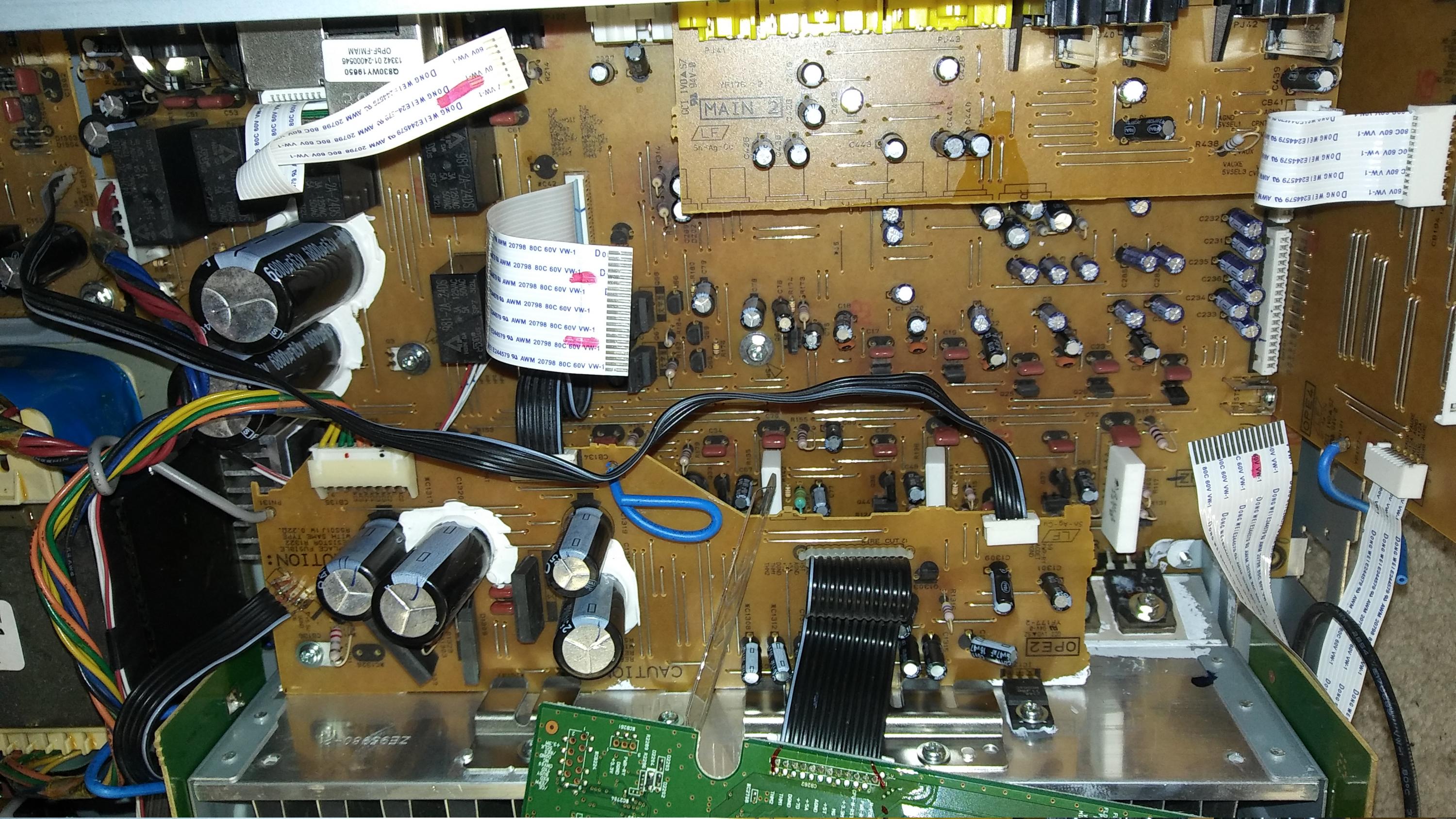

    By BaHa :Hi guys! For the ones who has the RX-V375, after suffering for hours, following circuits, tracks, cables, checking voltages, signals... I finally found out how to "fix" (it wasn't damaged, just locked) mine!! Just press and hold buttons TONE, INFO and POWER for 3 seconds (if it turns on in less than 3 seconds, don't release the buttons yet, hold them for 3s!), after that, turn the unit off on the Power button and turn it on again, it should work fine now (if nothing else is damaged inside). Good luck!
    https://www.badcaps.net/forum/showth...t=32444&page=3
    YES! Good luck! I try that still not work, I found two power Tr shorted, 2 badcaps, one loose connector and 100 of screws then MISSION COMPLETE.
