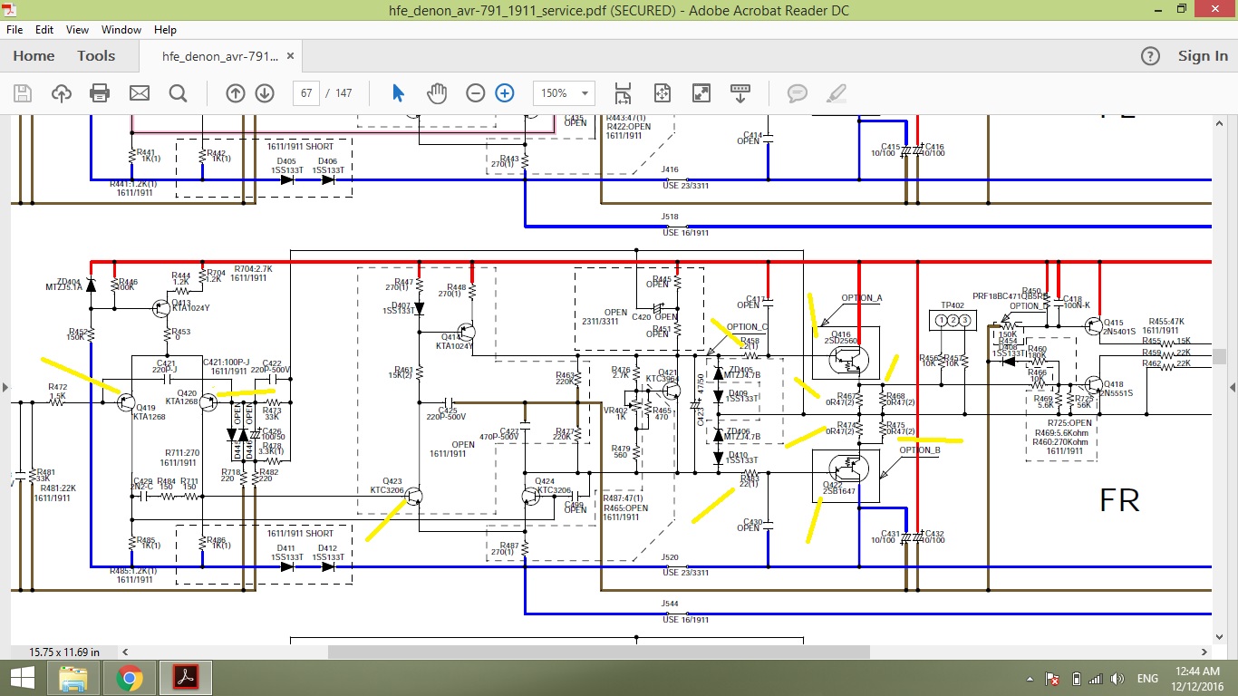

    Hello. I have Denon avr-1911. I like this amplifier, and hope to repair.
    Before 2 days led lamp on stand by begin to blink red. I open receiver and:
    1. FR chanell was blow. The power transistors 2SD2390/2SB1560 was shorted.
    ---I replace them with another darlington MN2488/MP1620. I think they are 100% equivalent with 2SD2390/2SB1560. If i wrong, please tell me.
    2. 4 resistors 0.47oms, also was open. I replace with 0.33oms (hope this is not problem).
    3. 2 resistors 22 oms, also was open. I replace it with same.
    4. I the last one three small transistors was short (KTA1268/KTC3206). I replace it with 2SC2240/2SA970. I think they are good equivalent.
    5. All zener diodes, all resistors, all trimers, all regulators are fine
    I try to reset the proccessor, but no result.
    I upload service manual. The bad channel is on 67 page.
    I hope for any suggestion :/.

    Check again all elements on the channel. Compare the values with the other working channels. Probably you've missed something.

      I would suggest the same thing. Also, I would use the .47 Ohm resistor and not the .33 Ohm.

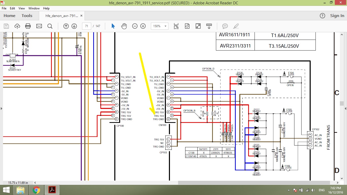

        Hi. I replace all parts with original, and the situaltion is the same. But i have question.
        What is ''TRG''? I have two pins ''TRG 15V'', but i have 12.10V. All diods /d124, d125, d126, d145/ work fine.
        In all channel i have 4.2mv...which is perfect, but when i push the button combination, on the display i have ''DC Protect''....

          TRG usually stands for a "trigger" signal. It should go from 0v to 15v and back to 0v.

            Ok, you tell me 'trg'' go from 0v to 15v. I have 12.10v....is that correct value, or must have 15v?
