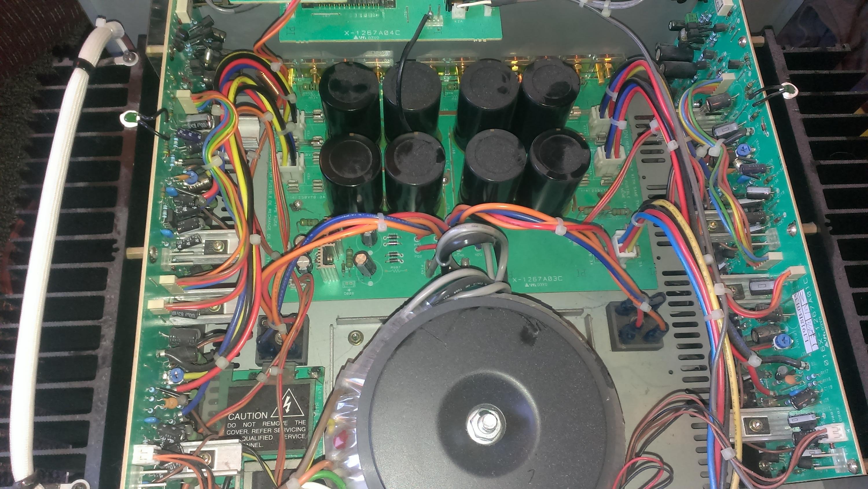

            Re: Rotel RMB-1075 blows left front fuse
            Pictures.
              If fuse 401 and 402 blow, you have a fault in the power amp that is connected to P4 & N4 Left front (last power amp on the last page) If you don't have a shorted output or open emiter resistor, the you could have either a shorted or leaky driver transistor in that circuit.
              Those fuses supply the L.F. amp and if they blow then your fault is too much current draw through the fuse, You could try compairing resistances between the L.F. amp section and the Center amp section at the top of that page (3** component markings)
              Without a variac it could be hard to troubleshoot, what I would do is slowly turn up the variac while I checked the voltage at S4B to ground, It should be 0 volts, if its higher I would would also note if its positve or negative with respect to ground, then I would know what part of the circuit had the bad bias problem.
              If the outputs and the .22 res. check ok then something before them is turning the output transistors on full. and that will take the B+ (or B-) supply to ground blowing the fuse

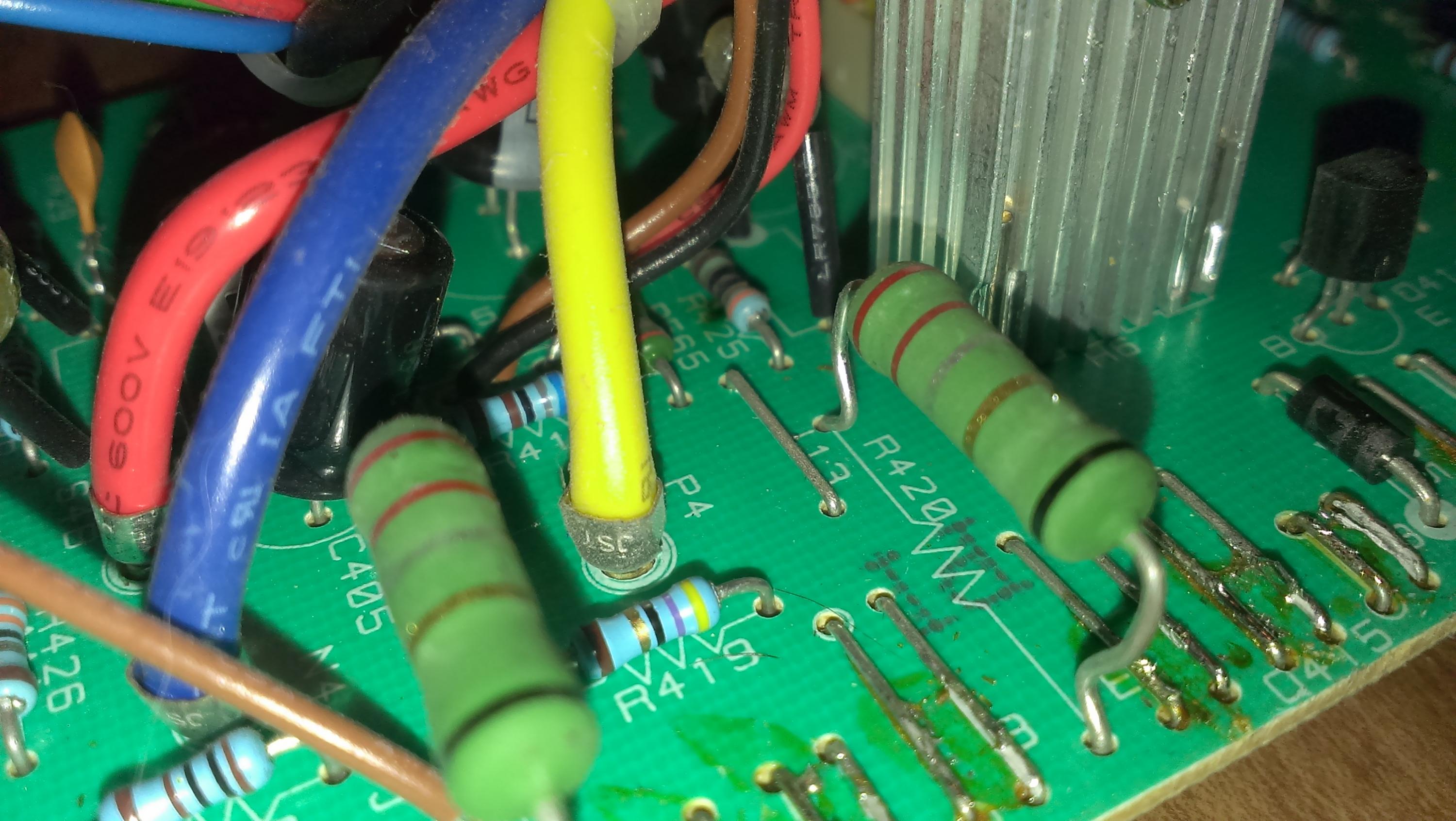

                                    I tested everything on the board. Driver transistors are ok. diodes are ok. The only other fault is the R425. Any idea how to find the value for replacement? I'm thinking it's either 33ohm or 330 ohm but no idea on the wattage.
                                      It's a 33 ohm metal film, (see schematic) not seeing it I would guess 1/2 watt. measure the voltage drop accross the same resistor (any of these: R125, r126, R225, R226, R325, R326 ) in one of the working amp circuits, ohms law will give you the wattage
                                      • zacheriaj
                                        • Jan 2014
                                        • 138
                                        Originally posted by R_J
                                        It's a 33 ohm metal film, (see schematic) not seeing it I would guess either 1/2 watt or maybe 1 watt . measure the voltage drop accross the same resistor (any of these: R125, r126, R225, R226, R325, R326 ) in one of the working amp circuits, ohms law will give you the wattage
                                        It is shown in this picture. I have it pulled now but can't see the middle color codes.
