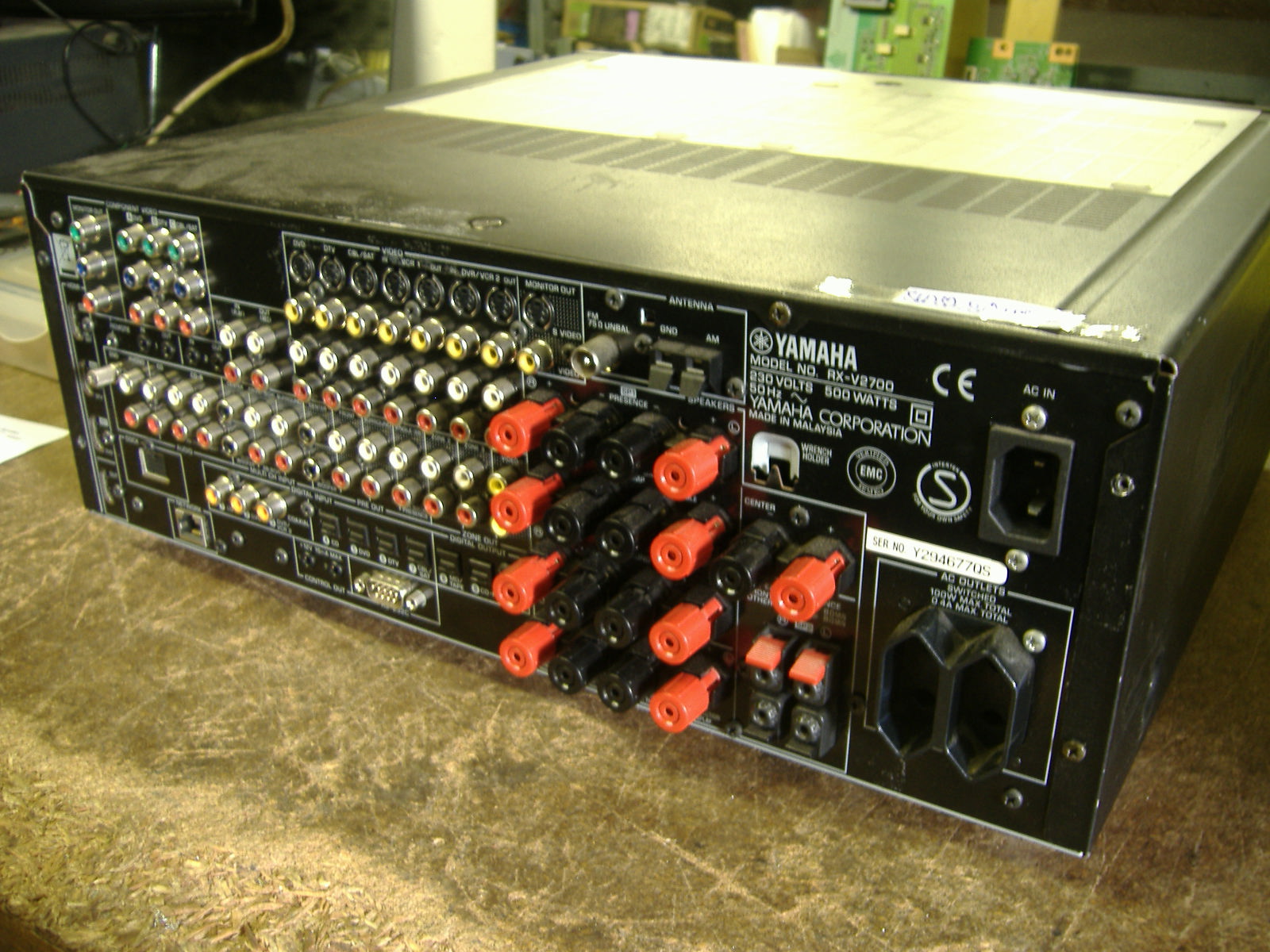

    Morning guys 10H48 here in sunny S.A. My work is kinda up to date, so I'm dedicating my whole day to this amplifier.
    I'm taking a chance here because i haven't even opened this set. The owner said he took it to another repairer who quoted him 2500ZAR just for the faulty module. So I thought if any body else has had this fault on this amplifier, they could give me a few pointers. ( Stereo sound okay---crackles in surround mode.)
    I'm primarily a television tech (appyship on radar station repairing ppi's), so audio not my forte. Any help please.

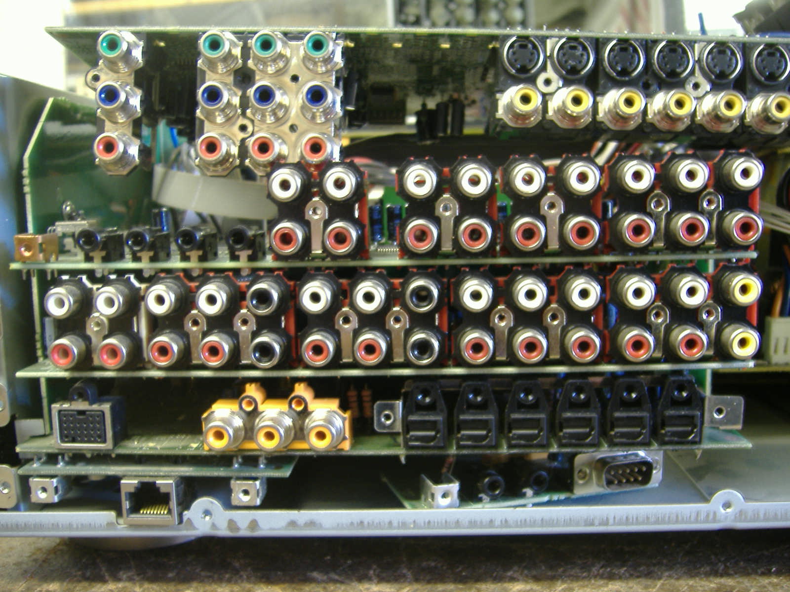

          Yes charis, seems to be either the customers cable or player. I dont have a multi channel player, so I just used a stereo signal to input into the SURROUND input and swapped my speakers to the SURROUND speakers----no crackle.
          I did the same for the CENTRE, and FRONT----- no crackle.
          I see an input for the sub woofer, but no speaker terminals for sub woofer??
          Also how do I get audio out of the SURROUND BACK/ BI AMP terminals??
          Also how do I get audio out of the PRESENCE SP1 & SP2 terminals??

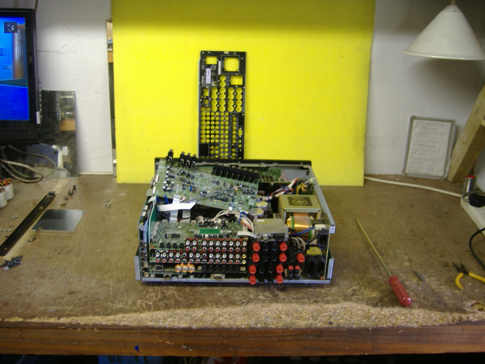

            Follow up: Spoke to owner, said turn up volume and listen to audio between tracks on a cd. Connected FRONT & SURROUND speakers, cranked up the volume, and there is a SLIGHT hum (NOT crackle) more so on the SURROUND than on the FRONT speakers.
            Not sure of signal to noise ratios on this amp, will rather refund deposit and refer customer to Yammy agent. He swings past tomorrow, so will post outcome later.

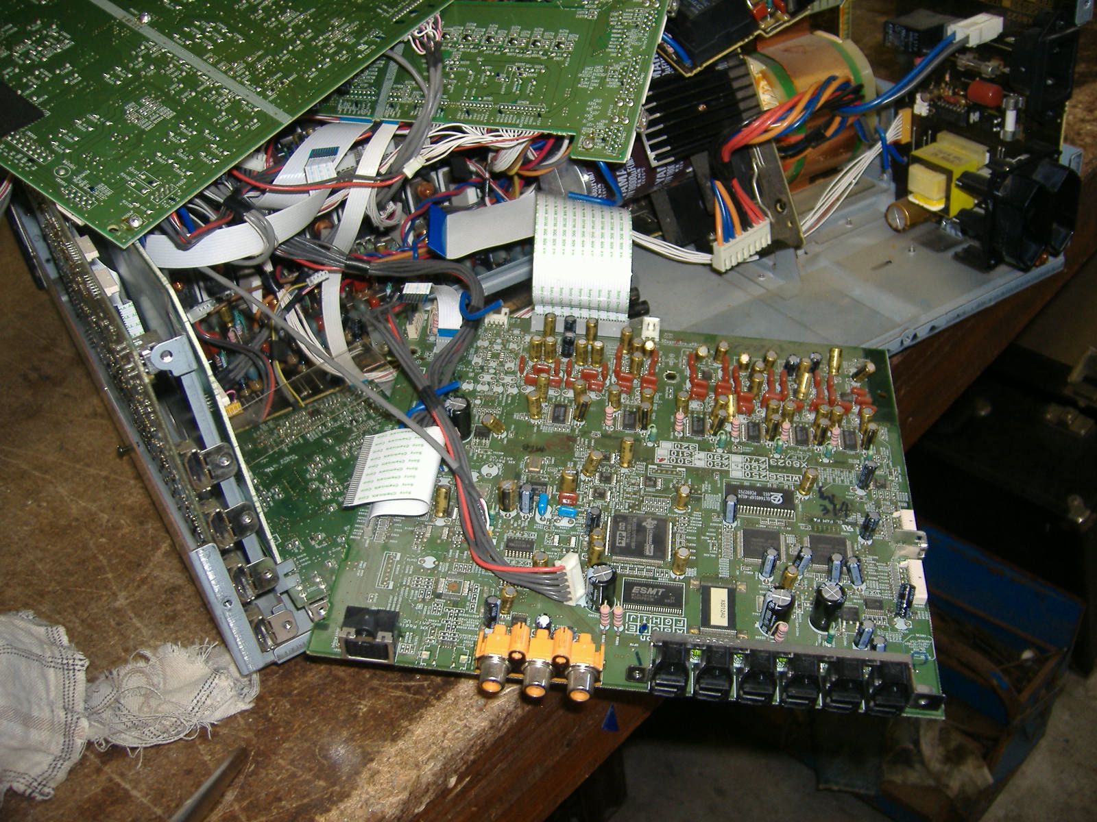

                Hi charis, thanks, the owner came in and demonstrated that in either Stereo or Pure direct the sound is fine. only when choosing Cinema, Hall or other processing that there is an audible noise on one Channel.
                This also confirms with what the audio technician at Yamaha said yesterday, that the DSP module is faulty. Today I will get Price & Availability to see if the job is do-able.
                A bit of concern is that the customer says he connected ALL of his surround speakers in parallel and plugged it into the FRONT speaker output.(maybe Barbarian is too strong a word to use) To top it off, the cabinet where the amplifier resides has inadequate ventilation and has to run with external fan when amp driven hard for extended periods.
                I'm hoping job is rejected when I get P & A. (sorry to say). Will see as day progresses (Half Ten in the Morning here/ at posting)

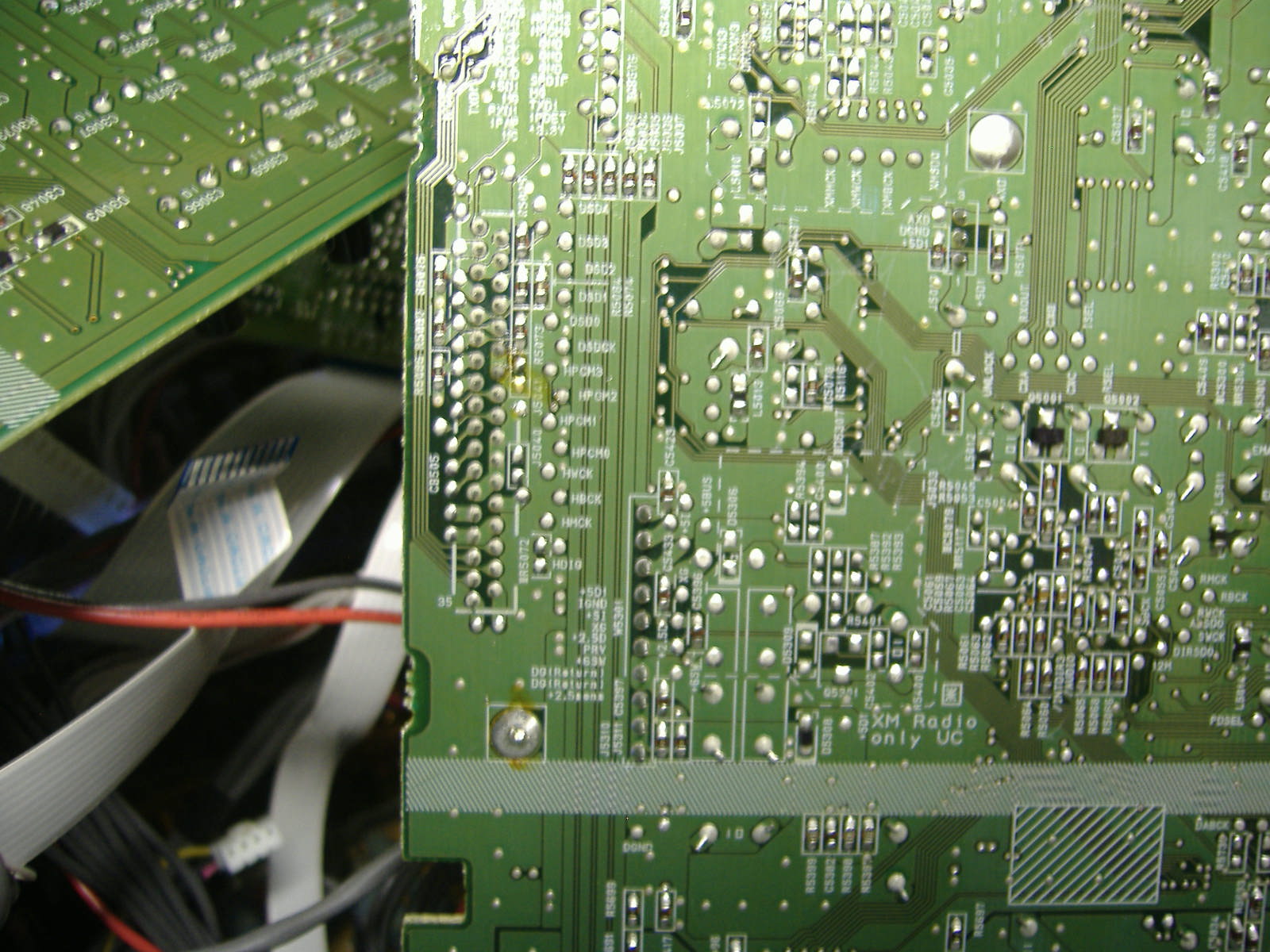

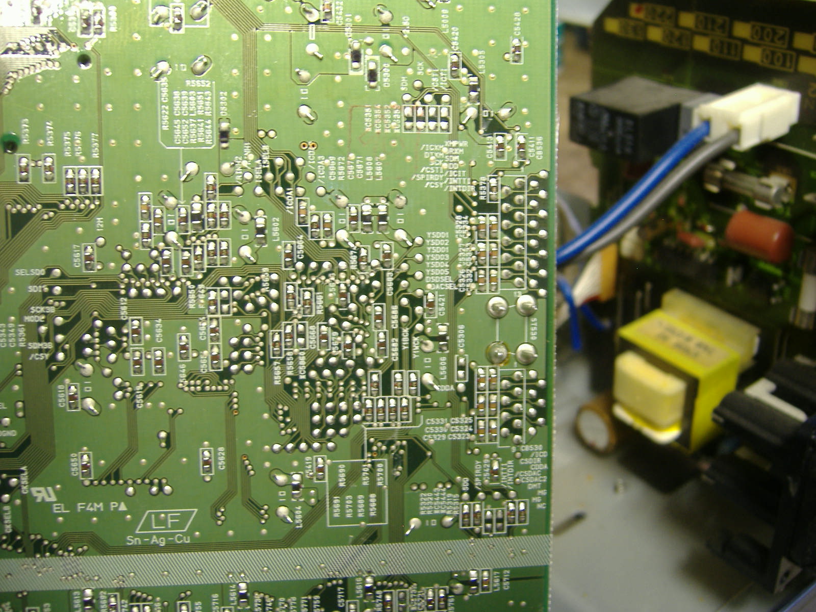

                  Much later, removed DSP pcb, resoldered poor looking connector plugs, & reassembled. No joy, still has distortion when entering any of the digitally processed effects like hall, club, stadium, etc.
                  Many caps to check/replace. Is it worth the effort? Have heard that the ceramic capacitors could also be an issue.
