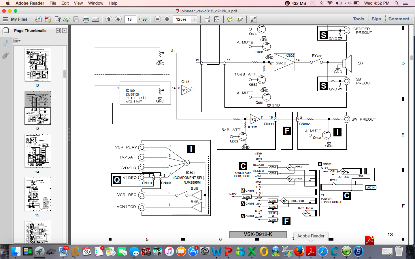

    I don't do a lot of repairs on audio equipment. I have a pioneer receiver that is dead, no power/standby. I get all my voltages on the AC side, nothing on DC. I get power going into transformer T51 but nothing after. I get no DC on either the power transformer or standby transformer.
    I removed IC51, the 5.6v regulator and it tested good. I also removed and tested the relay and it is good. I attached a screenshot of the block diagram and the service manual. Could someone please give me some advice?
    thanks

    duh, I forgot to change my meter to AC when testing the output of the transformers. Both transformers have AC voltage at the outputs.

      Re: Pioneer VSX-D812 Dead
      Check "AC RY" and "AC WUP" signals.
      You should also check voltage on power switch S505 to see if there is +2.4v

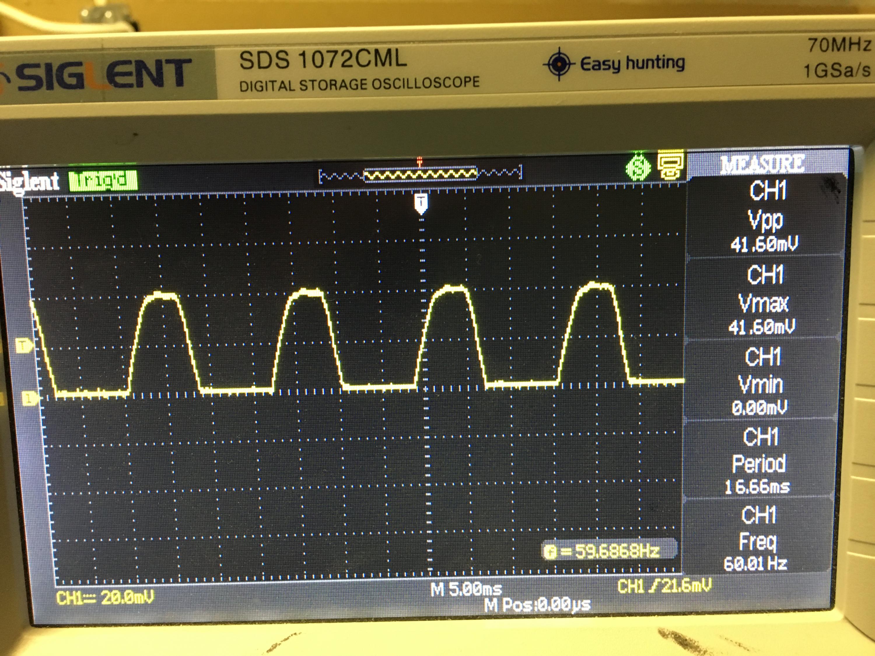

          I get nothing on the AC RY pin, but I do get a signal on the AC WUP pin. See pic below.
          I get no voltage on S505.
          Does AC RY stand for AC relay?
            Yes, AC RY is for AC relay.
            Since you have no volt on S505, you need to check volt on pin 22 of IC401 or its power supply, VDD, L401 and D401.
            If you have no voltage on S505, you can't turn unit on.
