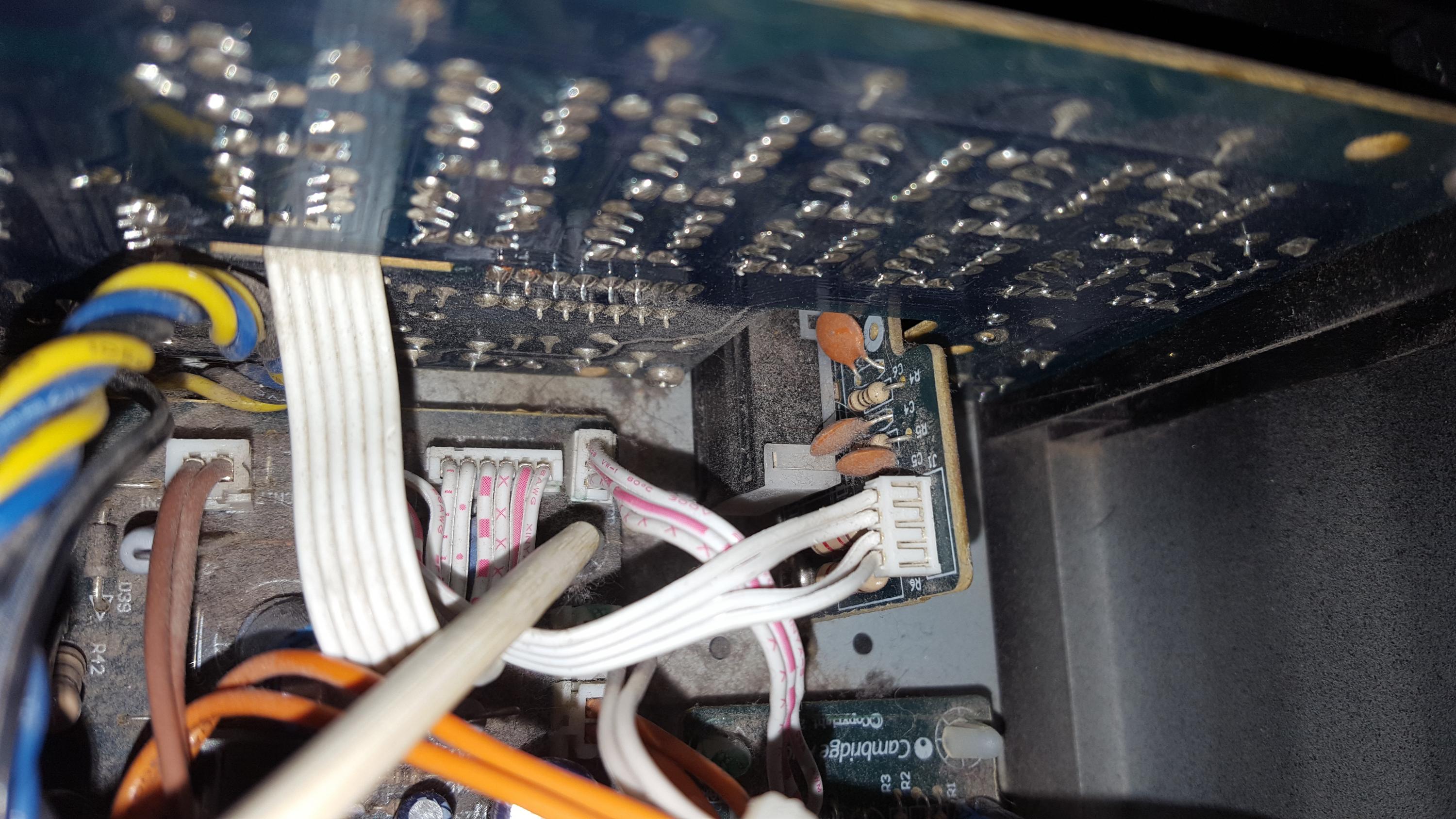

      Re: Cambridge Audio Azur 540R v2.0 repair, no sound
      I'm now working on one of those and just got one of that WTF moments... the damn thing produces sound! No, no what you think! No speakers hooked upped to the unit, no headphones connected.. just the bare unit with a wire for FM antenna. Powered it up and it started to play music... I'm not joking!
      The sound seems to be coming from somewhere around the power supply boards....
      Anyone seeing/hearing something like this?

              • madan1
                • Nov 2016
                • 670
                • Bulgaria
                p.s. Here is the service manual.
                    Well, I see the logic here... but big "no, no".
                    Weird or not, it seems that the ceramic caps on the headphone pcb are singing!
                    Just googled for singing ceramic caps and it seems that it is not such an uncommon thing.
