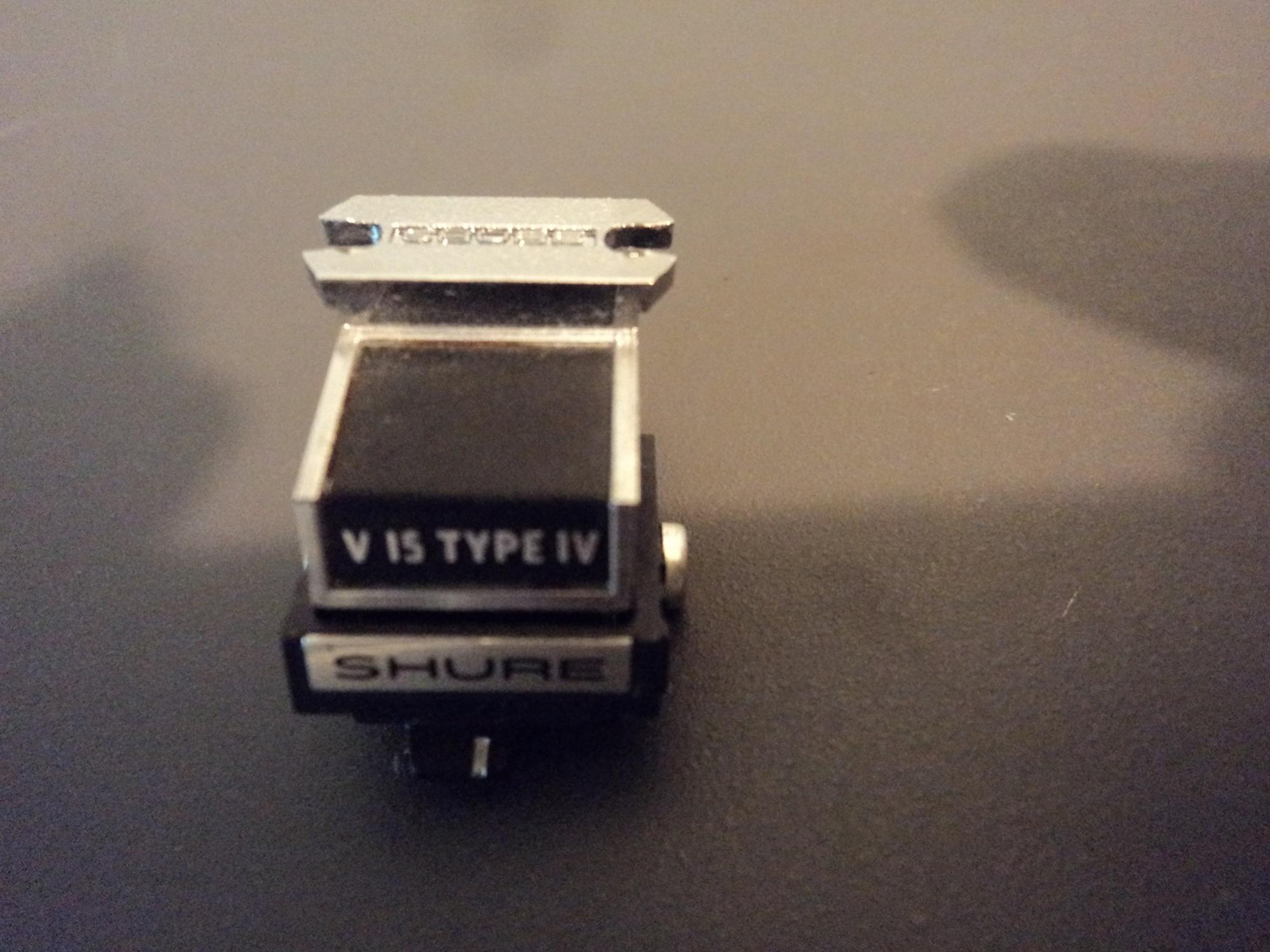

    Checking ebay for my parts I found another one for $200 less than all the others and supposedly working. I thought at worst it could be a parts unit since I couldn't get the wood end piece. It seems to be in good shape though. I might use it with a Sansui AU-717 integrated amp. Surprise surprise, it came with a Shure V15 TYPE IV cartridge. No stylus though so I just ordered a hyper elliptical from JICO in Japan.
    I can't wait for it to come, it's like Christmas. The V15 is supposed to be about the best Moving Magnet (MM) ever made. The Sansui cartridges I got on the others are basically a rebadged Excell ES-70 and no slouch in their own right but not as well thought of as the Shure. They're Moving Iron too (MI).

    To continue the saga: I got the Jico in from Japan and it does make the Shure sing. Really nice sound. I'm still using it on the backup table.

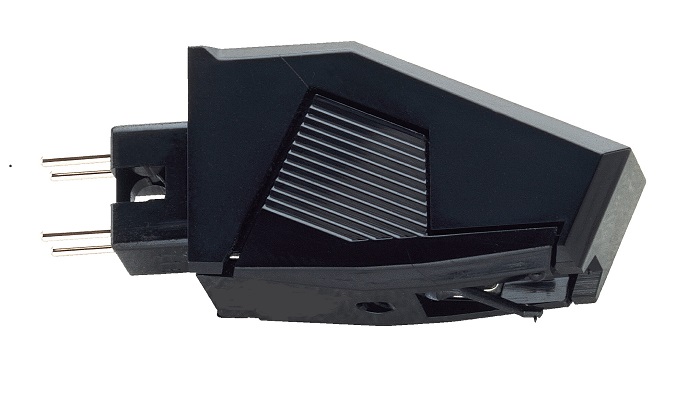

    I had an old Pickering cartridge with a new needle laying around, I put it in a headshell and mounted it. I've been listening to it for a few days now sitting on it's cans of chili. Waiting on that last transistor. It has 6 more transistors on the board, 945's I have plenty of them in stock.
