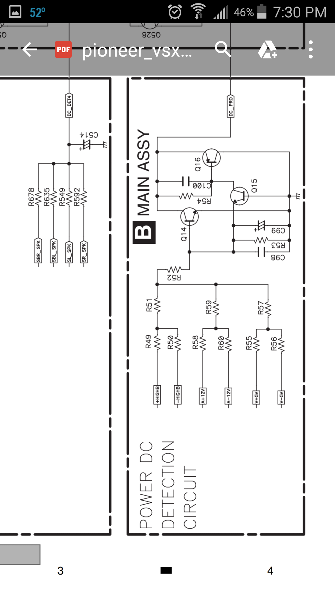

                        Well I think Ive narrowed it down to the unit going into power DC protect mode. 3 transistors on the main board on the very bottom and I'm going to have to dig in a little deeper and try to figure out why the protection circuit is being enabled

                          Hey tibimakai where is the thermal fuse located in the main transformer? I noticed you replaced them before. I have no ac voltage off the secondary side of the transformer. The little 3 pin connector with blue/black/blue connector. No voltage there.

                                  Problem resolved! Blown thermal fuse in the main transformer on the primary side. Checked the black and blue cable and sure enough the pins are open. Bypass for now but thermal fuse on order. My suspicions were correct along with other people. The guy I got it from probably had something on top of the receiver covering up the vent holes will he was blasting it loud.
