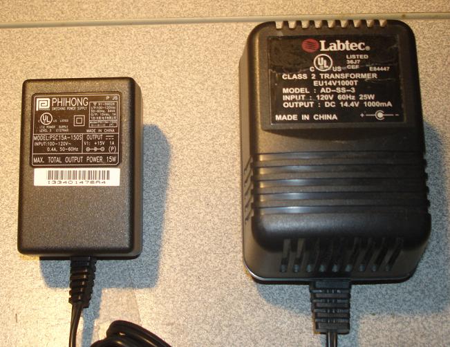

    For example take my Labtec 2.0 speaker system with a 1 amp 15 volt linear adapter that thing was probably more expensive then the unit was to manufacture. Why did Labtec choose that over a cheaper switcher?
    Take a look at the comparison pics the respective switcher is next to it and I'm not even going to get into the weight difference.
    The only downside I can think of is high frequency noise but most switchers operate out of the range of human hearing anyways.
    So what's the big deal?

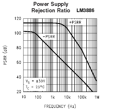

        PSRR is the ratio of the change in supply voltage to the change in output voltage of the (amp) caused by the change in the power supply.
        The PSRR of a typical integrated chipamp (let alone discrete designs) is much worse at increasing power (noise) frequency. If you are lucky you can see this as it specifically relates to the chip in your speaker set, if that chip datasheet graphs this.
        The frequency of the switcher doesn't have to be down in the audible range, rather the dirty power effects the *accuracy* of the amplification.
        With typical at-home audio gear the size and weight differences aren't that much, and a switcher is a less reliable PSU (the basis for this website is failing switching power supply caps?), particularly when seen over decades rather than the short expected lifespan of a computer or especially other lower cost consumer electronics.
        Plus most of the high frequency noise is filtered out in a well built switcher
        Relatively speaking, a switcher still has very noisey output (you can add more complex output filters of course but then they start growing in size, cost, weight, till the former held advantages are just about gone), they are typically used in digital circuits instead of analog where the precise voltage isn't as important as that it just be within a certain threshold(s).
        That particular Labtec amp and speakers may not be the greatest, the difference in sound from an unregulated, linear, or switching PSU may not be as great in this situation as some - and you can listen yourself to hear if the result meets with your approval.
        Here's an example of a (LM3886) chipamp PSRR graph, notice what a big difference there is between the AC line frequency range and up around 50KHz which might be roughly the frequency of a switching supply.

                                      The only advantage for switchers I see in audio equipment would be reduced weight, copper content, and better efficiency since linear transformers waste power as heat. I'm sure manufacturers would have already moved to switchers if they could to cut costs.
                                      There has to be a serious engineering issue in the way.
