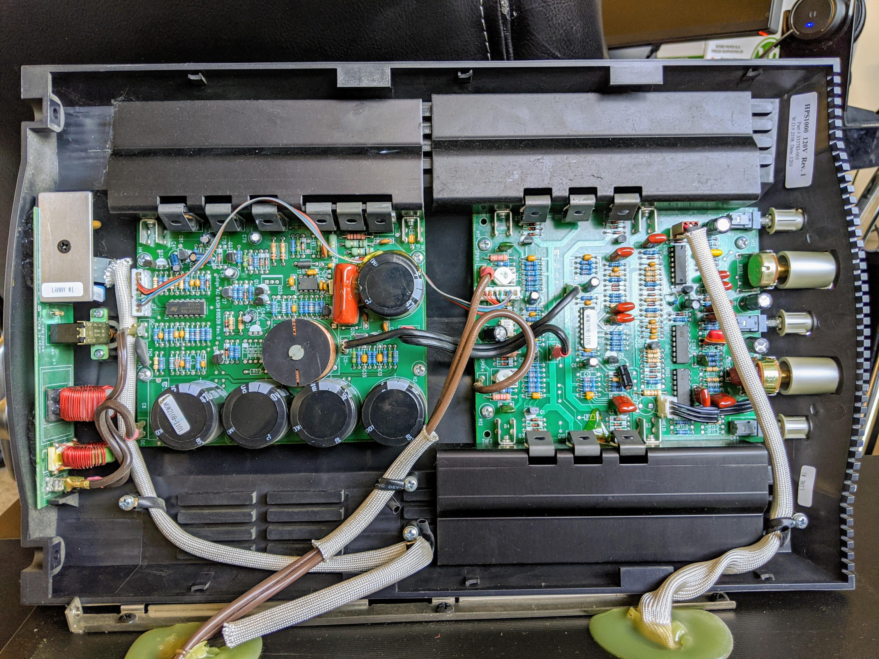

          My HPS-1000 no longer powers up. Fuse is fine and no visible damage on printer circuit board. It has been taking longer and longer to power up recently. I can't locate the manual "Infinity_HPS-1000_Service_Manual.pdf". I am thinking I need Nichicon UHE1H220MDD 22µf/50v as well, but where is C4 and C6 located at exactly, please?
            Re: Infinity HPS-1000 15" Powered Subwoofer Troubleshooting Help
            Here is a picture of the plate amp in my HPS-1000. Thank you for any assistance in locating C4 and C6.
              C4 is on the power supply board (the left board in your picture), it is next to C54 which is not installed.
              C6 is on the pre-amp board (the right board in your picture), it is located to the right of C64.
                    I see them plainly now. Thank you for pointing them out! Will post result after re-capping.
