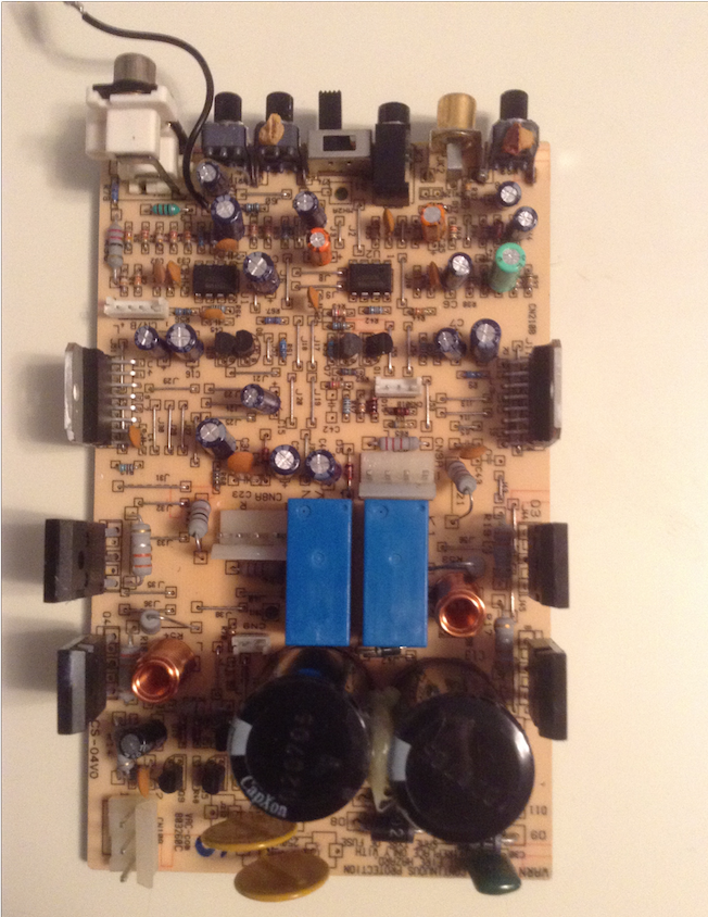

              budm, I'm not sure but do you want an overheard photo of the card and two sides so you can see the transistors? If not I don't know what you mean by the bottom.
              Anyway, I'm sending the overhead now. The front is where the two large caps(6800 mfs)are. Behind them are what I think are relays for each channel.
              Starting from front to back there are three pairs of transistors. The first pair, the ones closest to the large caps are: MOSPEC 2SB817E, HO7B the second pair are: MOSPEC 2SD1047E, HD6B, the last pair, the ones closest to the back are:TDA7296 388 D20230. This pair has 8/7 terminals whereas the first two have three. I have researched these and I think I have substitutes for these pending confirmation and input from the Forum members.
              The three prong terminal at the front lower left connect to the secondary of the transformer. With the two large caps you can see some semisoft plastic material in between them. I assume this is to keep the two caps stationary and connected to each other and nothing to do with its' function nor is it seepage.
              Here is the top view.

                I hope this is the top view

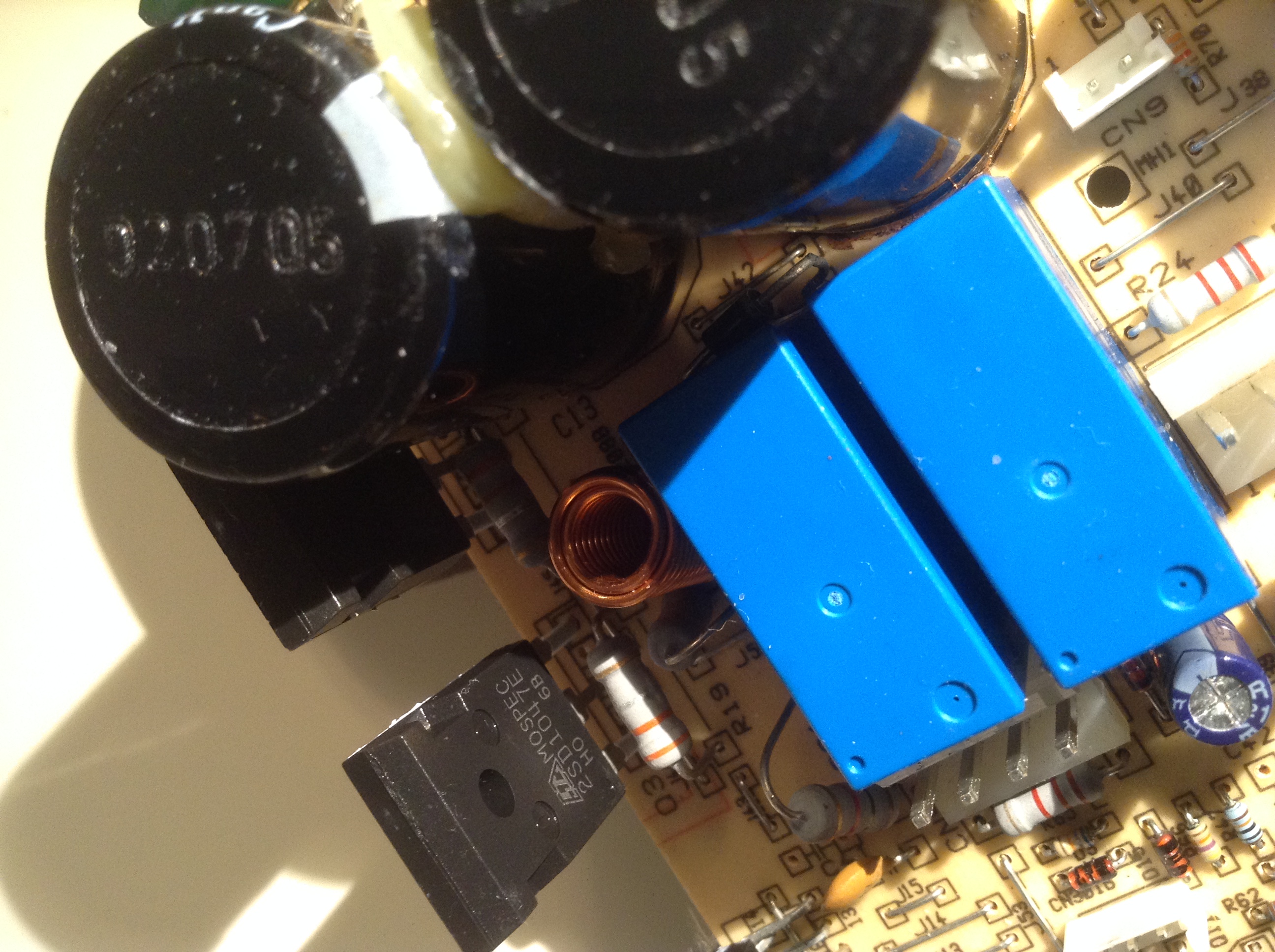

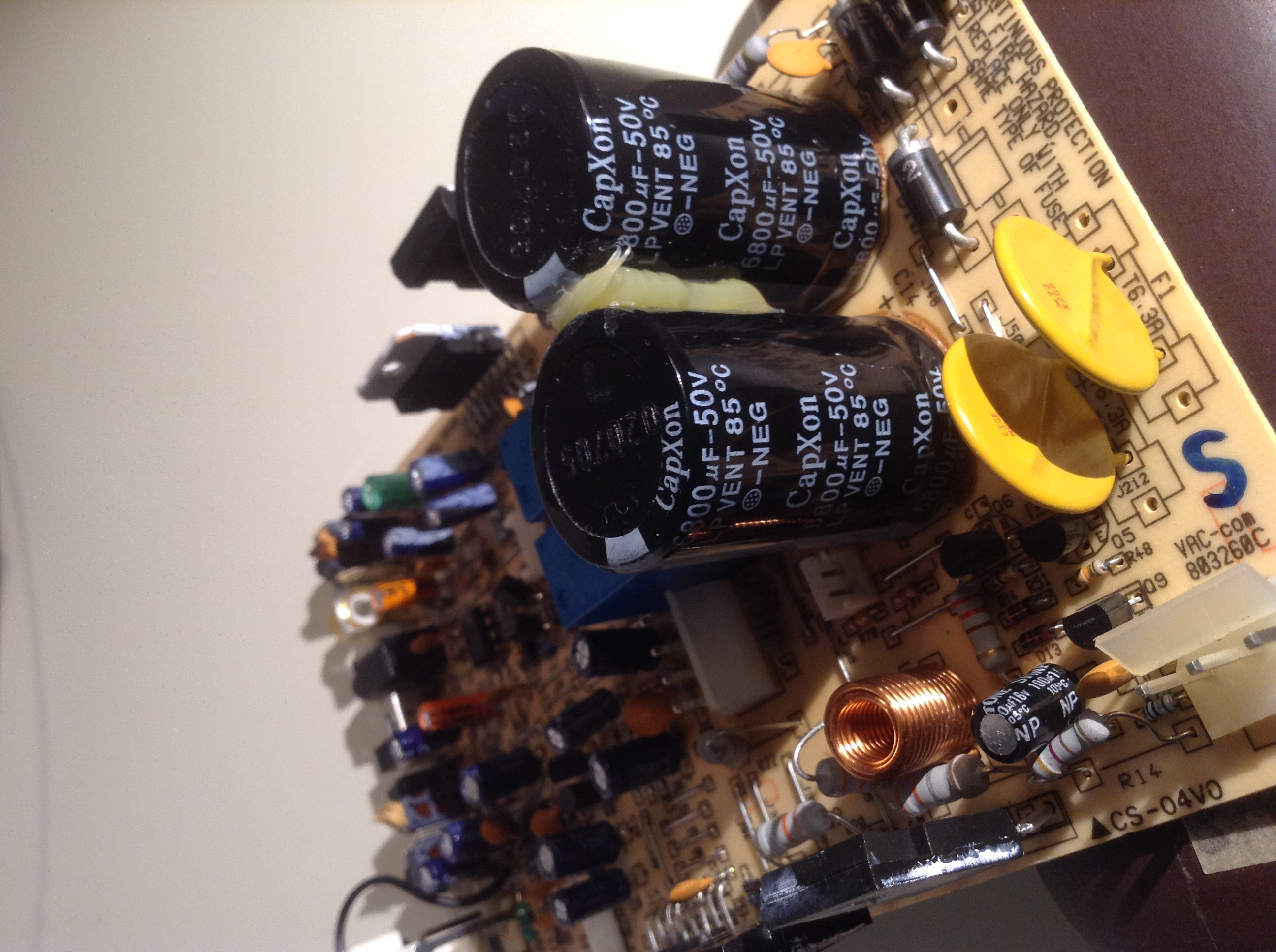

                    I forgot to add, the caps all look good, no bulging or leakage. Except for the large two caps, there is a small amount of hard(dry) light brown material around the bottom. I don't know if this is leakage around the bottom or something that helps its' functioning.

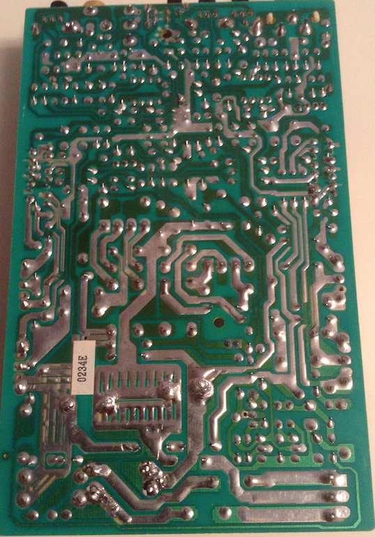

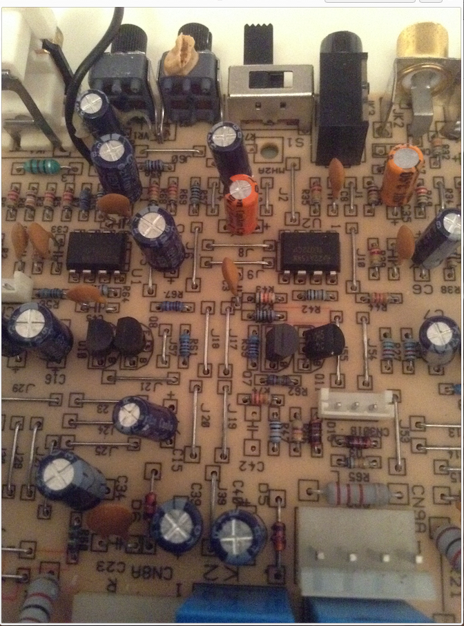

                      OK, you go the picture of the top side of the board, now we need the bottom side of the board so we can see the traces of the board.
                      You should also check the resistance between the Collector and the Emitter of those four big transistors (2SB817E, 2SD1047E) to see if they have low resistance.

                        More pictures.

                          Closer look at caps.

                            Re: Sherbourn 2-100A Amplifier
                            Closer look

                              Here is the underside.
