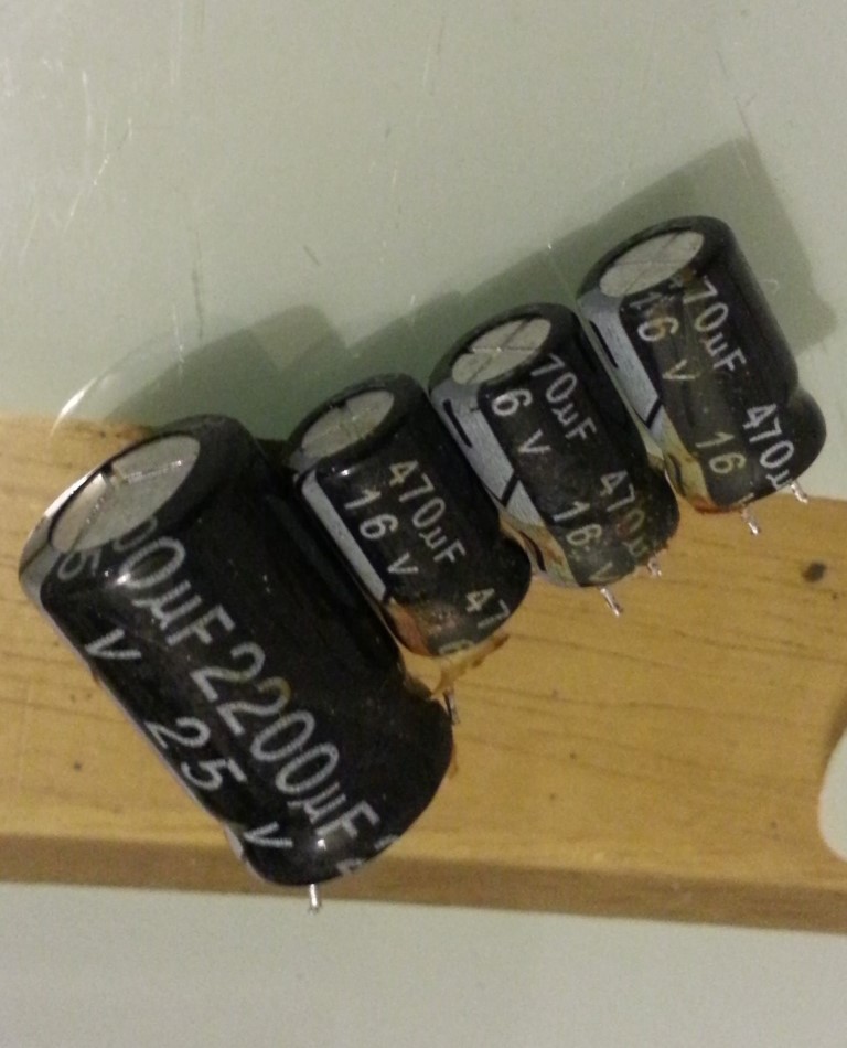

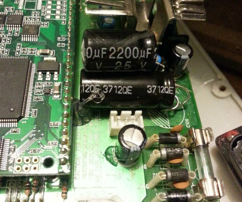

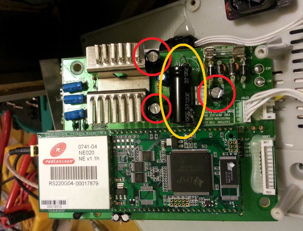

    Took the back off and surprise surprise, 4x bulging and leaking capacitors.
    There are 3x 470uF 16v caps (circled red in pics) and 1x 2200uF 25v cap (circled yellow) that were bad. Both radios had the 1.6A 20mm glass fuse blown also. The caps fitted to both were branded 'KSC' and '-40 to +105 degrees C'.
    I replaced the caps with some Panasonic FR series caps (105 deg.), they were the cheapest branded caps I could find and I think are suitable - they work fine so far anyway - I am sure someone will mention some alternatives if I am wrong! There was also quite a bit of electrolyte on the PCB that I cleaned off before fitting the new caps.
    The 2200uF Panny cap I used as a replacement was quite a bit taller than the original cap and would not fit upright, as you can see from the pics I fitted it laid down with a dab of hot glue to secure it. I would be surprised if the original cap was actually rated correctly as it was the same diameter as the Panny replacement but was approx 10mm shorter!
    Both radios are now working fine again with no crackling. I have currently got 1a fuses fitted until my replacement 1.6a ones arrive!

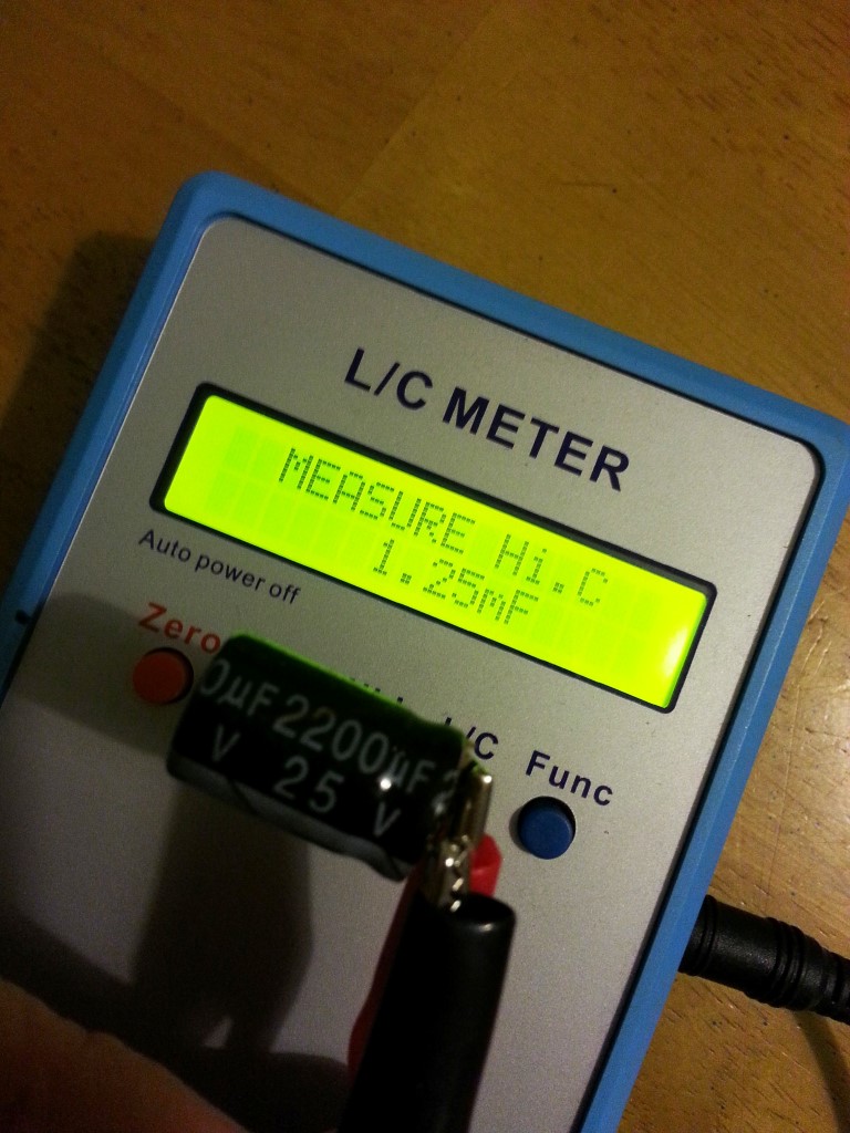

    The three old 470uF caps measured around 410uF and the 2200uF measured 1250uF.

    Re: Intempo PG-02 DAB Radio Repair (dead, crackling sound, no power, faulty)
    pany FR are the best you can get.
    good first choice!!
      Thanks stj, good to know my choice of replacement caps was a good one. I did a bit of research and they seemed like the ones to go for, but it's good to actually hear it from someone knowledgeable!
