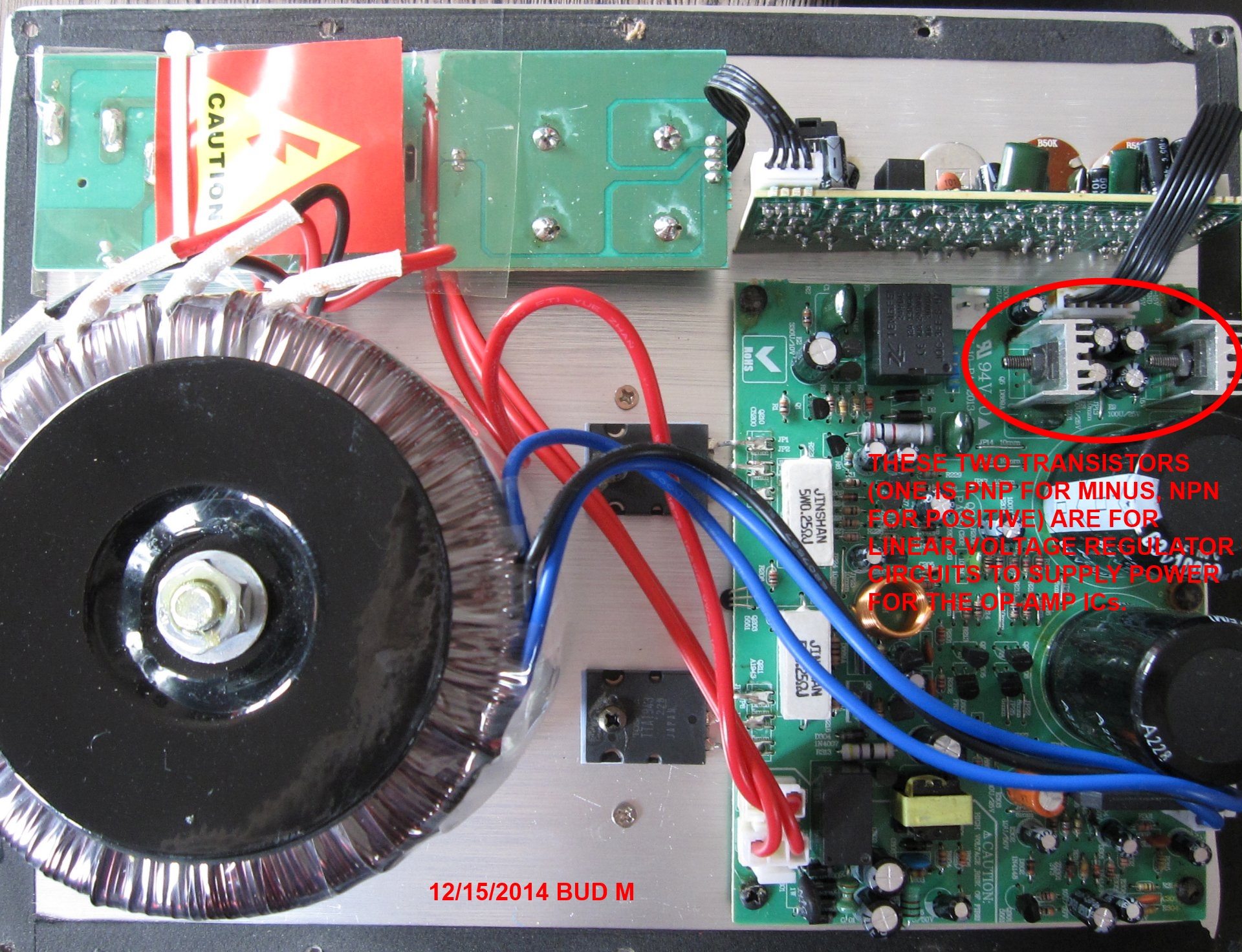

                            Re: Subwoofer auto on/off: Taga Harmony Platinum SW-10 v.2
                            I found more damaged stuff. The top left transistor on this link, with the heatsink attached to it, blew up as well.
                            https://www.badcaps.net/forum/attach...8&d=1414001830
                            I identified it as a B649A. I'll order it but could take a while (cheapest was China post).
                            Looking at the top of the board, there's a resistor and ZD02 (15V) positioned between the transistor and the group of 4 caps. They look burnt from the explosion.
                            The resistor is a 15K but measuring it made me confused.
                            If I measure with the multimeter set to 200M, I measure it at 1 MOhm
                            If I measure with the multimeter set to 2M, I measure it at 0,11 MOhm
                            If I measure with the multimeter set to 200K, I measure it at 0,9 MOhm
                            If I measure with the multimeter set to 20K, I measure it at 0,75 MOhm and when I measure again after a few seconds it's suddenly 0,05 MOhm.
                            So then I measure at 200K and the result is suddenly 2K...
                            So I'll replace it with a new 15K resistor.
                            The Zener Diode I don't know well how to test. I don't have a PSU. I used the "diode test" of my multimeter to test it in-circuit and got a beep signal when measuring both directions. Does this mean that it's shorted?
                            One of the 4 caps (100 uF 25V) clearly took a hit from the blow. I'll replace that one too and I might do its neighbour as well while I'm busy.
                            It's good that I quite enjoy doing this stuff, else I might be a bit frustrated by now
                              #94
                              It sounds like the power amp section has the problem, that may explained why it blew the main fuse last time, something was failing and finally blew up.
                              2SB649 is the full number for this PNP transistor.

                                        OK I look at the pictures of the main board, the transistor is used for the linear regulator (Negative), part of the +/- power supply for the OP-AMP, the other transistor should be NPN type for the positive Voltage regulator.
                                        So that explained why the filter cap on the pre amp board blew up due to over voltage when the regulator shorted out and dumped 30~40V on that small filter cap.
                                        There should be 12~15V Zener diode connected to the Base of the transistor, I hope that the ICs are not damaged by the over voltage.

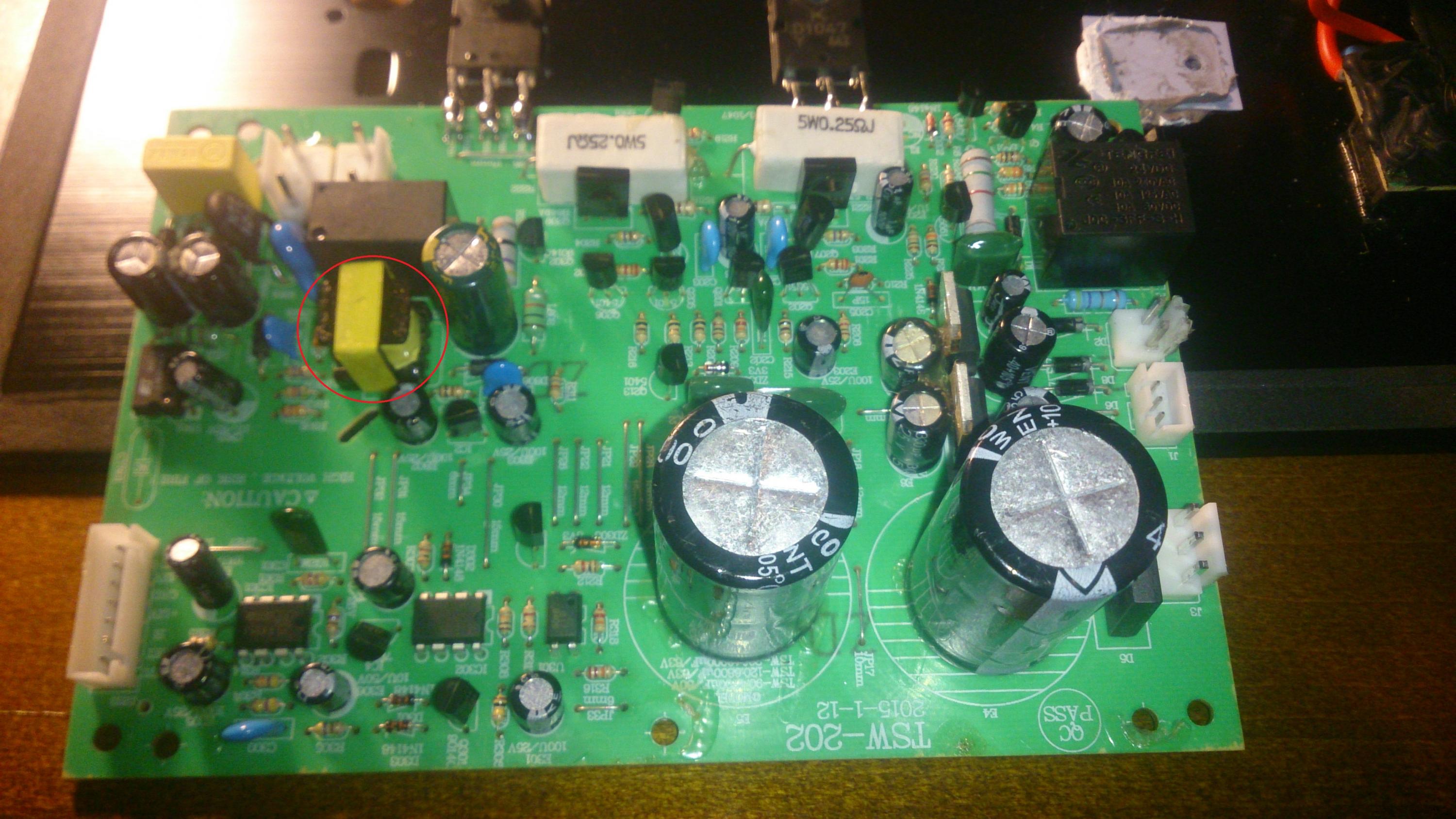

                                          • france
                                          #100
                                          Hi Guys
                                          I have a subwoofer taga tsw-90v3, which is damaged. I suspect this is the transformer in the red circle on the pictures, but he does not have any signs on the cover. How can I determine the model of this transformer?
