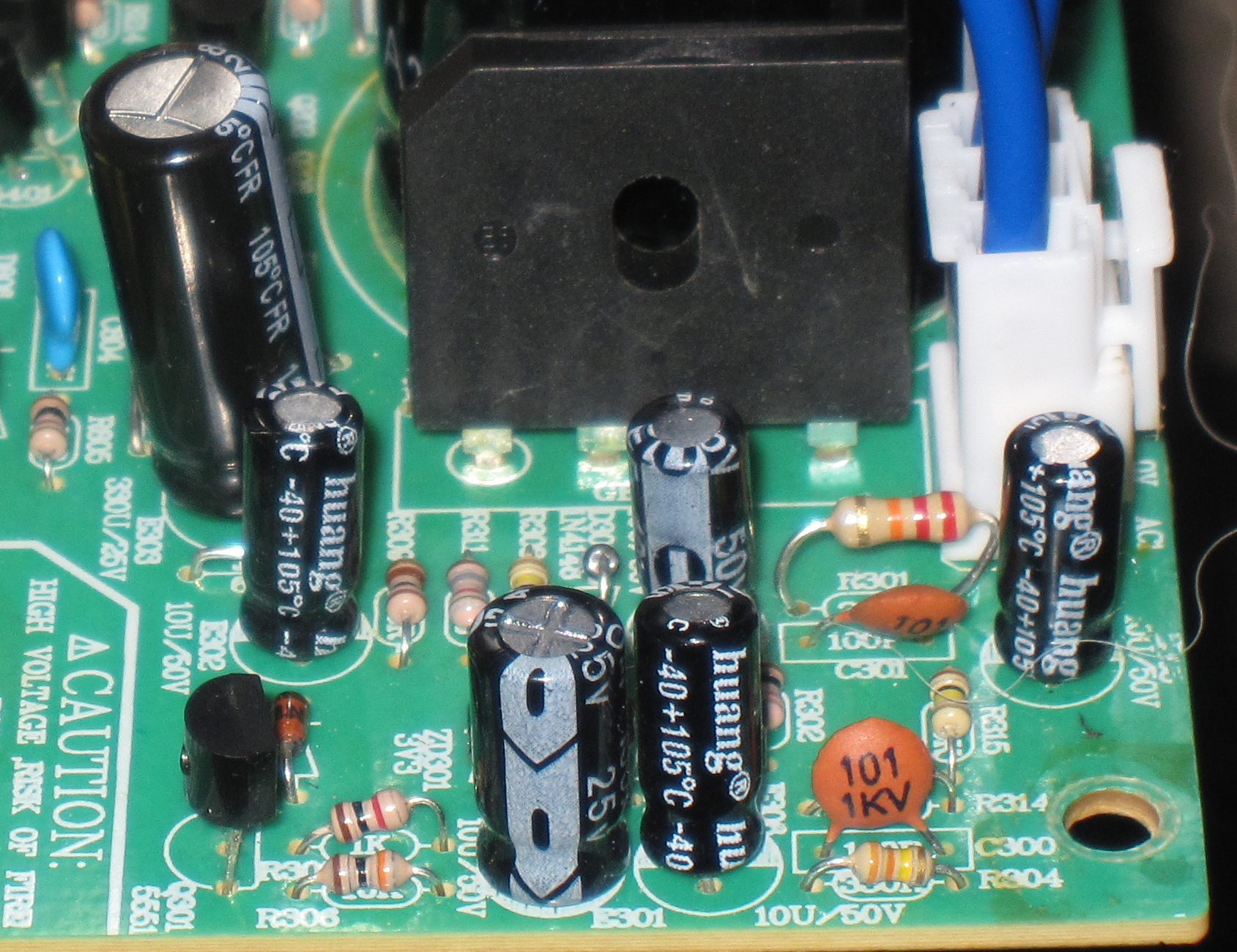

      Great news, I replaced the orange cap (330 uF) with a new 470 uF and that increased the standby timeout from 2 minutes to 4m15s. I'm super happy!
      Now to increase the timeout even more, could I safely replace that cap with a 560 or 680 uF one?
      I also bought some spares, among which some 150K and 680K resistors. I could potentially replace R310 (currently 330K) with one of these.
        Re: Subwoofer auto on/off: Taga Harmony Platinum SW-10 v.2
        Yes, you can use a larger capacitance but it will be easier to increase the resistor R310 330K to may be 680K which will double up the time or put in 1M pot so you can vary the time.
        BTW, did you check the capacitance of the 330uF to see if its capacitance has drop or it may have leakage current.
        BTW, the existing delayed time is 330K x 330uF = 108.9 seconds (about 2 minutes, which is why they said no problem found).

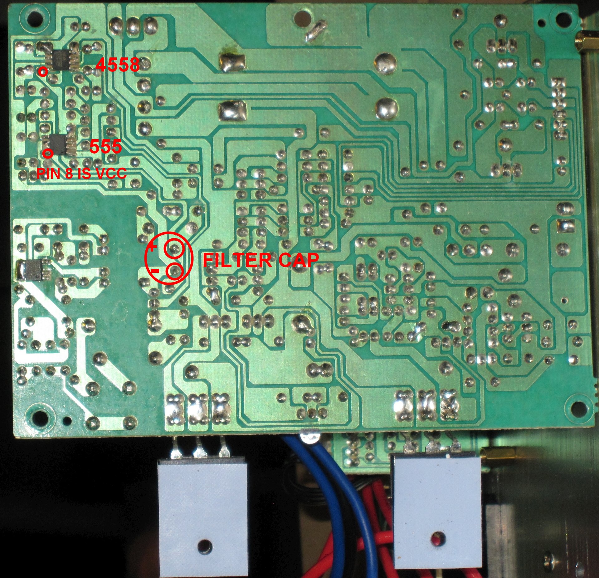

                          So you put the 22K back in place but the relay is still not kick in? Check the DC on the cap after the D301 to see if it has voltage to turn on the transistor, also check pin 8 of the opamp to make sure it has VCC.

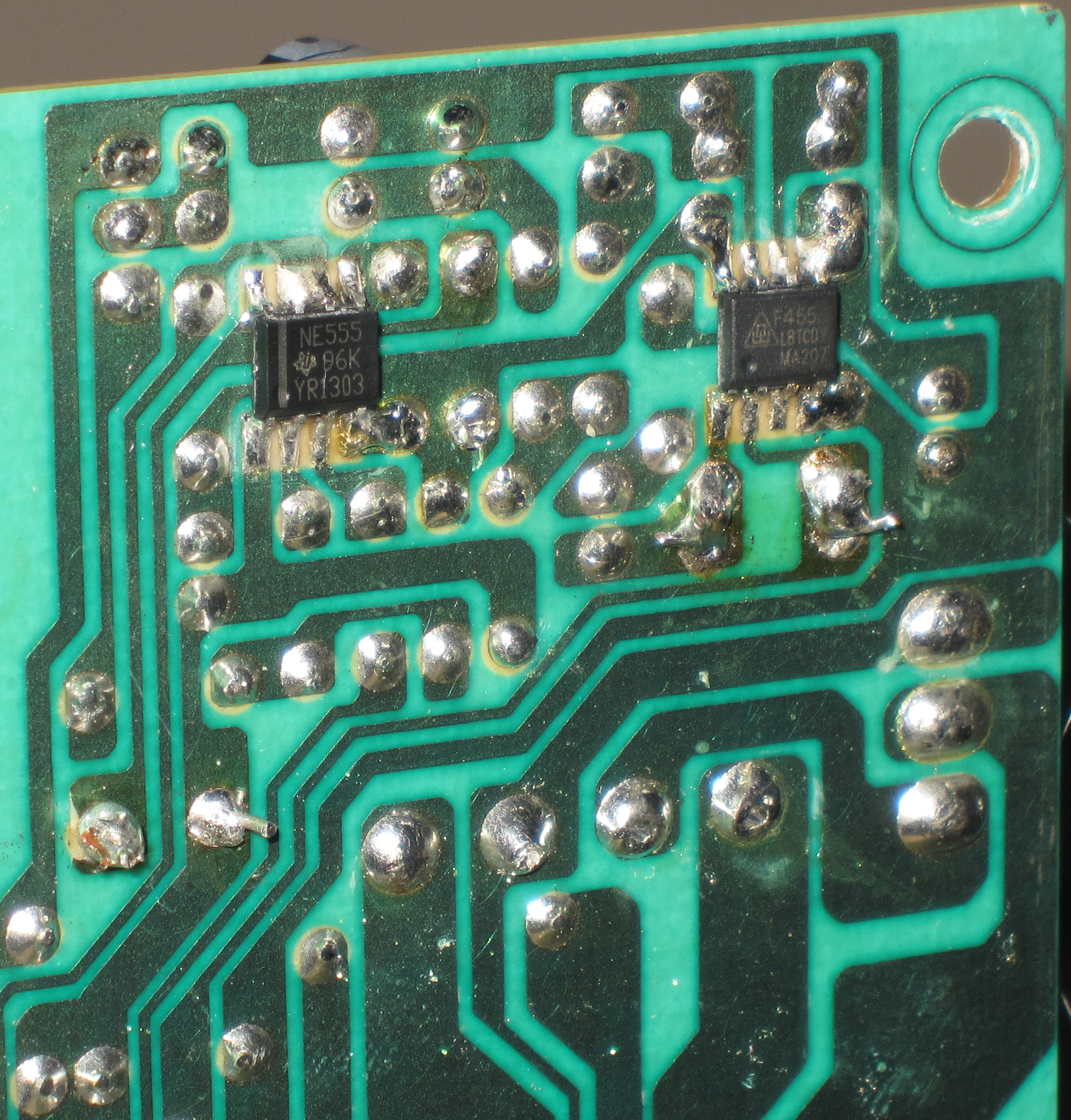

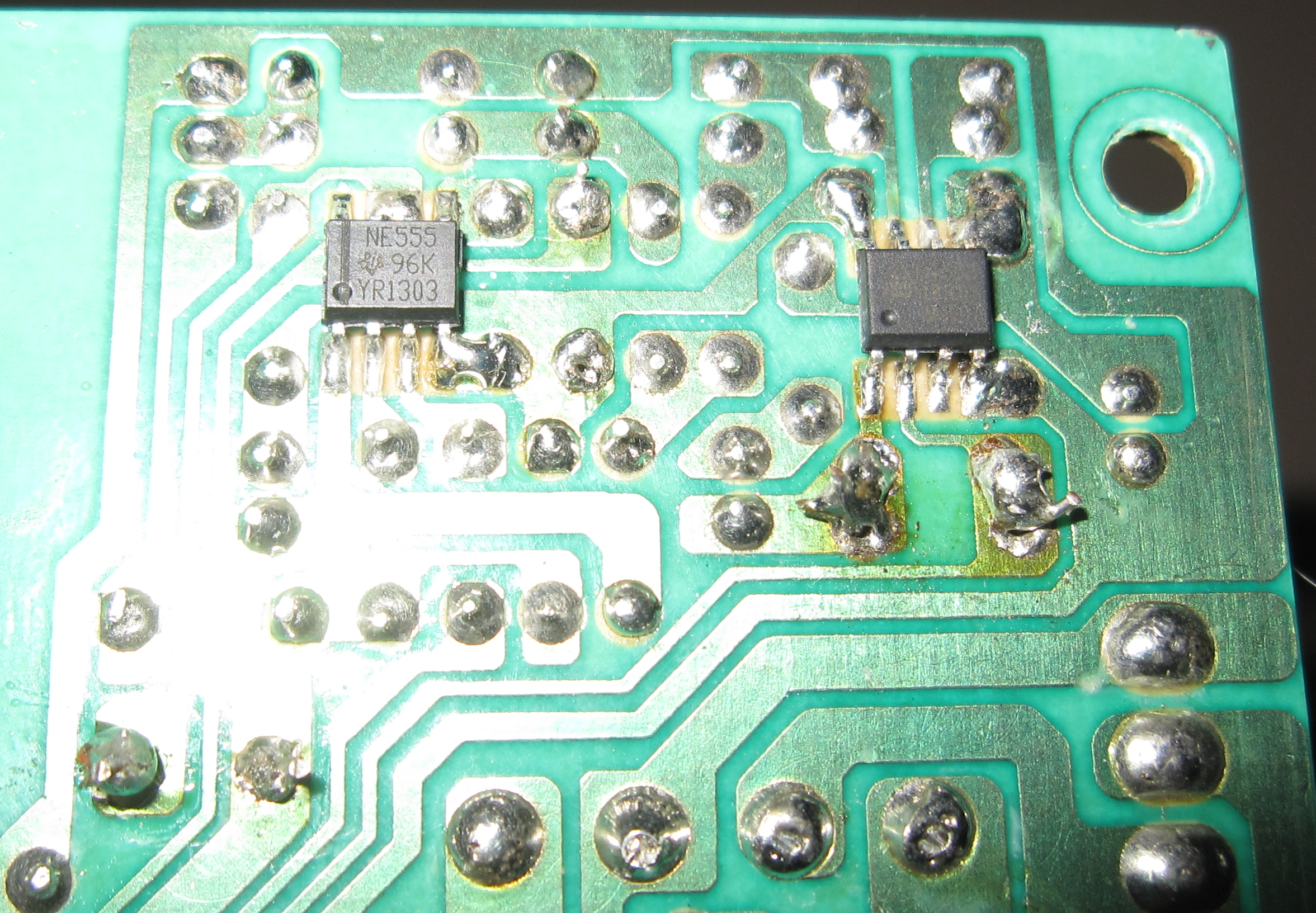

                              Can I see the pictures of that area you worked on may be I can spot soemthing? Right now it does not work is due to no Voltage to run the ICs.
                              • ihopethiswillfi
                                • Oct 2014
                                • 55
                                • Belgium
                                #35
                                Sure, here are the pictures. Nothing to be proud of, I know...
                                  OK, the VCC for both ICs in the timer circuits and the pre-amp are supplied from that filter cap as shown in the picture. So you need to find out if you have voltage at the two legs of the cap as shown.
                                    no voltage over that cap
                                      #38
                                      So that means the small switching power supply circuit, small transformer TR801 and a SMD IC close by, is not working. Changing that resistor should not cause the power supply to die.
                                      May be the cables that supplies the AC to the board are not seated or the fuse is blown.
                                      Please check the resistance on the two legs of that cap to see if it has very low resistance, the meter should show low resistance first and then as the cap is charged up, the resistance should rise.
