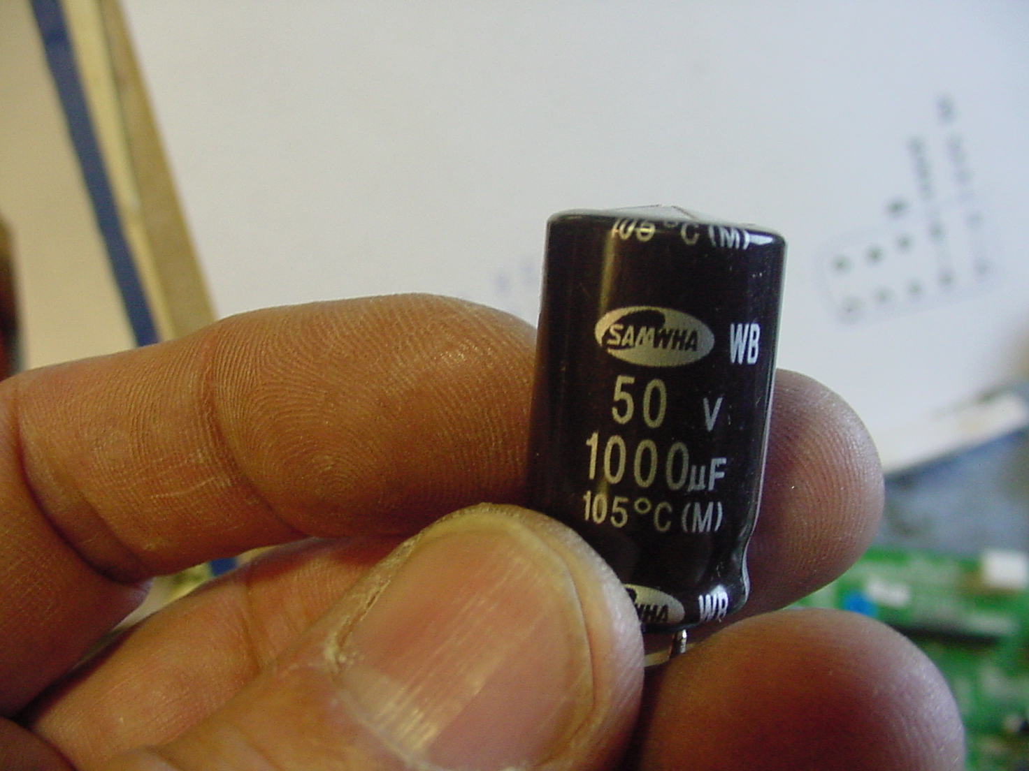

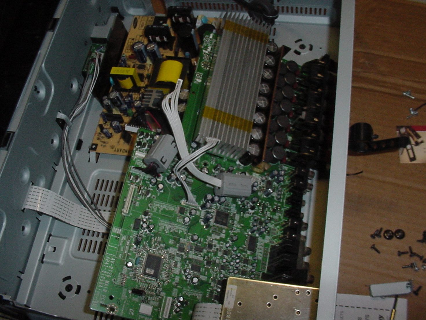

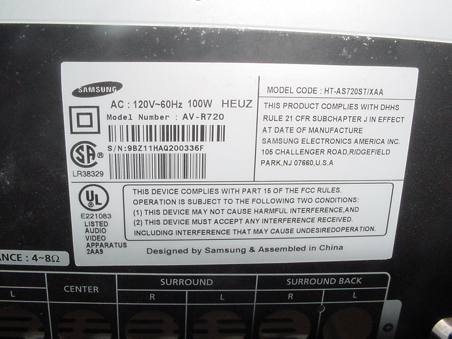

Samsung HT-AS720ST with bad caps

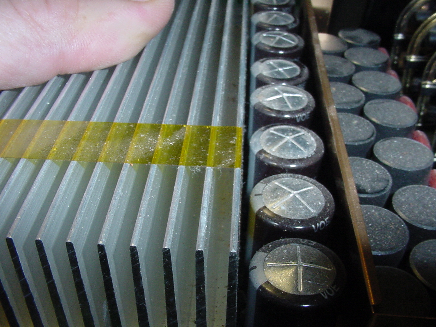

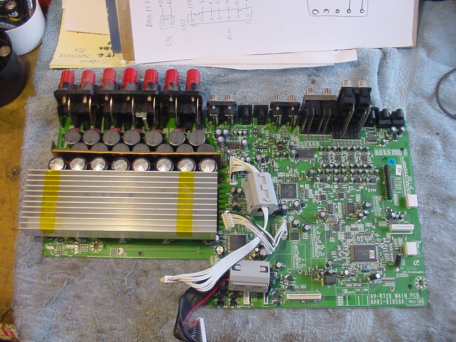

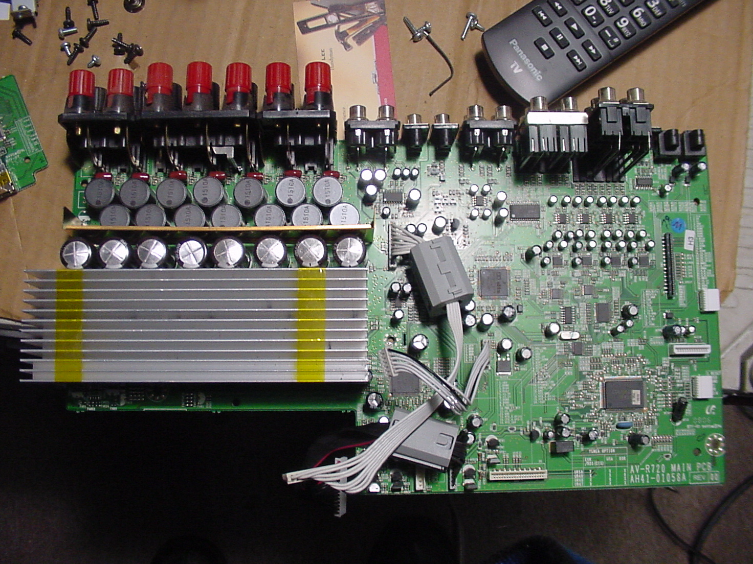

Bad filter caps on the main board.Never stop learning
http://www.badcaps.net/forum/showthread.php?t=24809Tags: None -
Re: Samsung HT-AS720ST with bad caps
Same lousy SAMWHA WB series caps used on SAMSUNG TVs that replaced tons of them, putting them close to the heat sink does not help either.
