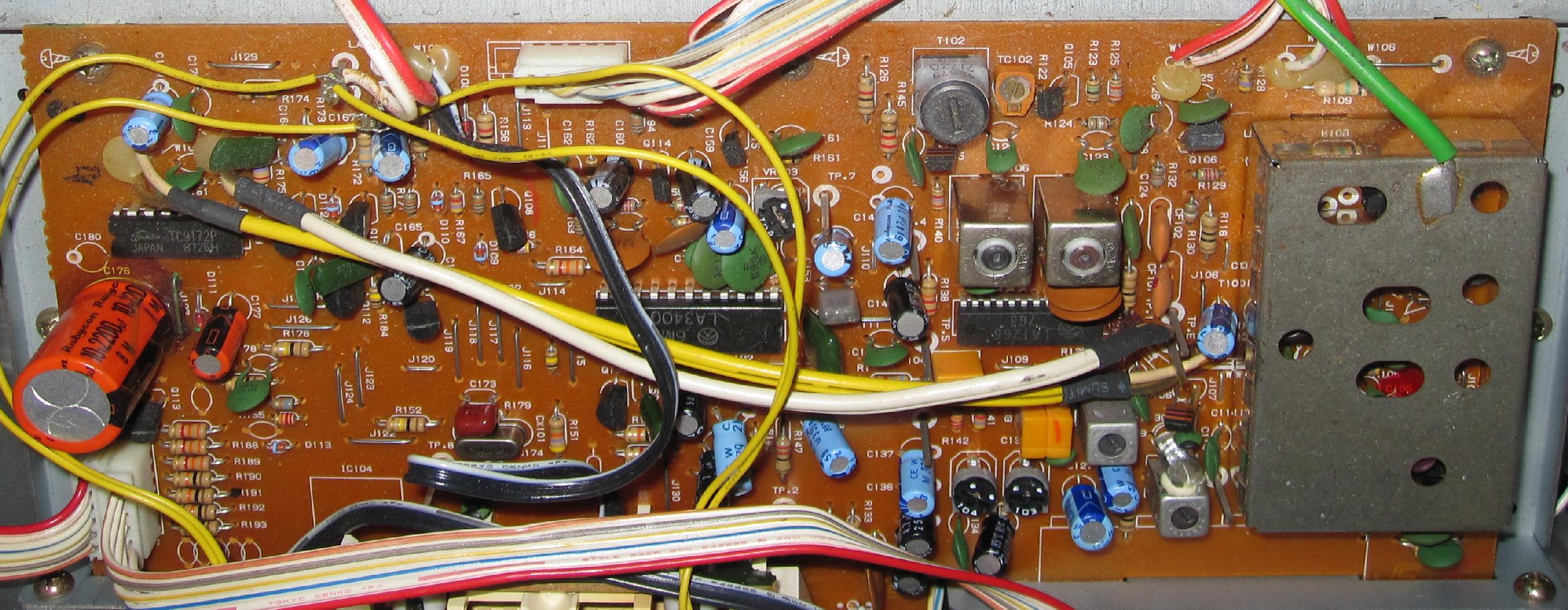

          The radio board...

            Re: Fisher RS-851 ... No FM, bad amp.
            Hmm. I think the FM VCO is borked. But now I'm not exactly sure why or how it's generated. Probing around the TC9172P, which is most of the PLL guts minus the VCO, I see a related frequency coming in when it's in AM mode on the AM input, but no signal on the FM input. I do wonder if it should be the IF or the actual FM frequency that should be fed in or not, but in either case, it looks kind of dead.
            I'll need to take a back shot of the board to figure out how this is connected... and where the VCO really is... Could it be discrete? Not sure...
              I found the tuning voltage finally, with the help of a similar RS-911 schematic. This tuning voltage works as expected in AM mode as I can see the voltage go up and down as I tune different stations. When in FM mode, the tuning voltage is stuck at 12+ volts.
              I still think the VCO is borked but I can't imagine how it could have broke. That, and how the VCO actually works... it looks like a tank circuit hooked up to the base of a common collector transistor amp, but doesn't totally look like a Colpitts or Hartley oscillator. Hmm. (and this circuit is underneath the metal shield...)
                I pulled up the tuner board and suddenly it started working! I don't know if it was perhaps a bad connection or a bad solder joint somewhere. The tuning voltage now works as expected and no longer stuck at 12V. The amp output is still crappy. Oddly enough through headphones it sounds OK... this is a key point because I think the headphones are hooked up to the speaker output with a resistor network.
                I fed the receiver's line output into my computer speakers and it looks like the tuner and mux are working well - so now I have to consider that the amplifier chip is perhaps fried. It does boggle why both channels are not sounding well. One thing I did notice, though the 30W amp uses a STK-4151-II chip, I see the voltage rail at 48V (!) ... The spec sheet says max voltage is 42.5V. I wonder if this is why it fried - it could very well be. I did notice a few STK-4151-V's and even STK-4191 pulls for sale, I wonder if I can swap these in, perhaps the 4191 will survive the higher voltages...
                The PSU for the amp is just a transformer and rectifier - no regulation as far as I can tell so I can't adjust it - and probably doesn't need it if the amplifier was designed to be supply voltage independent up until the signal has to hit the rails...
                  Err...it was already a STK4191-II, so now really unsure why it broke. Oh well. Ordered a STK-4191-V that has a slightly better input stage and lower THD. Hope this fixes this thing other than that FM which I think I narrowed down to a flaky inductor, I can now get it to stop and start working by jiggling it a bit. May need to reflow it to see if it helps, but the solder looks OK...
                    Well, problem solved. My Fisher is now working pretty much perfectly now. I replaced the amp module with the new module. While removing the module I noticed one pin was broken (it was an easy desolder with a vacuum pump, but the pin apparently broke before I removed the module.) The pin was #13... which may explain why the amp was not working properly.
