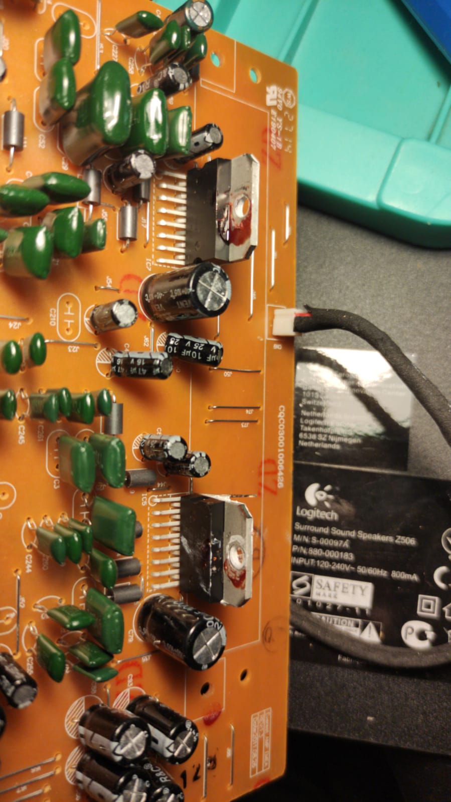

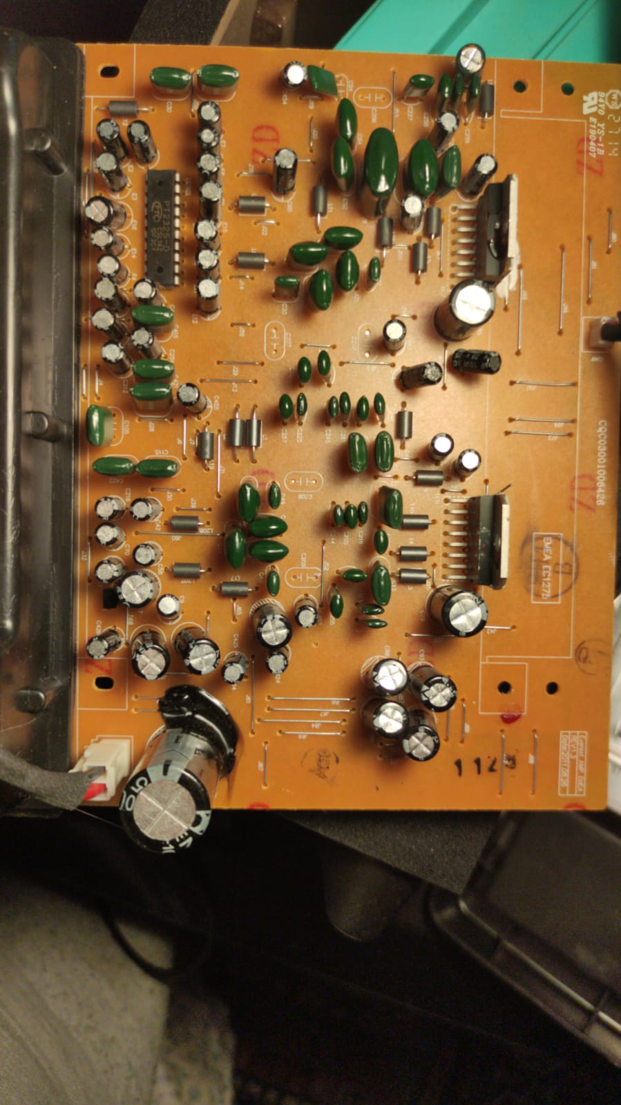

      Now i installed Dell Laptop Adapter wich is 19.5 volt 3,34a now working properly but after 3-4 hours need to cooldown 5-10 min so after i can use without problems. On board there is STA540 modules maybe getting too hot i dont know. Others looking fine.

          The STA540 has integrated thermal cutoff at 150C.
          The temperature is extremely high for normal operation.
          Use IR thermometer to measure the temperature.
          Check voltages to the STA540.
          Almost all the time, this kind of malfunctions are due to bad STA/STK/TDA amplifier chip.
          150C is not too hot. It's almost melting the solder.
          Boards with amplifier IC-s are pretty simple. Almost always it's the STA/STK/TDA fault.

            Hell guys now i refreshed thermal paste on the aluminum board and plus i addes fan inside the box lets what will happen if it continue like that im gonna change both chips. Hopefully its not goes this way Thank a lot i didint feel alone on this way I forgot to take photos but i used old model 12 vold DC fan along with Pentium 4 aluminum case fan is turning fast but not so fast im gonna test it.

                  Result is same guys im gonna buy freezer spray and test it which one get defected.

                          Here update guys i Fixed the power supply with almost same qualifications but somehow my bass quality dropped other amfi system works fine just bass not satisfying my requirements
