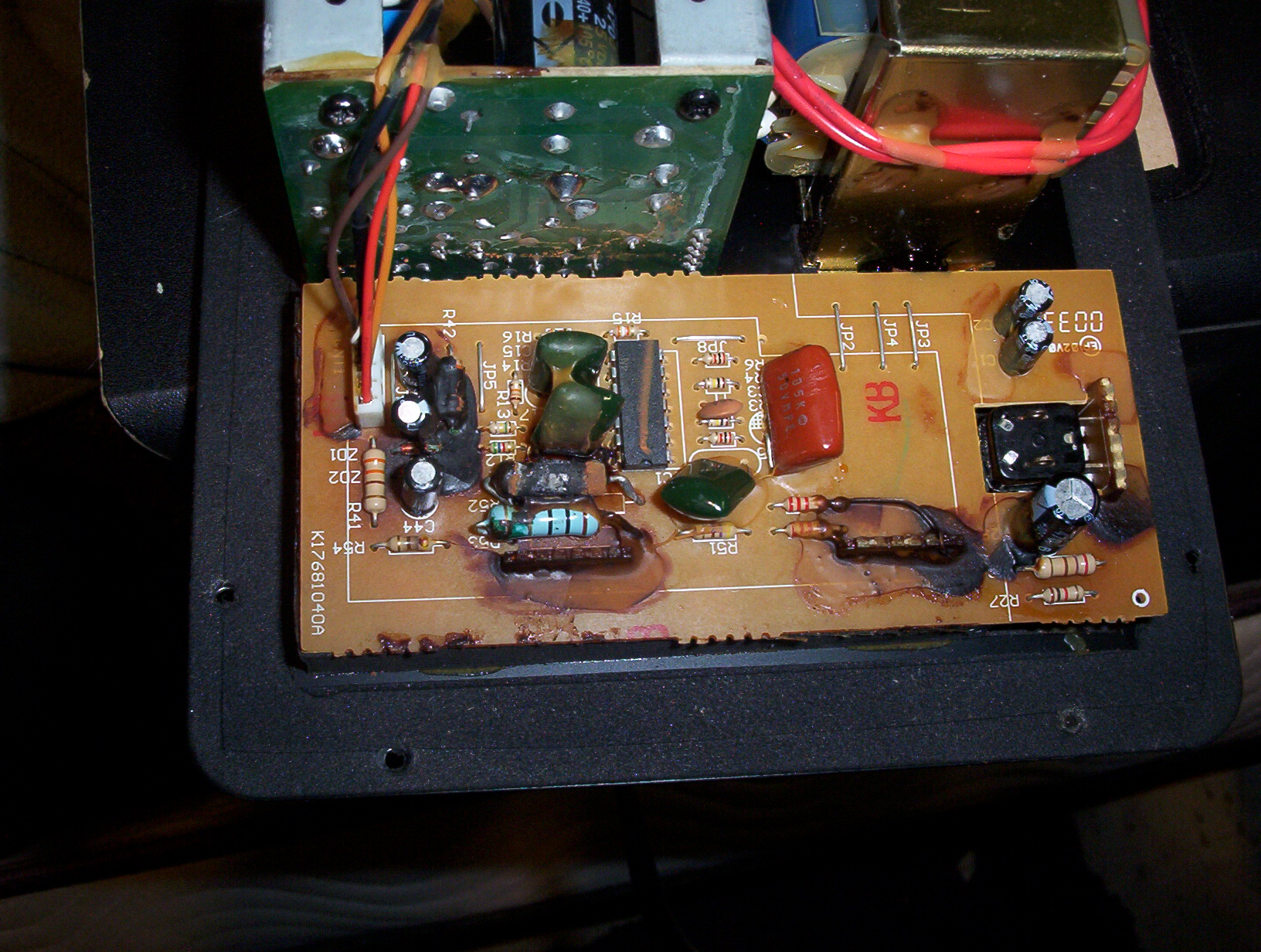

        Okay I got the resistors out. The one that I can read reads as brown, black, black, gold, gold. That comes out to 10 ohms at 5% tolerance, and my ohm meter reads 10 ohms on it.
        The second resistor is going to be an issue though. The ohm meter reads exactly 5 mega ohms, and it's too fried to get a color band reading off it. Its position in the circuit makes me think it's another 10 ohm, but I'm not certain, and I'm still unsure of the wattage.
        In the meantime I'm removing as much of the glue as I can.

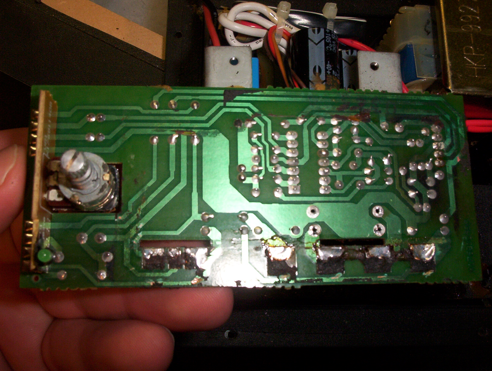

          Ah, I thought the 4th one is Silver. Can you post the pictures of the bottom side of the board?

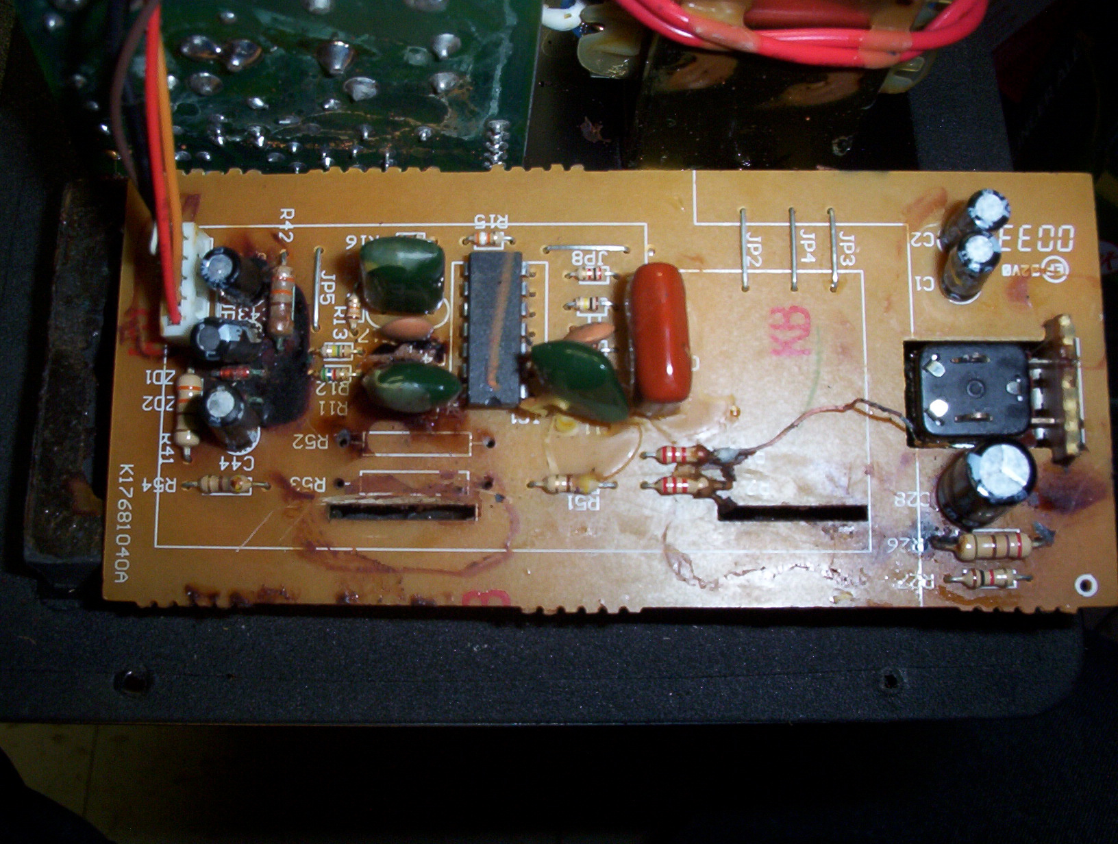

            Okay got a pic of the bottom board as requested, and a pic of the top as it looks right now.

              Are those big square solder pads (4) connected to some kind of speaker terminals?
              • Mrx3750
                • Jul 2013
                • 311
                Re: KLH Bassbite II Subwoofer works, satellite speaker channels do not
                Yes. There's a board with the four satellite speaker terminals that solders onto it. had to remove it to get the resistors out.
                  So each resistor is in series with the speaker, so if the resistor has open circuit, you will not get the sound then.
                          Well, the 1 watts are in place for now. I figure they'll do just for quick testing.
                          Now I'm getting a 60 Hz hum through the subwoofer. However music still plays through it. Satellite channels are still blown. Really wish I could find a model number so I could track down a service manual.
                          Edit: Testing in circuit tells me that R54, R42 and R41 are also blown. Looks like I'll need to hit up a real electronics store.
