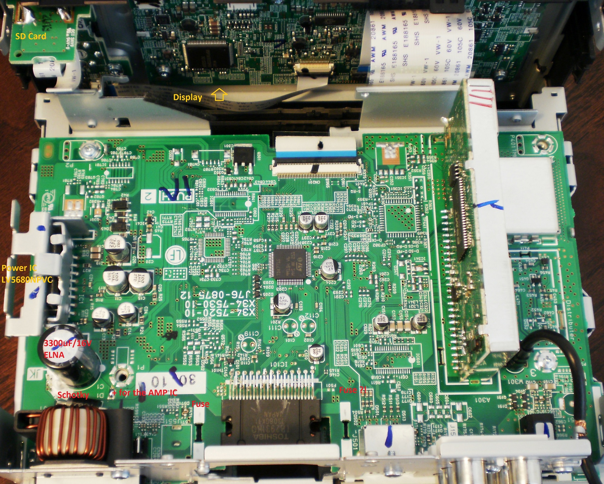

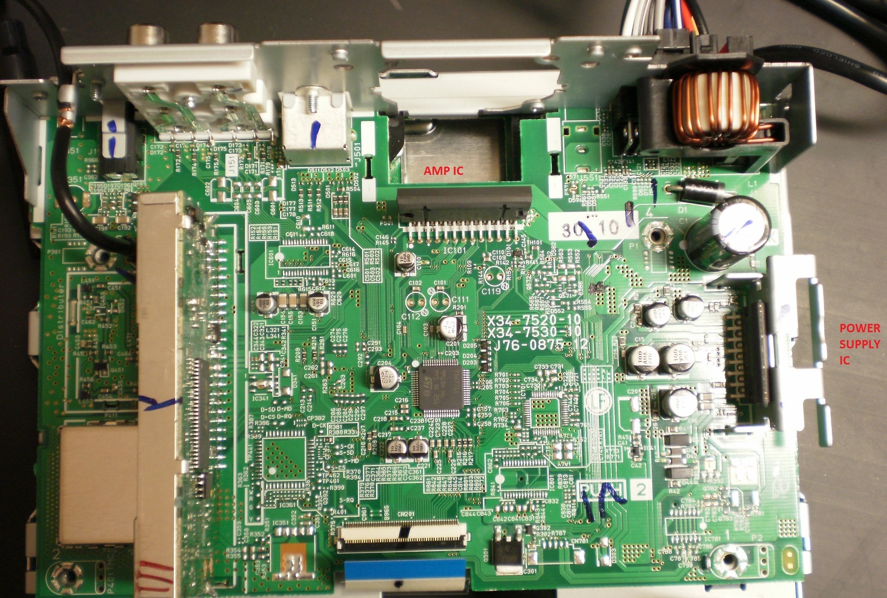

                    Re: Kenwood DNX6990HD service manual needed/DNX570HD
                    I took a picture with the Electrical board, where the power supply IC, amp IC, tuner board, etc. are located.
                    Here is the schematic of this board.
                    An opinion, please.
                    What could be when the unit powers up and then turns off. I have measured all the output voltages at the power IC and they are pretty much 0V.
                    If it turns on initially, the power supply IC could be still bad? After the initial start up, I can't make it to turn on again for a long time.

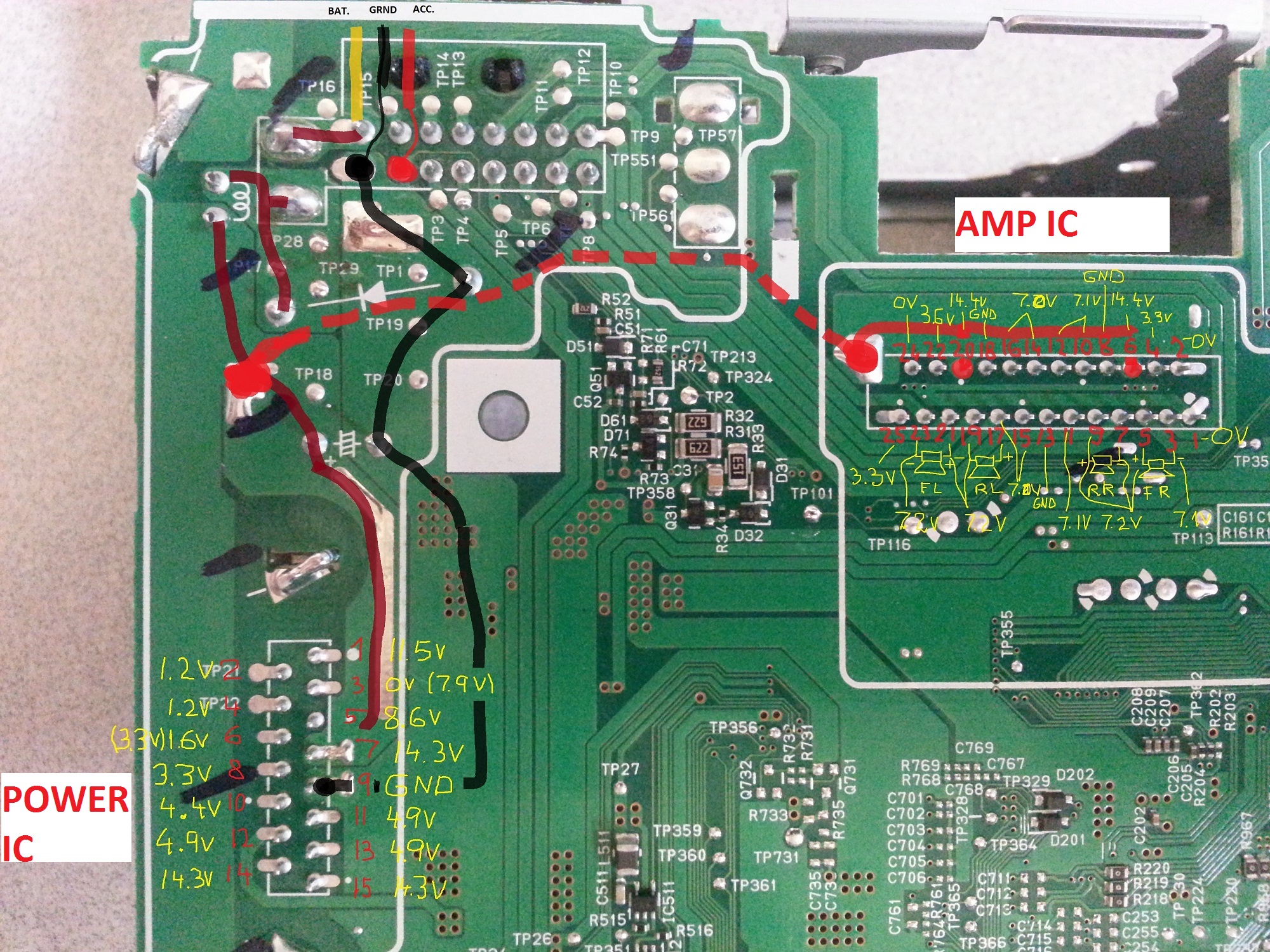

                        Made a "diagram" for easier troubleshooting.
                        These are the voltages that should be there.

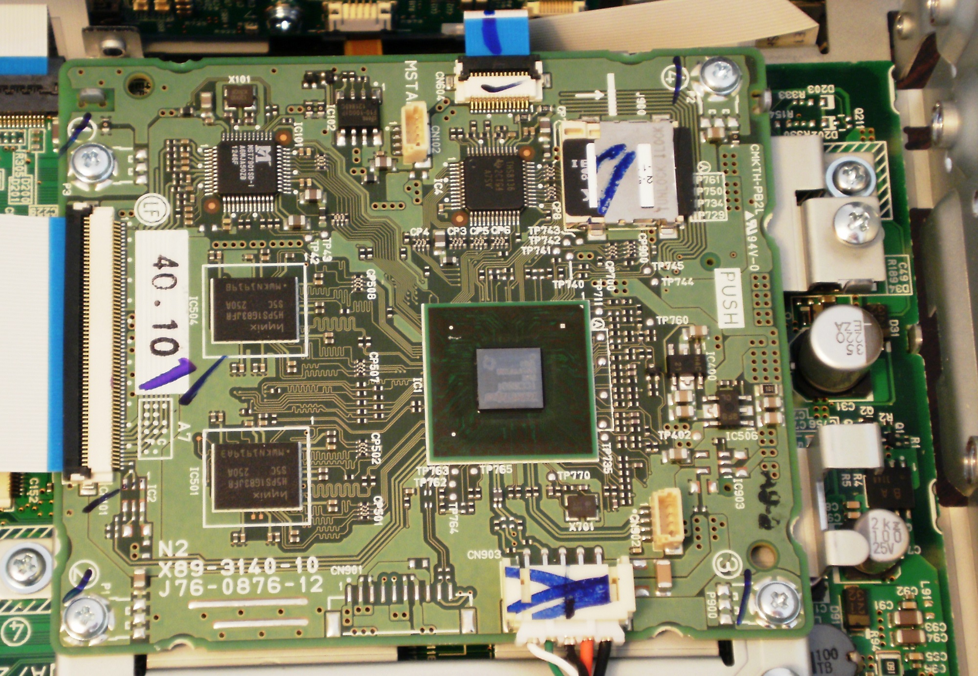

                                  I'm wondering if this daughter board is not the Windows CE 6.0 motherboard.
                                  It has a CPU, flash drive, memories, etc.

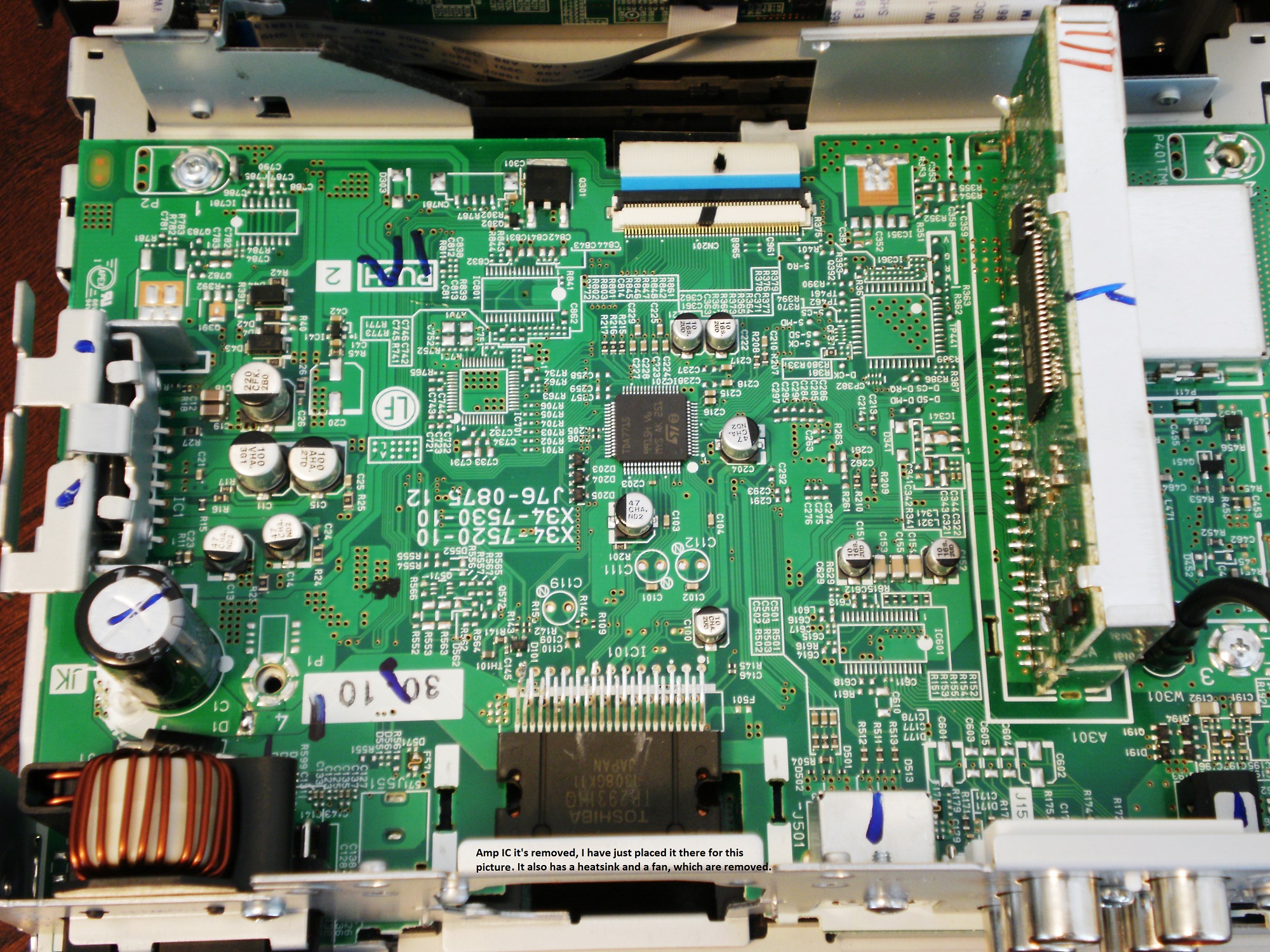

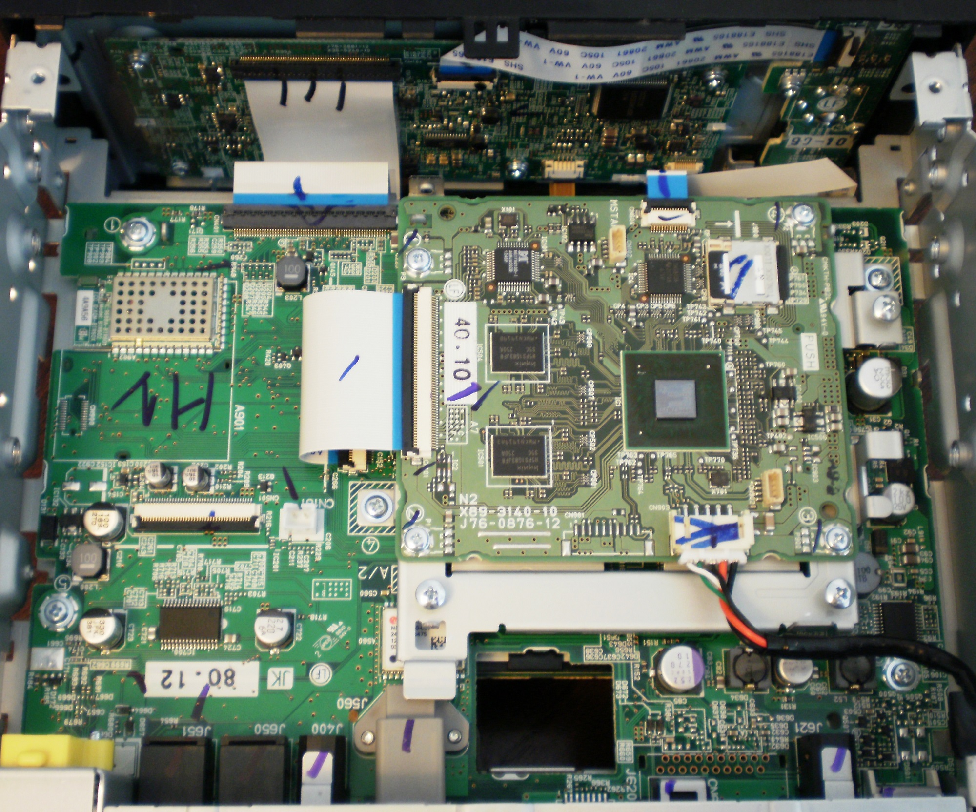

                                      I have posted it above.
                                      I have made some pictures too.
                                      AMP IC is removed, I have just placed it there to see where it is.
                                      First two are with the daughter board and the other two are with the "electrical board". (Power supply, Amp, Tuner)
                                      Below the daughter board is the video board.
                                      Heat sink is removed from the daughter board.
