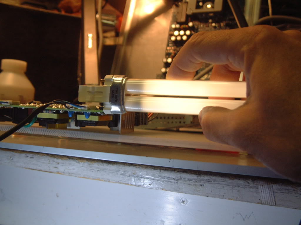

    You can try this, just touch just one of the output terminal with the one end of the CFL. But do not run it too long with the real lamp attached.

          Ok, I used a regular spiral type 13Watt fluorescent
          lamp, touching the center conductor to the
          output, and it works rather well. The lamp
          certainly shows the high voltage is there, and
          the arcing is very pretty when I pull the bulb
          away!
          Cool trick! Thanks, Bud.
          I know the inverter is good.
          But the bad news is: I probably have bad CCFLs
          behind my LCD display panel, right?

              Ok, I've taken out the panel, and sure enough,
              the lamp blew out on one end, and cracked the
              tube.
              The lamp is quite skinny, a little over 1/16th inch diameter (slightly
              over 2mm), and about 4" long (about 10cm). It has little
              metal tabs on the ends to solder the wires to.
              Any place I can get a suitable replacement?

                    Glad you found the cause of the problem, I use this lamp trick when I do not have the right connector to attach to the inverter output.

                          The keyboard works perfectly now.
