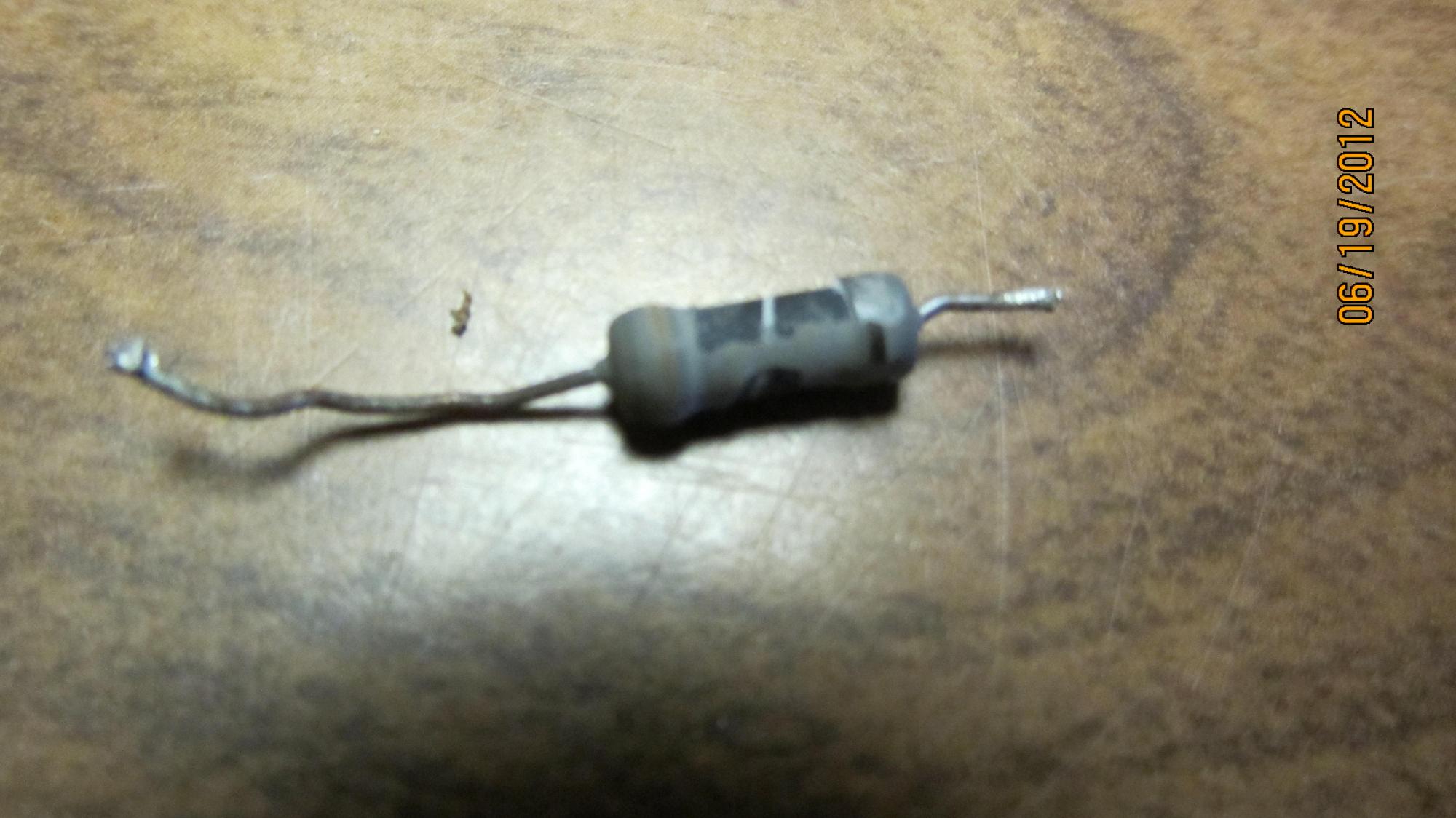

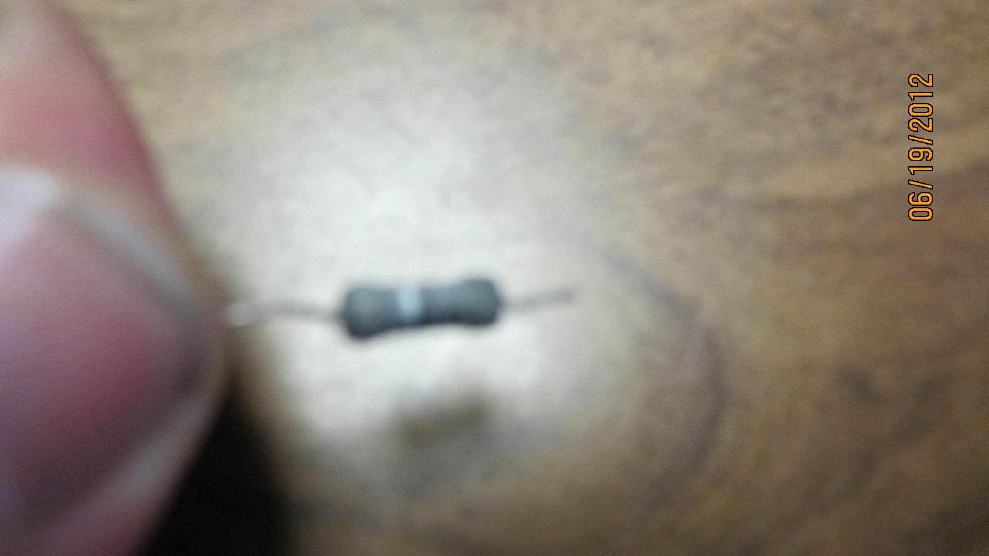

    I have the above mentioned receiver RCA RT2770.
    There is a Grey Axial (resistor?) or whatever that is next to the Large transformer on the board the bands are scratched off from someone trying to pull the thing off the board is there anyway that I can figure out its rating so I can find a new one to replace it?
    Or does someone have this receiver that could tell me the color of the bands on this (resistor?) This is a tough one folks I wish I knew I would get an accurate reading...
    Any help would be helpful I'm really unable to determine I can make out some of the lines as follows:
    Red at the bottom and the next is a thicker white line then nothing and at the top it looks to be black...
    Marking on the board says R202 by the way which a quick google search turned up 3.3k 1/4 watt but I believe the R202 marking does not note what the rating of the resistor is if I am correct if it does that would solve a ton of learning issues with electronics off the bat.

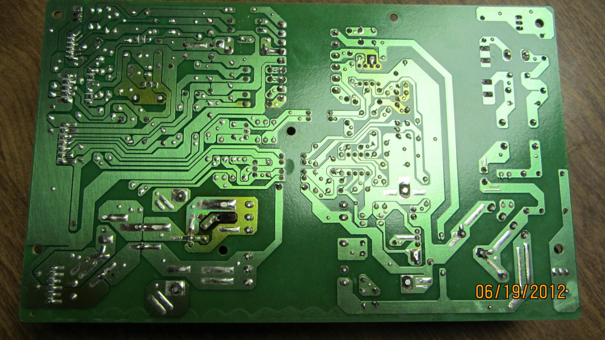

        Pictures of the whole chassis, resistor, area close to the resistor, SMPS board.

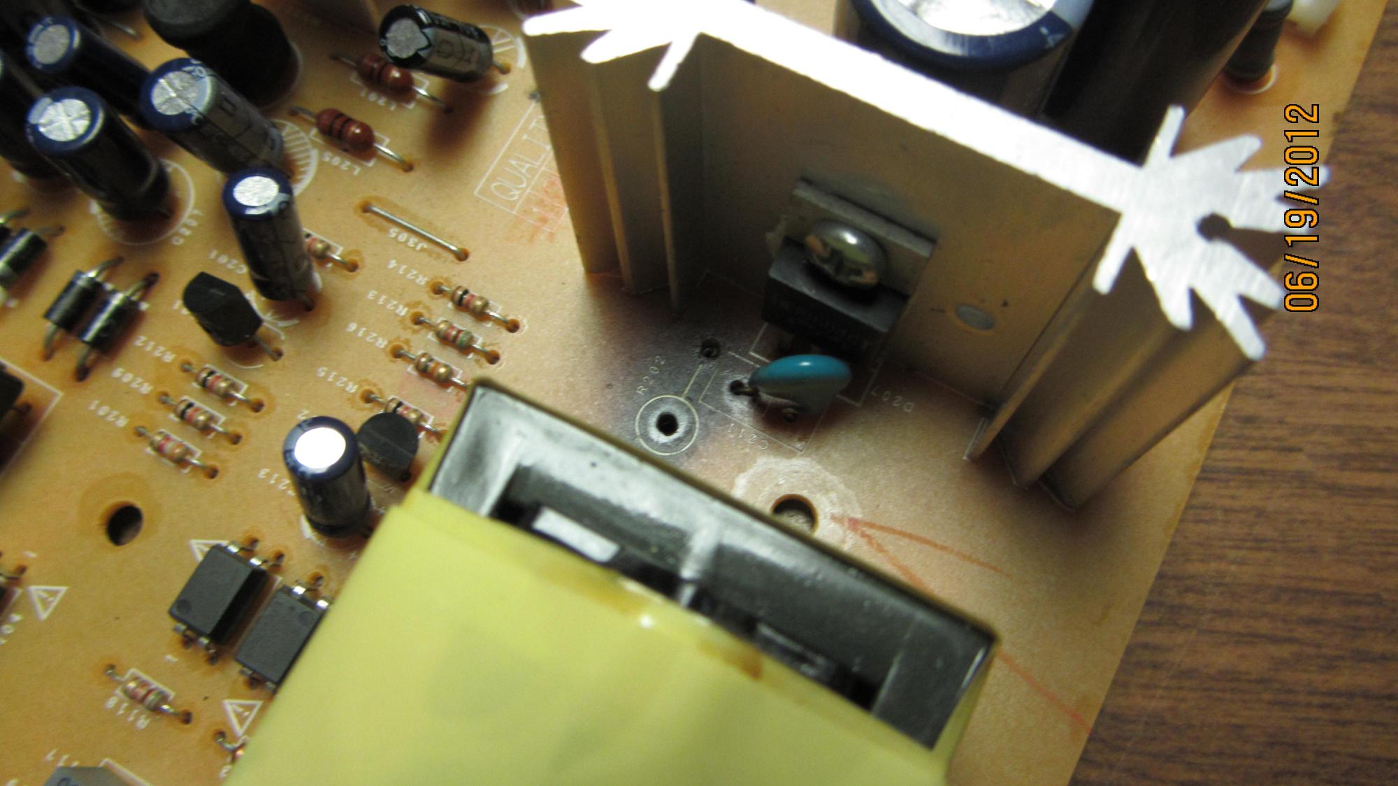

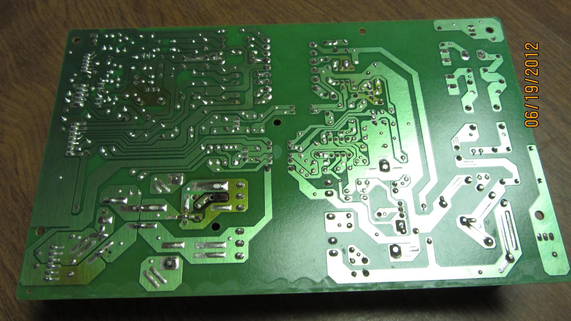

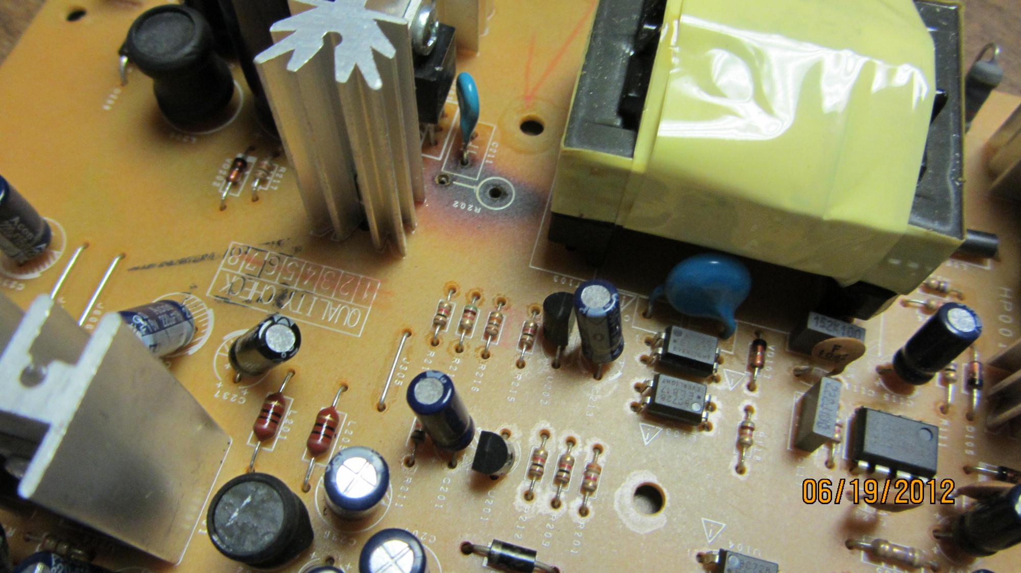

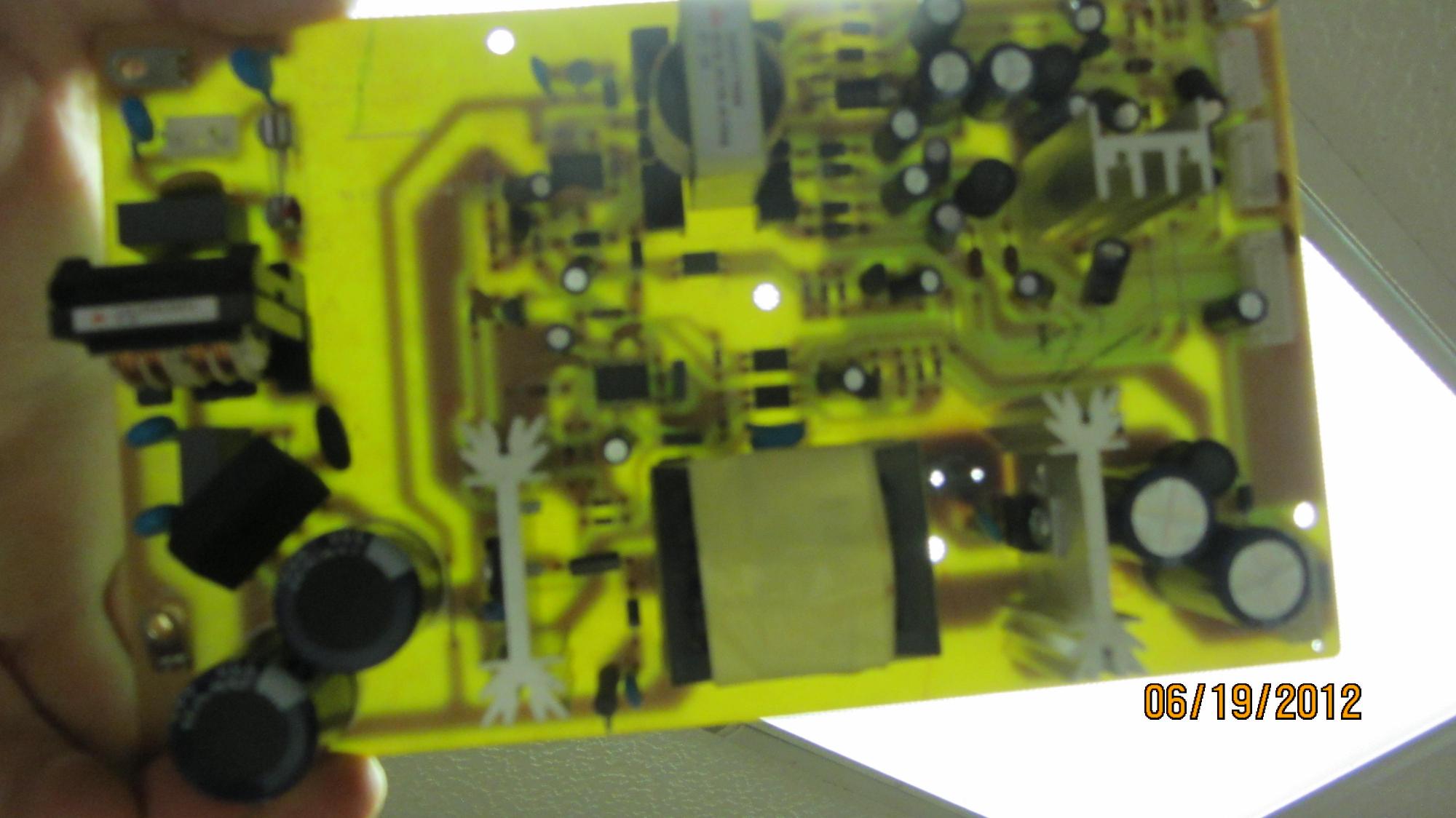

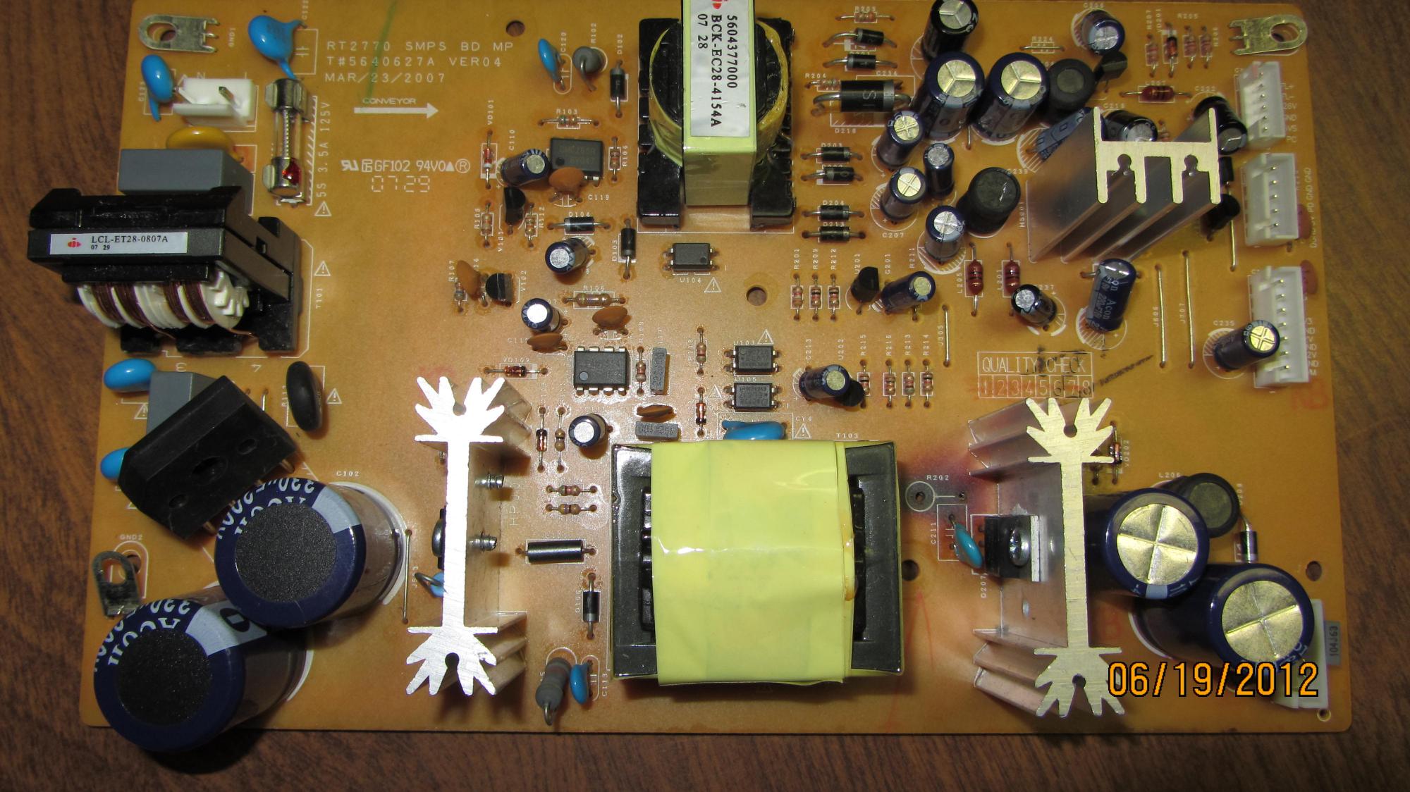

            BudM I hope these will do for pics. I dunno how you would prefer offsite photos or on site so I figured I'd post them on site.
            Please note: I am not responsible for any harm caused to you anything discussed is just discussion. Before you try anything discussed be sure that you have the appropriate knowledge and safety gear for the job. Like with anything education and safety are first! Do not try anything @ home without it.
              Re: RCA RT2770 Reciever (Home Theater?) Need help!

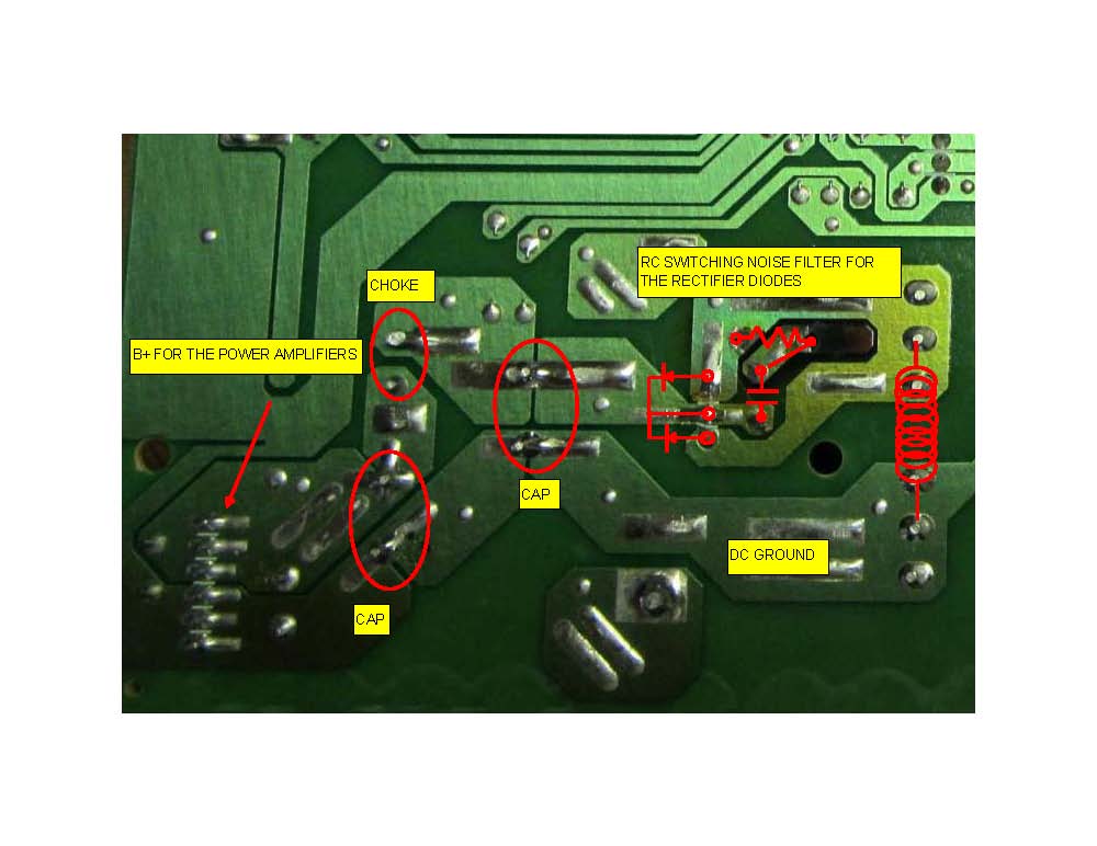

              OK, that resistor is part switching noise RC filter to reduce the noise of the rectifier Diode when it switch on and off at very high frequency of this switching power supply, this noise and its harmonics can get into the amplifier section of the audio amplifiers.
              Right now the power supply should work without this RC filter, you may want to check that blue cap (value of the cap?) and the resistance leakage, if the cap has resistance reading, that may explain why the resistor burn up.
              Check the rectifier also.
              Are you getting any B+ from this section?

                Judging by the spot of that resistor in the PSU, it's probably a low-value resistor (most likely 20 Ohms or less). Have you tried measuring the resistance with a multimeter?
                Also, check if that blue cap is short circuited.

                              The resistor is a snubber for the diode. Due to poor design, the wrong value has been chosen, which has led to early failure. Increasing the value should be harmless.
                                  8.2 ohms is too low, much too low.
                                  You need about 1~100kohm 3W.
                                  Depends on the output voltage of that PSU and breakdown voltage of diode.
                                  If output is 50V and breakdown is 200V, worst case is 250V across resistor.
                                  So calculate (MaxVoltage^2)/Resistance <= 1.5W (half rating of 3W to limit dissipation)
                                  and that will give you a decent lower bound... Example 47kohm works here.
                                        There is a small value cap which is in series with the resistor to create RC Snubber circuit to reduce the Diode switching noise, if that cap is shorted or it has low leakage resistance, the resistor will burn up since the current will also flow through the resistor for full cycle.
                                        example:
                                        https://www.badcaps.net/forum/attach...9&d=1354513907
