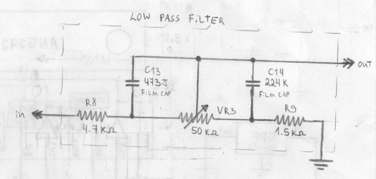

    Lastly, are there any improvements I can make to the Low Pass and High Pass Filter tone controls (perhaps any way to make the LPF boost the low frequencies even further)? I pretty much took the design for those from my Saturn speakers. The only thing I changed is that I didn't put a 470 Ohm resistor between the LPF and the output like my Saturn speakers did – but I simply did that because I forgot to. With the tone controls, it seems that the output audio level drops quite a bit - any way to improve that? Or is it pretty much a given trade-off?

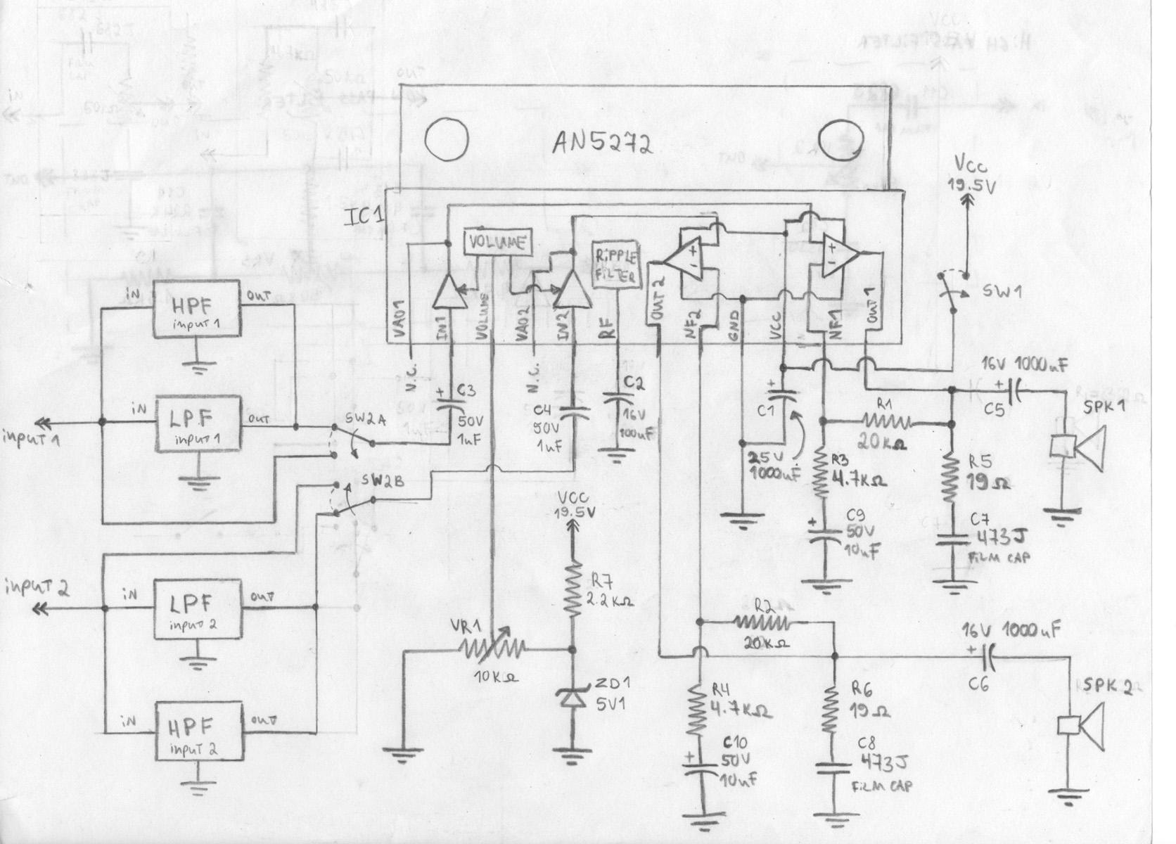

        Well, I did some experimentation with some of the caps and resistors, and this is what I found:
        - The feedback caps (C9 and C10 on my schematic) should not be changed. I tried 100uF and 47uF, and both make the amp produce an awfully loud popping noise when it is turned on (highly annoying IMO). So I'll be leaving them alone at 10uF, as per the data sheet.
        - Changing the output caps (C5 and C6) from 1000uF to 1500uF didn't seem to make much of an audible difference (at least I couldn't hear it).
        - Changing the ripple filter cap (C2) from 100uF to 220uF didn't seem to do anything.
        - Changing the input coupling caps (C3 and C4) from 1uF to 47uF didn't seem to make much of a difference in the audio either. (I guess you can call me tin-eared now ).
        - I also played around with the gain resistors (R3 and R4). Sure the noise is much lower with the 4.7 kOhm resistors in there, but so is the gain. And with the LPF and HPF filters active, I have to turn up the volume knob almost all the way up to get to that loud-enough level that I'm normally used to. At that point, the output becomes too distorted IMO. So I decided to increase the gain back up a bit. Both 3 kOhm and 2.2 kOhm resistors give me enough gain without increasing the noise too much..
        - Another thing I tried is swapping the 20 kOhm feedback resistors (R1 and R2) with 10 kOhm ones. The data sheet says not to do that, but I did it anyways. (Also swapped the gain resistors to 1 kOhm each to keep the overall gain more or less the same) Result: I *think* noise decreased a bit but I'm not 100% sure. So I'll probably end up leaving it at 20 kOhms.

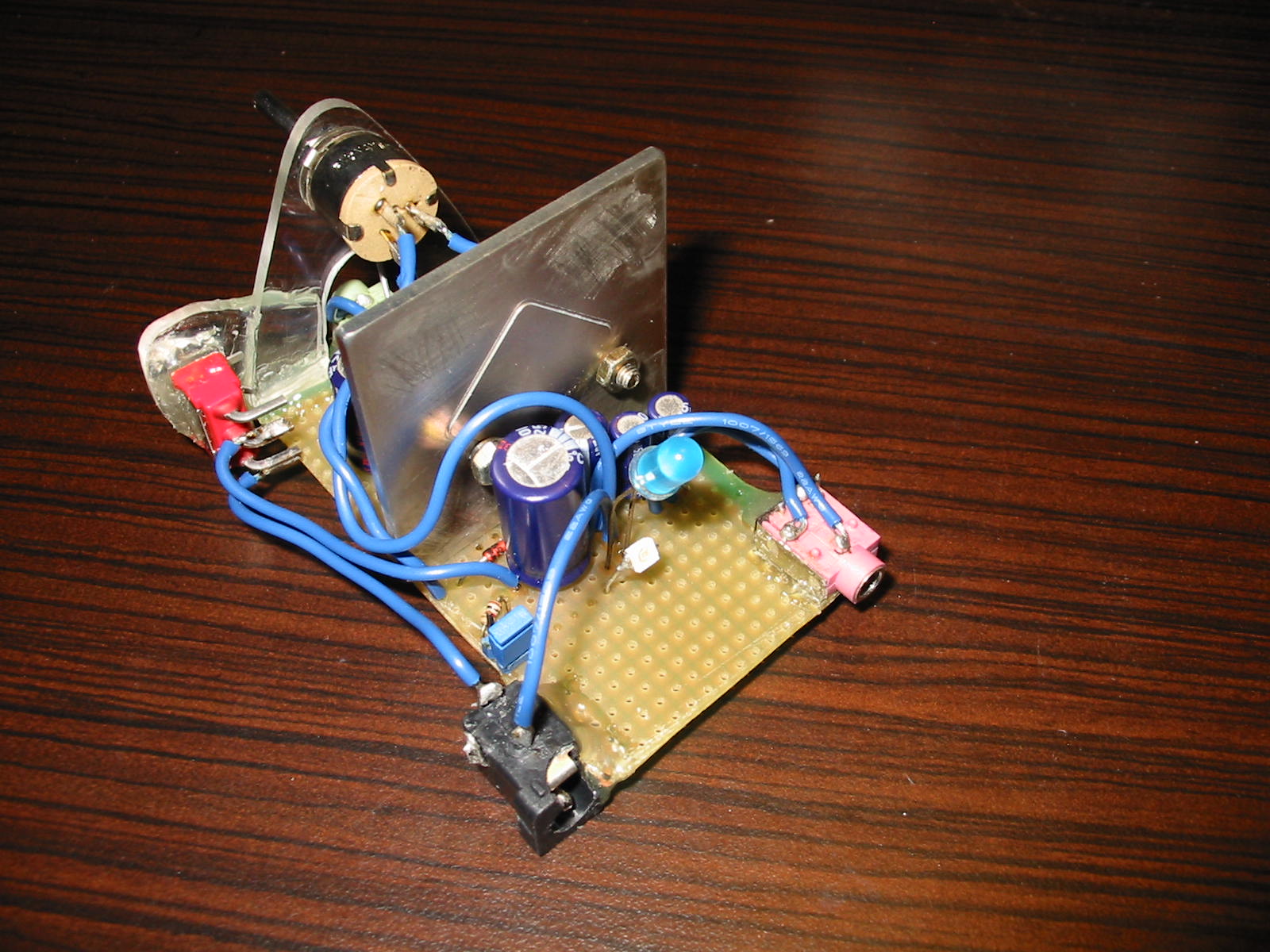

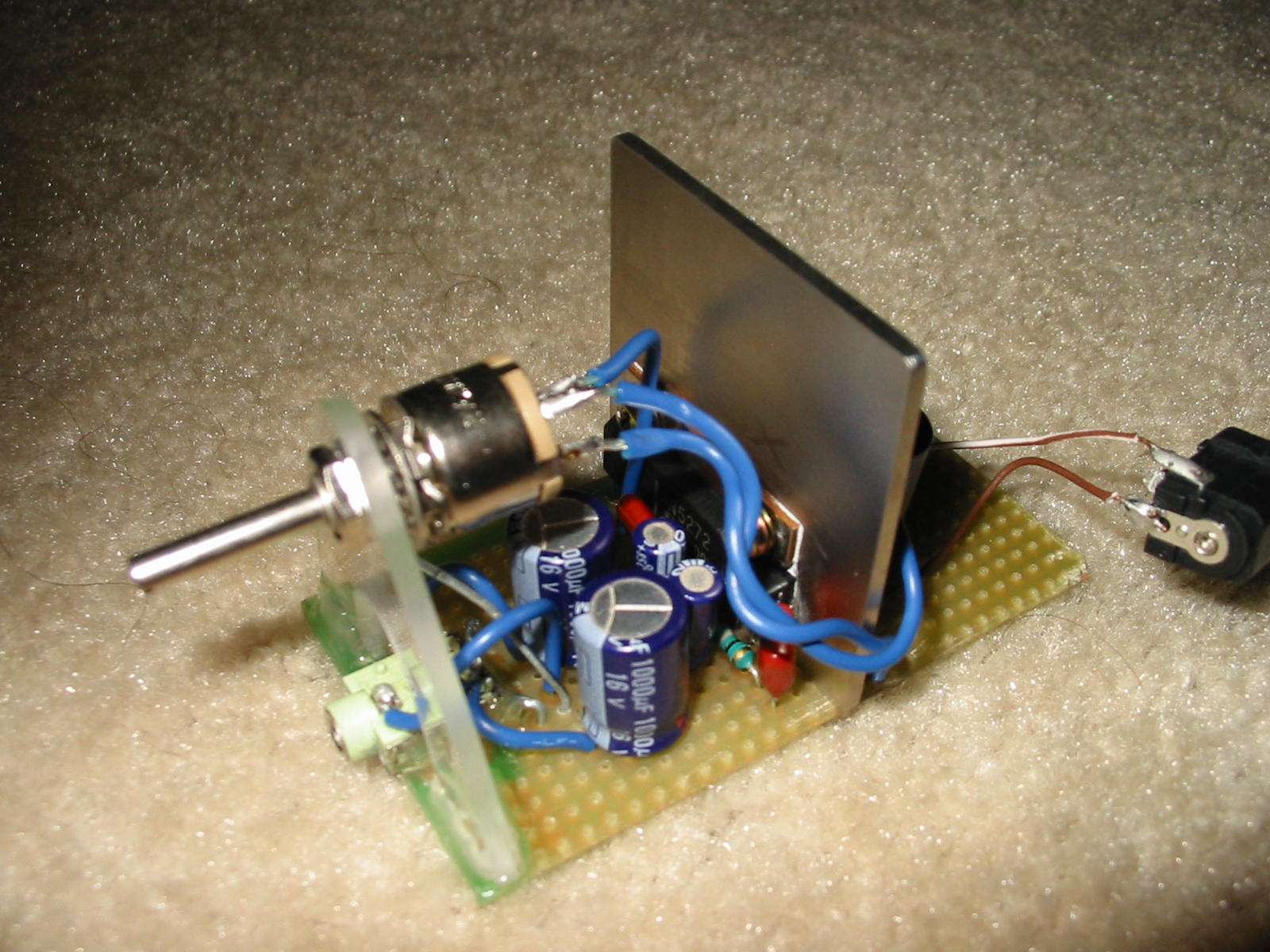

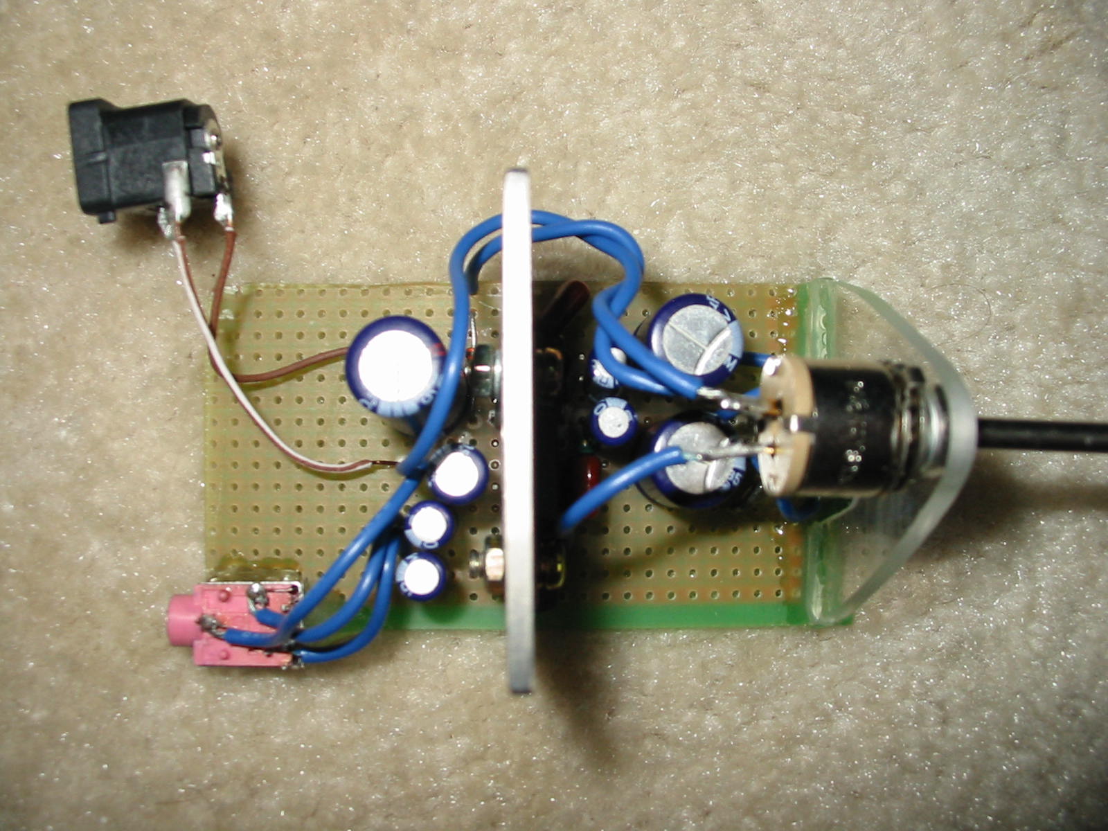

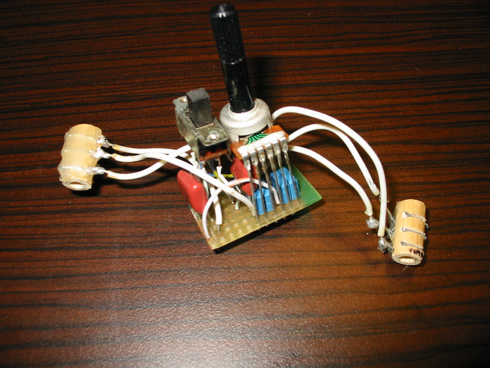

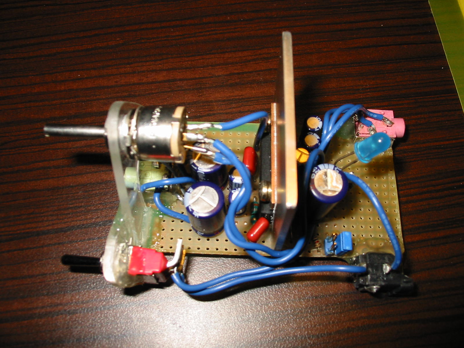

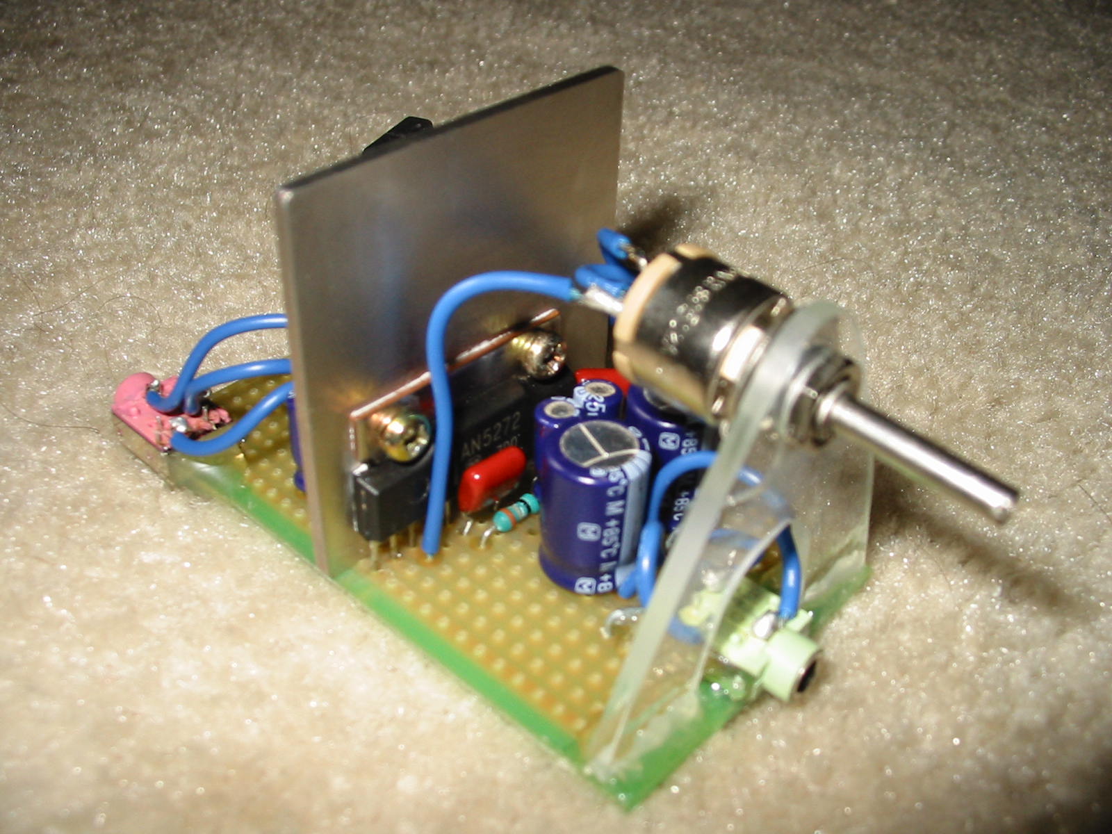

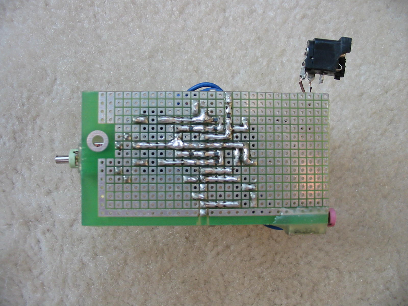

        Since I had nothing better to do on Sunday, I decided to build the headphone amp. Pictures attached. There are still a few things that need to be done to it, like add a ON/OFF switch, re-wire the DC power jack (I only put this one temporarily), put the whole thing in a case (I have it already), and make a knob for that volume pot.
        Note that I didn’t add the bass and treble tone controls. Decided I’ll play a bit more with them on the breadboard before implementing them. So far, the headphone amp sounds okay. Yes, I know I won’t win any Hi-Fi contests with it, but it more or less does what I need it to: amplify sound from my computer. Like I mentioned, most computer audio cards just don’t have enough power to drive my headphones loud enough for me. If I need less distorted but more quiet sound, I can just plug my headphones back to my computer again (or actually, now that I had that thought, I can wire a switch on the headphone amp that just bypasses it).
        At least the parts are of high quality . The IC itself is made by Panasonic, the caps are Panasonic, and even the DC jack came from a Panasonic Toughbook . The heat sink is copper and also of high quality (any guesses where it might be from? ).
        Most parts were all reclaims too (take that, Energy Star!). RoHS-compliant as well! (ugh . I only used Lead-free solder since someone gave me a really big spool of it long time ago – hence the cloudy joints in case you were wondering why. It didn’t help that I only have a 35W unregulated Radio Shack iron.)
        As far as what I used in the final design:
        C9 and C10 --> 10uF 50V
        C5 and C6 --> 1000uF 16V
        C2 --> 100uF 25V
        C3 and C4 --> 10uF 50V
        R3 and R4 --> 3.3 KOhm SMD resistors
        R1 and R2 --> 2 pairs of 10 KOhm SMD resistors in series (for a total of 20 KOhm)
        VR1 --> 5 KOhm potentiometer since that’s all I had (works fine)

          Seems like there isn't a whole lot of interest in this thread, but here's the update regardless:
          I've been using that headphone amp with my computer for the last few weeks. Surprisingly, it sounds a lot better than I though it would.
          At first, I had it hooked just straight to my computer without the analog tone controls. But after listening to music for a few hours, I found the bass and treble to be a bit on the lacking side at low volume levels so I had to keep the volume high (which gets a bit annoying after a few ours of music). So then I hooked the tone controls (which are still on my breadboard, btw ). Since then, I haven't really looked back to not using them. I can now turn the volume low and there is still a good amount of bass, even with my “cans”. (They actually sound a lot better than what most people would think. I have several pairs of other similarly sized headphones, and these other pairs do indeed all sound like cans. Still way way, waayy much better than ear buds, though).
          Anyways, I think setting the gain to ~6 V/V (~19.56 dB with volume stage) (via R3 and R4 = 3.3 KOhm) was a good move rather than having it at ~4.26 V/V (~16.58 dB with volume stage) the way I had it in the hand-drawn schematic with the original 4.7 kOhm resistors. Noise is actually much quieter than from my Saturn speakers. I can actually hear my computer's fans run again – and this is with the volume knob turned about halfway. As far as sound level goes – it's almost equally loud as that from my Saturn speakers when the volume knob is turned about halfway. All of this without changing any of the internal volume settings in Windows. So all in all the volume is the same, but the noise is much less (due to lower gain). Also, that copper heat sink really is doing its job well – it gets warm after a few hours of use, but no less than the IC itself. Funny, cause I actually (re)used thermal compound from whatever was leftover on a Pentium 4 CPU . The copper heat sink is also a re-used item – it came from a dead Sony PS3 GPU (now you don't have to guess anymore ).
          So, everything is almost done now - even the case for the amp. Normally I'm modest, but IMHO I think I did a really good job this time - the case looks quite cool. I figured, if it can't sound (as) good, at least it will sound so in style . Pictures are coming very soon, I promise. I just need to finish the knob for the volume control – yes, it's all handmade. I actually had to make a custom tool to make it . It was worth it, though. Made a few other knobs as well. Just can't decide which one to use.
          All that's left to do now is integrate the bass and treble controls inside the case (there's still some space on the PCB). But I want to play around with them a bit more. I actually have figured out how they work now (or at least I think I do, based on my experiments so far). Will add that in my next post in case anyone is building an amp and wants to implement these in their design. In any case, I'll probably post pictures before I integrate the tone controls.

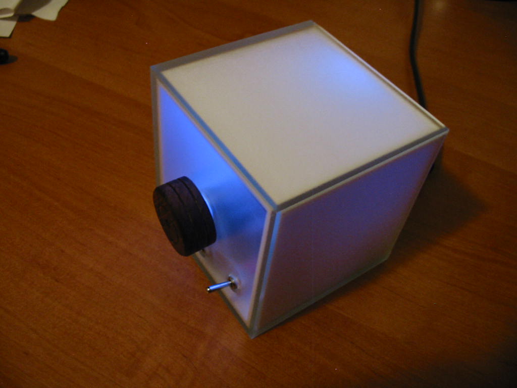

            Almost Done - Headphone Amplifier Based on the AN5272 Chip

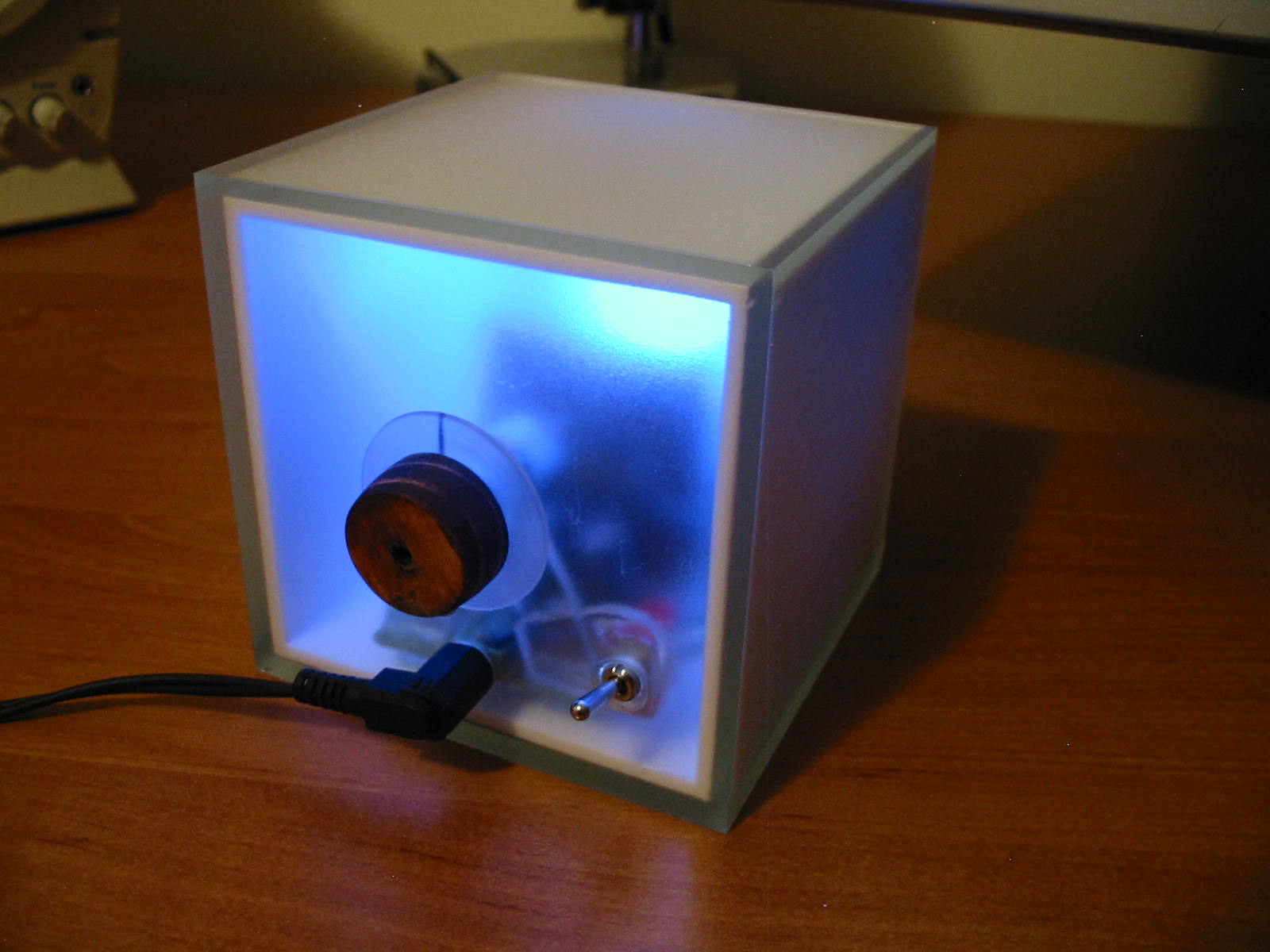

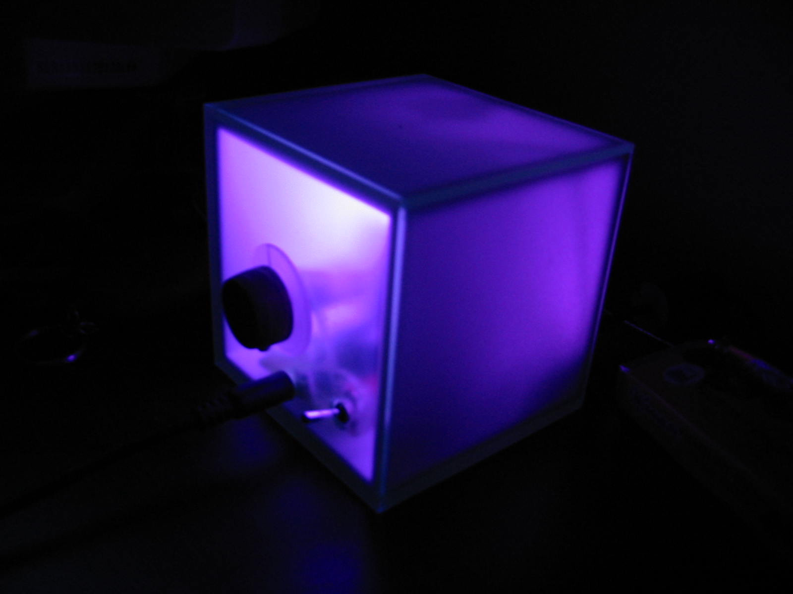

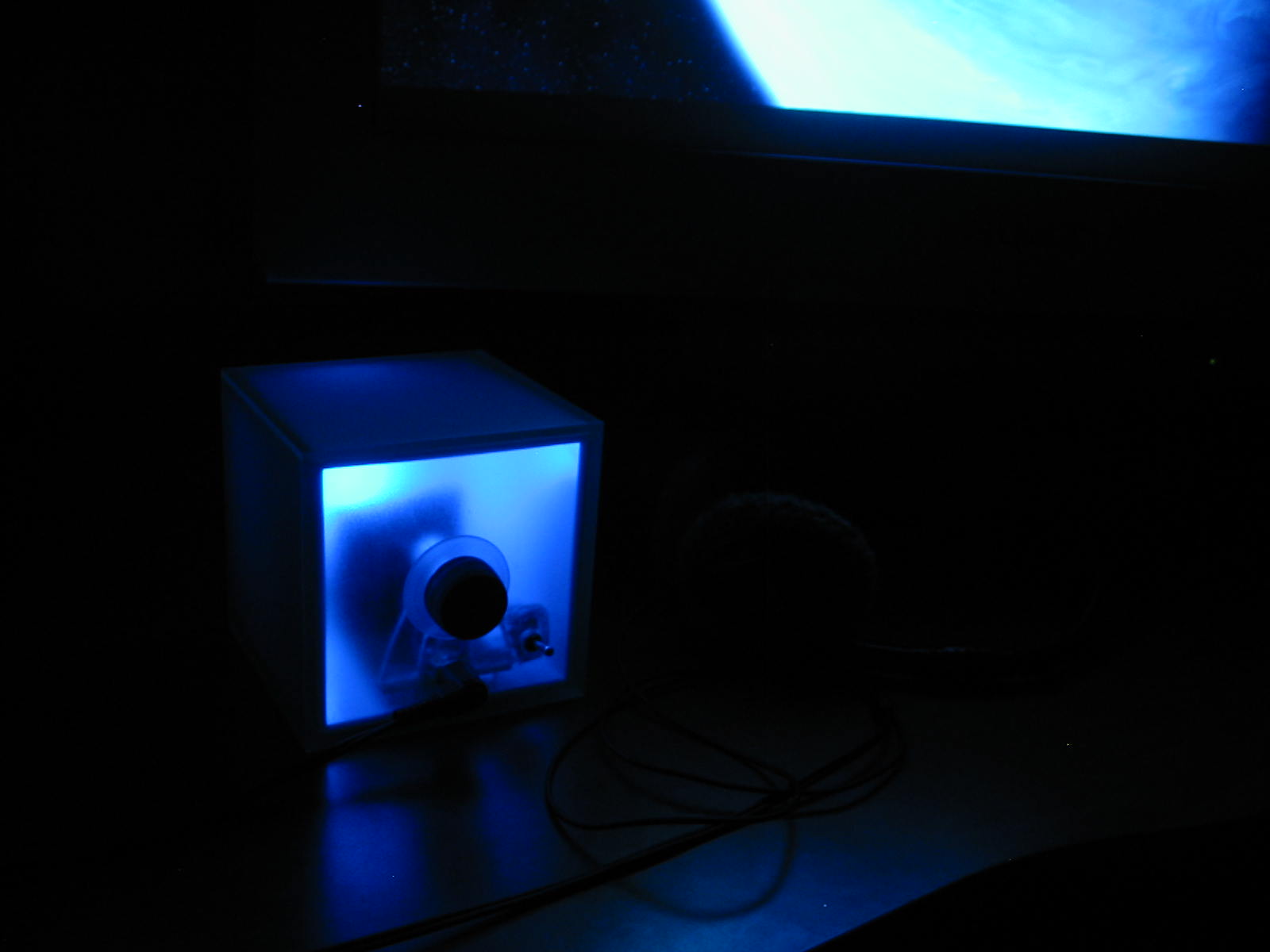

            Time for pictures! (finally)
            Lots of blue colors in this one
            https://www.badcaps.net/forum/attach...1&d=1343539304
            What is that blue object? Let's see it from a little closer...
            There we go, turned on the lights...

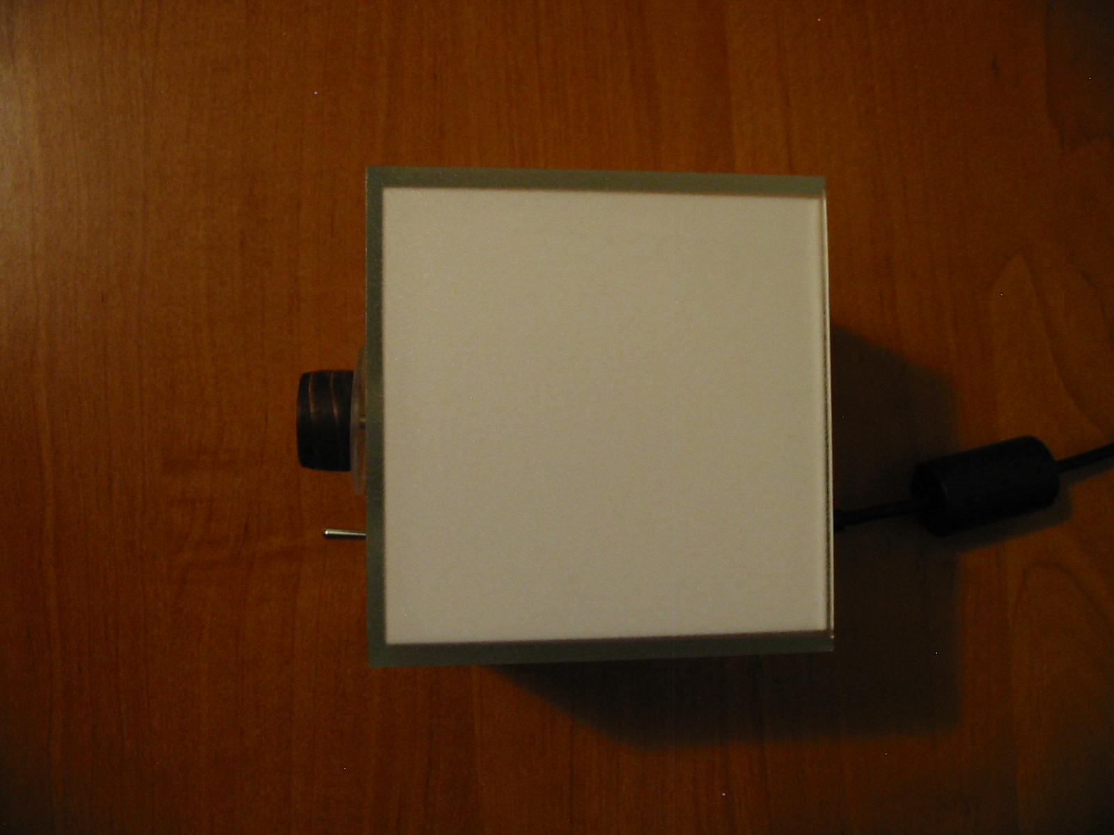

            Turned off:
            The back:
            Just a note, the color of the LED in the amp is a lot more cyan-ish than it appears. I guess my camera couldn't pick up all of the colors. It is one of those opaque blue LEDs.
            I'm thinking about using a different color LED, but haven't got to trying it yet. I have several I want to try actually. Red and orange may look fine, but I probably won't use them since it gives me a feeling as if something inside my amp was on fire.
            More pictures coming in a moment...

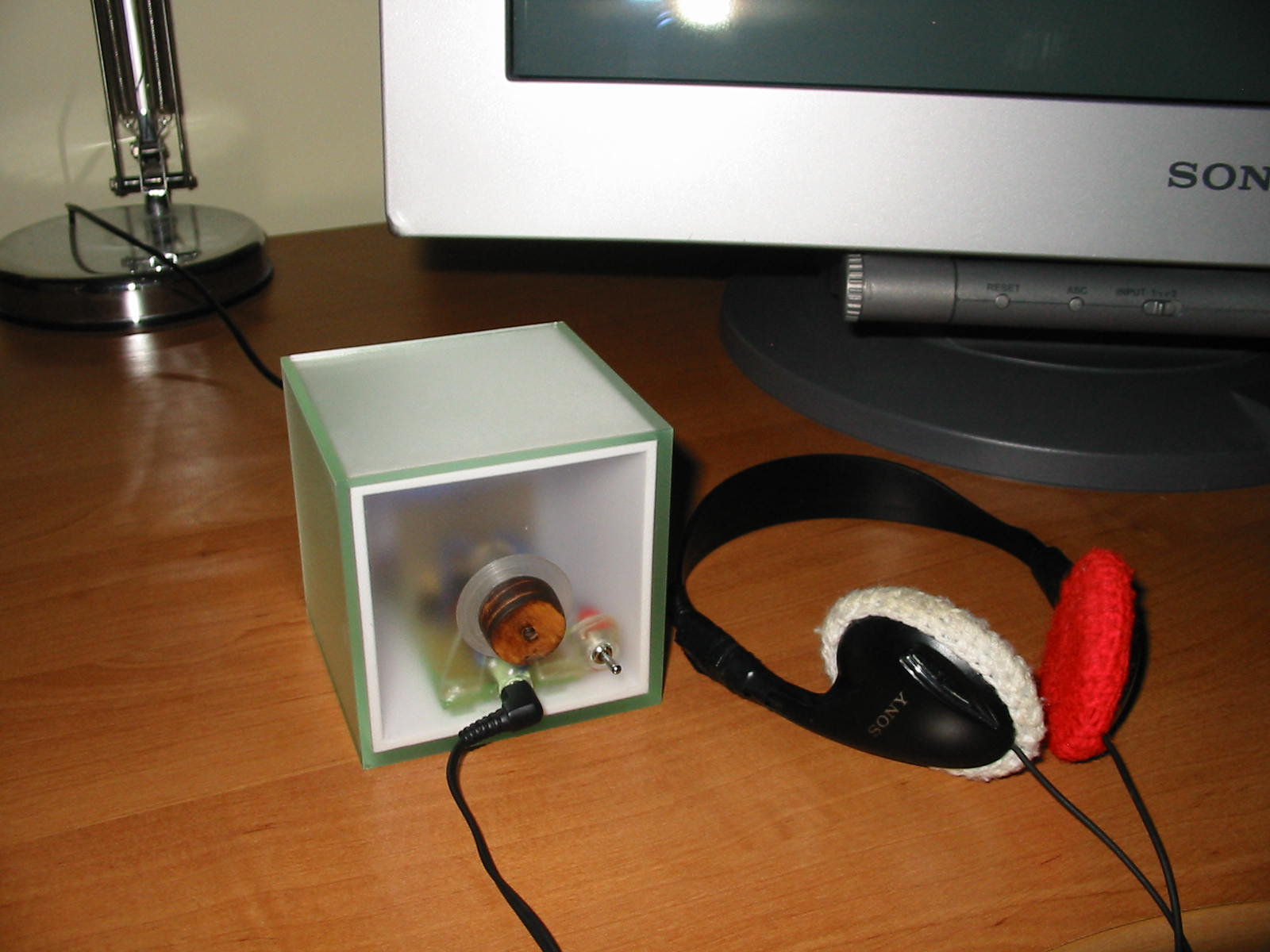

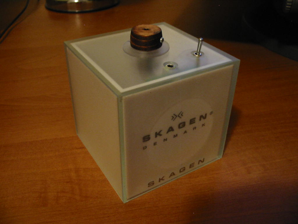

              The top side:
              https://www.badcaps.net/forum/attach...1&d=1343540760
              And here's the case all empty:
              As you can see, the construction is quite simple. There actually aren't any screws or anything like that to hold the white piece to the clear piece. It is simply held by some small friction contacts in the clear piece. I don't think I can make it more simple than that. As for the case, this is what it's from:
              When I saw it several years ago, I knew I could use it for something.

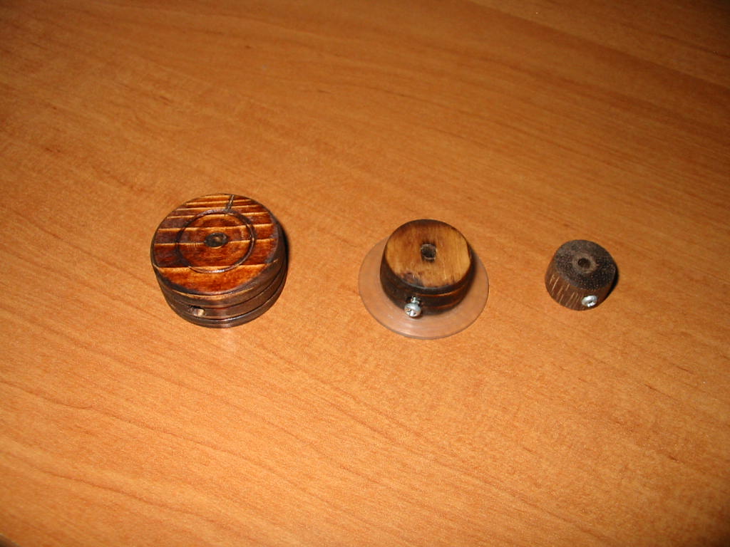

              Here's a few more shots, this time with a different volume knob:
              This was the first knob I made for it. I ended up making more, though, because I just thought it was too big. I don't know, what do you think? I can easily swap them since they are held by a screw to the pot shaft. The small one was supposed to have an acrylic piece like the medium one, but I didn't feel like cutting one for it.
              Speaking of which, this is the tool I had to make to cut those round acrylic and wood wheels:
              Yes, it looks ghetto but it works fine. I got the idea from way back in engineering class in high school. Back then, my friend and I made a custom RC car as one of the projects for that class. It looked cool, so we decided to make a custom turntable for it too. Decided we were going to use acrylic for the rotating base of the turntable.
              We had a professional configurable wheel cutter for our drill press, but it was too small for our purpose. It could only do about 6 inch diameter and we needed a 10" diameter circle. So we made our own and used the cutting blade from the professional one. It worked but it looked scary - having a rotating object that swings about 1/2 a foot each way at several hundred RPM on the drill press isn't something that looks exactly safe.
              This one is much smaller and it's well balance, so it's quite safe. My corded drill had no problems with it whatsoever. I would NOT recommend a battery drill, though - especially if it's low RPM.
              So any thoughts/suggestions about the amp?
              I still haven't put the tone controls, but I will be doing that next. This means there are going to be more switches and knobs added to the amp - actually only 1 more knob and 2 switches.
              The reason for having only 1 knob is that I'm thinking about setting the bass boost to max and thus eliminating the knob for it. The treble I will leave, though. Also, the 2 switches I'll have will do the following: one will select between direct input (i.e. no tone controls) and filtered output (tone controls enabled), while the other switch will select between bigger bass/treble boost but quieter sound output and louder sound output but with slightly less bass/treble (but again, I'll explain how those filters work in another post here another time).

                Lastly, are there any improvements I can make to the Low Pass and High Pass Filter tone controls (perhaps any way to make the LPF boost the low frequencies even further)? I pretty much took the design for those from my Saturn speakers. The only thing I changed is that I didn’t put a 470 Ohm resistor between the LPF and the output like my Saturn speakers did – but I simply did that because I forgot to. With the tone controls, it seems that the output audio level drops quite a bit - any way to improve that? Or is it pretty much a given trade-off?.
                I gotta go right now, so i'll only answer the last question - given that the tone controls are passive and pretty high impedance as far as i see, yes it is normal that the output level drops - because the input level drops. You would need more gain to make that up. If you make the filters active, then you get rid of that level loss, but you complicate the circuit because you'll need a couple opamps to do the job.
                Depending on what the source can drive, lowering the input impedance of the filters will also lower the loss, you may find that an acceptable compromise since pretty much everything these days can drive headphones.

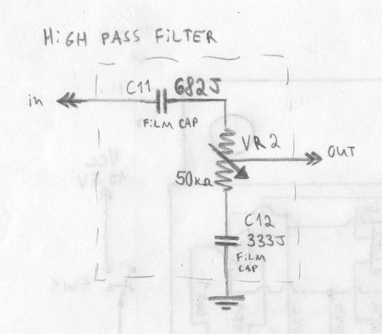

                  Yes, that's what I figured too with my experiments. Don't know how I didn't see that before but now it totally makes sense.
                  Those passive tone controls don't really "boost" the bass and treble, but rather attenuate the mid tones so that the bass and treble stand out more. So if I want more bass and treble "boost", I will have to loose more mid tones. It's basically a trade-off.
                  What I figured from my experiments is this: the high-pass and the low-pass filters work together to allow you to attenuate any or all (low, mid, and high) tones you like. R8 in the low-pass filter controls the signal strength going through the filter and to the rest of the IC. R9 in conjunction with C14 attenuate the mid and high tones. Lowering the resistance of R8 allows more of the original signal to pass through the filter and lowering the resistance of R9 further attenuates the mid and high tones.
                  How the low-pass filter works:
                  As potentiometer VR3 is turned away from R8, the input impedance for the low tones increases but not much for the mid and high tones, which pass through C13. Meanwhile, this also lowers the impedance for the low tones across C14.
                  This makes the low-pass less effective. Doing the reverse with VR3 (i.e. moving it towards C13) "increases" the bass.
                  The principle of the high-pass filter is very simple: as VR2 is moved towards C11, the impedance for the high tones between the input and the output of the high-pass filter decreases, therefore more high tones pass through the high-pass filter. As VR2 is moved further away from C11 and towards C12, the impedance for the high tones between input and output increases while the input impedance for the high tones that have already passed to the output is lowered. In this second case, the high-pass actually attenuates the high tones since the output of the high-pass filter is connected to the output of the low-pass filter and the high-pass filter can further "sink" any high tones that may have passed from the low-pass filter.
                  That's exactly why I didn't want to use op-amps. Moreover, if I used something common as the LM386, that would further add distortion to my already lousy-ly rated AN7272 IC.
                  I may try that. Most of my computers can handle headphones fine, but I do have 2 that distort quite a lot at full volume.

                    That's exactly why I didn't want to use op-amps. Moreover, if I used something common as the LM386, that would further add distortion to my already lousy-ly rated AN5272 IC.
                    LM386 isn't an opamp, it's a cheap n dirty audio amplifier. Even common and cheap opamps like TL072 or NE5532 are going to be plenty for your application. Heck, a lot of stuff nowadays still comes with 4558s, which are #!&%, and they sound just fine for most people.

                      "With my multimeter (-) probe on ground and the (+) to either pin 2 or pin 5 of the AN5272, I get nothing. My multimeter goes up to 40 MOhms. If I reverse the (+) and (-), I get about 29 MOhm and 31 MOhm for the inputs."
                      Since you are trying to measure AC input impedance not DC resistance of your amplifer which is not pure DC resistance. You can use an audio oscillator (1Kz), feed a 50K (or higher) pot on end of the terminal, the viper teminal goes to the input of the amplifier, set the pot to 0 Ohm, put an DMM (10M input impedance) set to AC and monitor the input voltage (set the Oscillator for 1V) of the amplifier, turn up the pot unitl the AC reading is at 0.5V, disconnect the pot and measure its resistance, that will be your input imedance of your amplifier.

                        Most of the time, amplifiers have their input "impedance" well defined, by using a simple resistor to ground from the input, hence no AC measurement needed. I'm surprised there's no DC resistance on the input of this amplifier - then, what are the input coupling caps doing there really?

                              It's been a while since I last updated this thread. Aside from a few very small additions, this amp is still pretty much the same. Originally, I intended to integrate the passive tone controls in the amp, but I've been using this amp on a daily basis ever since I built it last spring (which was more than a year ago now!), so I've been hesitating to take it "out of service" for anything major. I also didn't want to drill new holes in the case because I really like the way it looks now. Therefore, I decided not to integrate the tone controls in the amp and instead to keep them on an external board (last picture in attachments shows the prototype). That way, I can attach them to any other amplifier I want. Most likely, I'll build a separate case for the tone controls (when I get some time, that is). I'm thinking all stained wood with matching acrylic front, but will see. Will also likely add more than 1 input on that in order to have the option to switch easily between different sources.
                              So basically, the only changes are the addition of a new LED. Now the amp glows purple! (Just like I wanted originally.) This color fits it much better IMO. However, I also wanted to keep the blue LED as well just because that's how I built it originally. The solution: added a set of jumpers on the board. These select which LED turns on (can also turn on both at the same time, but this doesn't look good). For those interested, the LED is a Kighbright 3.5 x 2.8 mm SMD violet LED (P/N: AA3528VRVFS/A). Got it from Mouser. A bit pricey but definitely worth the price IMO.
                              Anyways, I think the pictures below show pretty much the final version of the amp now. As usual, I put some matching Avatar background as well .
                              The new look:
                              With my 21" Sony CRT monitor :
                              Amp upclose:
                              Finished PCB from top:
                              Another shot. You can see the Kighbright SMD LED standing in the air with leads that I soldered onto it. A little ghetto, but it works great.
                              Underside (sorry for the blurry picture. My camera just refused to focus on it)
                              (I know the soldering isn't the best, but that's all I could do with a RS 35W iron at the time and lead-free solder)
                              Tone controls prototype board (note the lovely wooden audio "jacks" . They work quite alright too. Have never gotten a loose connection through them so far.):
                              Just FYI though, the purple color of the amp is actually not exactly as the pictures show it - with blue on the edges and pink in the middle. Rather, the purple light from the LED is much more uniform and saturated than that and there is no blue. I tried to do some color correcting on these pictures, but I still cound't get the color to match.
                              So yeah, it's done now! And I am happy with this because this is a rare case where I actually finish a project (hence all the excitement in this post). Perhaps I may build another one . I do have a second identical green acrylic case like this, after all. Actually, I already sort of started on the "guts" of that, but I'll save it for another thread...
