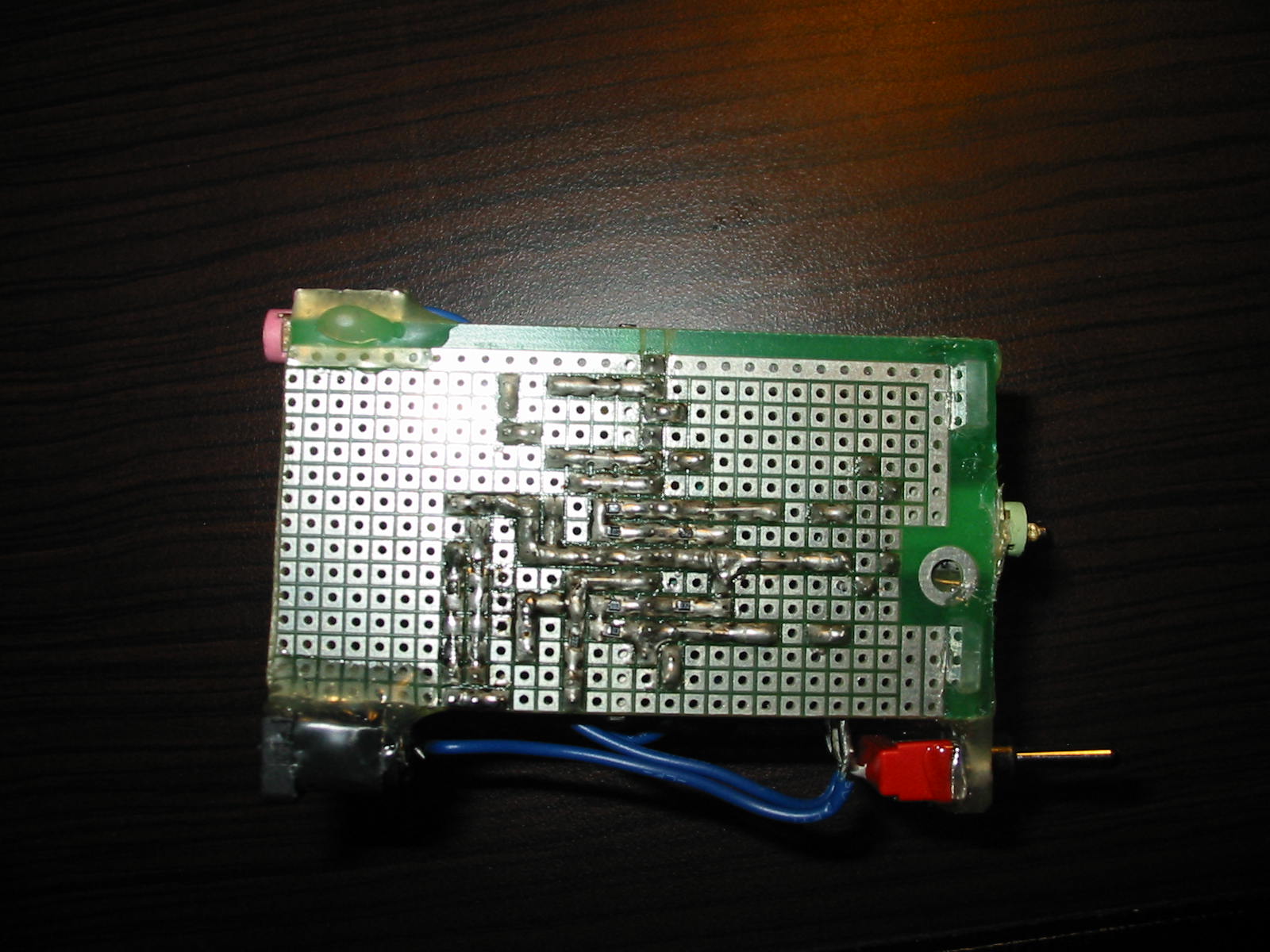

Now, I've read up quite a bit on amplifier theory since the last time I posted on that thread above. However, I still feel somewhat inexperienced when it comes to amplifiers, so I would like to know if there are any improvements that I can make to my circuit below. It's basically an almost identical copy to the application circuit in the AN5272 data sheet. The only changes I have made so far is lower the gain, Gv, from 30 dB (Av = 20 V/V) to ~16.58 dB (Av = 4.255 V/V) and add tone controls (those LPF and HPF boxes found on the inputs).
The circuit actually works – I already tested it on a breadboard. It sounds okay too, and a huge portion of the hiss that I mentioned here is now gone – all thanks to the much lower gain. Believe it or not, the circuit on the TV board had an even higher gain than the suggested one in the data sheet – it was set to 33.4 dB (29.4 V/V). No wonder it was picking up all sorts of random signals
Overall, I'm satisfied with the way it sounds, though. However, there are still a few things that bother me…

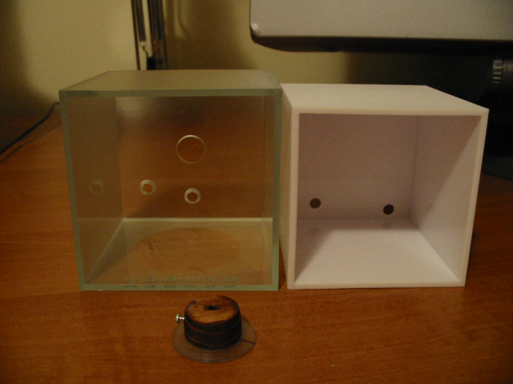

Sorry for all of the noob questions. I don't really expect anyone to answer all of them unless they would like to. Most likely I will just experiment some more with the amp to see if I can answer some of those questions myself. However, if anyone doesn't mind answering a few of them, I would be very grateful. I would actually like to finalize and build the amp in a few days if possible. I have all of the parts ready and a case as well. Won't give too many details away, but the case has some see-through plastic, so I'm thinking of putting some LEDs in there too
