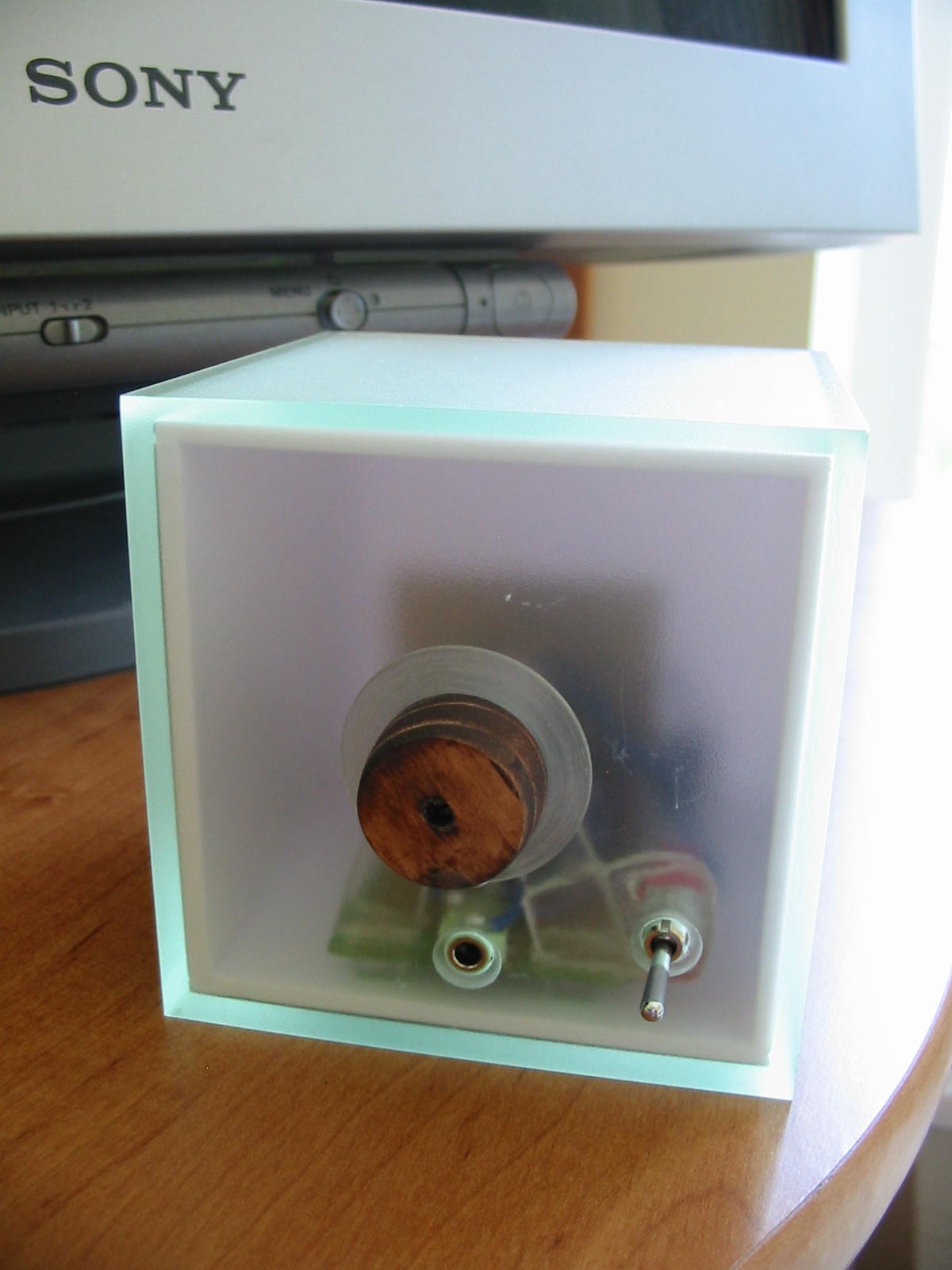

 ). . The heat sink is copper and also of high quality (any guesses where it might be from?
 . The heat sink is copper and also of high quality (any guesses where it might be from?  . I only used Lead-free solder since someone gave me a really big spool of it long time ago – hence the cloudy joints in case you were wondering why. It didn’t help that I only have a 35W unregulated Radio Shack iron.)
 . I only used Lead-free solder since someone gave me a really big spool of it long time ago – hence the cloudy joints in case you were wondering why. It didn’t help that I only have a 35W unregulated Radio Shack iron.) . Pictures are coming very soon, I promise. I just need to finish the knob for the volume control – yes, it's all handmade. I actually had to make a custom tool to make it
