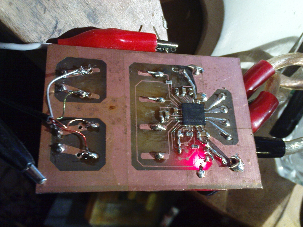

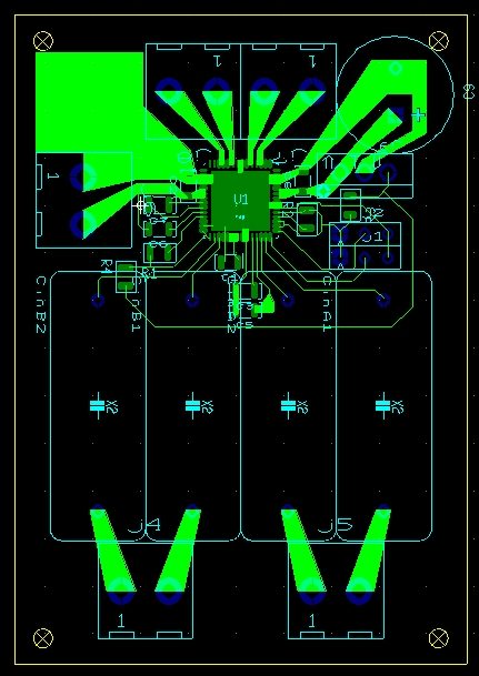

                      Chipamp PSRR decreases based on ripple frequency. Switching supplies should be avoided unless known to exhibit very low ripple.
                      I have not bought the amp linked, but looking, the input would be right before the POT.
                      Sadly the truth is, today you can't buy all the individual parts for practice and end up with as good an amp at same cost, economy of scale means the price can be undercut so long as it involves enough components to offset shipping cost, BUT beware, higher power and more costly amps on ebay may be fakes using generic/relabeled amp chips. OR, that could be considered a positive thing. Depends upon the goal.
                      Frankly, what will make the most difference isn't the circuit, it's the enclosure you use for these speakers.

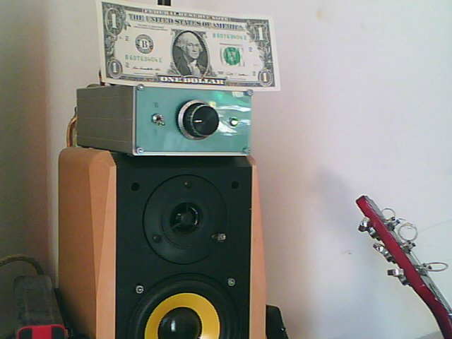

                          ya, i've got a nice little DIY TA2024C amp running here.
                          great sound, it's more than enough for normal listening, and it's got enough to punch to piss off the neighbors even with the small desk speakers.
                          the thing runs off a 12V 2.5A SMPS brick with some filtering and bulk capacitors. no complaints at all.
                          too bad Tripath have gone out of business. those amps are still abundant on ebay etc, but IC stocks won't last forever. i wonder how long it's gonna be before the first fakes show up.
                          and i've got a few MAX9709 samples here ().
                          should be good enough for my needs. we'll see how it sounds (filterless? hmm), maybe i'll make a sub amp out of it.
                          it's a TQFN package (bah), but not impossible on a single-sided PCB. it's a bit ugly.

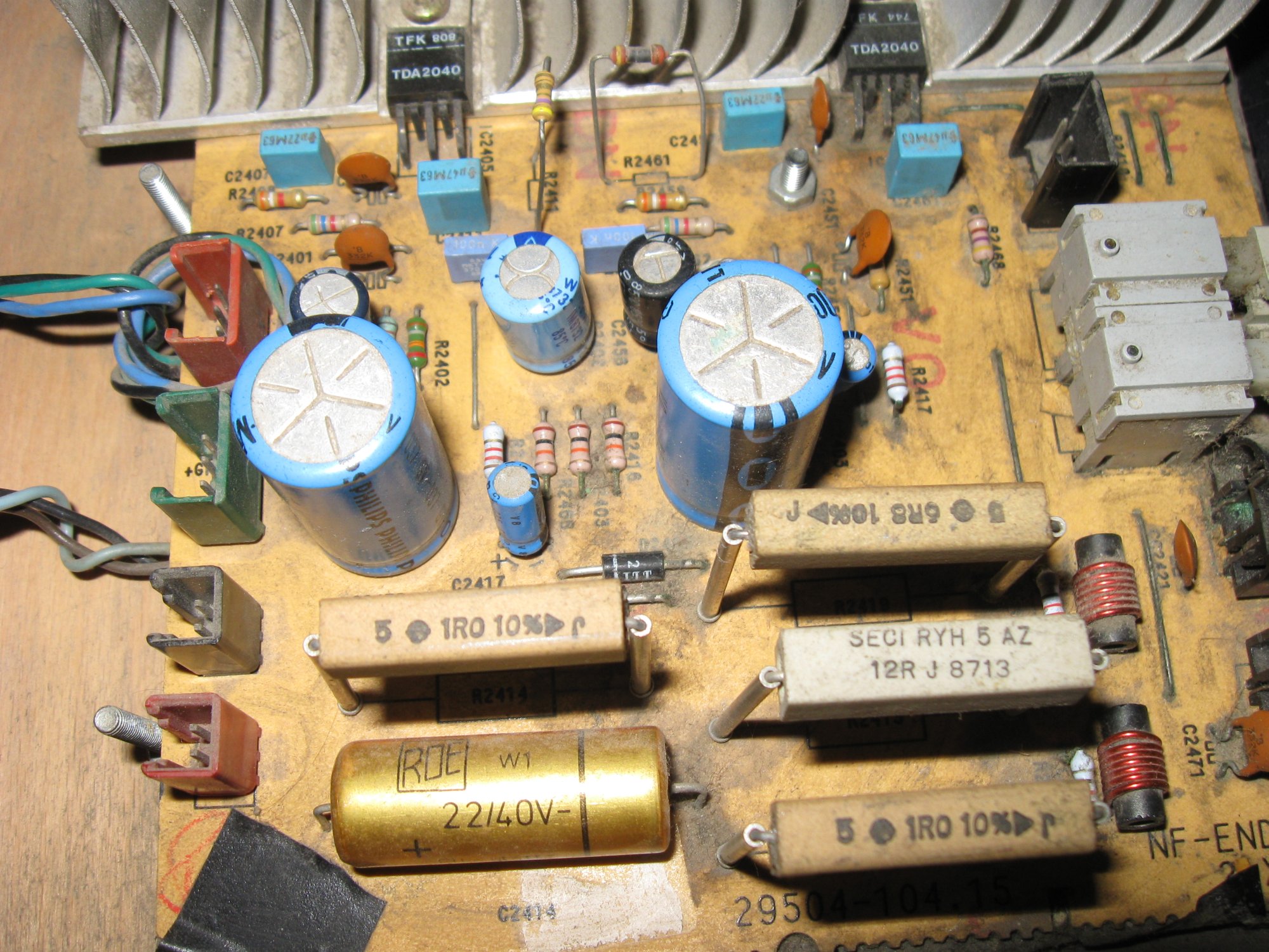

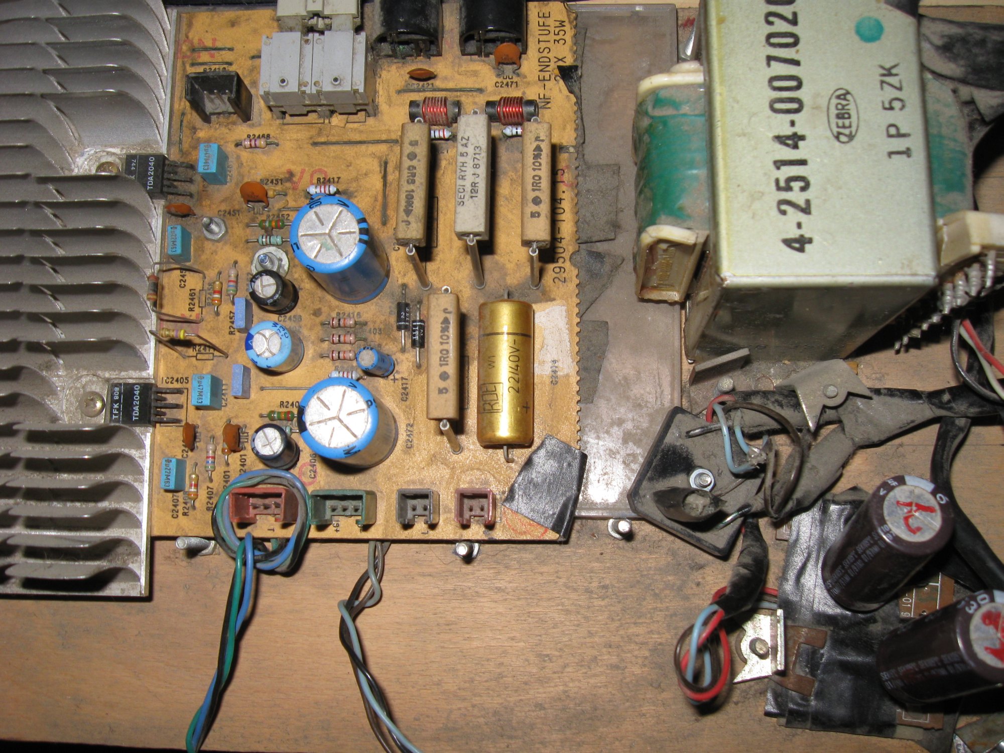

                            Well , I already showed in another post the amp that was pulled from a Phillips TV...
                            As you can see, quite simple construction, two channels, almost two copies with some glue between them added for some headphone outputs and other stuff the tv used to do.
                            The TDA2040 do about 25 watts when powered to +/-25v or so ... i don't remember exactly as i don't have the datasheet in front of me... but this one I screwed on the wood board does about 12-15 watts @ 4 ohm with the +/- 16v I give him.
                            The voltage is simply generated from a transformer with two windings on the secondary which then gets passed through a bridge rectifier to generate the + and - and then each goes through a 3300uF 63v teapo capacitor.
                            The large blue capacitors do the extra power storage for each amp.
                            (you can see on the board it says 2x35w but that's with 10% distortion, it's more like 25w @ 1% thd or less)

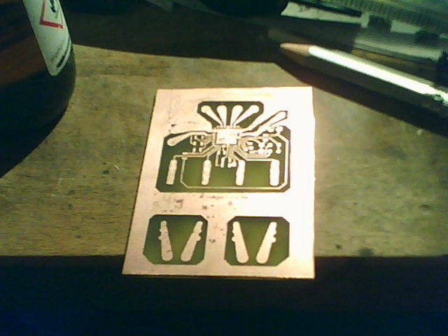

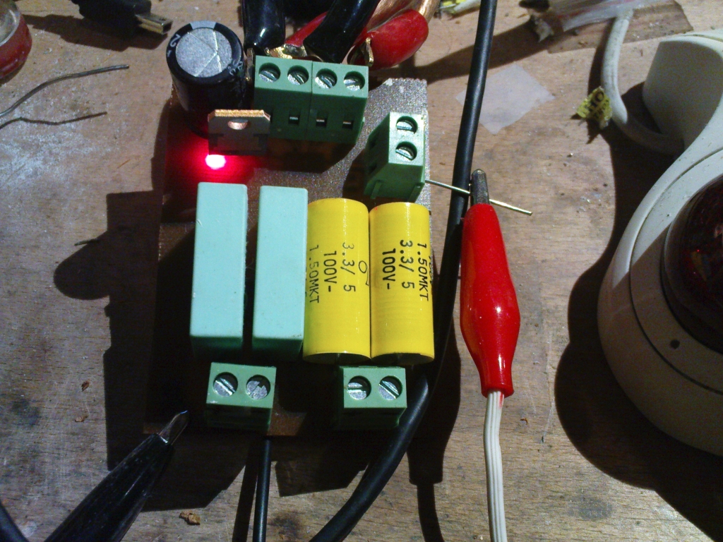

                              Re: Making my own little speaker system
                              Originally posted by shovenose
                              Please clarify this. I don't know much about audio stuff, and I'd be curious to know what distortion you mean and how it could possibly by enjoyable.
                              The entire reason I was going to do this was to get practice with curcuit design. However, that almost seems like too good a price to pass up! thing is, where's the input??
                              To clarify, on one of the pics you can see the side of the board with the POT and two long yellow film caps. The input is there, a rectangular screened trio of holes marked "S-INPUT"... so at the least you'd also need some wire and whichever type of connectors you choose, as well as terminals or hard-wired connections for the speaker output.
                                  nice! the MAX9709 works fine so far. it's still a little ugly (FrankenAmp?) but sounds good. i love the Tripath, but there's absolutely nothing wrong with this one.
                                  it doesn't have the one downside of the tripath: operating voltage up to 22V (vs. 14V absolute max).
                                  and it only cost a few bucks (everything came from the parts bin or trash, samples were free).
