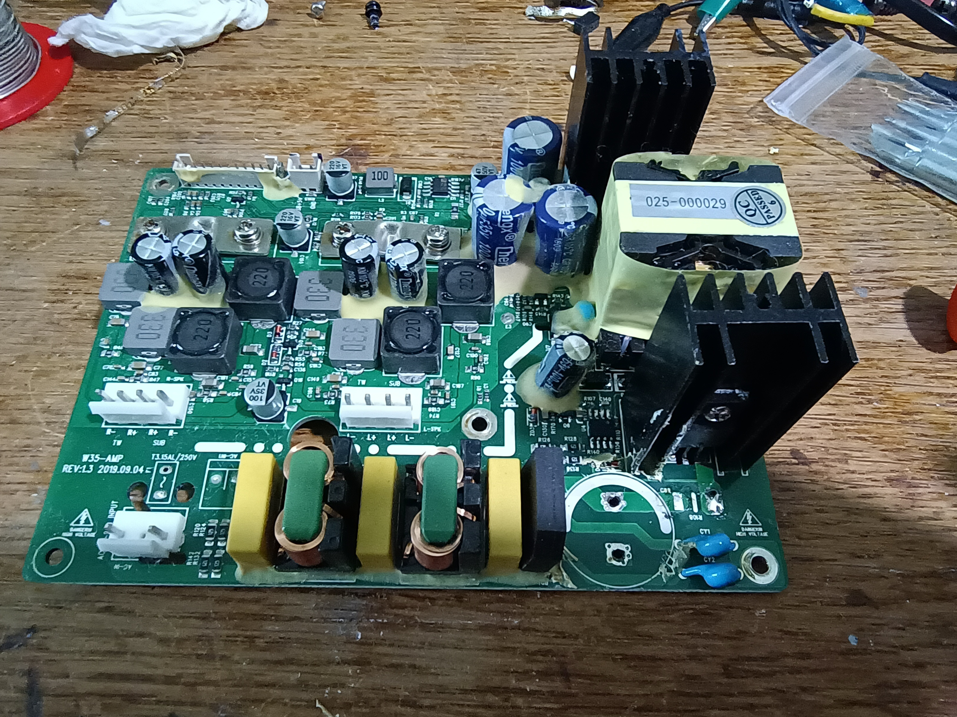

    Hello everyone !
    I'm trying to repair the power supply of my Elipson W35 Bluetooth speaker. The problem is that the PWM circuit has no reference "it's a smd marked U4 on the pcb. The reference has been erased at the factory. Here are some photos of the circuit; could you please help me identify the circuit? Thank you, and have a great day
    Important point: the resistor R108 marked R100 smd mount is a replacement and I'm note sur if it's the good value, it's relay the mosfet to the ground capacitor 450v
    the mosfet is a :SVF12N65F
    I also search the reference of the zener diode marked ZD3, I think it's a 15v !?

      Originally posted by Phoenix88
      Nobody have an idea please ? I'm blocked with that IC....
      Lemme un-block you a little bit…
      Looks like pin 3 & 6 have no connection. Probably something like an On-Bright OB2263 or similar 8pin sop8. Download the datasheet and verify.
