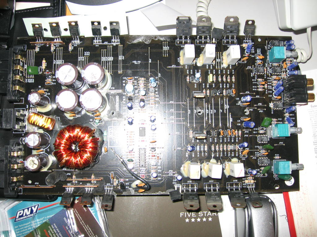

    Well I really don't think that I'll be able to fix it my self but I can try.
    It's a 337 watt mono sub amp that is 2 ohm stable. I think I only paid $90 new.
    The problem is it doesn't work right.
    1. It turns on but no power light
    2. A fake siren like noise comes out of sub
    3. 3 sec later Fuses blows and noise stops
    4. replace fuses
    5. back to one
    I think it might be the output fets but I'm not sure how to test them.

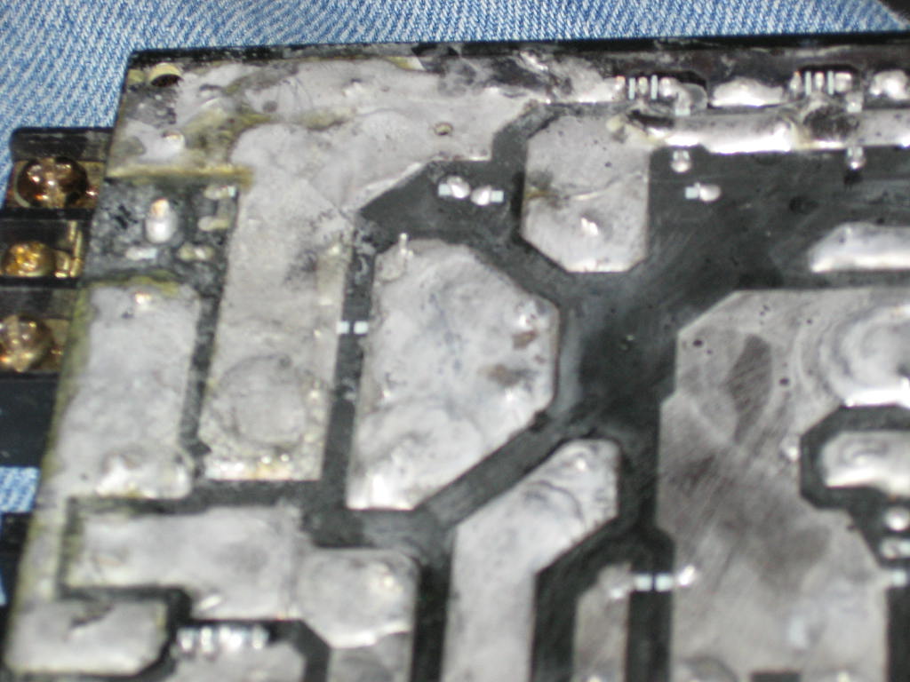

    The likely cause of failure is overheating, don't know what all this would have damaged.
    Look at that nice factory solder job, but it is made in china

    It seems a little bit difficult for me to judge this situation here, but I will try my best.
    The amplifier with no power light and making a sound from a speaker shows the amplifier section (and power supply section) is apparently OK (even though I can see a differently branded TIP36 transistor).
    There appears to be residue of something which has dried up; some of it is near the large-value electrolytic capacitors (be sure to clean it up with alcohol before performing repairs!). The large transformer is the DC-DC converter, and the sound you described is most likely to be caused by bad electrolytic capacitors loading down the output from the DC-DC converter.
    The first thing to do is unsolder all 7 large electrolytic capacitors (taking notes first!) and measure them with an ESR meter and a multimeter. If you get a low-resistance reading with a multimeter (<10 ohms), the large electrolytic capacitors need to be replaced (What are the series of the Su'scon electrolytic capacitors? Also, what other brands of electrolytic capcitors are used in this unit?)
    If the fuse still blows, despite carefully replacing the electrolytic capacitors, unsolder each high-power transistor, MOSFET and high-power rectifier (taking notes first!) and test them with a multimeter. If there are no shorted devices, put them back into the circuit.
    Also check the high-wattage resistors as well.

      Looks like water has entered the unit, I got a broken LA Sound amp just like that, it had blown all it's mosfets on one side, replaced them and then it ran just fine... Using it in my car now... (blown them as they fell apart when I removed the matal parts holding them to the heatsinks LOL)
      So check the Q9, Q12 and Q15 Mosfets after you check the capacitors, looks like they have become warm to me...

        i would clean up any water damage.
        the sound you hear is the boost converter trying to pump raw dc into the sub via shorted outputs.

            It never got wet so all that crap is from the factory.

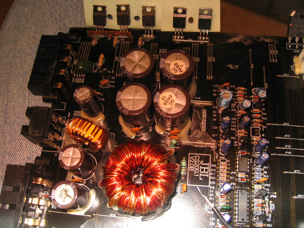

            The big caps are SD 105C, small dark blue are SL 85C, light blue SN 85C
            It has less then 30 hours by me, but it is a refurbished unit.
            Is it really nessarsary to replace the caps

                power section is around the big toroid.
                outputs have the white resistors next to each one.

                        What are the values of the 7 large capacitors (SD series)? I want to cross-reference their paramaters with a good brand.

                          big 4: 2200uf 63volt 22mm wide by 26mm tall
                          2: 2200uf 35volt 16mm wide by 21mm tall
                          1: 1000uf 35volt 14mm wide by 26mm tall
                          That one output side fet I tested seemed fine but I gota check more of them

                            A good replacement for the Su'scon SD series are Nichicon PW Series
                            The Su'scon SL series are general purpose units; use a good brand of high-temperature (105C or higher) units. Also, the Su'scon SN series are bipolar units; again, use a good brand of high-temperature (105C or higher) audio grade units.

                                I didn't give up on it yet, I found that the middle TIP36C is shorted, it is the only one I could find.
                                I think I should replace all six output transistors because they only cost $1.74 a piece.
                                $10.50 to fix an amp, not too bad.
                                What would happen if turn it on with that TIP36C removed and no sub hooked up, could it damage something. It would be for only 3 sec or less.
                                I just want to test it without that tip36c in, to see if that is the only problem.
