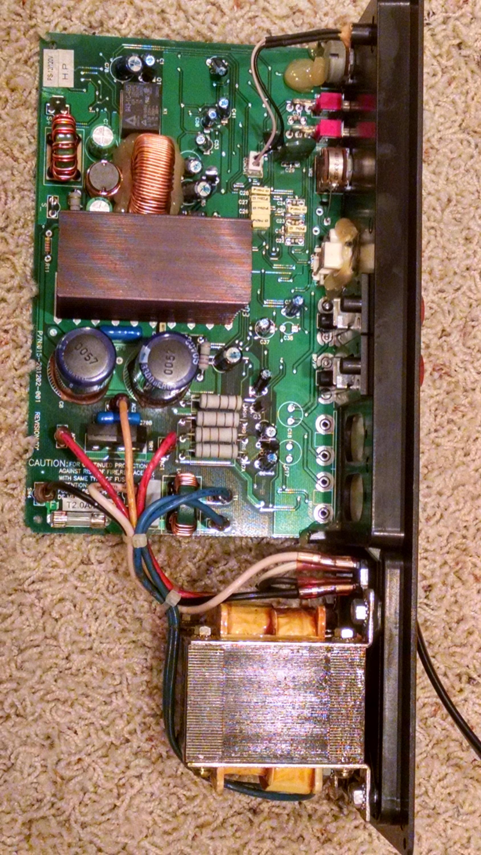

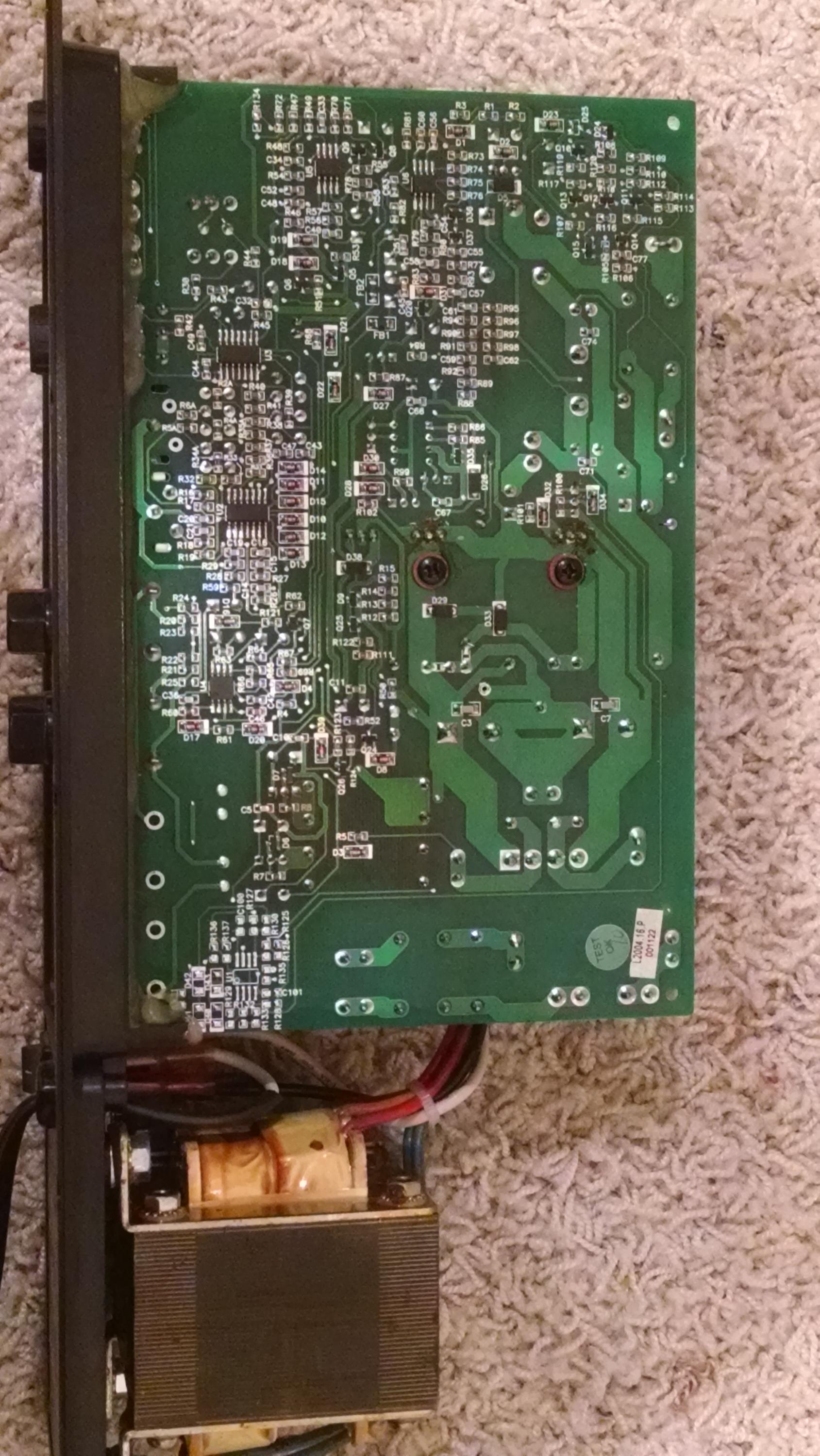

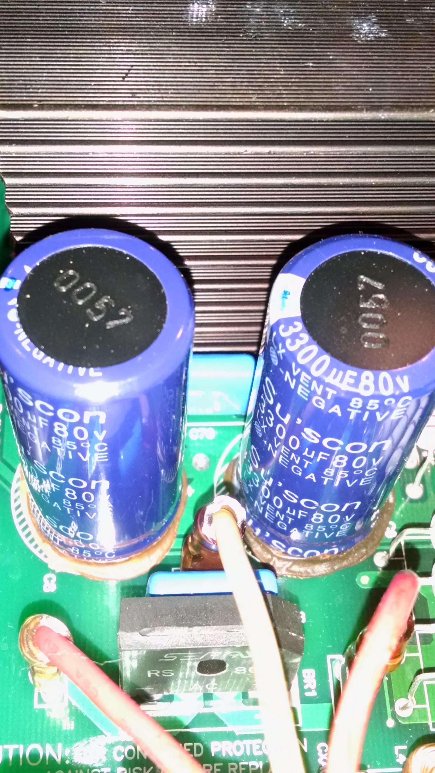

    I have an Infinity PS-12 that's exhibiting slightly different symptoms – the signal detection circuit detects when a signal is present and the light switches from red to green as expected but the sub hardly outputs any volume. This thing should rattle your teeth when it's working properly.
    The capacitors at C6 and C8 looked suspicious to me but after doing a little reading that may just be glue that was applied at the factory to hold them in place. So, I am wondering if the experts here have any opinions on how I should troubleshoot my sub. I am not an electronics expert but I can handle replacing the capacitors if they are indeed the issue and I can find suitable replacements. The sub is about 12 years old. It really hasn't been used all that much and it's never been pushed hard – mostly just used for movies and not at some outrageous volume.
    Any information/advice will be greatly appreciated.

      four3rds, yes that's just glue that turned brown from heat. The way they put the shrink wrap on some caps that size, with the plastic disc on there it makes them look a little domed on top like bad caps get but that's usually just the plastic disc bulged up, not the metal under it.
      Trying to describe from scratch how to trace an amp is really beyond the scope of a forum post but basically you whip out a multimeter and see if the right voltage is getting to the output transistor(s) or power pin on an output IC.
      With the audio you feed it a line level continuous tone and probe for where the signal (AC voltage) drops out. Since you are getting audio I wonder if it's just a potentiometer with a bad wiper. You could jumper across its pins to see if that produces FULL volume. Feed it a lower signal level in case that would blow the speaker or disconnect the speaker and measure output voltage. If you can't figure out which 2 of the three pins to jumper then you probably should ignore my advice and not be messing with a live mains powered amp, but basically one pot pin is signal input, one is ground, and one is output. Jumper input to output.
      If audio signal is making it that far you keep tracing the circuit to the next IC's audio input pin and verify that the audio output pin is outputting signal, and if it's a gain stage then the voltage should be a multiple higher to reflect that gain. You keep tracing the audio AC voltage all the way to the speaker output to see where it's supposed to get gain and isn't, or see where the signal is dropping like if there's an output relay and the contacts have oxidized so it's acting like a capacitive coupling. When tracing you'd get the part # off the component, use that to get the datasheet, and use that to get the pinout for power and audio I/O.

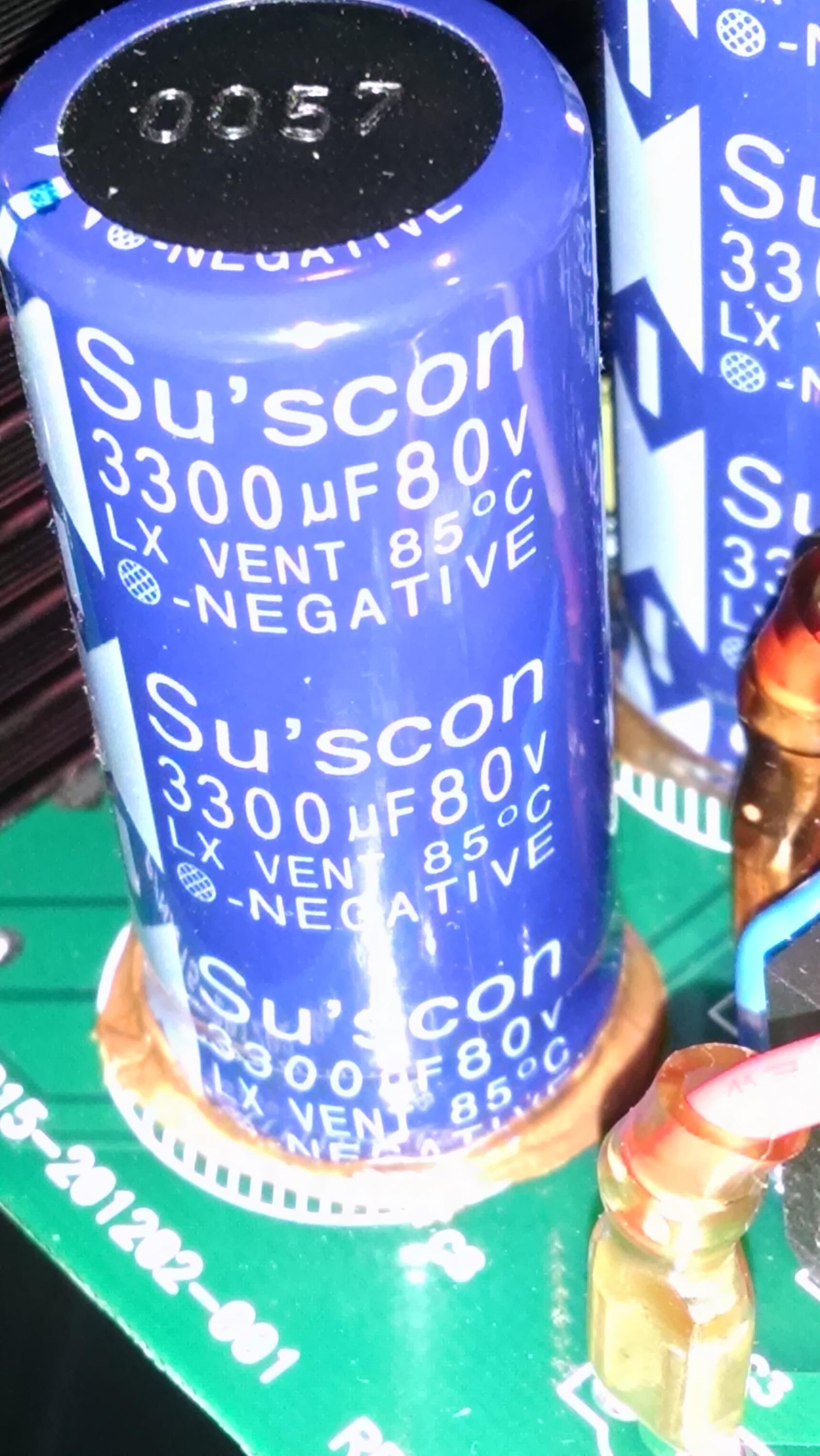

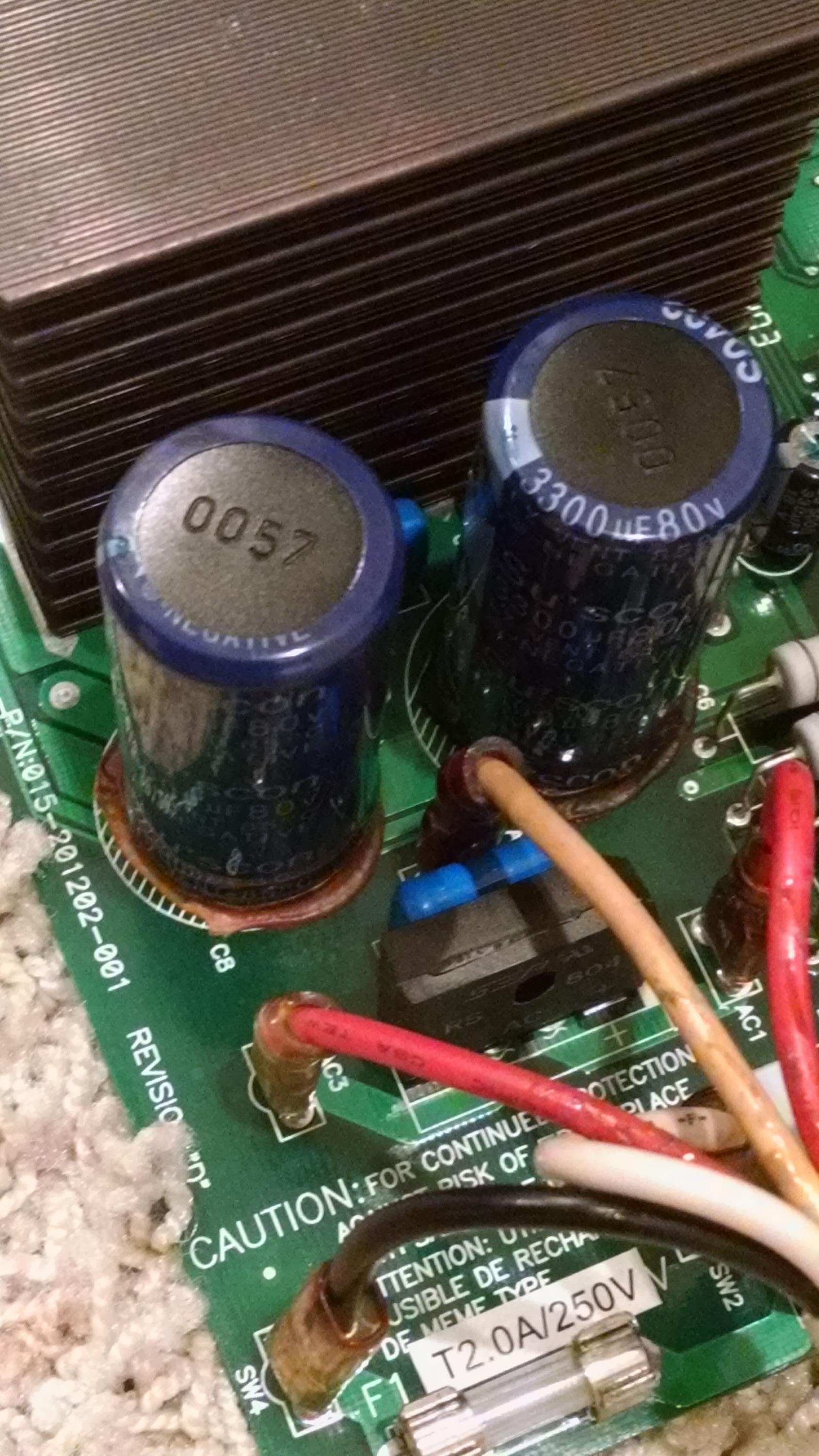

                        Love the information here! I was able to repair one of my two PS-12 with the information provided!
                        I bought a pair of PS-12 in 2006. It's now 10 years and I found out both of them are somewhat dead... x(
                        The left "L" Sub is 6 month newer than the right "R" Sub by manufacture date, and uses Su'scon 85 degree c main caps. One of them has failed, with a bulged top. The older "R" Sub uses Samxon 105 degree c main caps and they are Ok after I replaced the standby caps C2 + C4 & C9.
                        I replaced the newer "L" sub with Nichicon 3300 uF 80v 105 degree caps, but it is still having an issue. It would play bass fine for a while, and then after 30 minutes ~ 1 hour, it would start to make cliping noise as if the amp is running out of power. My "R" sub runs fine during those bass passages.
                        I thought replacing the bad Su'scon caps with Nichicon caps would have solved the issue, but it did not.
                        Anyone have an idea as to where to start to troubleshoot? I have a cheap oscilloscope that I don't know how to use much, lol. Can a bad transistor exhibit the symptoms above?

                              My PS-12 has a revision "D" board, which is a design between the PS-12 service manual and the PS210 Sub. From there I compared the design changes and found a few interesting tidbits.
                              C65, a capacitor near the IR2111 IC was 470uF/16v, it has been changed to 47uF/16v.
                              C39, C75 was listed as 33uF 16v parts. But in the schematics they were 22uF 25v parts.
                              I am hoping to "upgrade" some of the parts. C2 is a part that caused the Sub not to turn on from Standby, and it is a 4.7uF/50v part. The 50volt part is interesting since the power supply rail I believe is 15 volt, and the outputs are 72 volts or so. I changed C2 to a 4.7uF 400 volt part, hopefully the C2's capacitance have not decreased too much if it is only getting 15 volt.
                              BTW, if space allows perhaps C6 & C8 3300uF caps can be a 100volt part or greater? I measured 72 volts on them with 80 volt rated caps.
