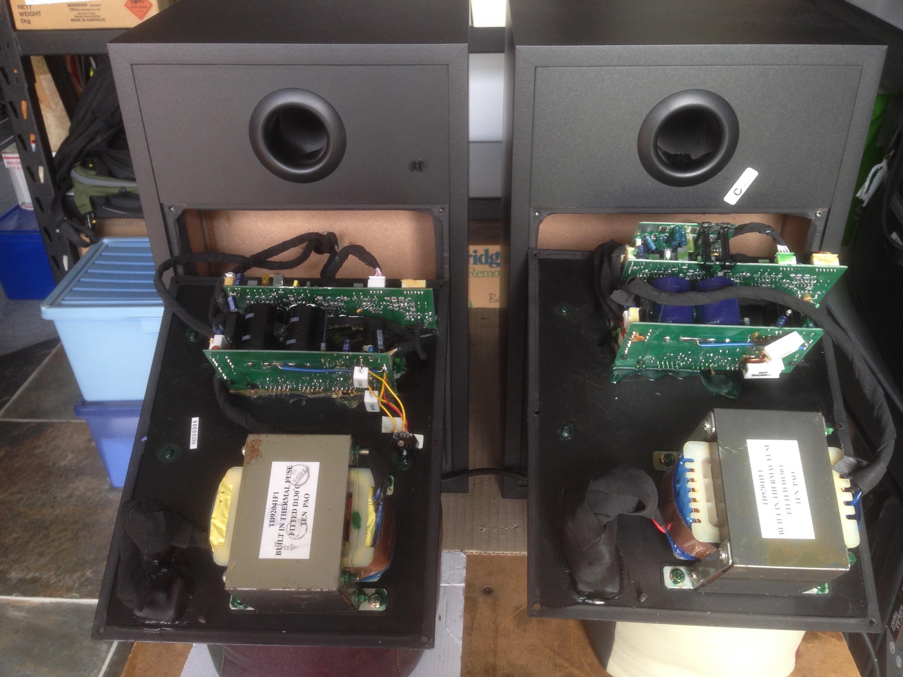

Tannoy Reveal 6D
  • Khron
    replied
    Re: Tannoy Reveal 6D
    Slight update from this side as well.
    It must've been a couple months ago that the tweeter output in my right-side Precision 6D died out. But since i hadn't done any mixing or critical listening, just watching YouTube and some series, it didn't bother me all that much. Not enough to take it off its place (bit uncomfortable to reach), crack it open and see what's what.
    That is, until last night, when the left-side one went totally mute. Voltages looked ok, S/PDIF was locking on (LED on the back went from red to green), DAC-to-crossover-board cable was ok, power amps & drivers were ok (jiggling the switches made a bit of noise). So i "chiseled off" the black gunk off the ends of the cables, double-checked the speaker connectors, and it finally came good.
    Mostly the same routine with the former (right-side) one as well, except without improvement. That is, until i decided to give the tweeter level trimpot a twist. And lo and behold, with some initial crackles, the tweeter came back!..
    <sigh> I really gotta see when and how i can scrape together some cash, to finish my project to overhaul the electronics in these.
    Got the two TAS5630 class-D amp boards almost fully populated, just gotta wind the output inductors (got the cores, need appropriate wire).
    Got the little DSP boards pretty much designed (ADAU1701, tap off the I2S signals from the DAC board), still need to get the PCB's manufactured, plus the little adapter board for the DIY "USBi", and some panel-mount miniUSB's.
    Leave a comment:
  • Valden
    replied
    Re: Tannoy Reveal 6D
    This is a fresh post to this very helpful thread, seeking assistance with identifying the thermoswitch on the power board of my Tannoy Reveal 6D monitor.
    Diagnosis: The music was fading out in one monitor, which was the master of the S/PDIF pair. The other monitor kept playing, so I suspected a problem with the audio or power circuit in the problem monitor. Upon inspection, I found that the trace between the transformer connector's pin 3 and the thermoswitch was broken. Soldering in a jumper wire to replace the trace got the monitor working again - for about four minutes from a cold start, at which point the music fades with crackling over a period of about 10 seconds, to nothing. This replicated the fault I noticed before disassembly. If I jump the thermoswitch with a test lead, between that transformer connector pin 3 and the near side of diode 3, bingo, I've got music again (see pic below). That switch is looking guilty. :-|
    Any info on what it's specs are, or might be? Sourcing a form/fit replacement could be tricky/expensive/slow, so I might use a switch with suitable specs, should one be available at the local Jaycar store. I'll mount it near the amplifier ICs, so it can feel the heat. Another option would be to just bypass the thermoswitch permanently, though I worry about the missing protection for the amps. From studying the power board schematic I gather that the thermoswitch works by muting the amps when it opens due to excessive heat. Upon opening, current flowing through the amp's pin 8 drops below 0.5mA, muting it, which stops it from operating and getting hotter. A point to note is that the amps (Texas Instruments LM3886) include built in thermal protection. They shut down at 165℃ and start again at 155℃. Not ideal, but an OK temporary fix. The heat sinks for the amps are quite substantial, after all. :-)
    Leave a comment:
  • Khron
    replied
    Re: Tannoy Reveal 6D
    Tiny update.
    The other day, the tweeter in one of my Precision 6D's seemed to go out of commission.
    Removed the back plate, cleaned off the speaker output connectors on the power board, removed the contacts from the tweeter connector housing, bent the "tongues" inside the contacts so they press harder onto the pins on the board.
    Whaddya know - tweeter came back to life
    Propped the speaker back to its rightful place, and guess what - woofer sound went away...
    After some messing around, i figured i'd start flipping switches, and it turned out the 80Hz high-pass switch was the guilty party. A squirt of contact-cleaner and 20-30 operations later, all was well (and stayed that way)
    Now, for a more long-term plan:
    1) redesign the filter board - reusing the connectors, surface-mount resistors, film caps and DIP-switches; NOT reusing any of the ceramic, electrolytic caps or opamps (replacing them with either NJM2068's or NJM5532's);
    2) redesign the power supply & amp board - "piggyback" / retrofit a stereo class-D amp (2xBTL) board; reuse the big fat electrolytics; change the power supply to be a full-wave rectified +39v only, for the power amp; add a 1A bridge rectifier & a pair of cap-multipliers to work as discrete regulators (bolted to the existing heatsink) to power the filter board
    Leave a comment:
  • Khron
    replied
    Re: Tannoy Reveal 6D
    Either way, congrats on the revival
    Leave a comment:
  • Valden
    replied
    Re: Tannoy Reveal 6D
    Ah, Variable Resistor! hehe.
    Thanks.
    Leave a comment:
  • Khron
    replied
    Re: Tannoy Reveal 6D
    Variable Resistor 1
    Well, sometimes you get lucky :P
    Leave a comment:
  • Valden
    replied
    Re: Tannoy Reveal 6D
    It's not a voltage regulator? When I look at the schematic it's called VR1. And yes, it's rated at 1K (with no units, but Ohms it is! ). I'm happy to call it a trim pot, since that's what it's supposed to do.
    Thanks for the advice on trying the contact adhesive. I have a can of CRC CO Contact Cleaner for such purposes. Expensive stuff! I've seen others using isopropyl alcohol.
    I have to say, if I'd known that the main problem with this monitor would end up being the second surface mount component I lifted, I'd have been lifting them a lot earlier. Still, those days worth of looking at the boards and schematics and using my full powers of ESP paid off. It's surprising what can be achieved with the worlds crappiest multimeter. Sometimes when it's on the voltage setting it behaves more like a random number generator. Re those Brymen's, TME in Poland seems to be about the best source.
    I have half a dozen supposedly failed negative voltage regulators on the desk, all of which test just fine. Oh well, spare parts.
    Leave a comment:
  • Khron
    replied
    Re: Tannoy Reveal 6D
    Those aren't voltage regulator trimpots - they're just literally a volume control, for the tweeter channel
    At least before bothering to source a replacement, sure, contact-cleaner's well worth a shot. Definitely can't hurt, anyway
    Since they're trimpots, they're (obviously?) supposed to be continually-adjustable (as opposed to a multi-position switch). The schematic says that's a 1kohm trimpot, but you'd need (in an ideal case) to find one with a compatible footprint (ie. pin spacing, etc).
    Then again, now that i read your message more carefully, they wouldn't necessarily need to be set to the same position, in both monitors. Mechanical things (ie. speakers) can easily have wider tolerances than electronics, so those levels should best be set using the actual tweeters, imho
    Otherwise, even if you have the trimpots set the same, you're at the mercy of whatever sensitivity differences (dB per watt) the two tweeters might have...
    Last edited by Khron; 10-12-2016, 04:55 PM.
    Leave a comment:
  • Valden
    replied
    Re: Tannoy Reveal 6D
    Re the attenuated tweeter level, I had a look at signal strength at the voltage regulator on the filter board (the trim pot Khron mentioned) and compared the two monitors using the audio probe. The output from pin 14 of opamp 3 goes to pin 1 of the trim pot. With the good monitor the factory set output from the trim pot (pin 2) was a touch lower in volume than the input, to my ear. The trim pot appears to be adjusted fully clockwise, which appears to be fully attenuated, from fiddling with the one on the faulty monitor's filter board.
    With the faulty monitor, the factory set position was also fully clockwise, but there was a big reduction in signal strength across the trim pot's pins. I found that in turning the fiddly adjustment screw through its 180 degree range, fully anticlockwise, that the output level came up, to equal the input, by ear. The trim pot is very intermittent during adjustment and has only two settings: fully loud at hard left and what sounds much the same in the middle.
    Are these voltage regulator trim pots meant to be progressively adjustable, or do they have two or three settings? Would a drop of contact cleaner and some sweeping back and forth help?
    FWIW I checked voltage levels with my POC meter (ain't got that Fluke or Gossen yet). The good monitor was steady at 3.8mV in and 1.2mV out, with an audible reduction in level from using the probe. This was measuring DC millivolts though. Wrong? Each time I checked the faulty monitor I saw readings of around 14 millivolts at pins 1 & 2. Que?? The opamps in both monitors appear to be working the same.
    The outcome is that I'm now getting pretty good and reasonably balanced sound from the two monitors. The 'faulty' one might be a touch overdone in the high frequencies, but I'm not too fussed given where it's come from. I'll look into replacing that trim pot. I'll report on any markings I can find. Do we know the manufacturer and part number? I'm guessing a properly specced generic replacement would work?
    Last edited by Valden; 10-12-2016, 02:31 PM.
    Leave a comment:
  • Th3_uN1Qu3
    replied
    Re: Tannoy Reveal 6D
    Now would be the time to install a signal generator app on that iphone and trace thru the signal path for the tweeter amp. I am sure Khron can help you with this more than i can, as i have never taken apart this model monitor.
    Leave a comment:
  • Khron
    replied
    Re: Tannoy Reveal 6D
    No worries, it's just "giving back to the community", as far as i'm concerned
    Keeping information like this secret benefits noone, not even me
    Attenuated tweeter, you say? In a pinch, you could fiddle with the trimpot that's on the output of the tweeter filter section (that's what it's there for, actually - fine-tuning the signal level at the input of the tweeter amp).
    Leave a comment:
  • Valden
    replied
    Re: Tannoy Reveal 6D
    Before I forget, Khron, thanks for your patience and assistance with this. It's been very good of you, to respond so helpfully to a new member's problem. I've really appreciated your advice and encouragement.
    Leave a comment:
  • Valden
    replied
    Re: Tannoy Reveal 6D
    I rang Jaycar and to my surprise they said they had just the thing. But when I got there, just before closing, and showed the girl the surface mount cap I needed, she said. 'Oh, I don't think we have any of those!' I settled for the next best thing - a ceramic cap of 10nF and 50V rating.
    The monitor is working! But, the high frequencies are significantly attenuated. Could it be the ring-in cap I'm using? I'll check the schematic to see if opamp 2 (IC2) has anything to do with the highs. The tweeter itself is fine. The highs problem moves with the repaired electrics; the tweeter works with the good monitor's electrics.
    Leave a comment:
  • Khron
    replied
    Re: Tannoy Reveal 6D
    There ya go then! Glad to hear you nailed it that quickly
    You'll want the replacement to be rated for at least 25v though.
    Leave a comment:
  • Valden
    replied
    Re: Tannoy Reveal 6D
    I decided to focus on the surface mount components that were single points of failure in terms of creating a short between the negative rail and ground. I lifted one end of C18. Nope. The short's still there. What about C21? Holy crap! The short's gone. Connect it again with a molten strand of solder. The short is back. Break the strand? The short's gone again.
    With a bit of luck this could be the fix. Now I'm on the scrounge for a 10nF SM ceramic capacitor.
    Leave a comment:
  • Khron
    replied
    Re: Tannoy Reveal 6D
    That's the only realistic way to hunt down short-circuits - separating the potential culprits.
    Fingers crossed
    Leave a comment:
  • Valden
    replied
    Re: Tannoy Reveal 6D
    Thanks for the suggestion re cutting the tracks. I'll have to start calling it the Frankenfilter board.
    The short/s I'm hunting for is/are present when the board is unpowered, as well as powered. Bewdy!
    I've been checking out the Brymen BM869S. There's a very interesting test video on YouTube, by Joe Smith.
    https://youtu.be/K-4L2JarVxA
    Leave a comment:
  • Khron
    replied
    Re: Tannoy Reveal 6D
    There needn't be a "hard" or permanent short from the negative rail to ground inside one of the opamps - it might just be a transistor inside that is made to conduct fully when the opamp in question is powered.
    A simpler test - get a nice sharp box-cutter knife / stanley-knife / whatever it's called "down under"
    And then just (carefully but firmly) slice through the trace going to the negative supply pin of each opamp, one by one, and power-test the board between each operation.
    Once you've detemined which one's the culprit, you can then just scrape off the solder-resist from both sides of the unnecessary cuts and bridge them with a solder blob (or a piece of resistor leg / wire, if needed).
    I'd start from the opposite end of where the connector is, and work your way towards it. Once the semiconductors are cleared, then we can start suspecting the passives.
    That being said though, you miiiiight wanna check the negative rail bypass caps (10nF between ground and -15v), if they're surface-mount ceramics - they've been known to fail shorted (i've revived several laptops that way )
    Leave a comment:
  • Valden
    replied
    Re: Tannoy Reveal 6D 8D repair
    Status update for repair of Tannoy Reveal 8D studio monitor.
    I have confirmed that the power board is working, by using a dummy load to simulate the filter board being connected. In this configuration the two voltage regulators are supplying +15 and -15V, as they should. However, once the filter board is connected, voltage at the output of the negative voltage regulator drops from what should be -15V to -0.1V, relative to ground measured under the big caps on the power board. Measurements taken at the connector of the dismounted filter board show that there is a short circuit between pins 2 and 4, being the -15V rail and ground. I'm presently hunting for that short circuit.
    Using the filter board schematic for the 6D as a guide, the first suspect was capacitor 49, one of the two electrolytics on the board. With it removed from the board the short circuit persists. Thoughts then turn to the five LM837 quad opamps and the one LM833 dual opamp. The negative rail connects at pin 11 for the 837s and at pin 4 for the 833. However, resistance testing reveals no short circuit between pin 11 (or 4 for the 833) and any other pin on these ICs. Even if there was, none of these IC pins connect directly to ground. At least one other component would need to be shorted for a short in an IC to be part of the overall short circuit between the negative rail and ground. The suspect components are surface mount capacitors and resistors. Are these prone to failing and going open? If it's more obvious than this, I haven't seen it yet
    So, I'm continuing to look for the cause of the short circuit between the negative rail and ground on the filter board. I'll have to start lifting the surface mount components one by one …
    Don't call the priest for this board just yet.
    Leave a comment:
  • Khron
    replied
    Re: Tannoy Reveal 6D
    A noble intention, but perhaps a bit premature / hasty
    As i said - first i'd want to check / establish how things look from a DC perspective (voltages, operating points at idle etc). Once that's cleared up & settled, THEN it's time to move to check the AC behaviour.
    Perhaps a bit late, but here's a "testing checklist" that might come in handy:
    http://sound.whsites.net/troubleshooting.htm#test2
    Although it must be said that some of the details there refer to an amplifier made up of discrete components, but the same principles apply
    Also, see lower (section 11.0) for tips regarding testing the filter board.
    Last edited by Khron; 10-04-2016, 06:45 AM.
    Leave a comment:
  • willis6732
    LTO PS 4LA Powerred Speakers - Tweeter Audio Low
    by willis6732
    Hello, I have two of these speakers with the same Prioblem. The tweeter volume is very low. I believe it happened after running them too loud.
    There is a lightbulb on the tweeter output i tried shorting and no change.
    The tweeters measure 6 ohms and it seems to play loud if i plug them into an alternate amplifier
    There are a couple resistors and diode getting really hot in the mute circuit...
    At the bottom left of image. R17 gets the hottest. Over 70 deg C
    Z1 and R7 next to that get hot as well. Zener tests ok
    I measured the...
    11-02-2023, 06:14 PM
  • goodpsusearch
    Speakers damaged from children. Can this tweeter be repaired?
    by goodpsusearch
    I got these speakers that seem to be damaged from the previous owners small children.
    As you can see on the first pic, the tweeter's outer membrane has been totally ripped.
    I also post another pic with the other speaker that survived...
    Is this beyond repair?
    I have no clue about soft dome tweeters.
    12-26-2023, 05:18 PM
  • Topcat
    Topcat's Ultimate Pentium 4 Retro Gamer!
    by Topcat
    I'll open this build with the comment that the Pentium 4 processor was probably my least-favorite CPU; even in Xeons. Netburst processors were hot-running and quite unimpressive performers considering the high clock speeds....but they were capable to a certain extent.....and are now entering the peculiar era of 'retro-ness'.
    With that said; I was given THIS LITTLE JEWEL last Friday....a gaming rig built on the very CPU I liked the least....but there were some interesting things in it to say the least....and I really don't have a really good P4 retro gamer in my fleet....so....hmmm...yea...lets...
    03-07-2022, 08:20 PM
  • freak
    JBL LSR25P amplifier chip overheating
    by freak
    I have a set of JBL LSR25P speakers in which one had a popping noise about once every 2-3 seconds. A local tech (who only worked on pro equipment) bet without looking it was a bad cap. So I replaced all the caps and the problem persisted. The board has 3 LM3886 amp chips. 2 of them appear to be a push-pull setup and drive the woofer. The other one drives the tweeter. I powered it up and noticed that the LM3886 that ran the tweeter was extremely hot. The other two were room temperature. The datasheet stated that it has thermal overload protection and will shut down at a certain point and then restart....
    04-06-2023, 07:30 PM
  • 30Cal
    Peavey SP5 Speaker Crossover.
    by 30Cal
    Greetings. Having an issue with extremely low output to tweeter. Replaced driver and fuze. As far as I can tell every component has relatively low ohms and no opens. I only use the speakon connection. Woofer operation is OK. Tried tweeter on woofer connection and sounded fine. Jumped the resetting fuze, no difference.
    Considering speakers are 20+ years old (MADE IN USA) and been through hell and back I really can not complain.
    Redid a few years back with Eagles influence.
    Any information would be greatly appreciated.
    Thank you for your time.
    09-07-2025, 03:53 PM
